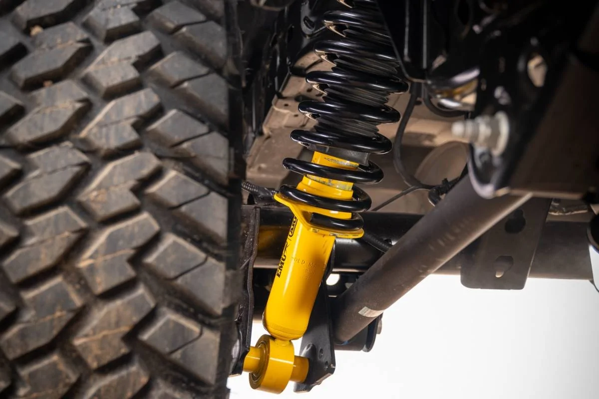

One Shock That Does It All: OME Nitrocharger Sport
Ford Bronco Which ARB Suspension Kit Is Right for Your Bronco Build? 9i1FTPEuzVfYRrgYUfIRZpA?key=UsAMNYrUI55dsBP3MxPESQ
Every ARB 4x4 suspension kit for the 6th Gen Bronco starts with the OME Nitrocharger Sport shocks and struts. These were built to make your Bronco ride smoother, handle better, and feel more stable no matter what you’re driving on.
The Nitrocharger Sport is designed to reduce body roll, smooth out uneven ground, and help keep your tires on the ground, giving you better control and comfort in all kinds of conditions. Here’s why it performs so well:
  • Twin-tube design with nitrogen gas and high-quality oil keeps the shock cool and consistent, even when you're pushing your Bronco hard on long drives or rough trails.
  • High-flow piston and multi-disc valving work together to give you smoother control over bumps, helping your rig feel stable without being stiff.
  • The 18mm chrome piston rod is built to handle repeated off-road impacts, and it’s protected by a triple-seal system that keeps internal components safe and helps prevent leaks.
  • Finished with a thick steel outer tube and a durable dirt shield, for even more protection against debris and long-term wear.
What really sets the Nitrocharger Sport apart is that it’s valved specifically for each vehicle, and in this case, the 6th Gen Bronco. ARB has taken the time to fine-tune each shock to match the vehicle’s weight, geometry, and handling. You’re not just getting a basic lift kit, you’re getting a complete suspension system built for your Bronco.
For those who want a solution that’s ready right out of the box, this is it. There’s nothing to adjust or dial in, it’s just ready to go.

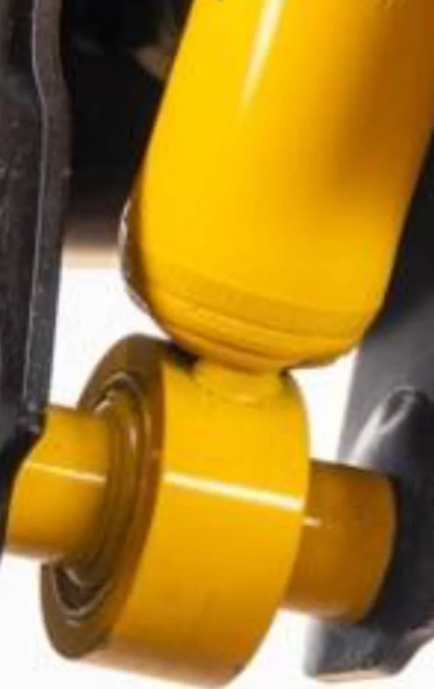

i was hoping they would be a little beefier. I’m not sure i want a spot weld holding up my vehicle.

Man, i was looking at getting these OME because they're well regarded for other platforms, but seeing that small spot weld does have me second guessing.
also wonder whatever happened to the OME BP51's from like 2 years ago that were in development.

Don’t get me wrong. It might hold up fine. Im sure the OEM bilsteins look the same, its cheaper to make. However at this price point i want more.

fully agree. should clarify i'm second guessing simply because id love to see them at least fully welded, not because i think they'll fail or anything, just kind of disappointing to see for the price point when compared to others.

From a picture I dug up on the forum, the front OEM Bilsteins appear to be welded all the way around, with the rears being spot welded. Although, the spot welds on the OEM rears appears to be more comprehensive than the ones pictured in the OP.
https://www.bronco6g.com/forum/thre...-sasquatch-shocks-and-coil-springs-700.73946/
