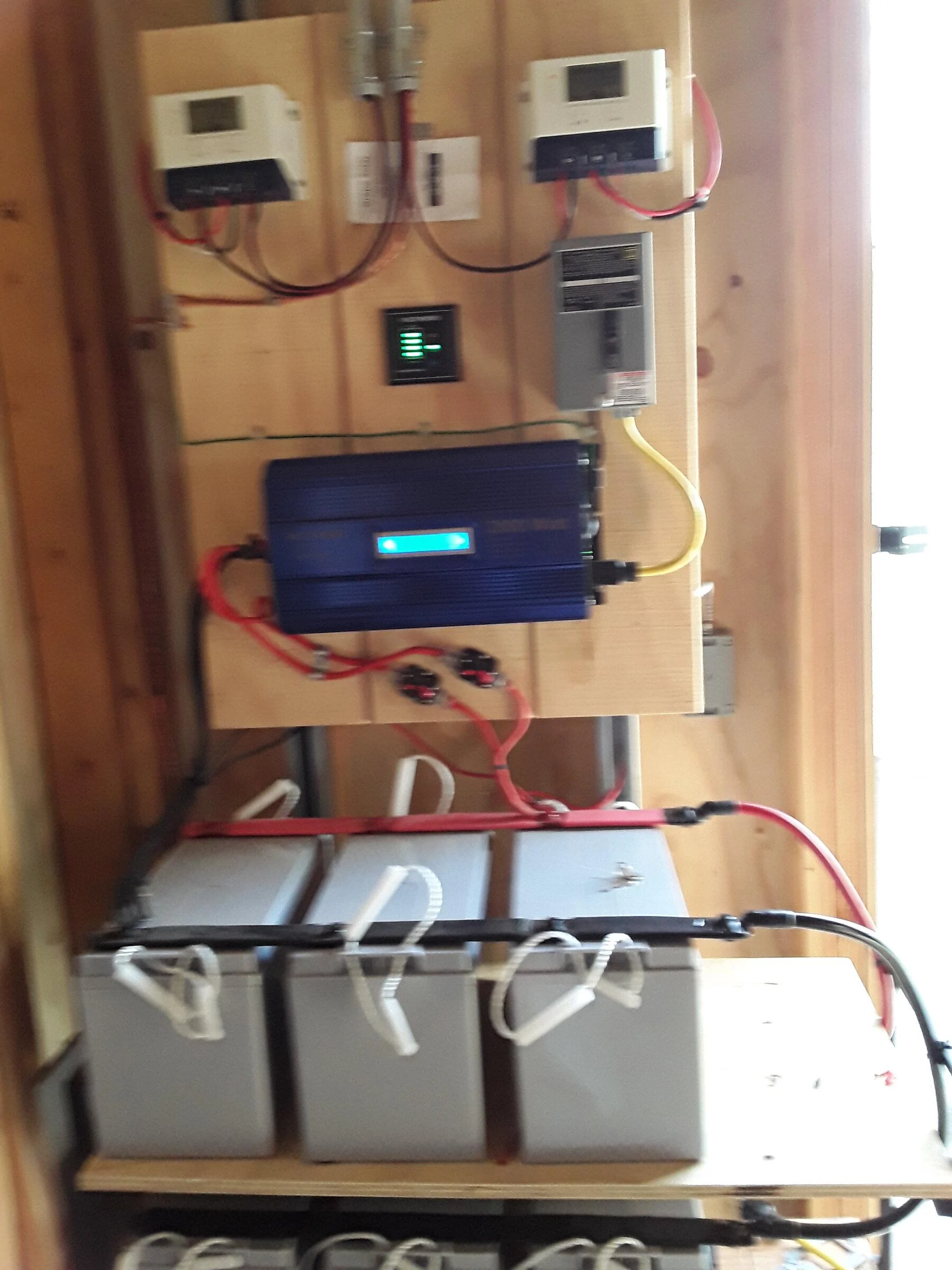

I thought the bronco would come with a standard US plug style 12v. Anyone have any good ideas to install? I am thinking the kids will need a heated blanket in the back considering the horrible airflow.
OP from reading your posts it would seem your looking for an inverter. This allows you to convert your vehicles 12 volt DC systems power through the inverter to provide 120V AC power.
First thing for you to consider.
Take your time in understanding what you want to use it for and then what items you may additionally want to power up.
You do not want to undersize your power to the devices you intend to run.
I'd suggest by starting with youtube videos.
There's plenty of them out there.
I'll be doing the same with my Bronco once it arrives.

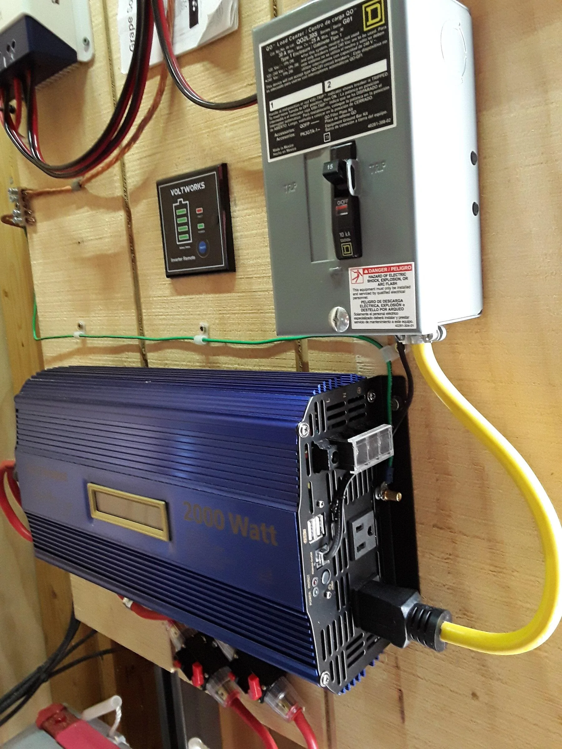

Pic below is my set up which provides outbuilding solar power and emergency backup power to the main house.
12v DC inverter to 60Hz 120 AC pure sine inverter
Again it's very important to take your time and learn about the system you want. It's not all that complicated once you grasp the basics.
Note: pay attention to the inverter you select.
Determine if it is "bonded" or "Non-bonded or Floating ground". Also I'd add look for a "Pure Sine" inverter to protect your devices.
Good Luck to you OP. If it seems too involved find a RV dealer/mechanic to assist you. They're pretty much standard features they deal with.

Thanks for the advice, that looks intense.
Ill start looking up YouTube videoes. I am fairly handy but the conversions and understanding electricity will take a bit of education… I was going to run both positive and negative to the battery, but you are saying ground closest to inverter as possible, why? I am looking at a 1000w with 2000w peak but apparently that won’t do it for a 150w blanket. I’m guessing it is the heating coil technology where we run into troubles with blankets and crockpots. Weird, it’s not a microwave or drier…
