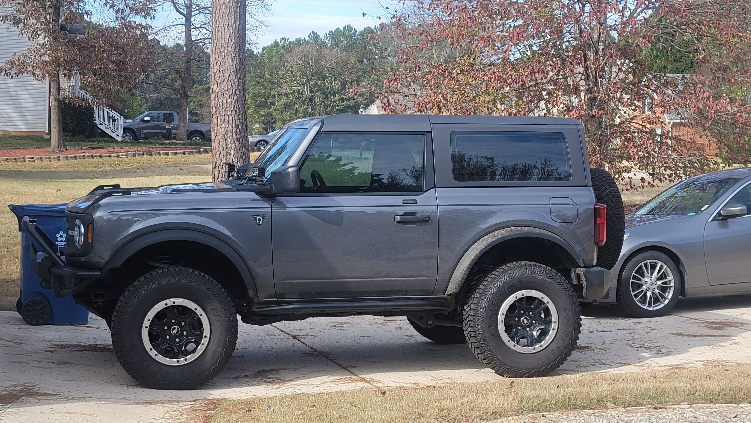

Basesquatch 2.7 . Aftermarket bumper and winch plate.
Eibach Pro lift springs.
$345 on sale
2"+ up front 1.5 in back.
A little more work to install but I consider it 10x better than a spacer lift. Rides great.
