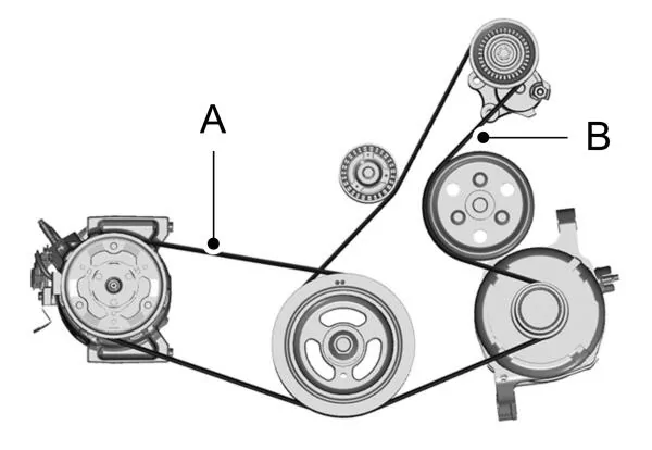

Need to replace one of the broken serpentine belts on my 2.3L badsquatch. I have looked high and low for a schematic showing how the belts go without success. Searched here, YouTube, and web in general. No luck. Can someone point me in the proper direction?

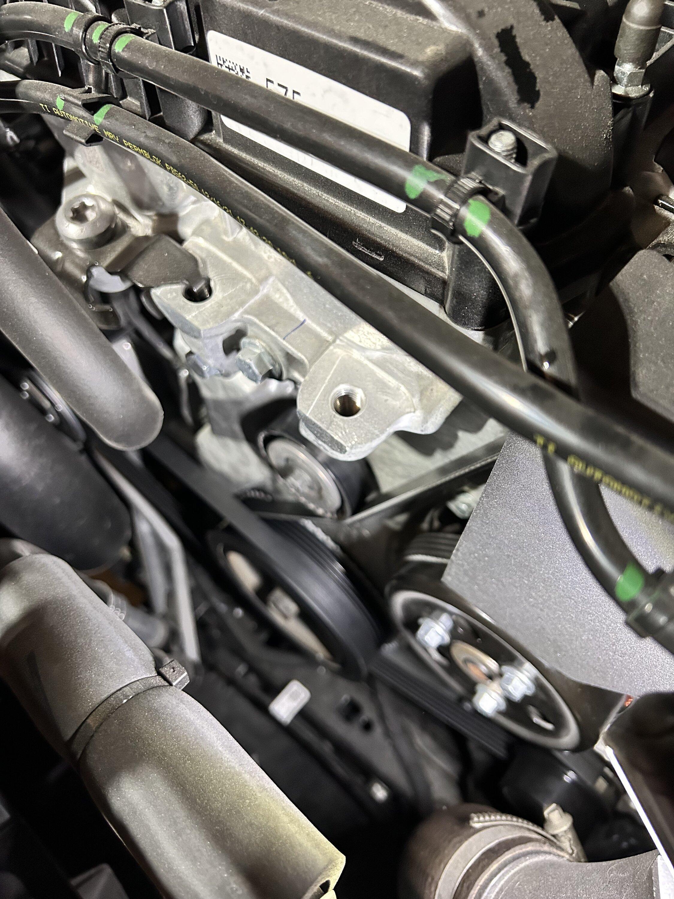

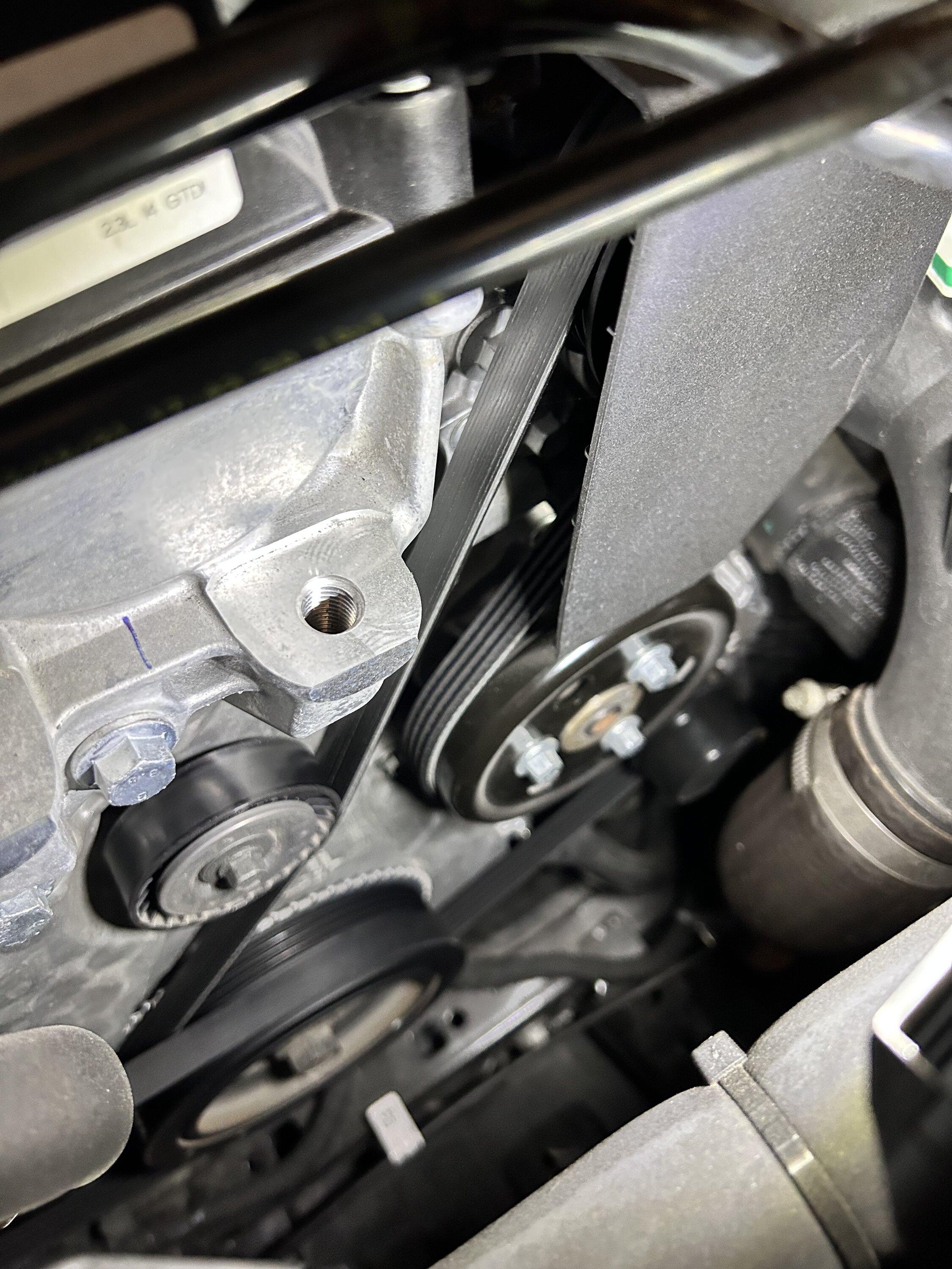

Thanks to all for the prompt responses. Very helpful, not only in repairing but also figuring out what happened. I unintentionally got into some deep water today. After several anxious moments, both lockers in and some to and fro was able to back out. Within several minutes of being out I got coolant overheating warning. Checked and found both belts off. The long one (B) was broken. Short belt (A) to a/c compressor was ok. Belt B broke because the water and sand froze accessory drive idler pulley. Won’t turn at all. Luckily I carry tools. Was able to stretch the short belt (A) over coolant pump and alternator which got us out of the woods and home.

- Great save on using the short (A) belt on the critical parts to get you out of there! Two questions on that: 1) how much of a stretch was it and what tools do you need to stretch it? 2) It looks like that would result in the coolant pump rotating in the opposite direction, is that true and if so it doesn't matter in an emergency?
also
- I have changed serpentine belts like B before, but never a two belt system like this. If only B breaks it looks like you have to take off A in order to replace B. What is the process for removing A? Is it loosen the AC compressor bolts?

Short belt farthest from engine, long belt closest to

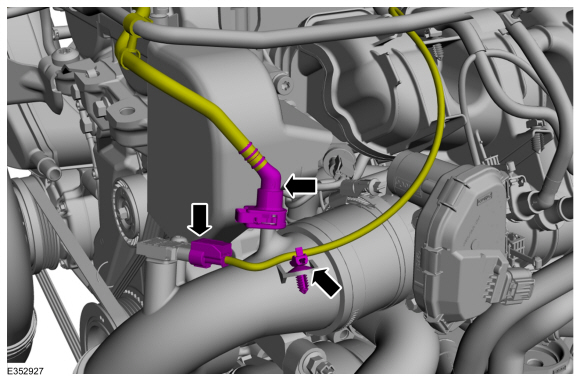

  1. Remove the quick connector and the electrical connector.
    Refer to: Quick Release Coupling (310-00A Fuel System - General Information - 2.3L EcoBoost (199kW/270PS), General Procedures).

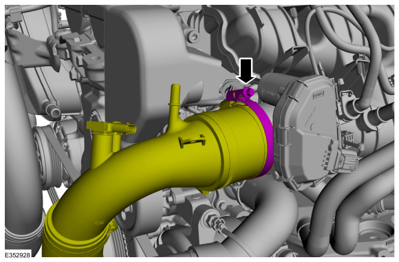

  1. Loosen the clamp and position aside the CAC outlet pipe.
    Torque: 44 lb.in (5 Nm)

@BudgetBronco - I threaded the belt over the alternator and water pump and then used a 21 mm racheting combination wrench to slowly rotate the crank while pushing / stretching the belt onto the engine pulley. I cut it this morning to get it off. Re: water pump rotating backwards. I didn’t notice that until you mentioned it, but that might explain why I had to drive at 35 mph to keep coolant temps in the green. I kept engine gauges up the entire way home.
