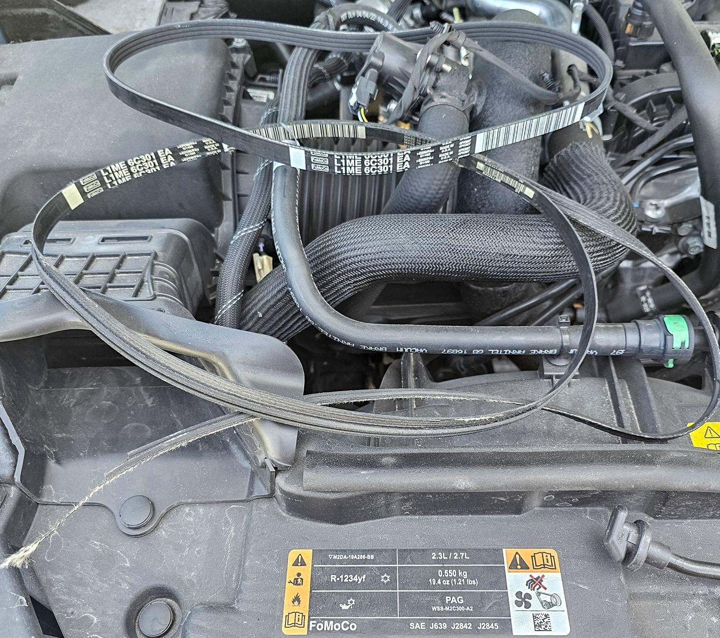

Somewhere along I-10 in west Texas, my A/C compressor belt decided to hit the ol' dusty trail and pursue it's 21+k mile dream of calf-roping. Like many broken belts before it, its dream was over before it began...
Well, I found the old belt as it was hanging onto a charge pipe clamp screw and supported by the skid plate. It was half peeled and inside out.
Ford Bronco 2.3L A/C Compressor Belt - INSTALL 1000026843
**old in foreground, new in the rear

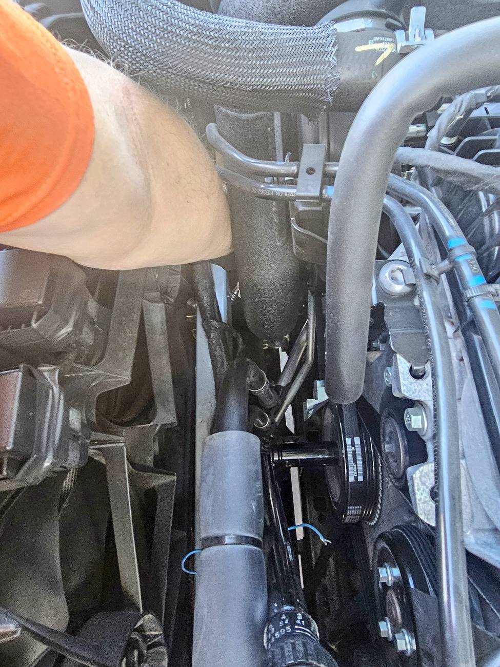

The install, with $20 tool, Lisle 59370 Stretch Belt Remover / Installer, and $20 belt went super smooth after a bit of resistance on the crank that I'm attributing to the other, larger belt. I was also being very very gentle because, while I knew it should work, I was also following a random YouTube video to play with my modern engine.
I'm 6'3" and have a decent wingspan, so this picture is how far I had to reach my arm in to set the belt, and hold/guide it on the grooves, on the compressor pulley.
