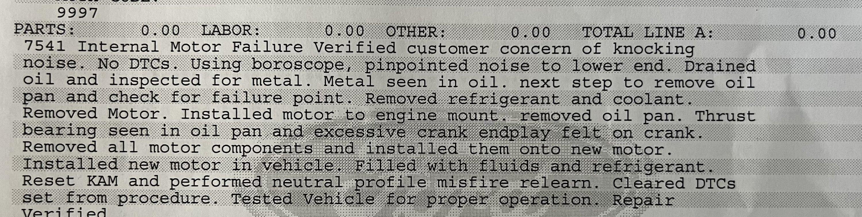

Dropped my car off on 6/9. Got it back on 7/13. Surprisingly the longest wait time was just them getting around to diagnosing my car. Once they realized what was wrong, from ordering the engine to putting it only took about two weeks. The pic is what they said was wrong with it
Ford Bronco 2.3L engine dead IMG_4013
