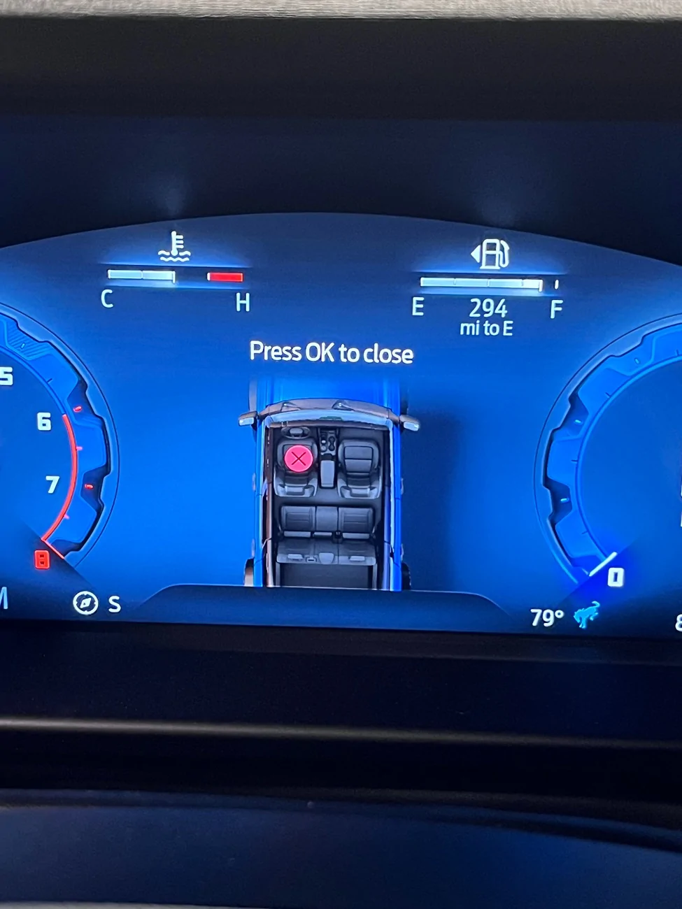

I've eliminated the seatbelt and door chimes, but I don't see anything in the plain English enable/disable options to remove this pop up? Anybody know if it's possible, and if so... how? I'm not opposed to doing As Built.
You can't remove that. Just the sounds.
