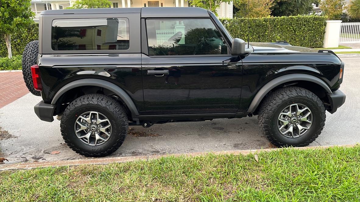

I thought for a second I might be your buddy rguest3 since I just picked up these Badlands takeoffs earlier this week.
Here is how they look on my Base incase you like the look oudidntknow84. I'm a big fan personally.
Ford Bronco 2023 Base Bronco tire options? CFD04A82-FA94-4DA6-879E-C30B6AD58824_1_105_c
Yeah. Those tires look really good on the bronc. I just like the design of the nitro ridge grappler. I think they look cool. Lol

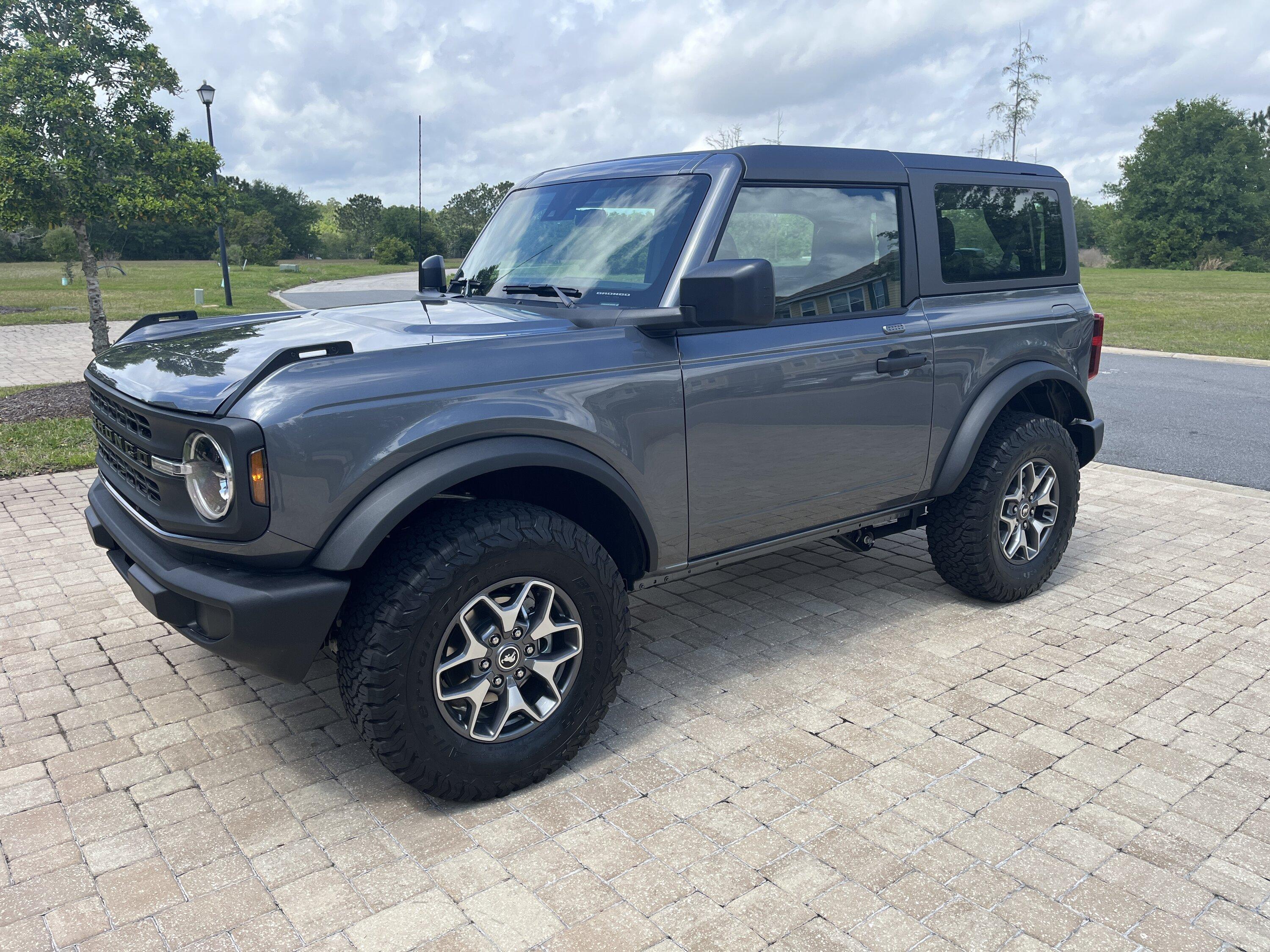

2023 Base 2 Door, Manual, 2.3
Base with Badlands takeoffs. Perfect IMHO. Haven't adjusted the computer for the tire size yet so it's 4-5 mph off.
