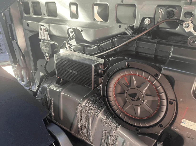

So you clipped the harness from the factory amp connection and removed the amp? Did you place the Key 500.1 In the same location of the factory amp? Any Pics?
correct. I mounted the Kicker Key 500.1 amp where the factory amp was located. It doesn't fit in the same holes but in general it makes for a nice place to mount. Here's a pick.
