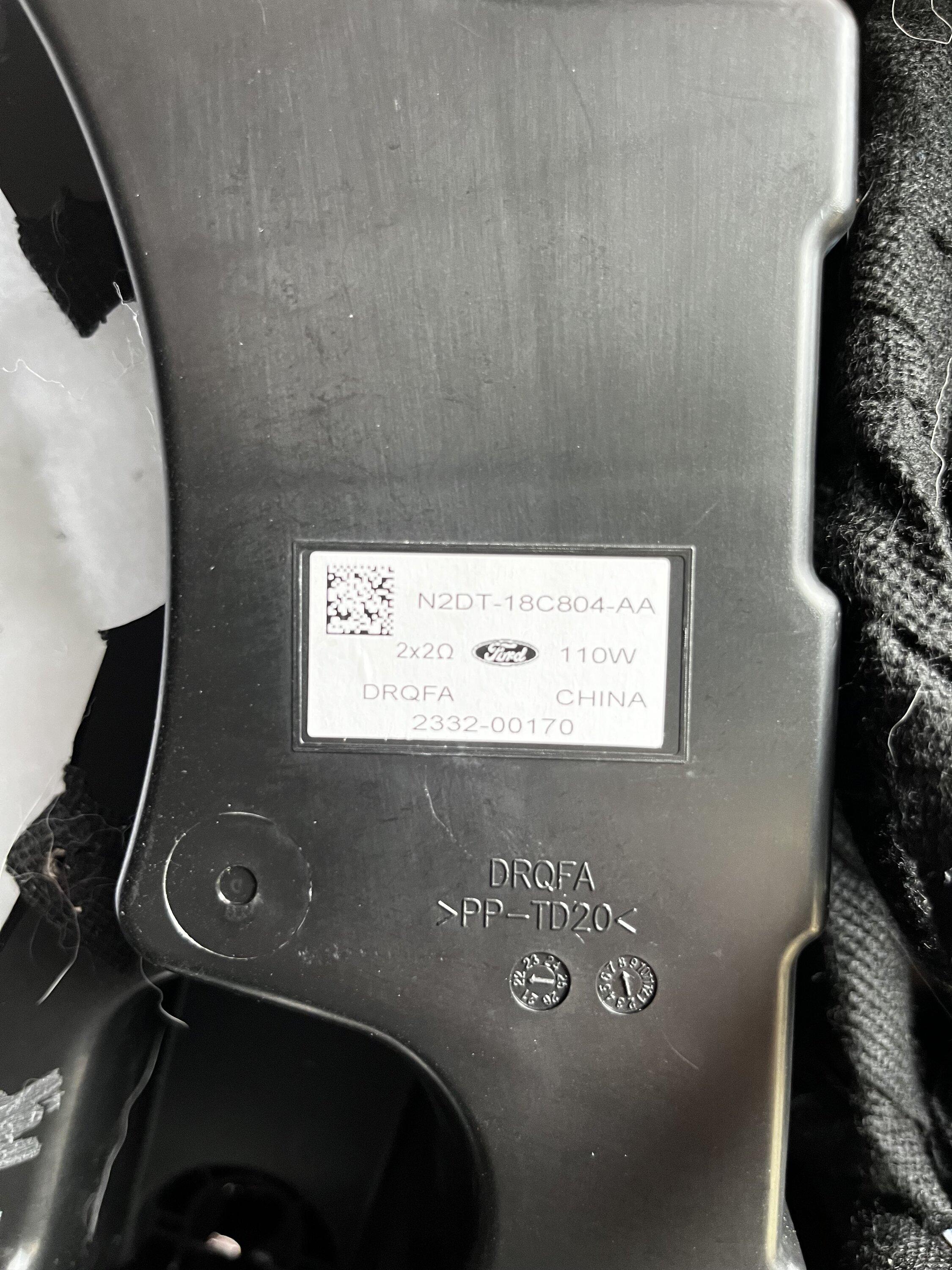

Great post, helped sway me to just do my dash speakers and rear pods. Do you have any info on the stock sub speaker? Size and what kind of connector it uses? Trying to replace just the actual speaker itself, but the info is hard to find.
Ford Bronco 2023 7 speaker subwoofer upgrade IMG_0364
I don’t think I would just change out the speaker only. This guy tried it and it didn’t sound any better
https://www.bronco6g.com/forum/threads/anyone-have-picture-of-the-b-o-sub-harness.40760/post-1352611

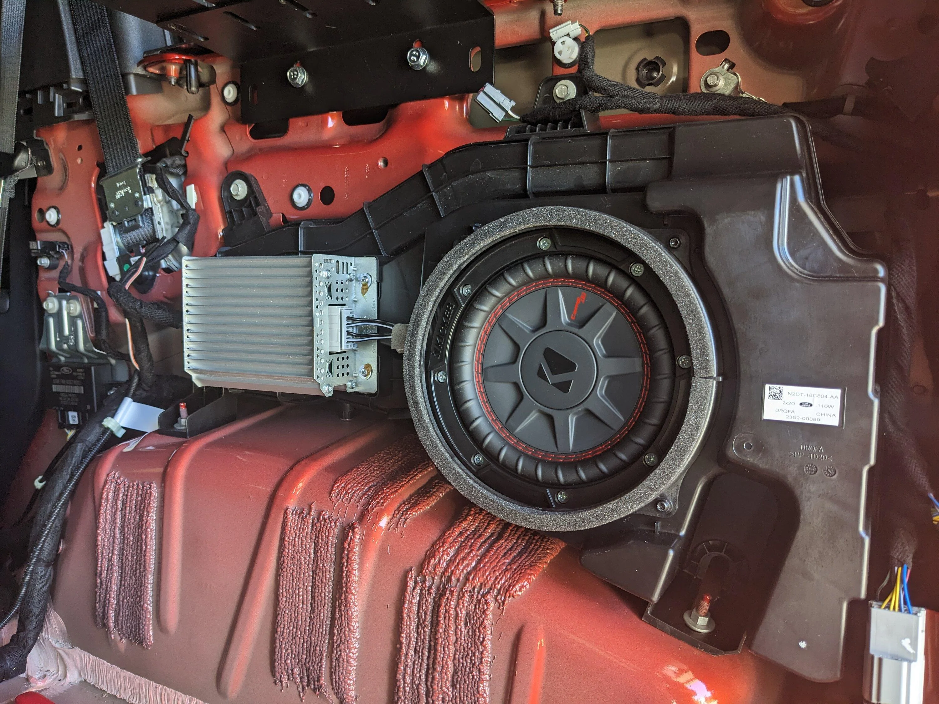

Did mine today using the Kicker 6.5 🤟
Ford Bronco 2023 7 speaker subwoofer upgrade PXL_20230503_212918628
Well done my man. It's a pretty simple install. I did the same thing. I think I twisted off a small plastic protrusion off the speaker box and made the wires longer from the stock amp and that was it.
I originally had an RF amp with an RF 10" box sub, but wanted to know how good it would sound by running the RF amp to the new 6 3/4" Kicker sub. So I did. It sounded fine. No "boom boom" but it was pretty decent. I still wanted to use my box sub tho so I decided to run the 6 3/4" to the stock amp and I'm happy now. Definitely done with my stereo for the Black Diamond work truck. Now I'll tackle the stereo on my Outer Banks. Lol

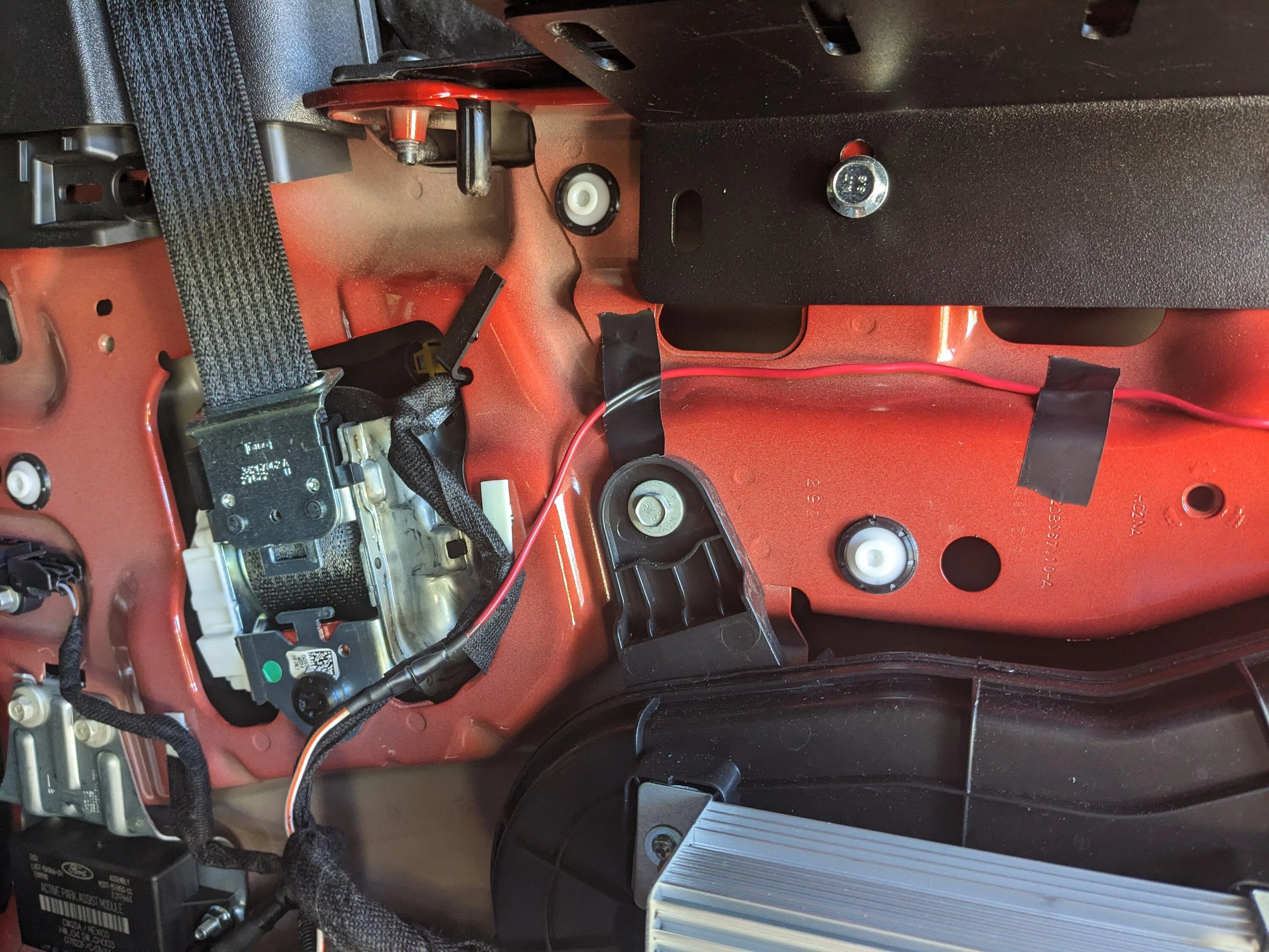

Yup there is a plastic nub that a razor blade took care of. Also got the stock wires to work hence why it's clocked. I also extend the upfitter wire to the back corner so I could access it later without messing with the cover.
