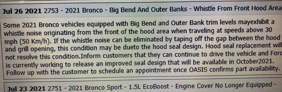

Ford Bronco Whistle sound coming from grille / hood on some Big Bend and Outer Banks Broncos. Improved hood seal design coming October CA0D1662-4810-49AA-A1F5-2FB02467B49C

I have driven 2 different outer banks vehicles and neither exhibited the whistle. I took extended drives in both of them. They both had Lux.
I drove a base sasquatch, obviously without said Lux package and it exhibited the whistle constantly.
I'm pretty sure Ford is off the mark with the cause. Most think it's related to the lack of camera on the bottom of mirrors on mid or lower packages that must break up wind flow or something similar.

I wonder if its because the higher end models have that insulated hood dampener.
BB/OB Grilles are the same exact design. Ford identified that only that grille design is creating whistle noise and is working on redesigning a part revision.
