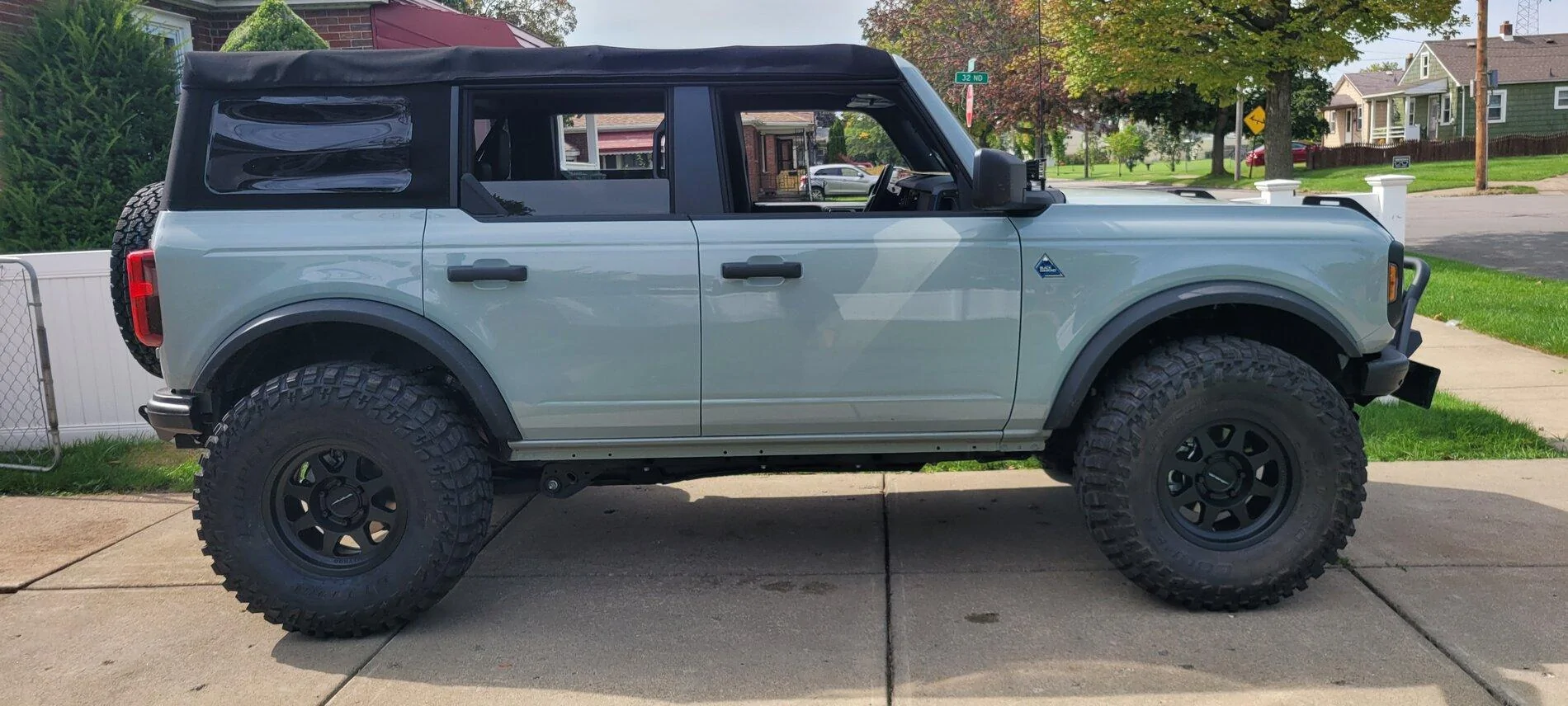

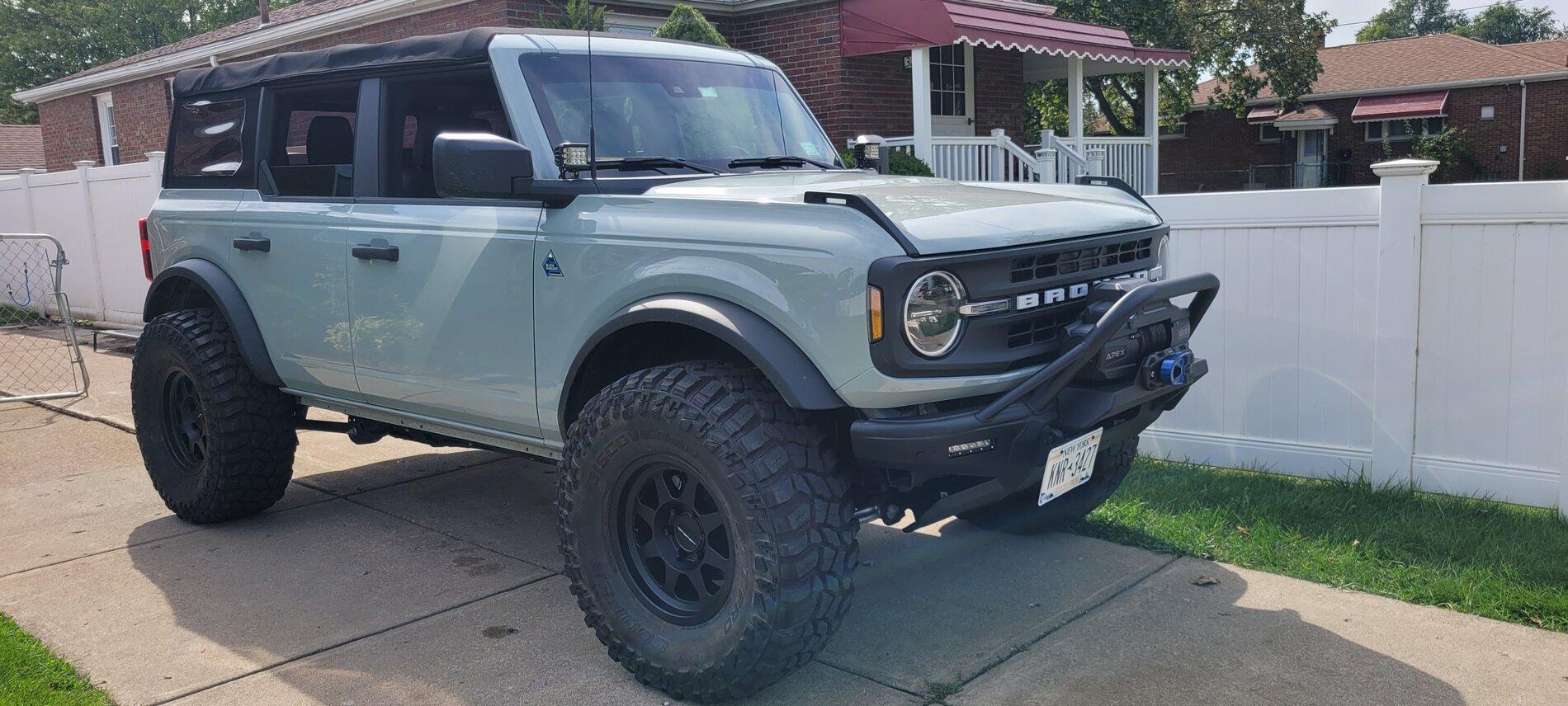

Black Diamond non-sasquatch 2.3 manual.

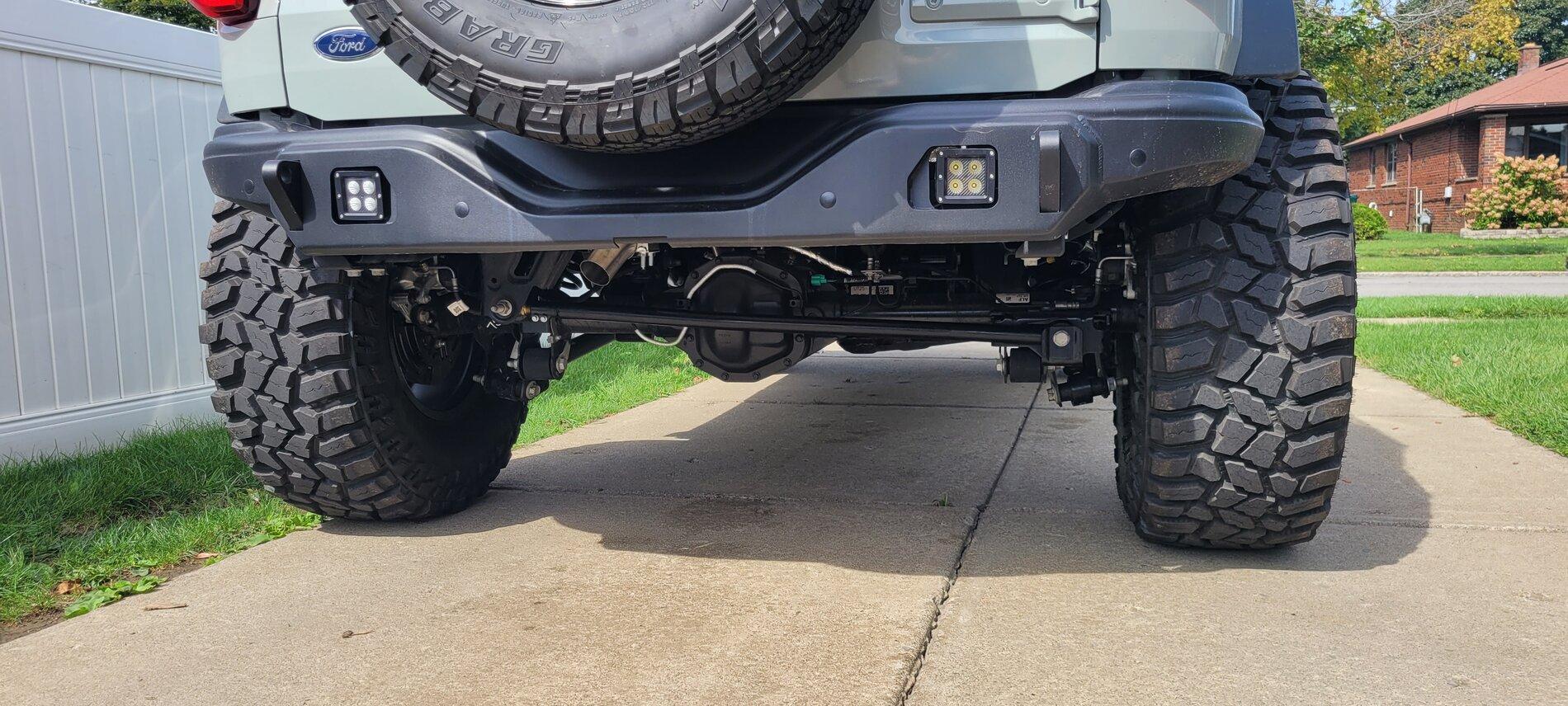

Installed Rough Country 2 inch spacers, 4WP upper control arms and rear track bar.

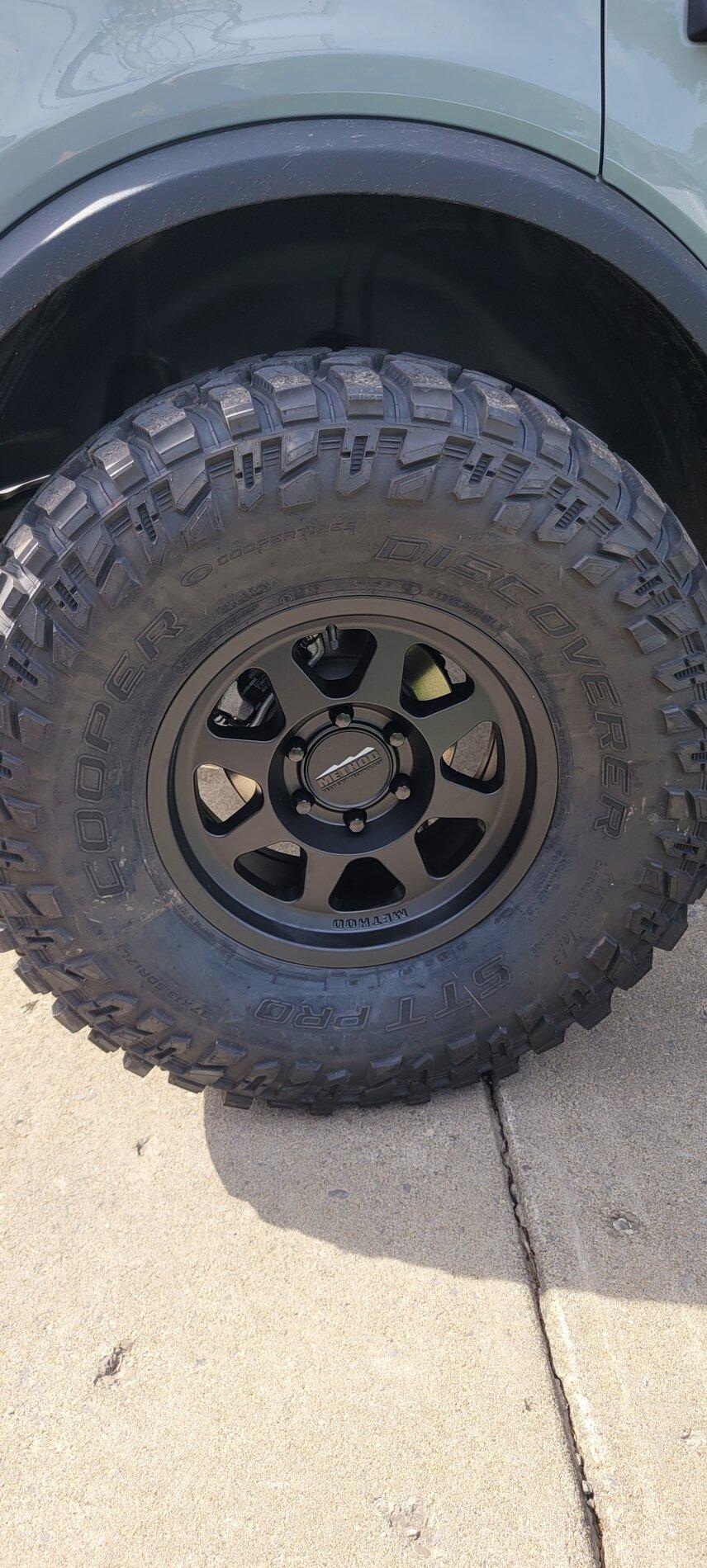

37x13.50x17 cooper discoverer stt pro tires
Method 701 17x8.5 0 offset
These tires were off my 2016 ram 2500 and just barely rub. I would much rather have 35s but wasn't buying a whole new set of tires.
I have king shocks on pre-order and was impatient so ordered the spacers to install the arms and track bar. Everything installed fairly easy and the 4wp stuff is decent quality. As for spacers, I'm not a fan of them, but that's what's out right now.
The ride pretty much feels the same if not a little better from the tires absorbing some hits.
I didn't order sas package because I took a chance of getting my bronco early. My reservation was 7/28. But I do regret not moving up to badlands. it is what it is.

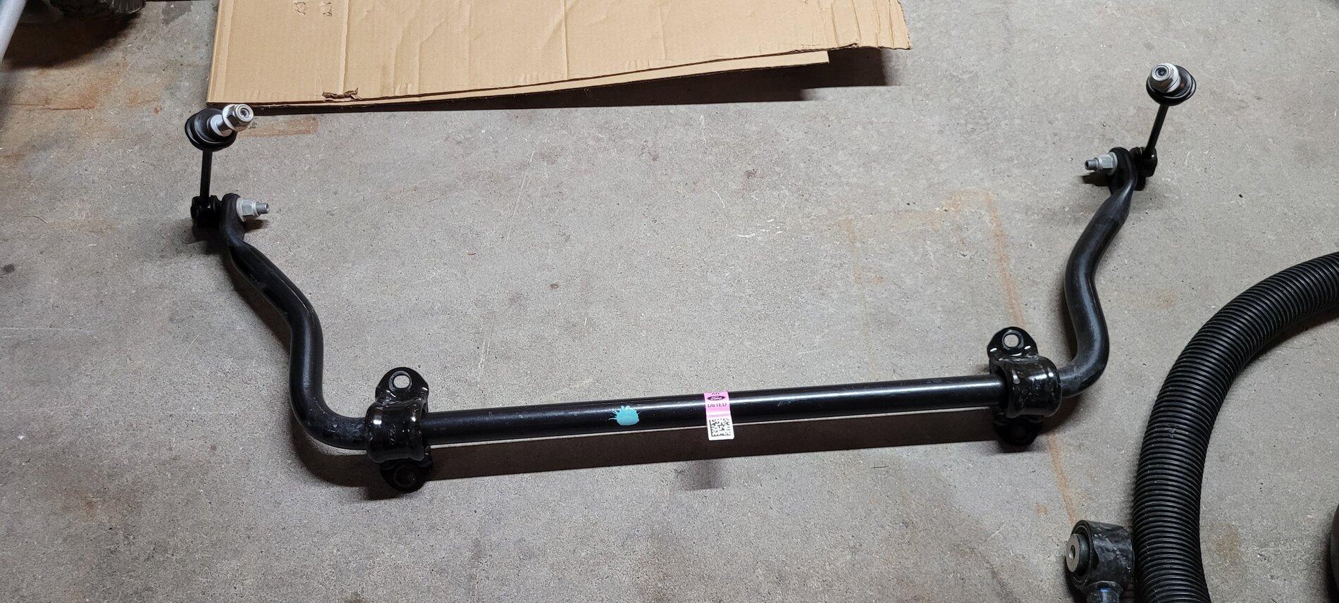

Cheaper sway bar disconnect
