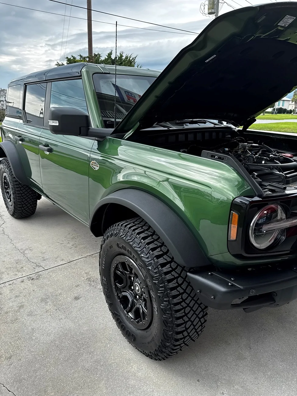

I have owned maybe 50 vehicles in my time, and with only a couple of exceptions, they have all been Red, Blue or Black, but for some strange reason, I really liked this green...I didn't at first, but the more I looked at it the more it grew on me until I finally decided that it had to either be this green or red....I think it looks great with the black accents...
The best thing about these vehicles to me is how easy they are to make it your own. Rarely do you end up sitting beside one exactly like you at a stop light....
