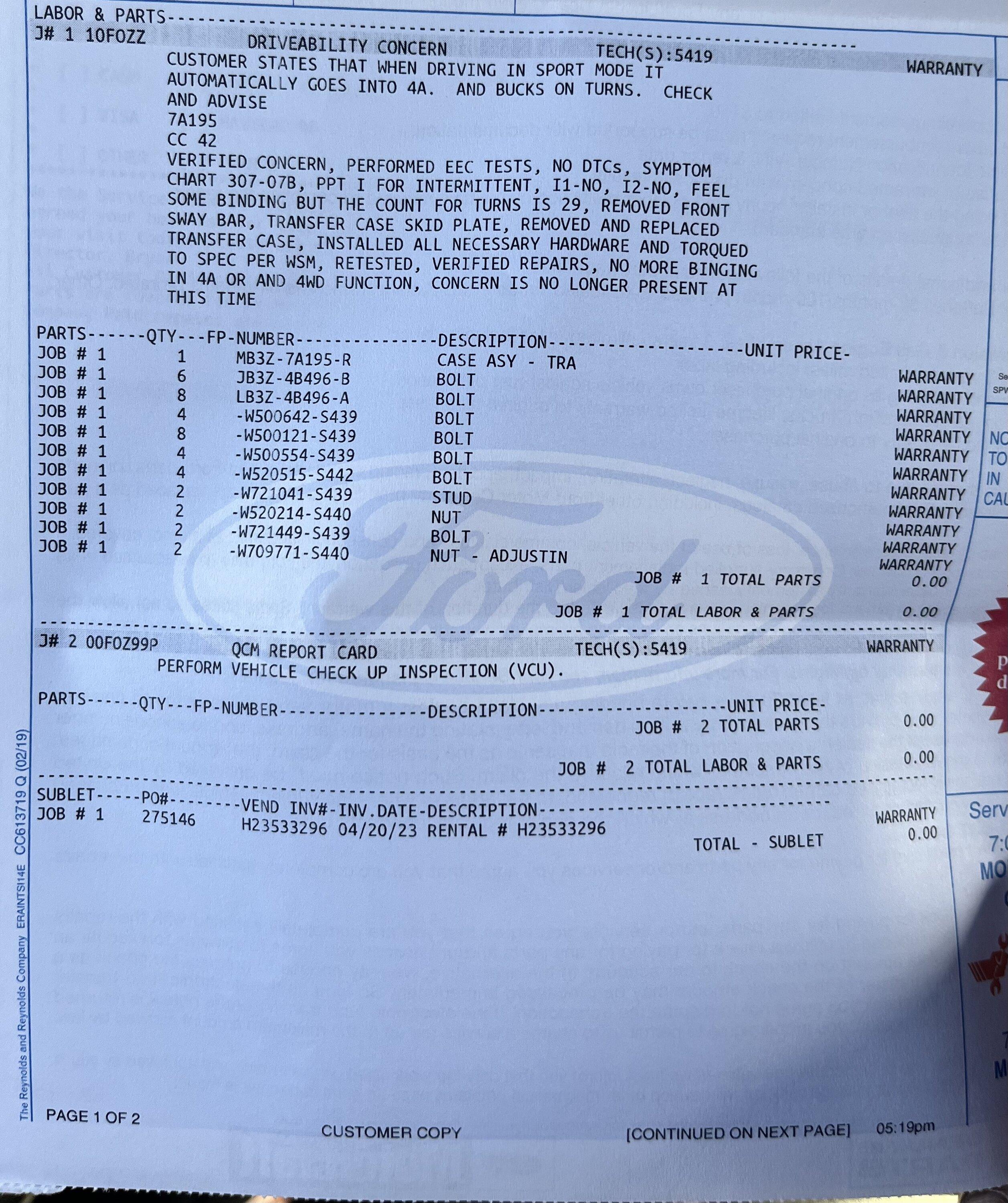

My dealer at first said this was normal and I had them do a figure 8 in the parking lot while in sport mode (4A ) and they are now replacing the transfer case.

In my case when the vehicle is in 4A when the wheel is turned it binds the right rear wheel and starts to vibrate as you move forward. They tried it after removing the front driveshaft and it still did it, so they determined it was the transfer case that was faulty. I am still waiting on one which has been backordered for 45 days and counting...

The dealer replaced the transfer case and all is right again. No binding on turns while rolling. Here are the techs notes and parts replaced.
