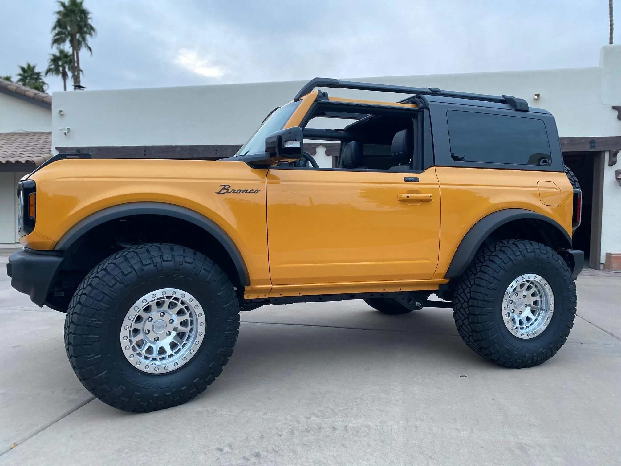

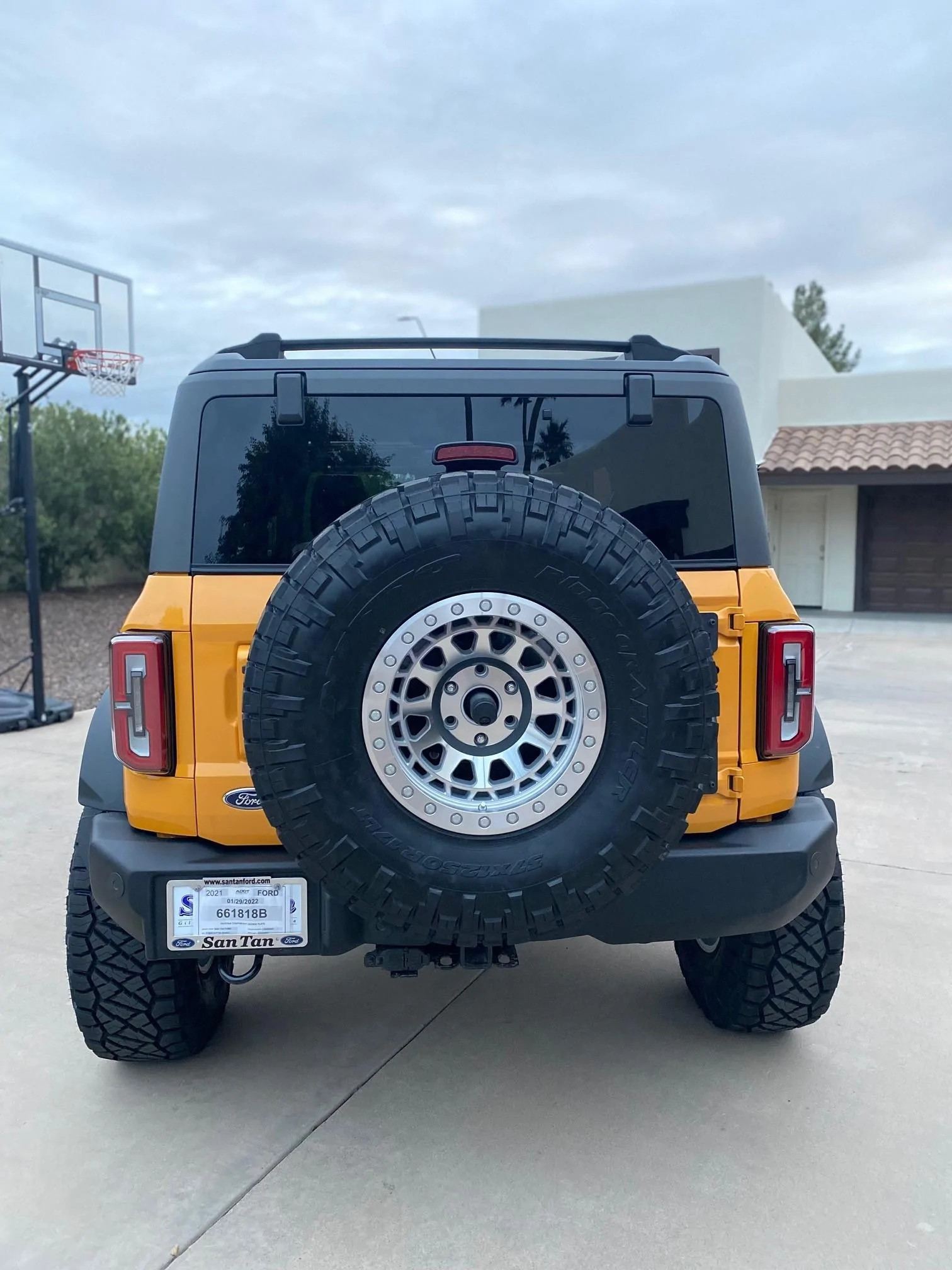

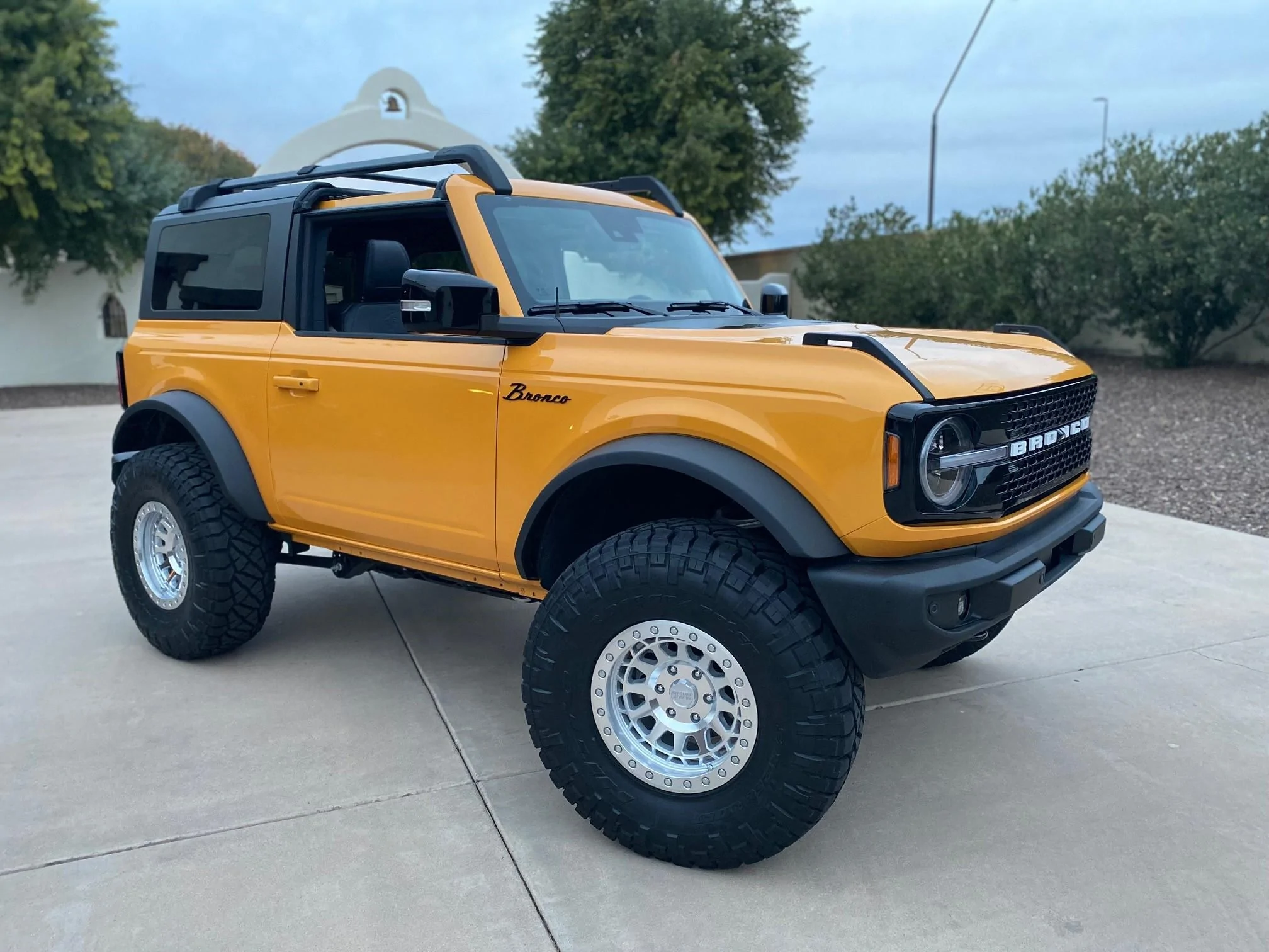

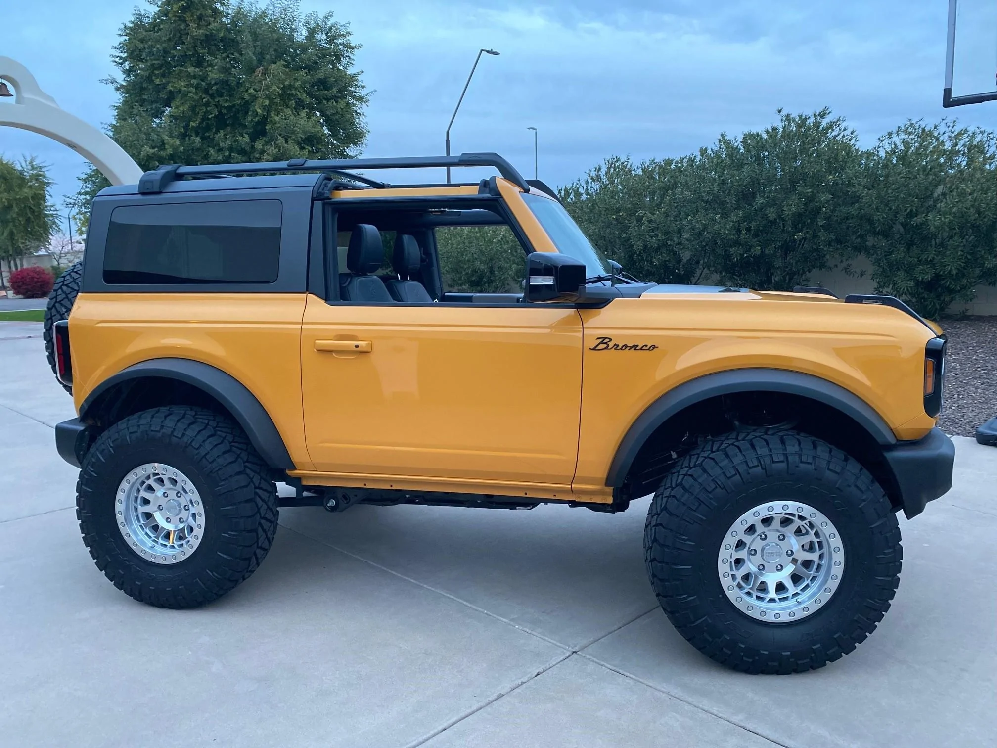

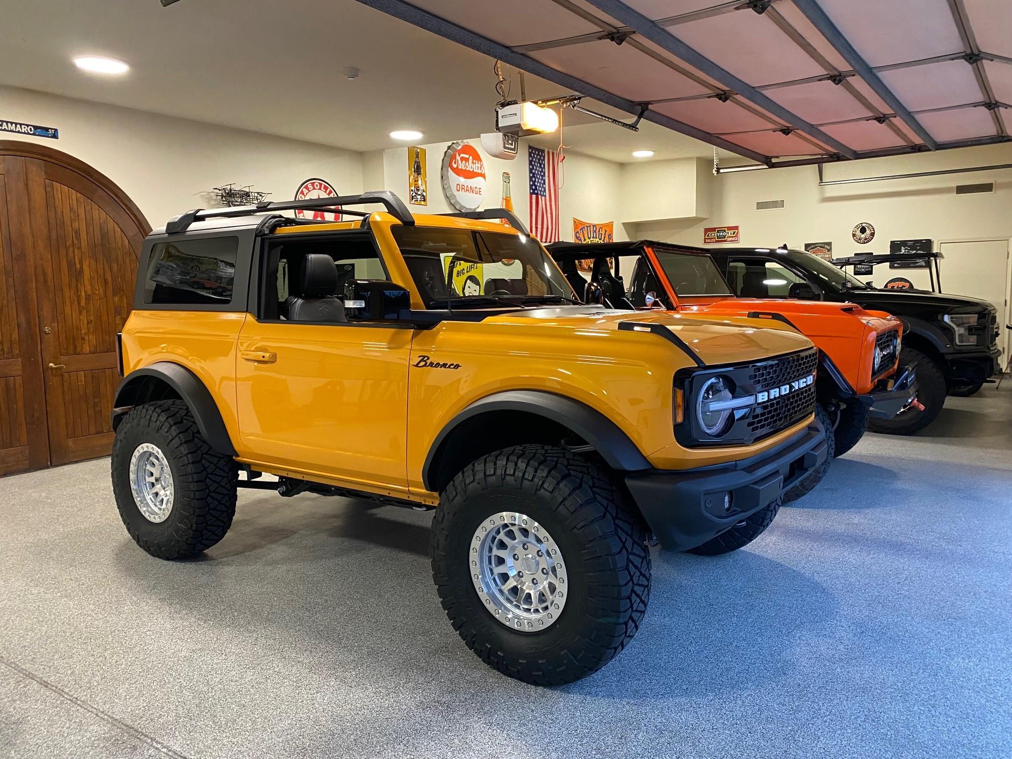

Thought i would post the first pics to the start of my build. So far i have installed 37x12.5x17 Nitto Ridge Grapplers on a set of Black Rhino Primm Beadlock wheels with a 0 offset. I also installed the RPG 2.25" Perch Collar lift. It raises the front 2.2" and the rear 1.2"". The crash bars are removed and i have absolutely no rubbing issues at all. I added the Rough Country 3rd brake light extension and tailgate reinforcement brackets. I also added the classic bronco script badges.
Last week i put the order in for the ADD Bomber front Bumper with the Rigid 360 series lights(3-4 month lead time). Since the lead times are so long for coil overs i decided i didn't want to wait so that's why i got the RPG collar lift. Rides great! Will end up replacing that with a coilover kit at a later date. So far i am in love with the Bronco and so happy i did the 2 door. Wanted it to match my 73 a bit more.
Update 3/29/22: Finally got the RSE Electric Steps and Magnaflow exhaust put on.

The extra 20 ish pounds of weight on each wheel/tire, how is the braking and do you think the rear door hinges will hold up with your extra bracket?
No noticeable difference in braking. And yes, the door hinge bracket was designed to support the added weight of 37’s.
Have you flexed it to check rubbing or are you just talking no rubbing in street use?
Ive had the lift on for only a few days so havent taken it out post lift. I plan to go sometime next weekend. However, there is a few members on the forum, including RPG, who have given a good review with this kit on 37's. From what i gather, as long as you have a 0 offset, you wont have any rubbing issues. I believe another member here did the same kit with 37's on a method wheel with a -13 offset and he didnt having any rubbing either.
