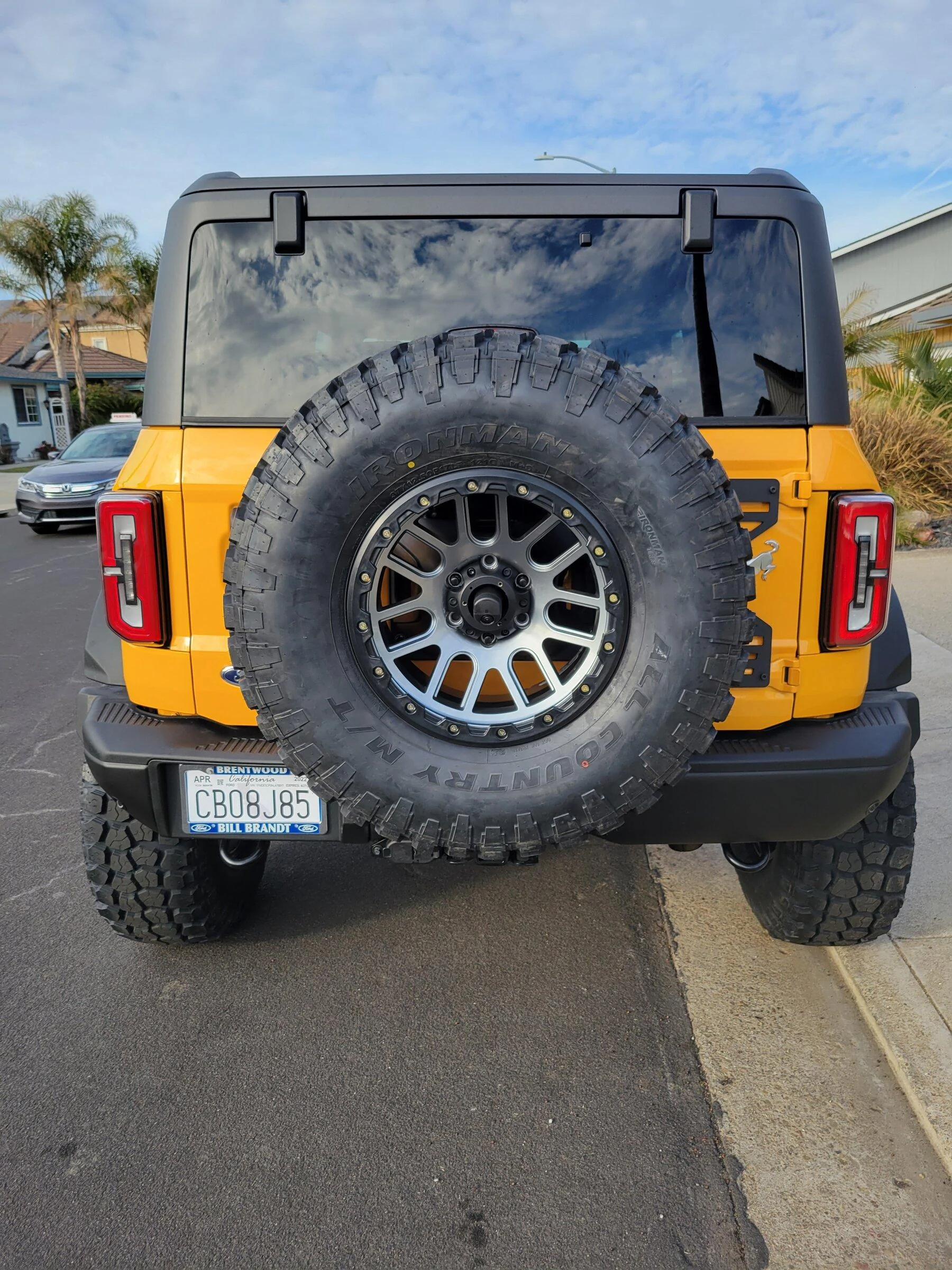

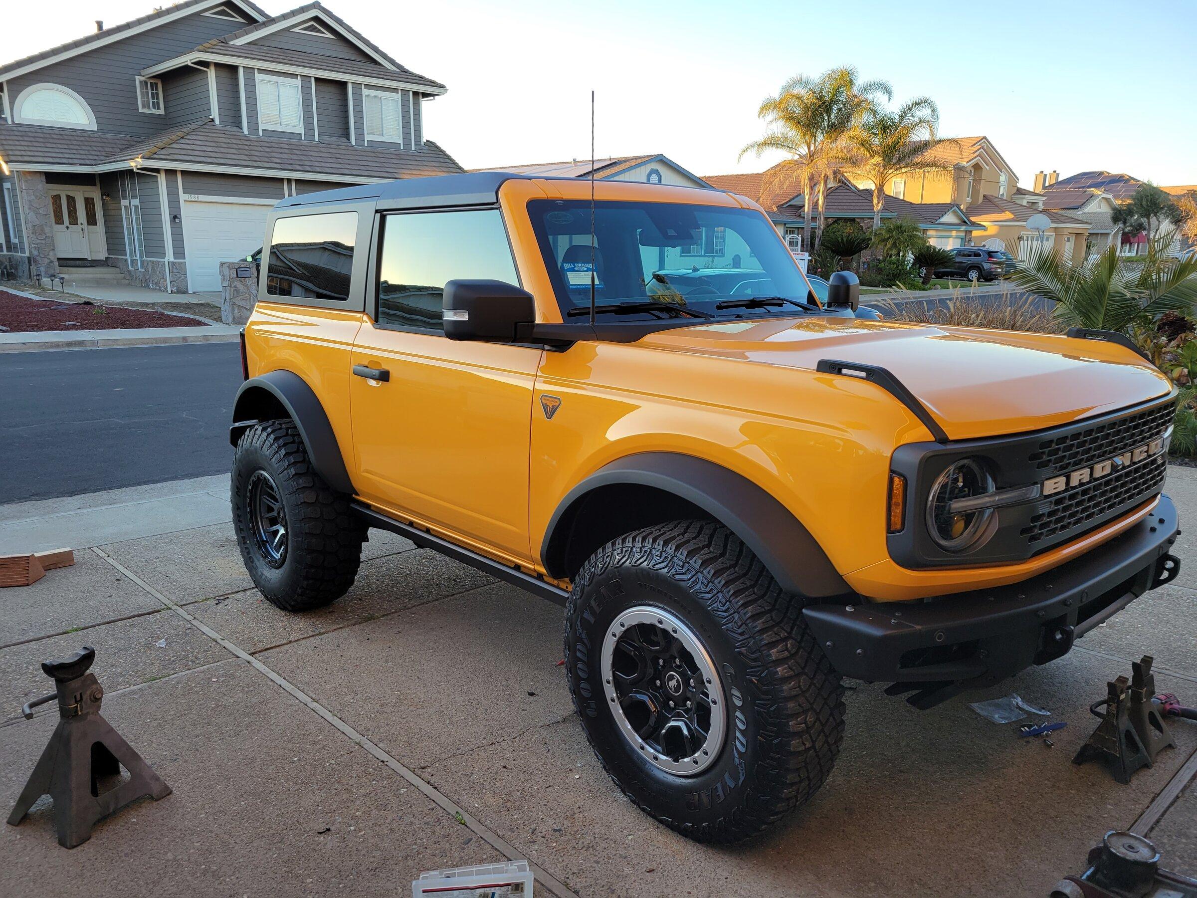

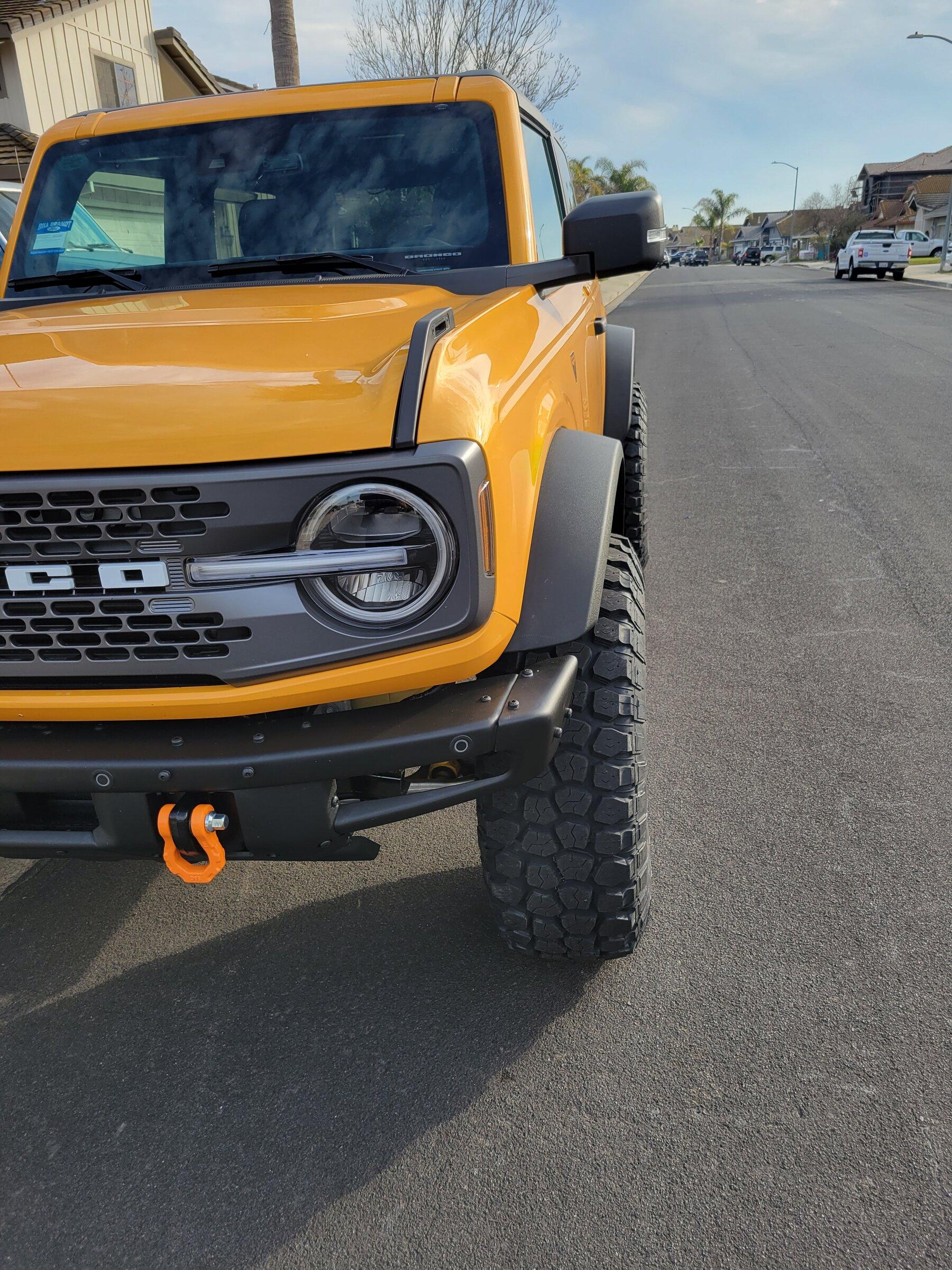

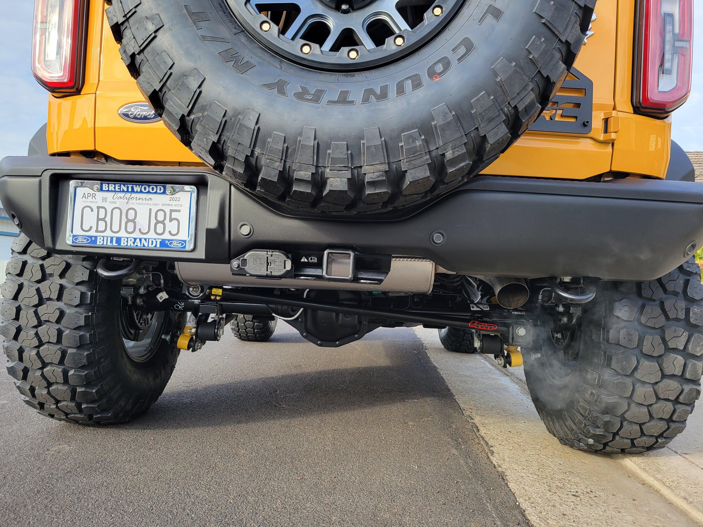

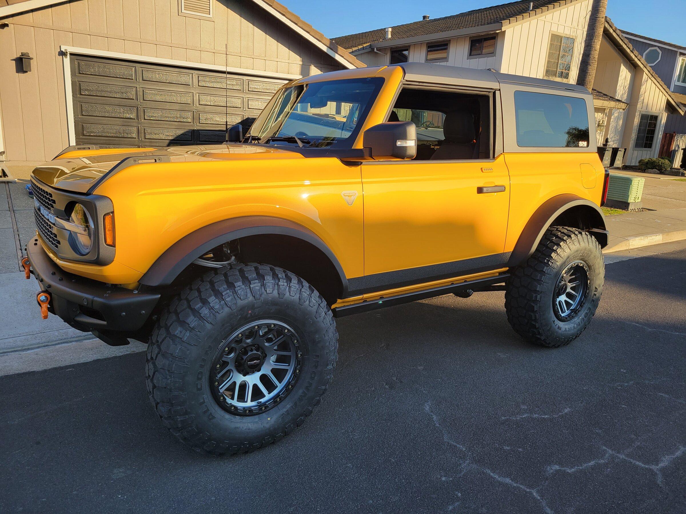

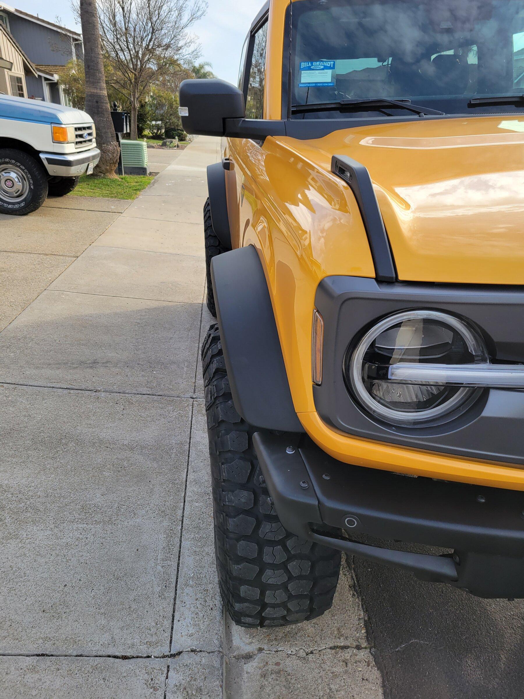

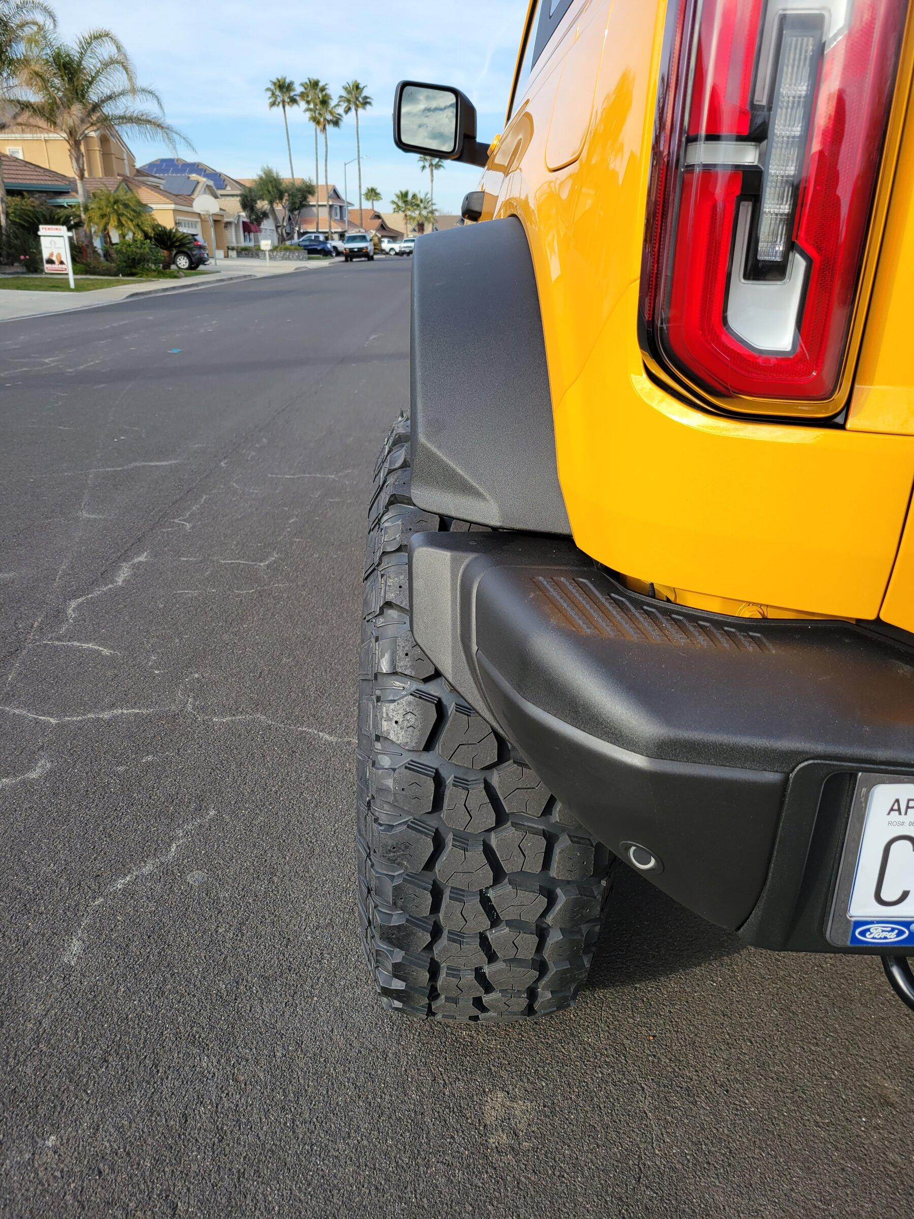

Just finished my getting the Bronco on 37 tires. So far so good no rubbing seems to ride a little better than with the stock Goodyears.
Full specs / mods:
2022 Bronco Badlands Sasquatch 2.7L
RPG Spring Perch Lift https://www.rpgoffroad.com/product/bronco-spring-perch-collar/
17x9 -12 offset Vision Nemisis
37x12.50x17 Ironman Mt
Vision 17x9.5 -12 Wheels
4wp track bar
Rough Country spare reinforcement
Stereo:
- Kicker key 200.4 powering 2 kicker KS 6.5" and 2 KS 4" up front
- Rear kicker KS 4 inch factory powered
- Kicker key 500.1 powering a kicker comp rt down firing shallow 12.
Ford Bronco 2 Door on 37s, RPG lift, Vision wheels 20220130_161132
Ford Bronco 2 Door on 37s, RPG lift, Vision wheels 20220130_161110

You don’t think the 37’s look too big for the 2 door? Was thinking of doing this as well.

I think they look better than the 35s

I was down at koh and ran around all over. I will say that the 37s handled the rutted sections on the lake bed at high speed better than the 35s. Also was able to move around in the rocks a little better as well.

No noticeable mpg or acceleration reduction. One thing you will notice is a little more roll in hard cornering on the pavement but what do you expect from a box on 37s lol.

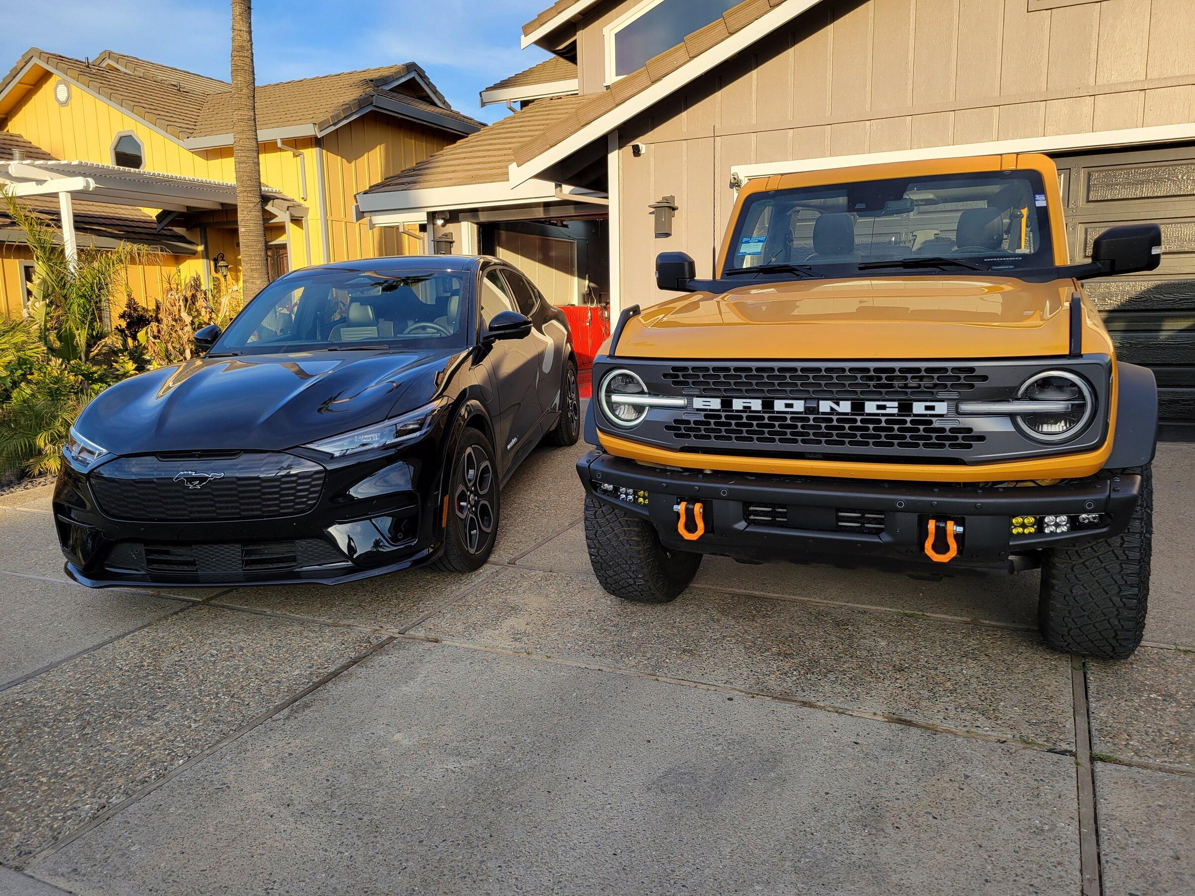

Tony, looks great! Next time I want to get a better look at that MachE GT lurking in the background. 🤣

Nicely done!!! All 2dr should have 37".... We rule!!! 🤩
