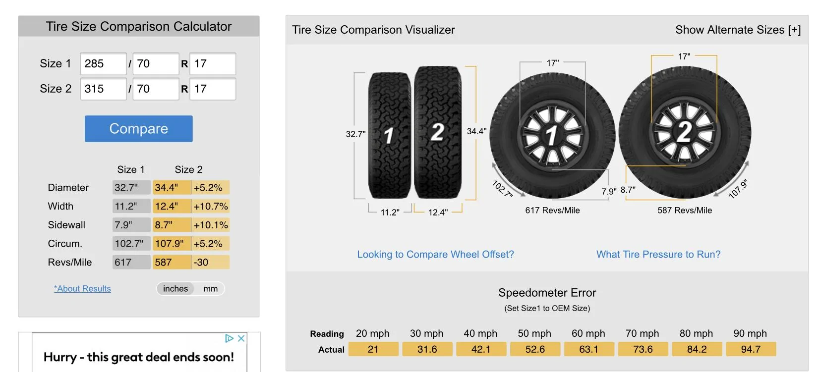

Tire size comparison on the 285/70/17 and 315/70/17.
Ford Bronco 35's vs 33's any big differences? 229582AC-9A1A-4216-844E-8912AE9C645D
The speed difference is what I was looking for. Will dealership be able to adjust for that difference if stepping down from 35” to 33”?
