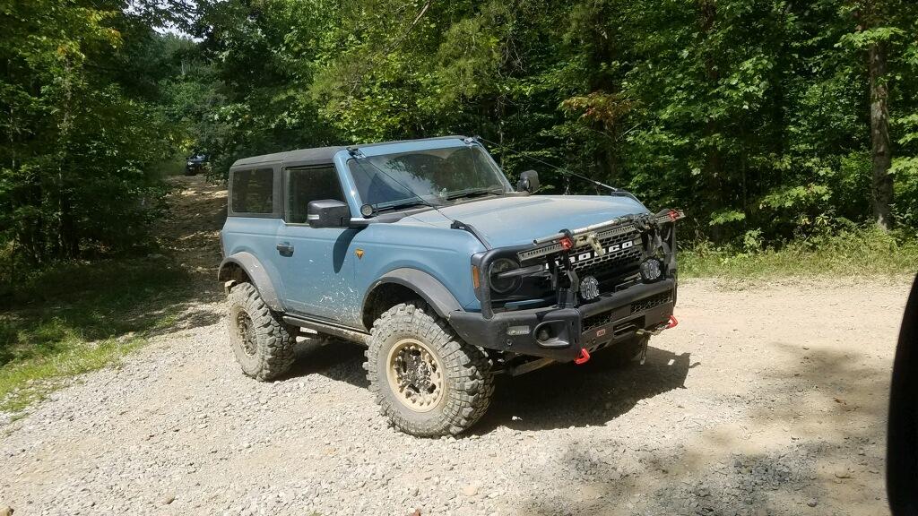

Hi, I'd like to add if I may, when you lift the articulation of that lift comes in to play for rub. You may need to lengthen your bump stops. This is often overlooked.
I run a 3" body lift and 37x12x17 interco sxII they are on Hutchison Rock Monsters.. I rub dricersside cutting left at compression slightly. I run the stock squatch tires on highway.

Where are you rubbing? did you lengthen bump stops? I would have thought a 3" body lift would have been fine for upper fender clearance without limiting up travel. But the body lift doesn't alter clearance with the frame and frame horns.

It's the front crash bar holder.. Only seems to rub the drivers side though.. it is slight.

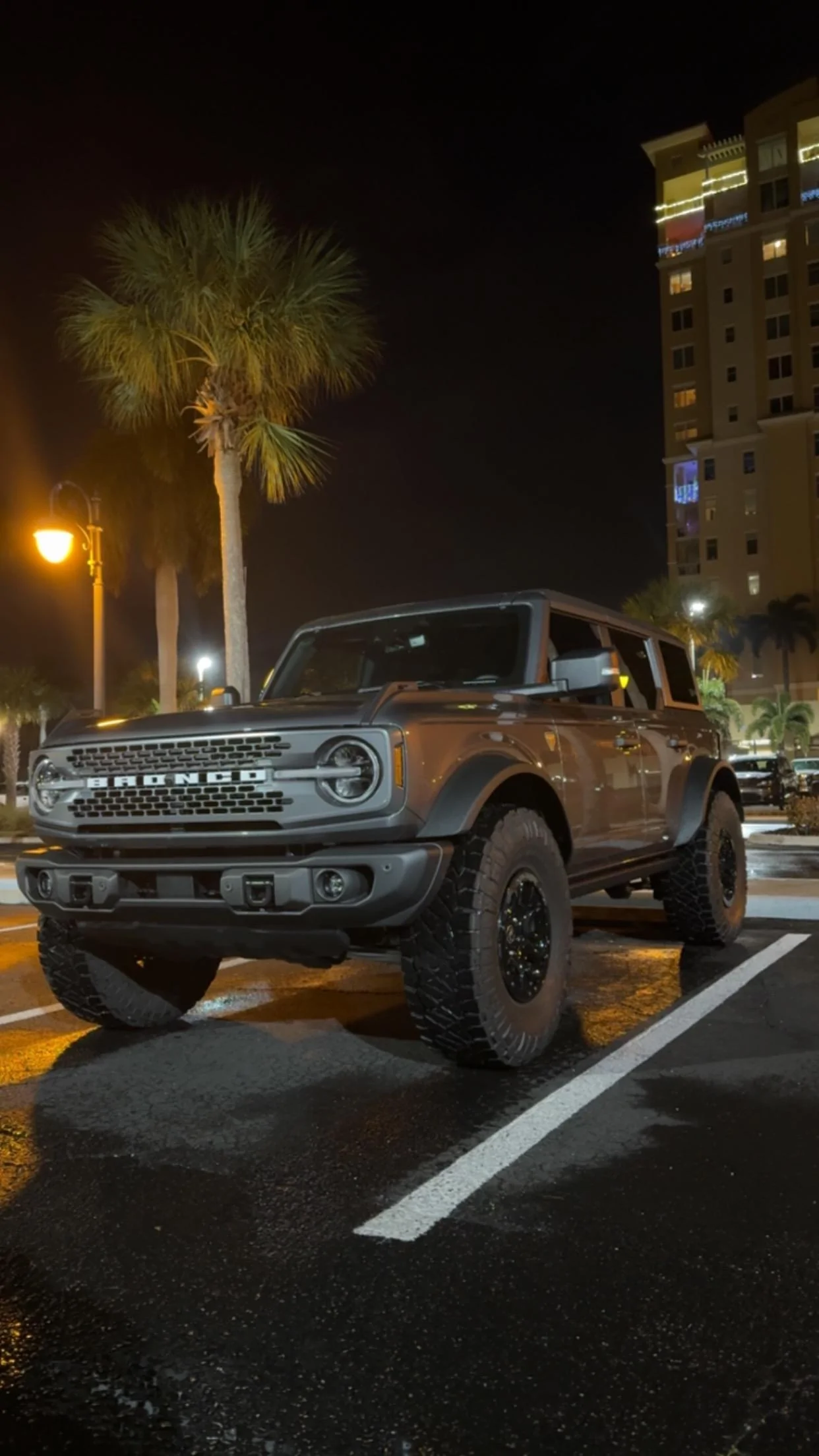

Bone Stock 23 Badlands SAS, 37/12.50 Nitto Ridge Grapps. Slight rub at full lock on inside frame rail Nothing Major at all IMO. Wife everyday drives it randomly drives over curbs among other things. I like the Stuffed tire look personally. Works for us.
