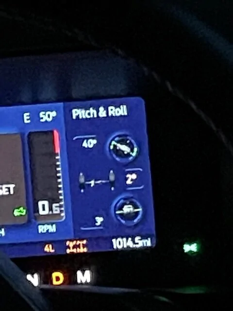

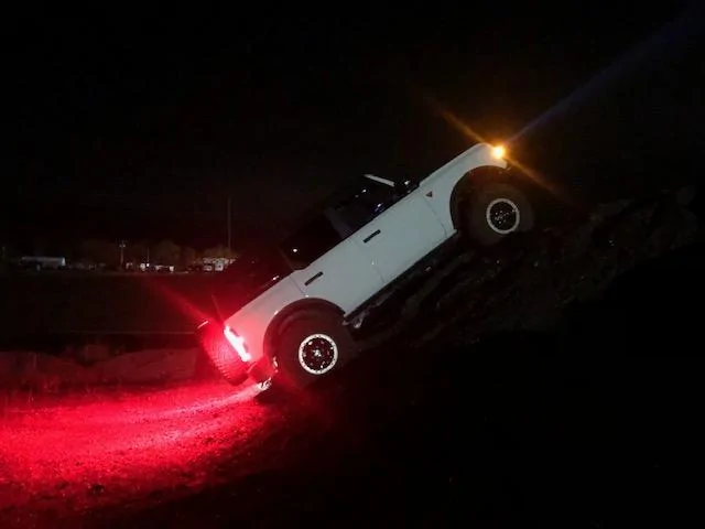

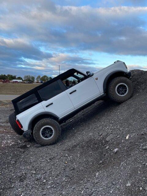

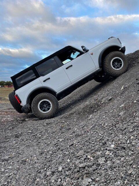

BTW pics don't do it justice.
The night pics we got over the hump. We backed up a little and maxed out at 42deg didn't get a pic but did at 40deg. We did the day playing using brake but the night riding we tried the One petal) dude it worked great like stupid how cool it worked. Also just a normal going up and stop when it starts spinning no extra speed to get on up was 37deg but when I turned it around and had nose down it only showed 33deg. When I went nose down also the spare just did touch the dirt right at the bottom.

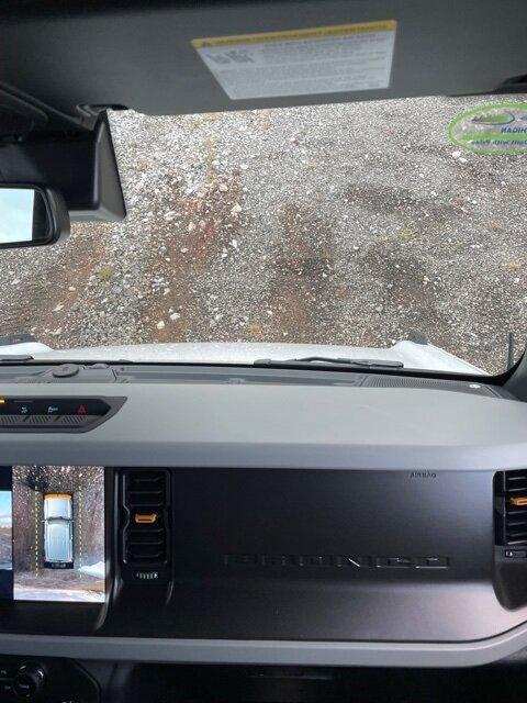

Day time playing nose up.
Ford Bronco 37x12.5r17 KM3s Sasquatch Badlands No Lift/Build Thread IMG_1341
Ford Bronco 37x12.5r17 KM3s Sasquatch Badlands No Lift/Build Thread IMG_1342
Ford Bronco 37x12.5r17 KM3s Sasquatch Badlands No Lift/Build Thread IMG_1347
Ford Bronco 37x12.5r17 KM3s Sasquatch Badlands No Lift/Build Thread IMG_1352

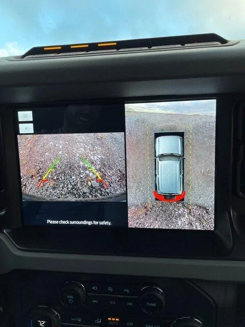

Nose down
Ford Bronco 37x12.5r17 KM3s Sasquatch Badlands No Lift/Build Thread IMG_1353
Ford Bronco 37x12.5r17 KM3s Sasquatch Badlands No Lift/Build Thread IMG_1354
Night riding again max was 42 but when we thought about taking pic got one at 40deg. If you look close it shows the truck in green the goal was to see red. (Anyone know at what deg it will turn red)

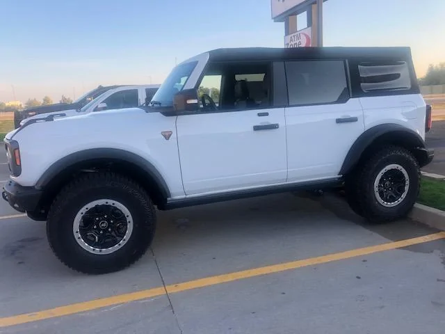

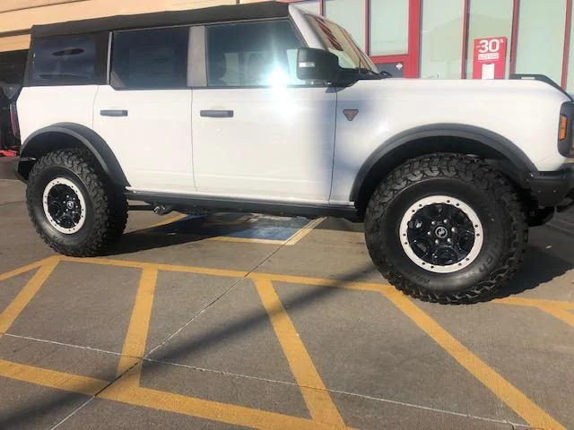

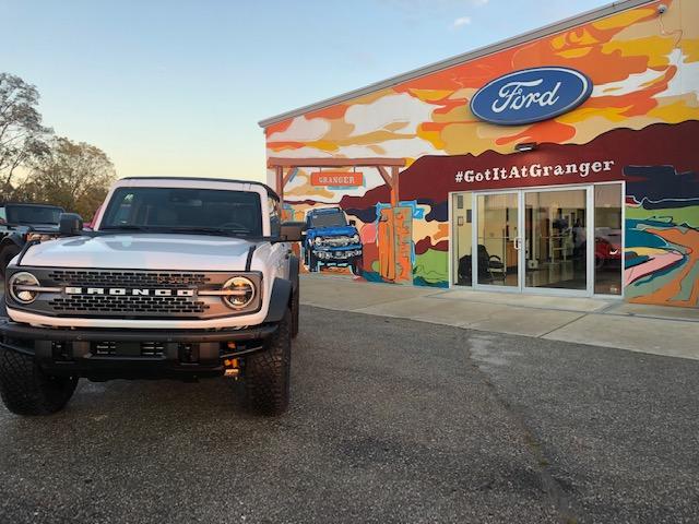

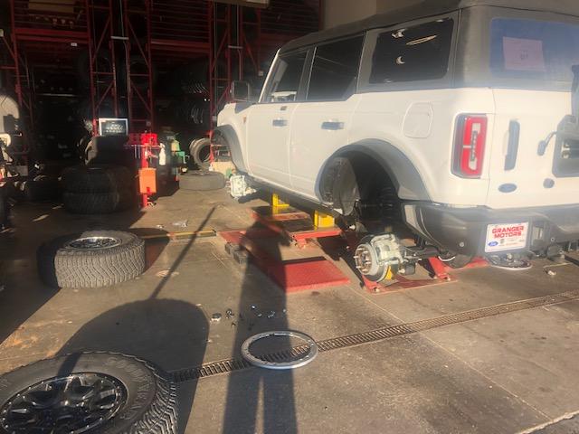

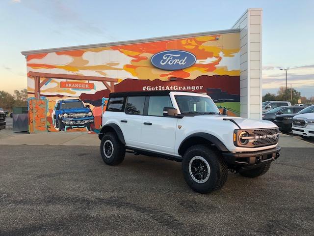

This will be my build page so will update as I add to my ride. (2021 Badlands, SaS, Lux, Leather, Tow)
Picked up at Granger at 6pm last night drove to OKC and added 37s at 9am this morning 600 miles on her.
No lift, No 3rd light extension, 40psi tire pressure

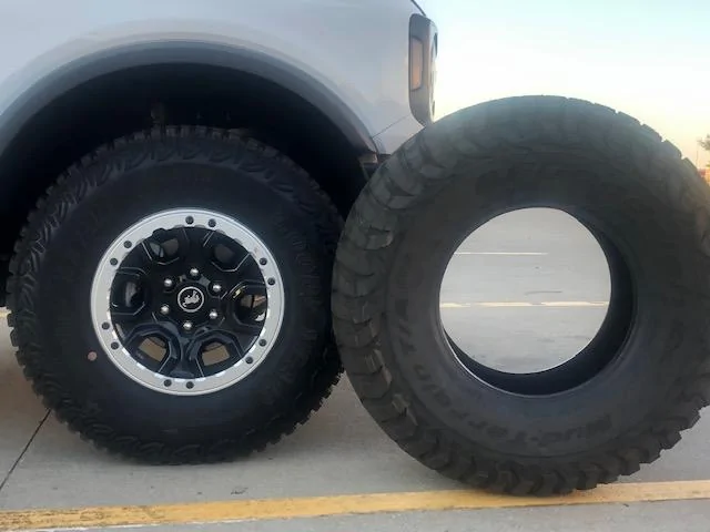

35s vs 37s
Ford Bronco 37x12.5r17 KM3s Sasquatch Badlands No Lift/Build Thread IMG_8226
37x12.5r17s (Really 36.5in tire)

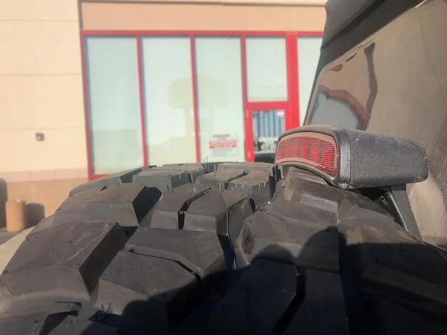

Tail Light (No extension) 40psi tire pressure

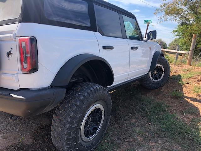

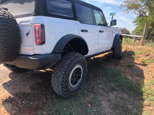

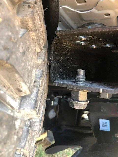

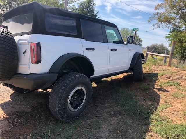

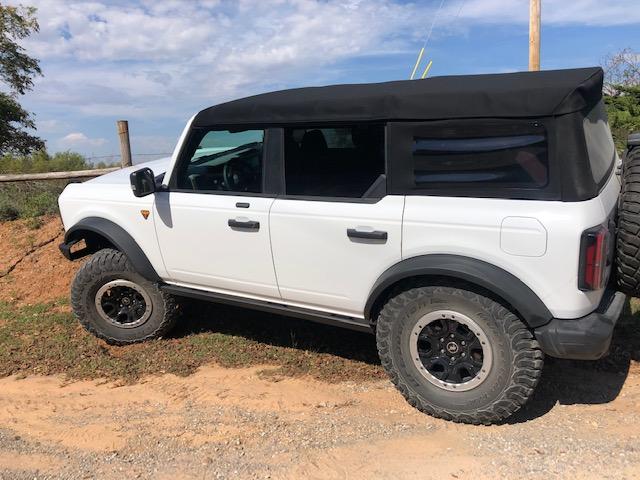

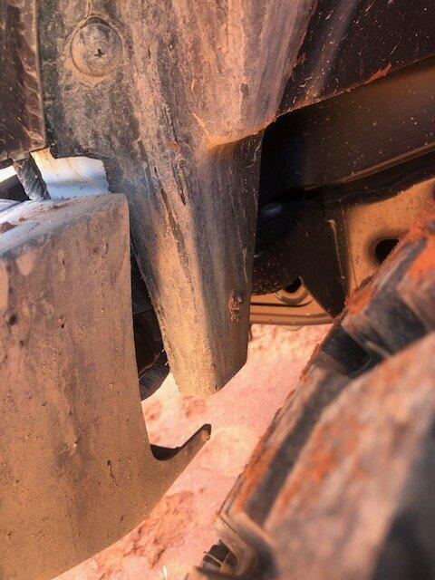

Testing the 37s (Swaybar discontinued and Back tire just off the ground)(40psi tire pressure)
It was super tight as you can see but you also want be running 40psi tire pressure, in the real world I may end up grinding just a little off the tips.

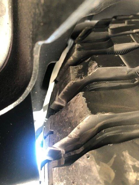

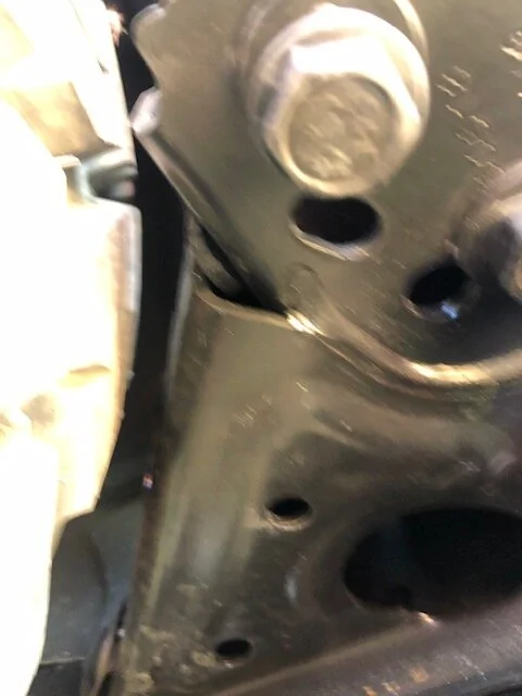

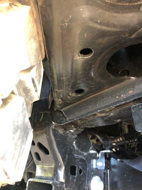

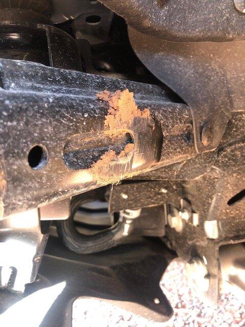

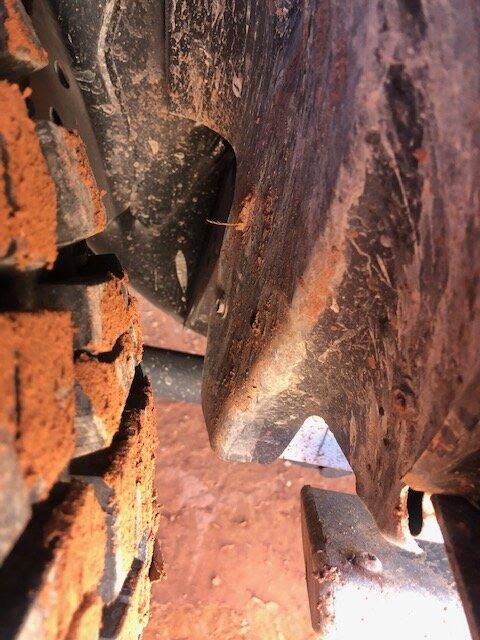

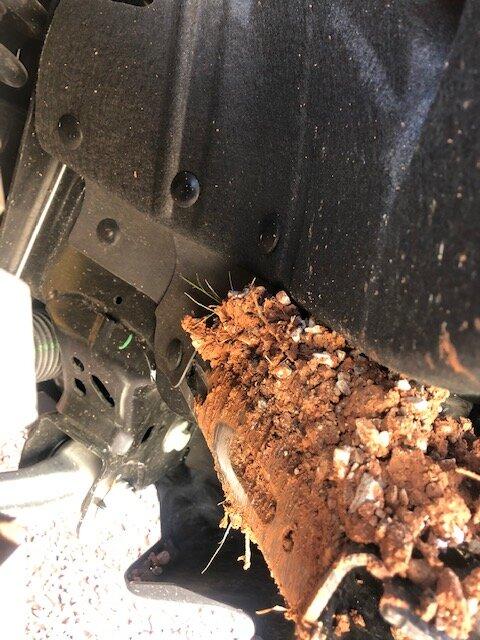

Got up this morning went to check out the Bronco and found it did rub. Let me be clear this was so little I couldn't feel it in the steering wheel at all. I really think it was the mud and not the tire but regardless it rubbed the paint off. I will be cleaning repainting and adding a 6mm spacer from post #25. One little spot in the back that a zip-tie will fix. (See pics for details) Keeping this real this really is over kill to even care to fix. This has 100% no effect on Performance at full articulation more less daily driving. Its just me tinkering like I like to do.
If your that guy that is like it rubbed TROLL on my friend. Lift your ride (spend $1000s) kill your center of gravity so you can say but it doesn't rub. Let me know when your ready and we can test them both out I'm not scared.
As you can see it looks like it didn't rub but more the mud acted like sandpaper.
Ford Bronco 37x12.5r17 KM3s Sasquatch Badlands No Lift/Build Thread IMG_8250
Ford Bronco 37x12.5r17 KM3s Sasquatch Badlands No Lift/Build Thread IMG_8251

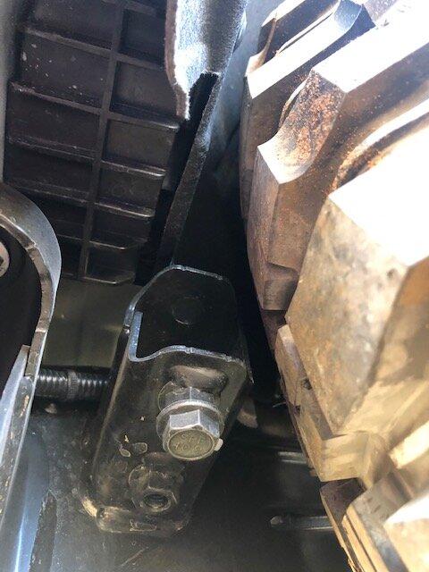

The rear if you look close you can see a few small marks on the plastic (at the very bottom) again this looks more like mud did it. But this is different than the front. The front is metal so it want hurt a thing but if it catches this plastic just right it could rip it. So I will drill a small hole and zip-tie it back to make sure that doesn't happen.
Ford Bronco 37x12.5r17 KM3s Sasquatch Badlands No Lift/Build Thread IMG_8252
Ford Bronco 37x12.5r17 KM3s Sasquatch Badlands No Lift/Build Thread IMG_8253

Hard to tell from pics. Is that bar on the front the mount for the crash bar? I noticed in the first pics the mount was still close, and I'm thinking just cut the crash bar mount off since crash bars will never go back on. That's what I'd do on mine personally.
