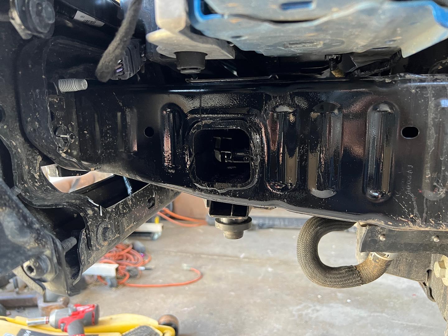

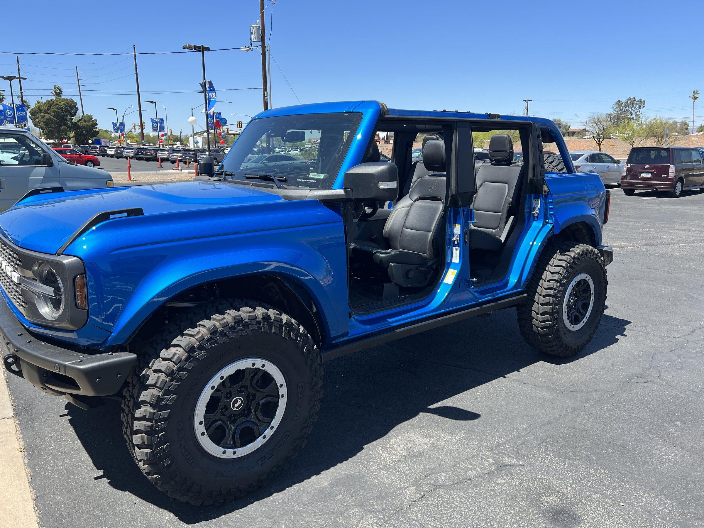

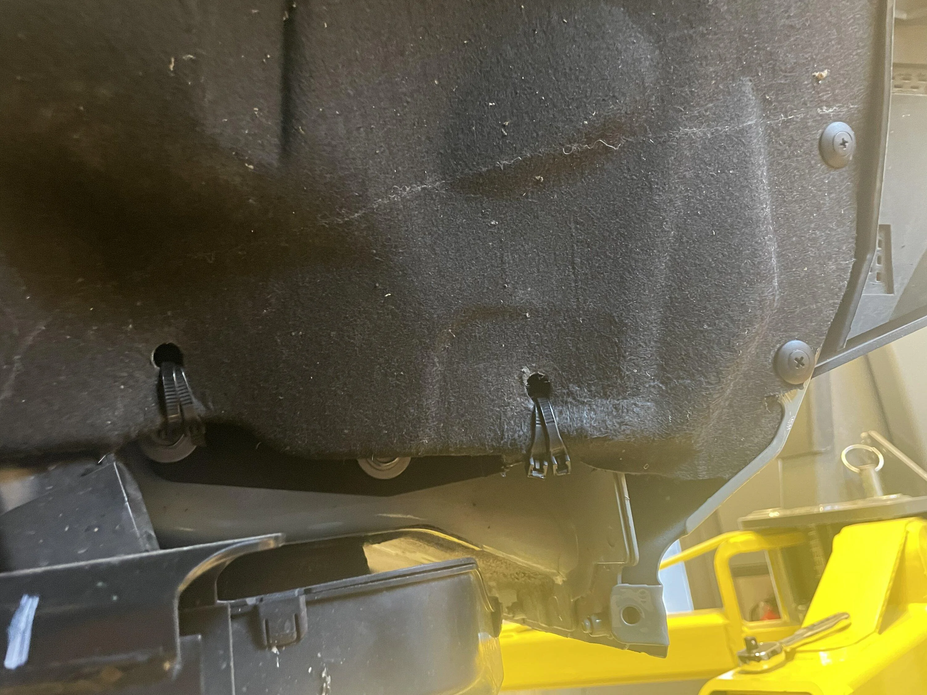

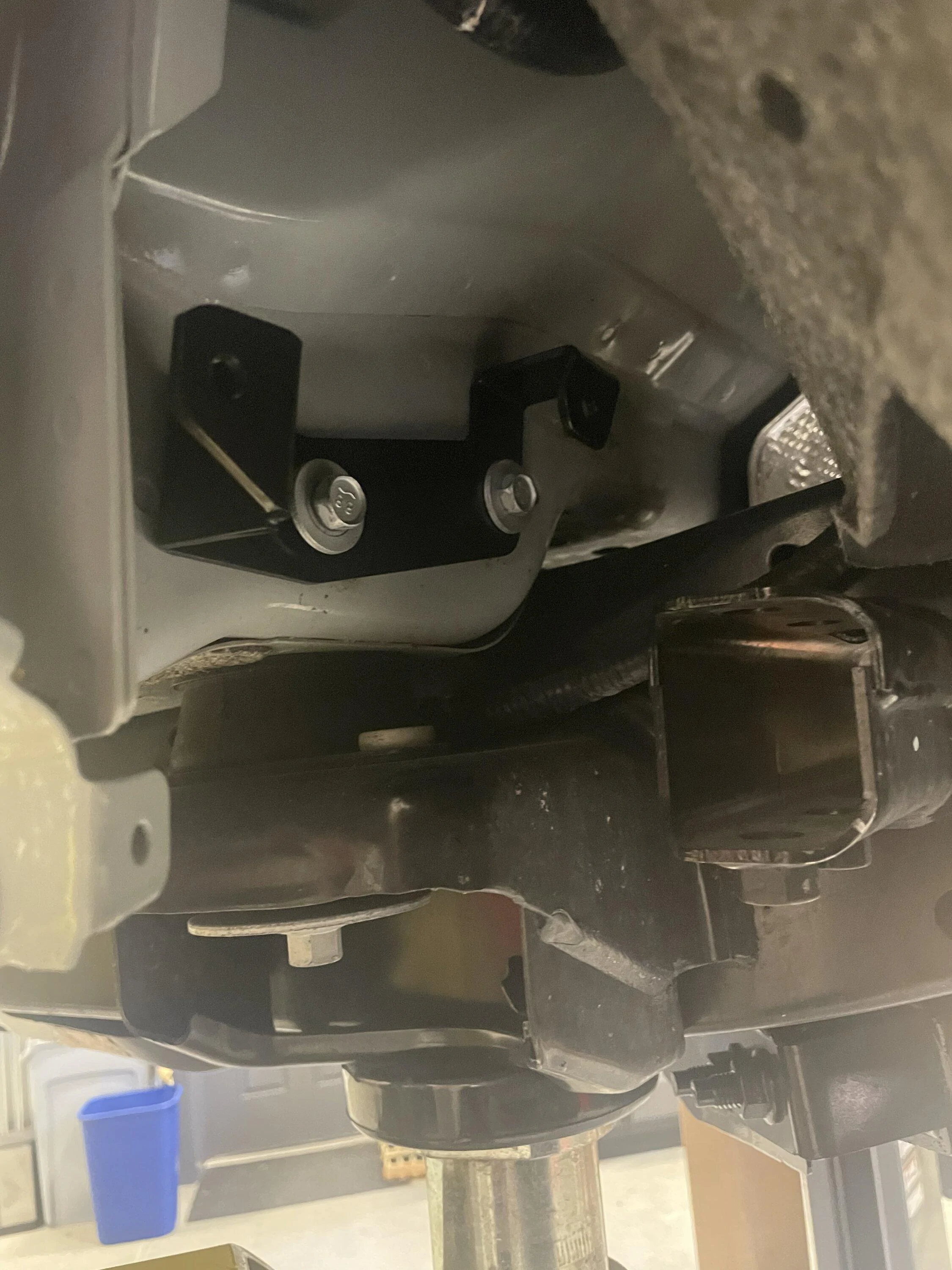

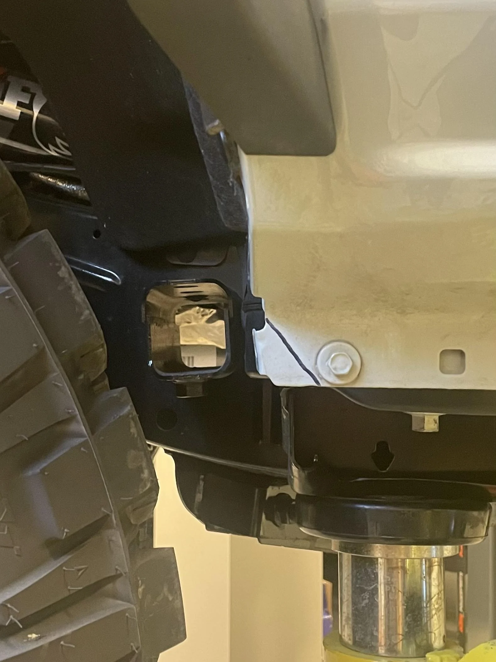

great thread. I have 37x12.5r17 Mickey Thompson Baja Boss MT's on stock Sasquatch wheels and suspension. The only thing I have done is the Big Tire Clearance kit. I also have AdV Fiberglass quarters all the way around. The only rubbing I have is at full stuff and full lock the sidebiters on the tires hit the frame. I also had to pull back the fender liners and zip tie them so that they wouldn't get rubbed.
Is there more clearance with the ADV fenders? Do you think it would rub more with factory fenders and Sasquatch flairs?
The ADV fenders are supposed to be 2” up and 2”out. But I think that is off of nonSasquatch flares. So there may be a little more room but not much

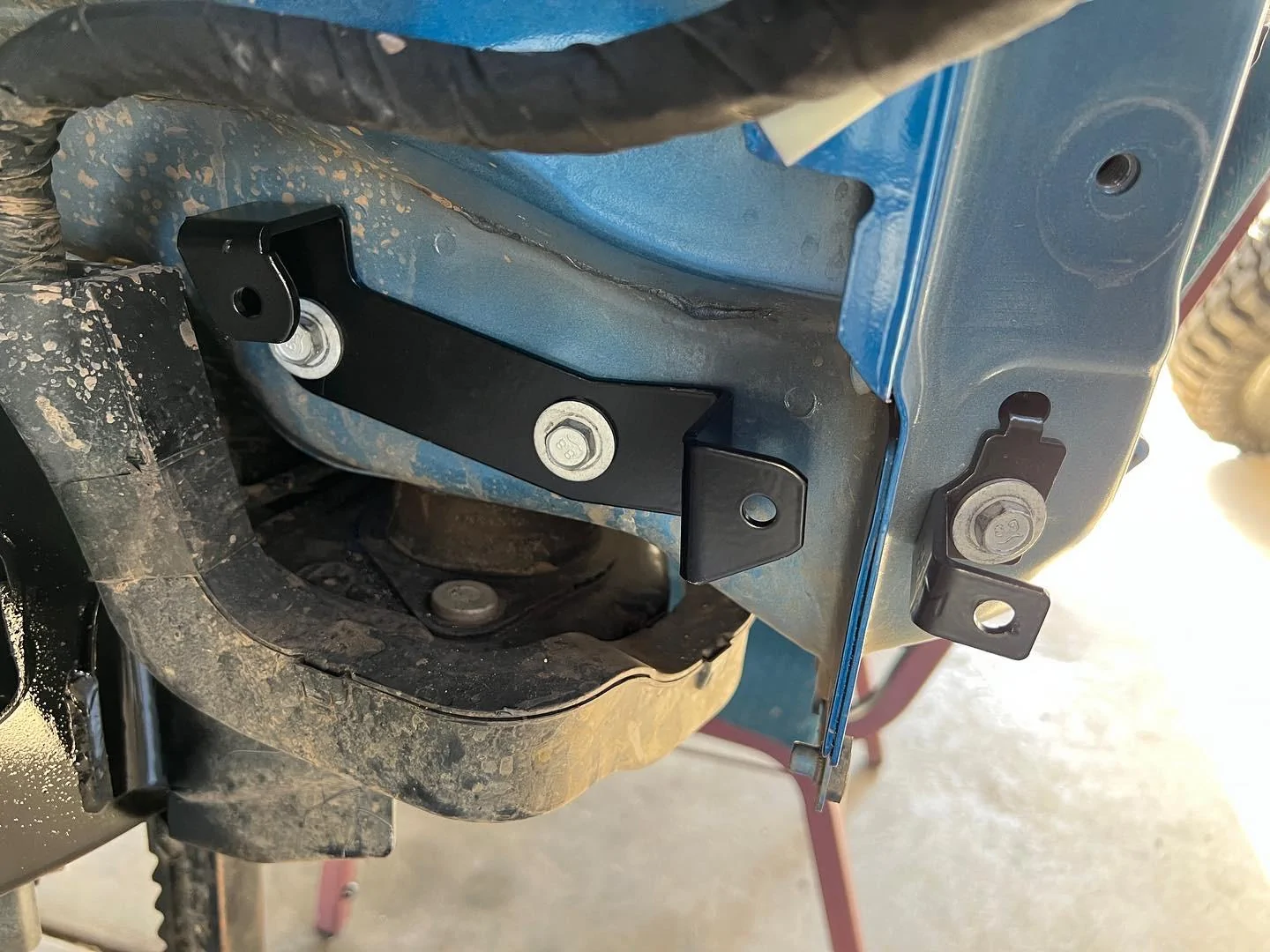

Great pics thanks ! I’ll be cutting the crash bars this weekend.
Your Truck looks rad with the fenders … that’s quite the project.

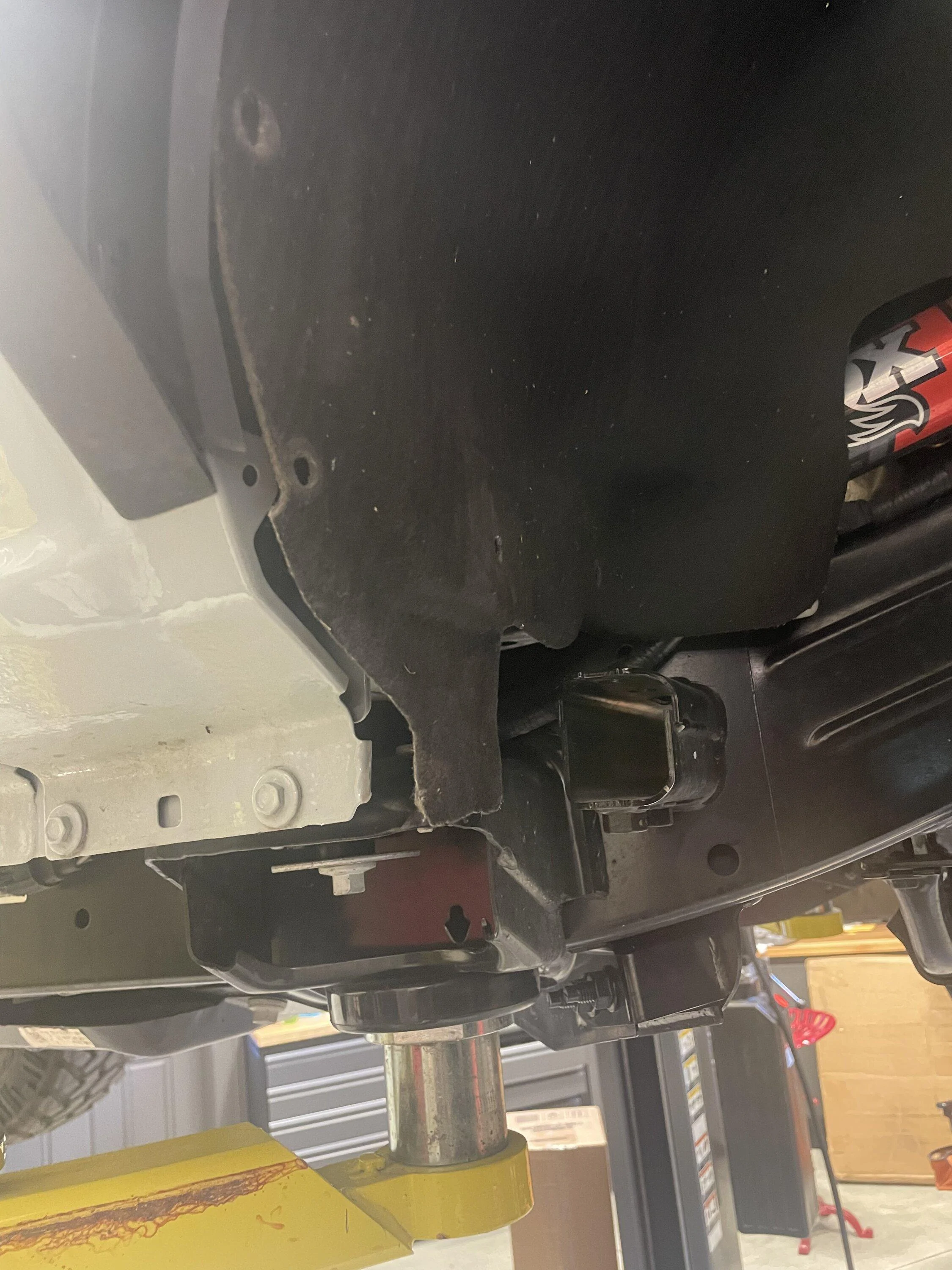

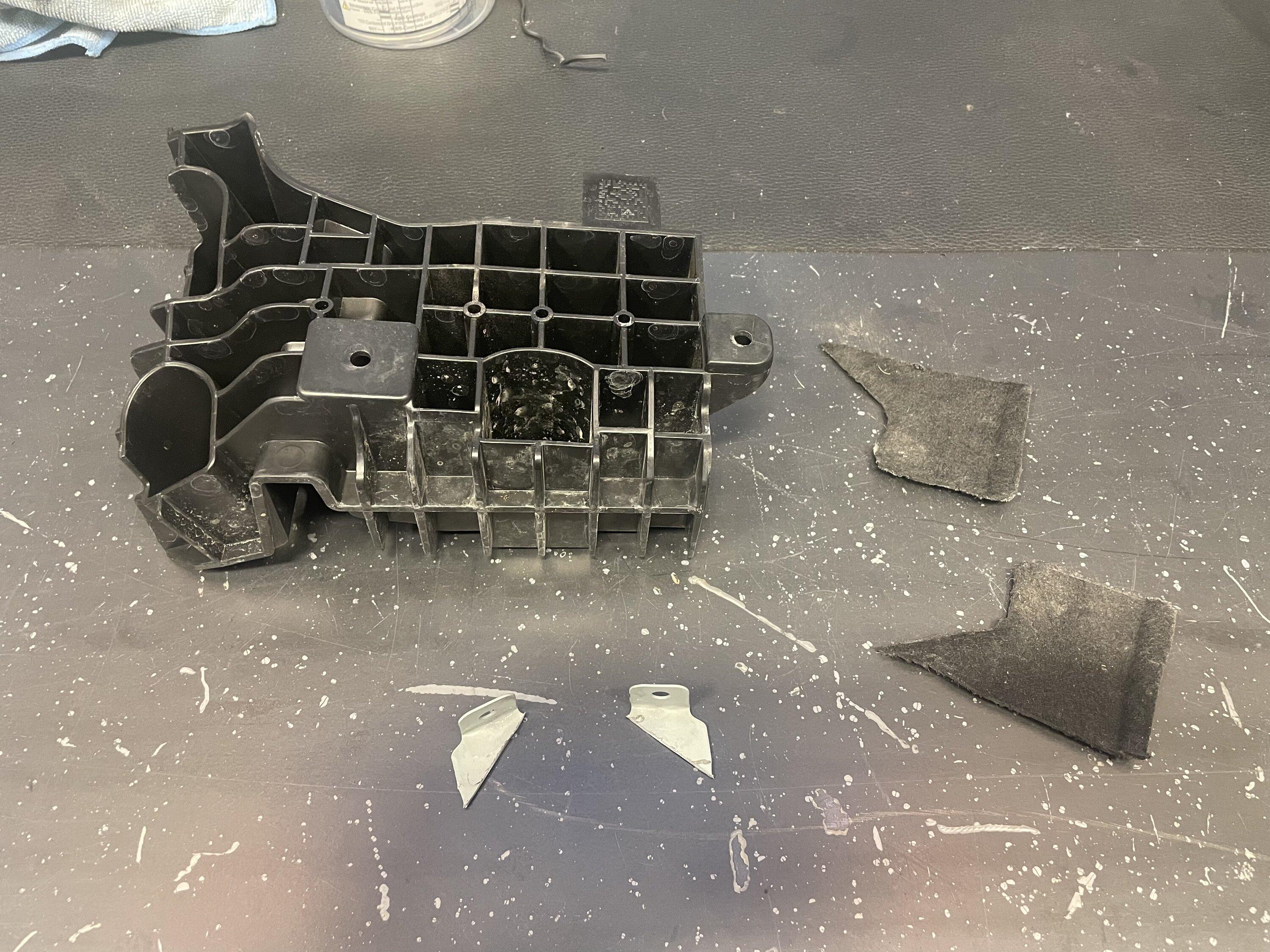

Did you completely remove the plastic block that is behind the liner on the back side of the wheel well ?
Rockdawg84
Sam
Feb 12, 2021
185
396
Tucson, AZ
98 4RUNNER, 96 F350 CC 4x4
thanks I'm loving it. Yes the max tire kit comes with a bracket that replaces the plastic block (see last photo). the suggest using push pins to hold the liner back but I found that zip ties are more secure.

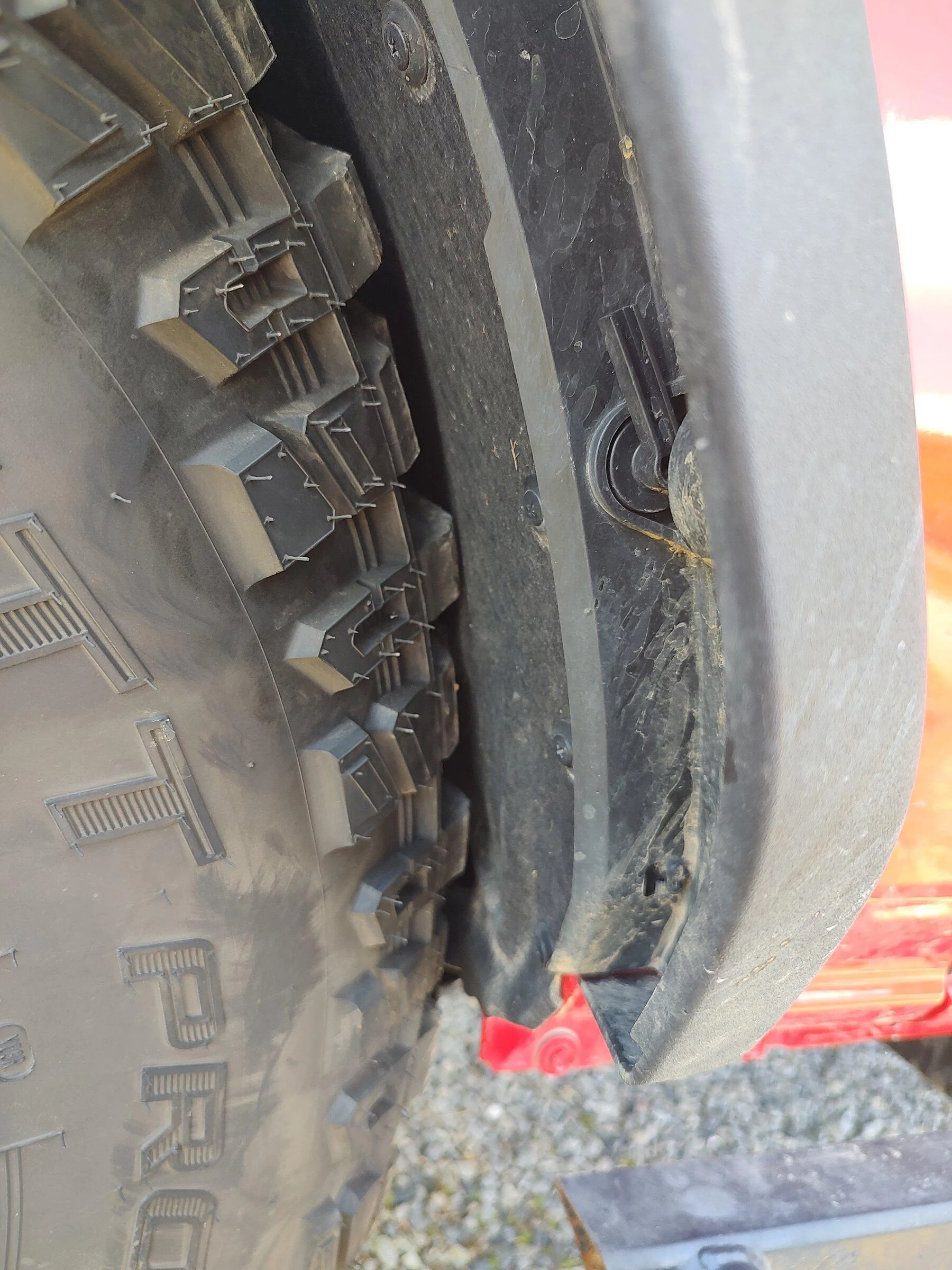

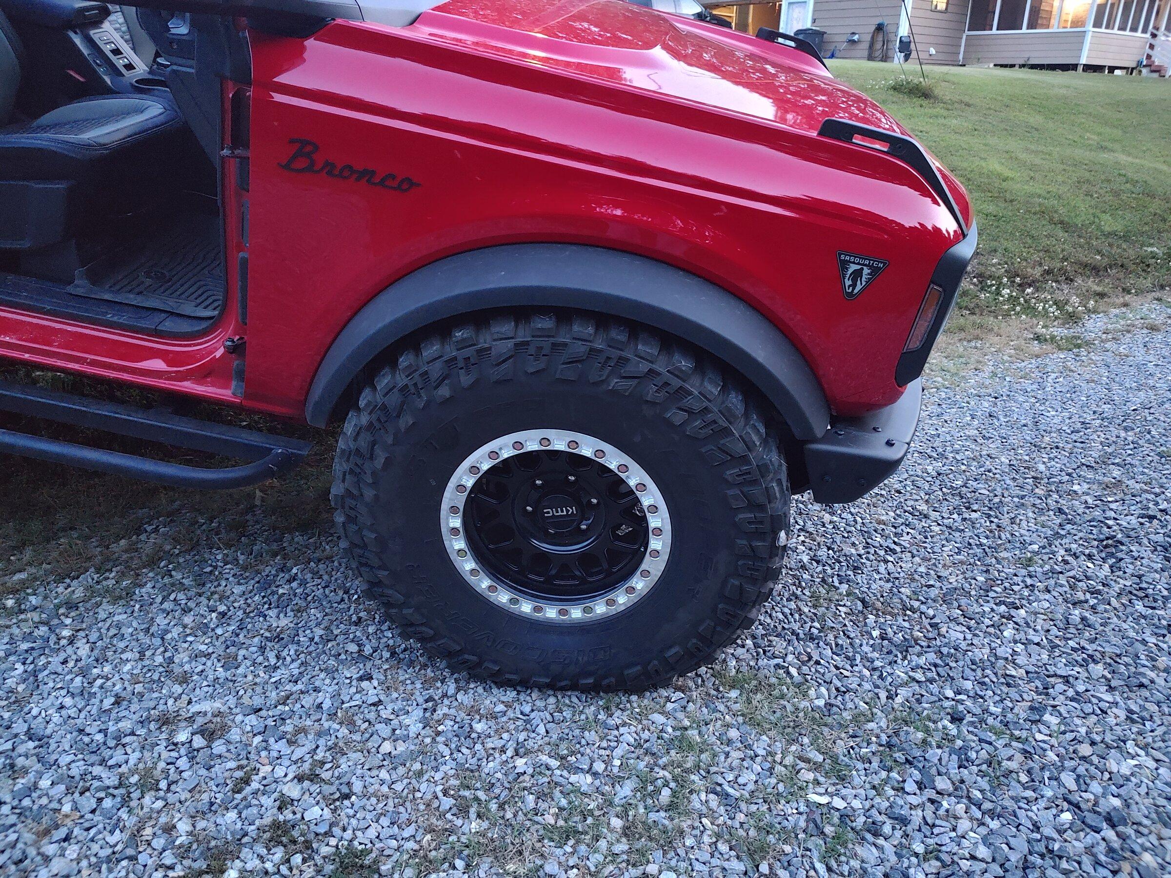

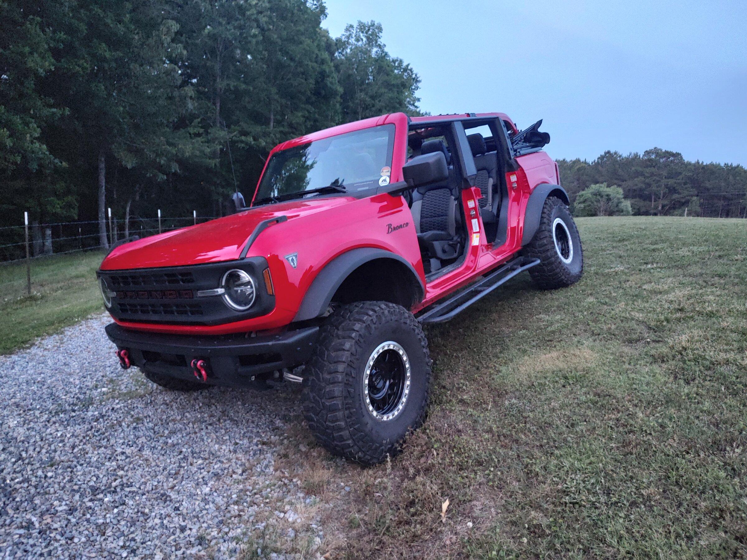

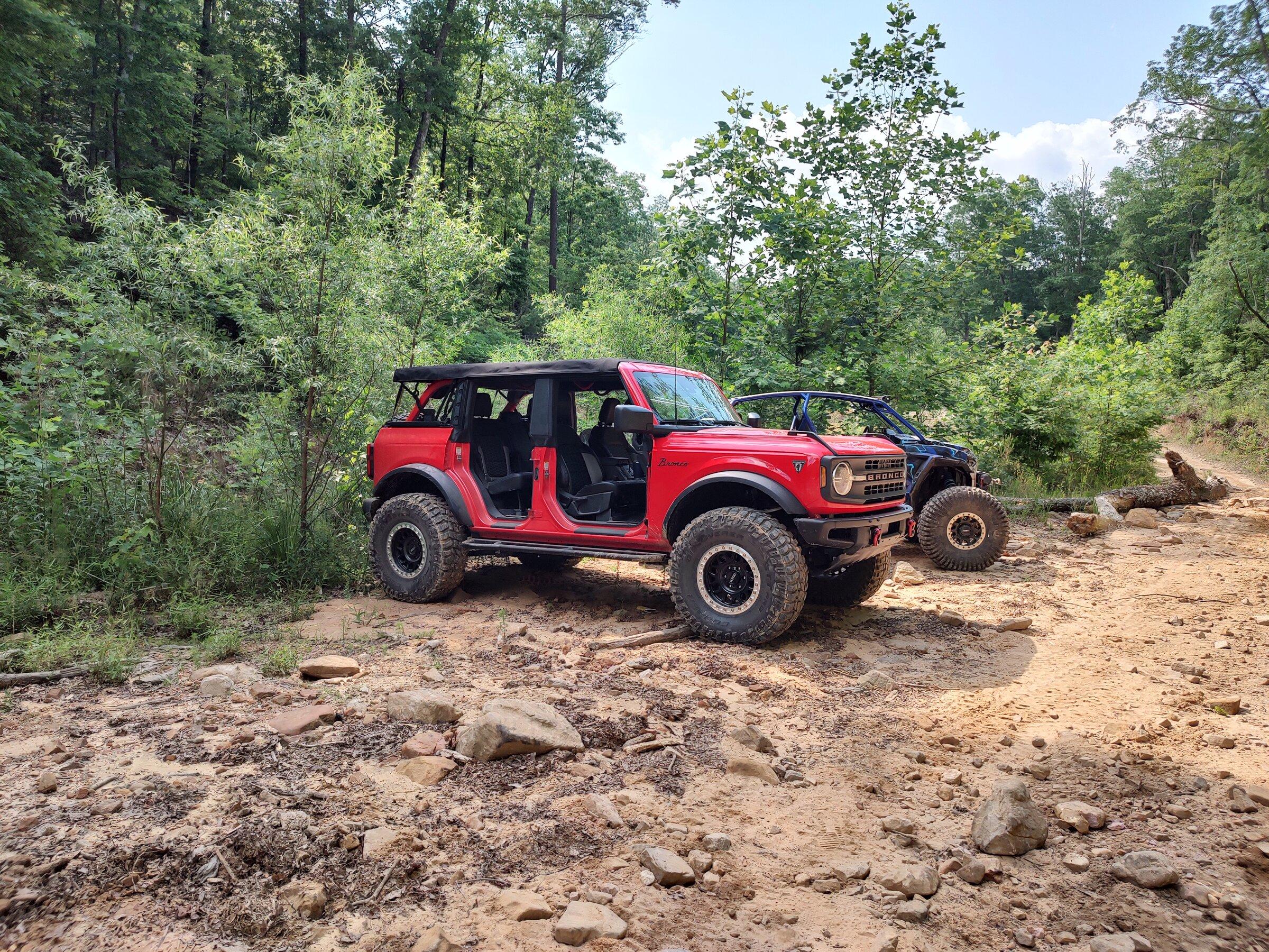

Just thought I would throw some pics in here.
22 Basesquatch
37x12.50r17 Cooper STT PROs
17x8.5 0mm KMC Grenade Desert
Icon 3" spacer lift(waiting on icon UCA)
JKS max tire clearance kit
Front sway bar removed
Ford Bronco 37” tire rubbing modifications IMG_20220521_093313208_HDR
Ford Bronco 37” tire rubbing modifications IMG_20220515_195148420_HDR
Ford Bronco 37” tire rubbing modifications IMG_20220515_195123597_HDR
Ford Bronco 37” tire rubbing modifications IMG_20220515_141748521

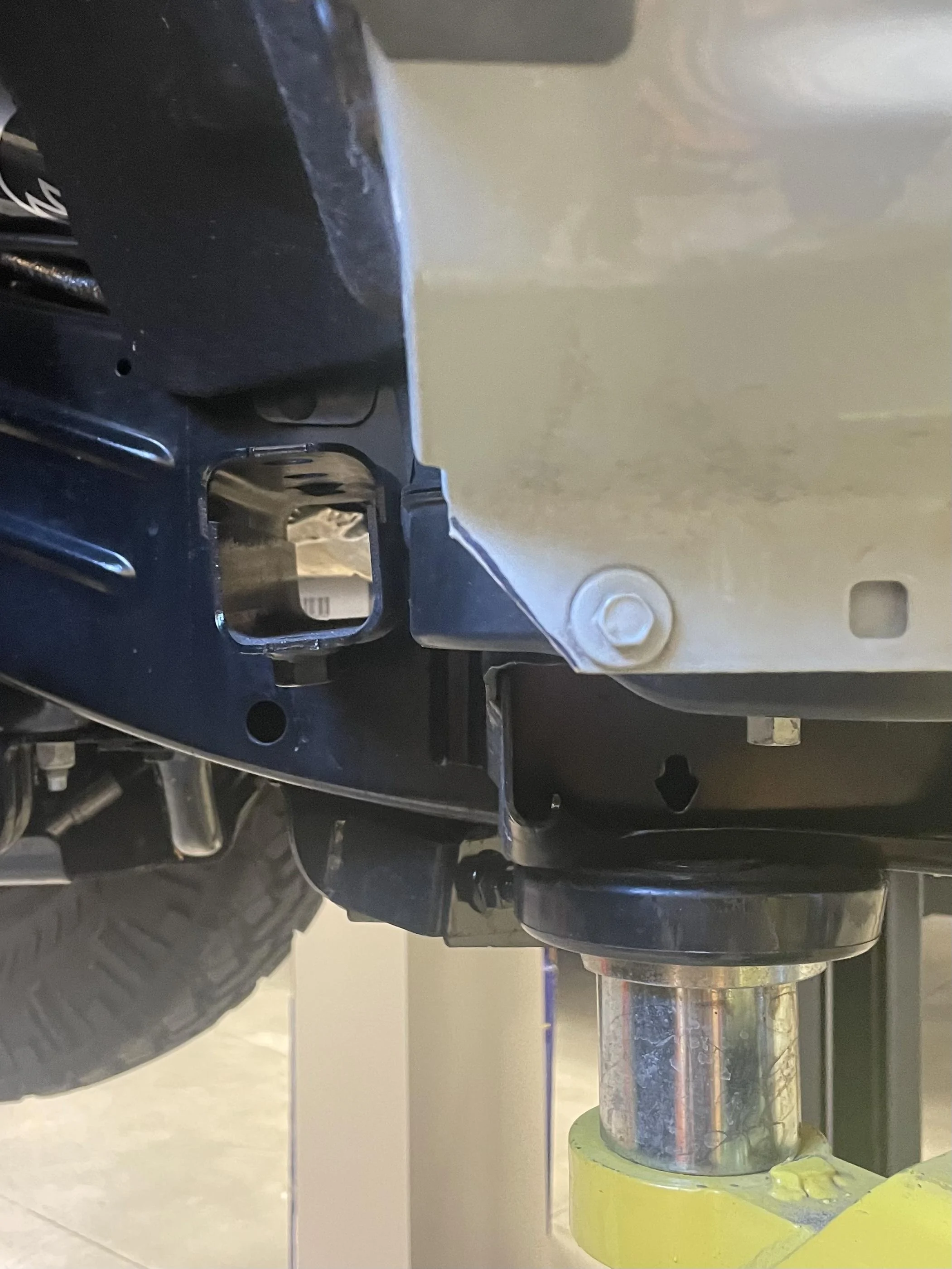

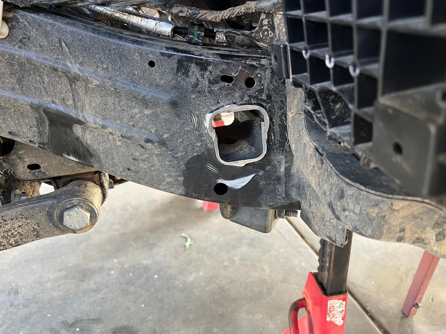

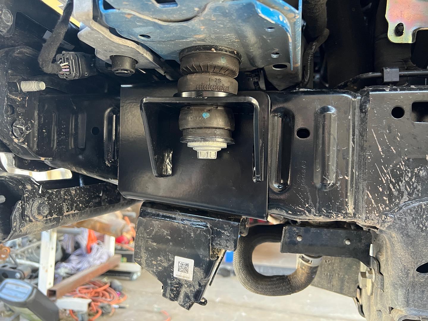

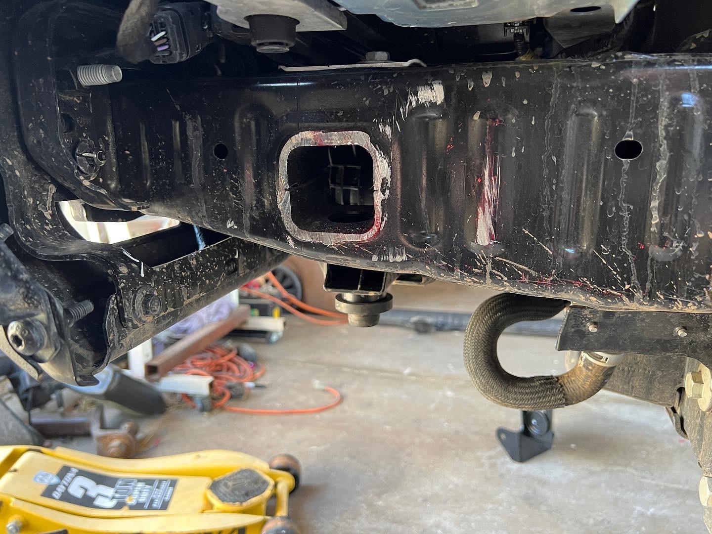

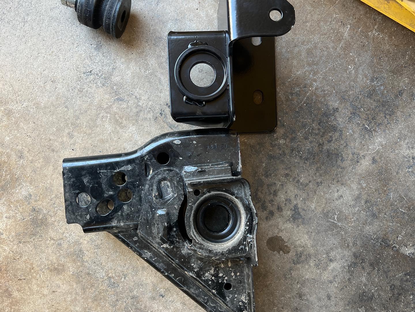

The only thing I don't like about this kit is having to cut the front piece off. I like the fact that allows a lot of clearance but worry about the strength of having the mount just bolted on to the side of the frame vs being a part of the frame. Probably worry too much but just something that worries me.
Did you think about the 4WP big tire kit?
The new body mount is a seriously solid bracket with angular supports that wrap over the top and bottom of the frame. IT's beefy and didn't seem to me in anyway to be a strength issue.
The big tire kit replaced the crash bars. The kit I installed removes the part of the frame that the crash bars slide into. On my sasquatch package Ford didn't even supply the crash bars because the 35's would rub, so the crash bar mounts are just in the way.
Felix808
55
4,890
10,449
SRV CA
Yep, & you are not really even cuttings the "Frame" no loss in frame strength , you are cutting brackets off of the frame for those concerned ;) That big goby bracket has a small amount of mounting surface vice its size.

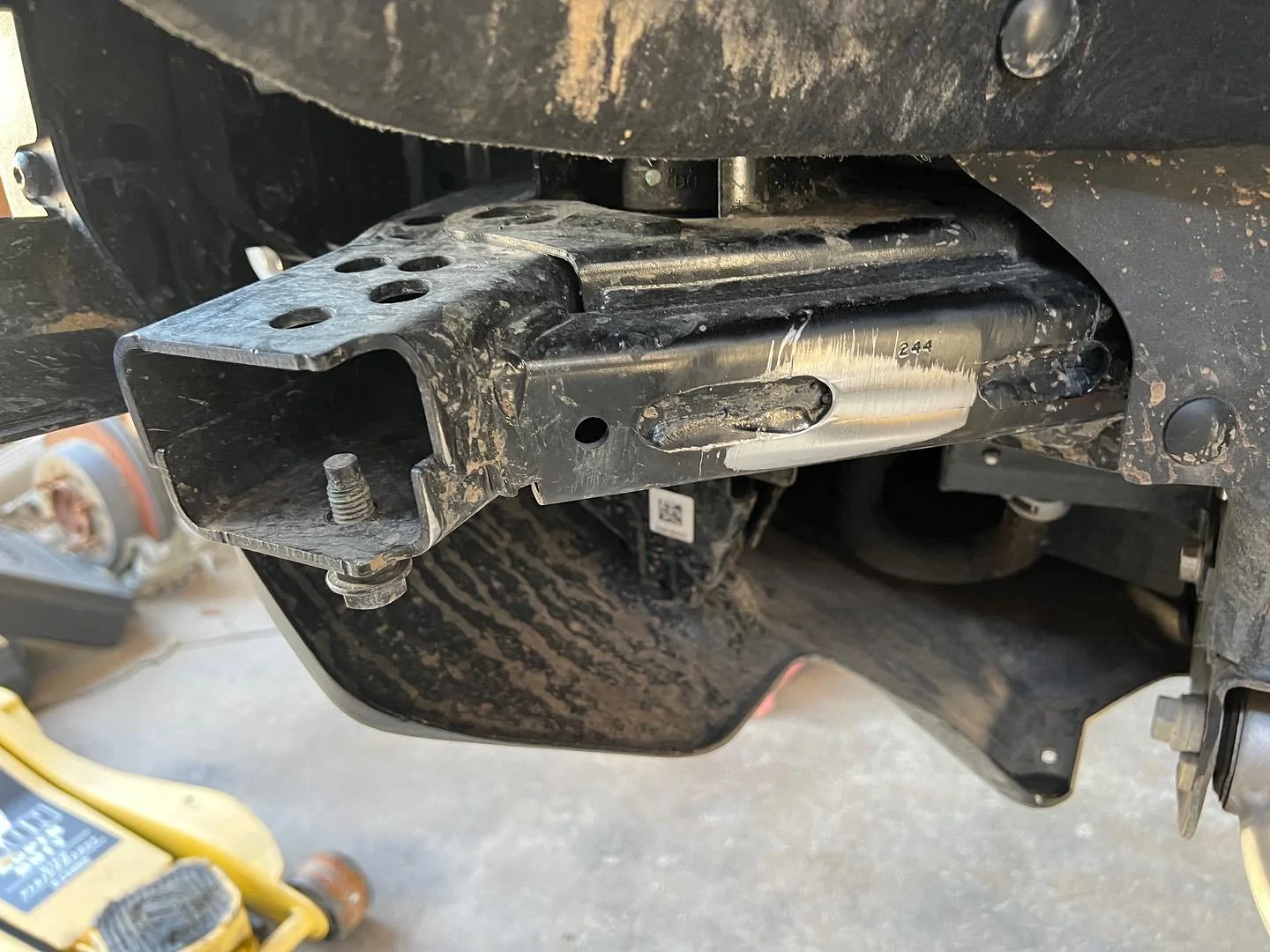

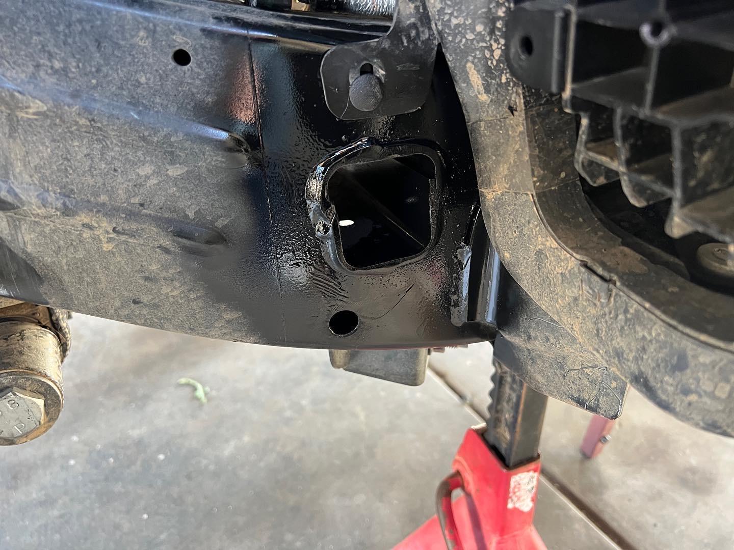

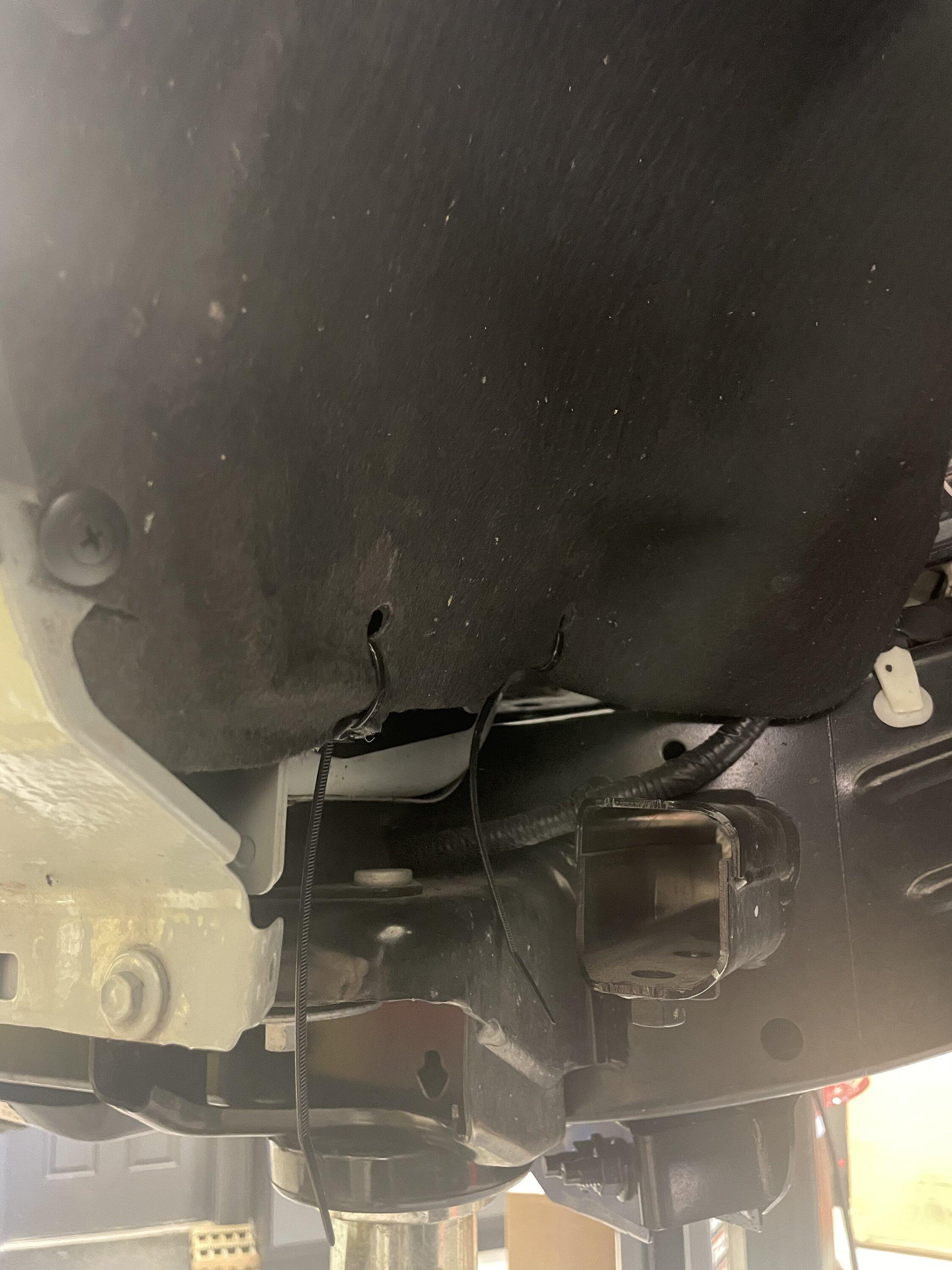

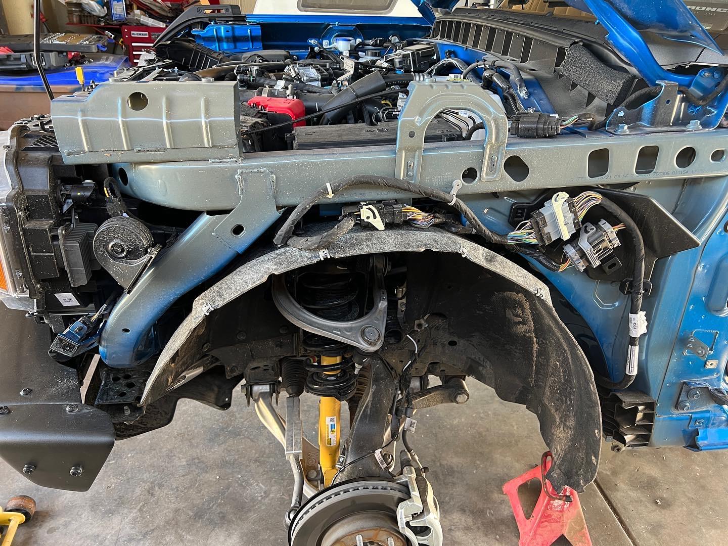

Making room for the 37s on the back of the front wheel well where it rubbed the fender liner. JKS Max tire kit includes the brackets to eliminate the big plastic block behind the liner so the liner can be pulled in.
I trimmed the bottom edge of the liner, and used zip ties instead of the plastic push rivets to secure to bracket. Also cut off the metal body corner.
