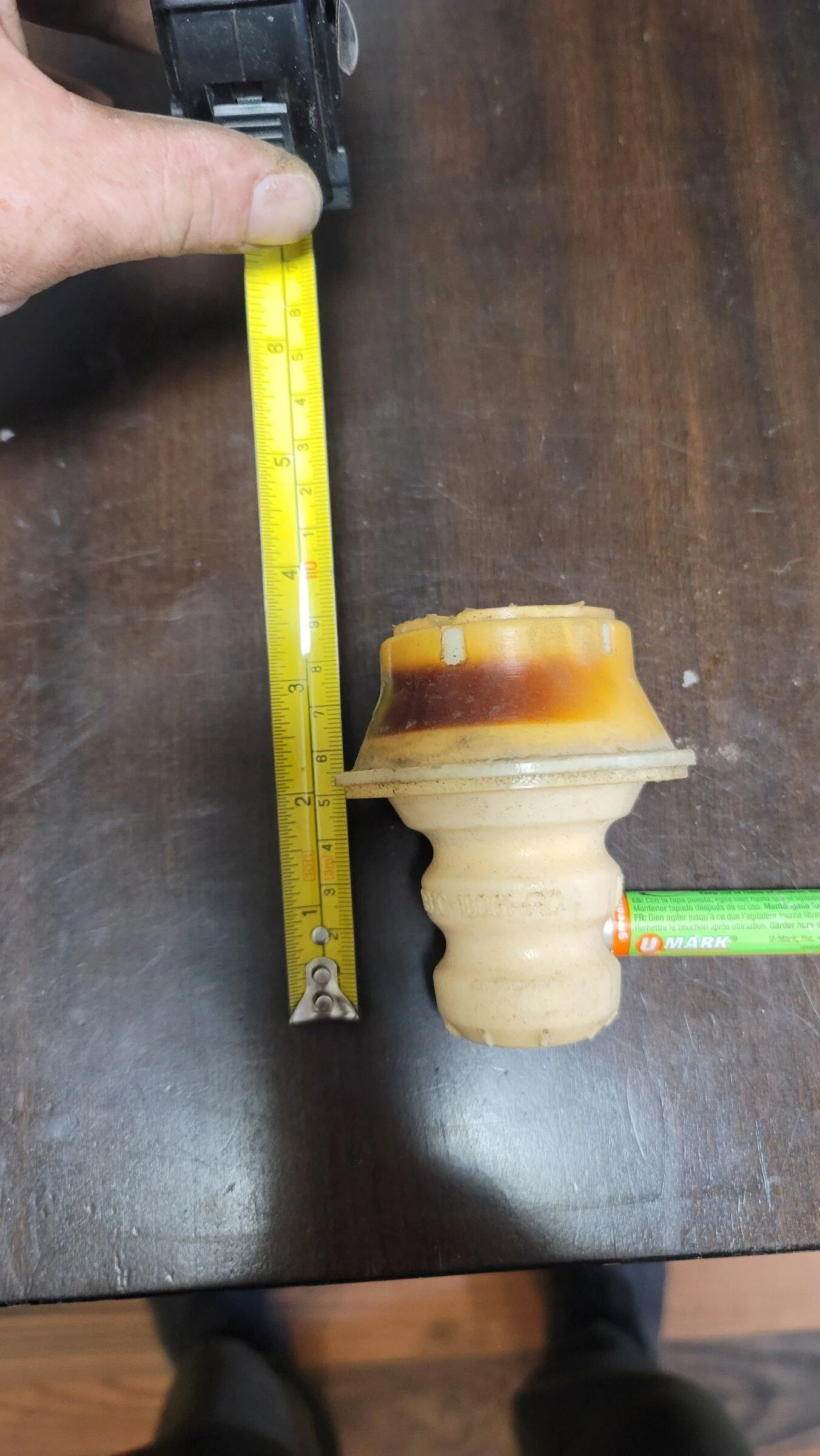

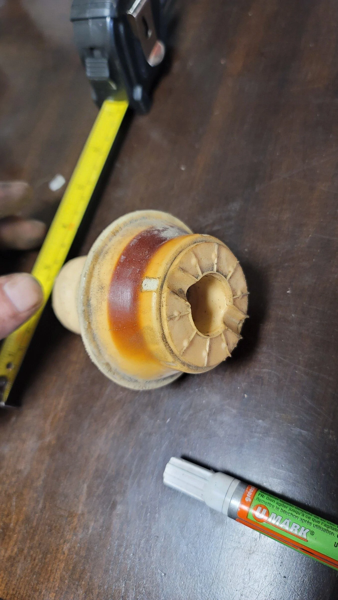

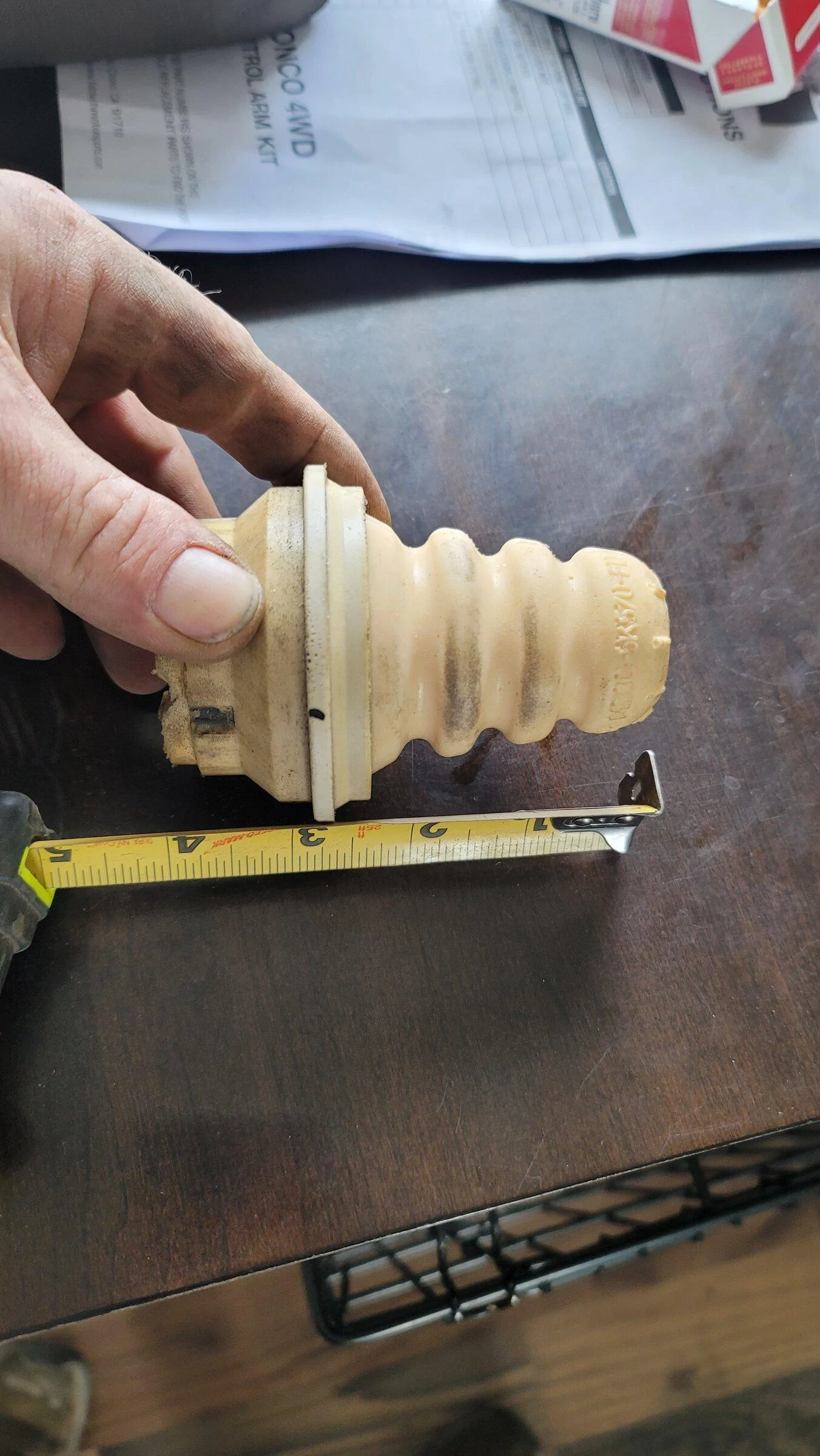

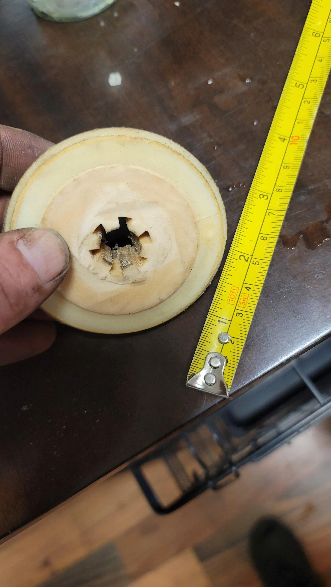

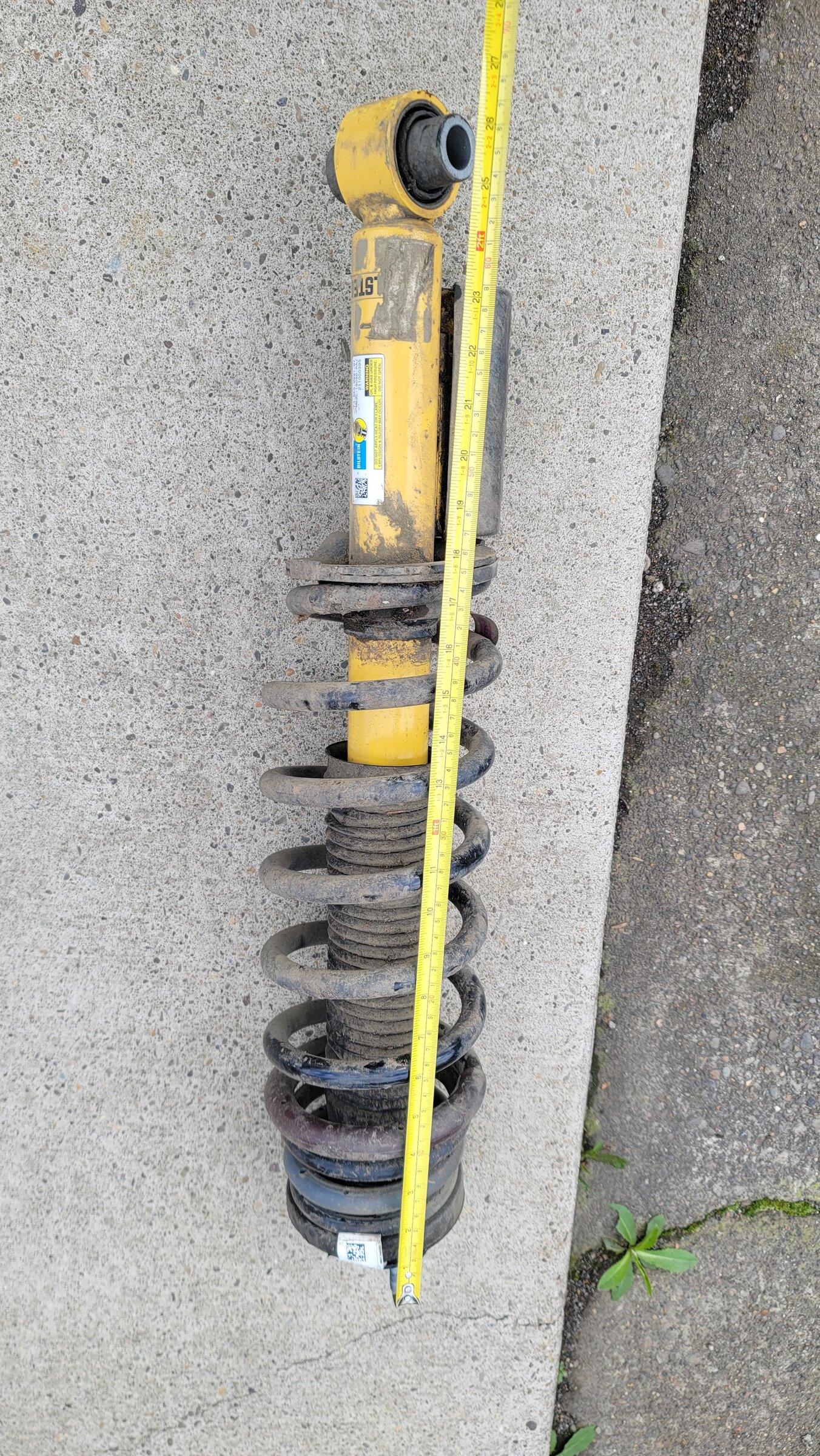

Finally got my fabtech UCAs, so I thought while I'm installing them I would pull the coilovers and see how much bump stop is really in there....
Here's some pics of the whopper.
I also took a pic of the overall length of the shock (for non-SAS Badlands owners to compare with)

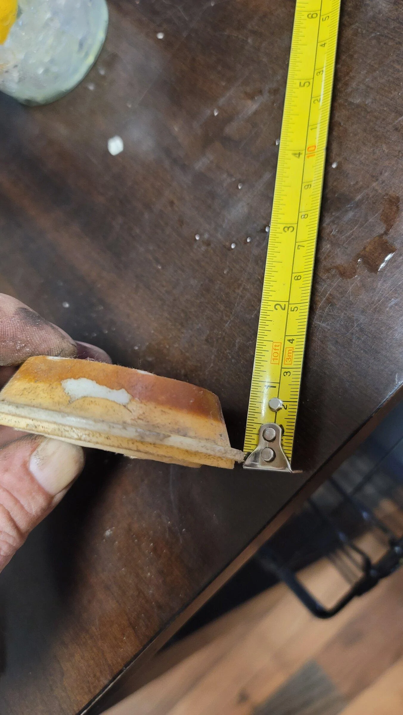

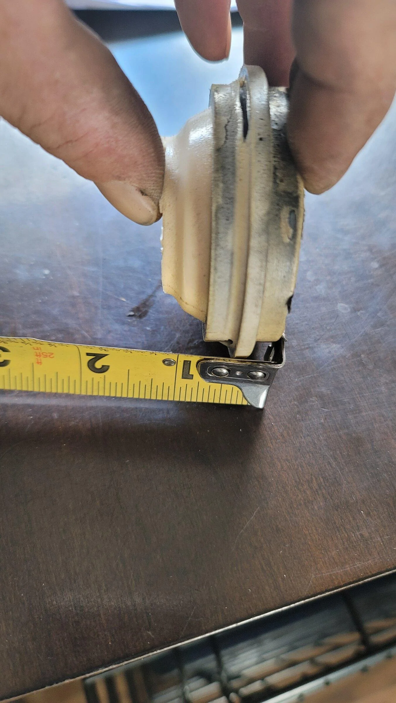

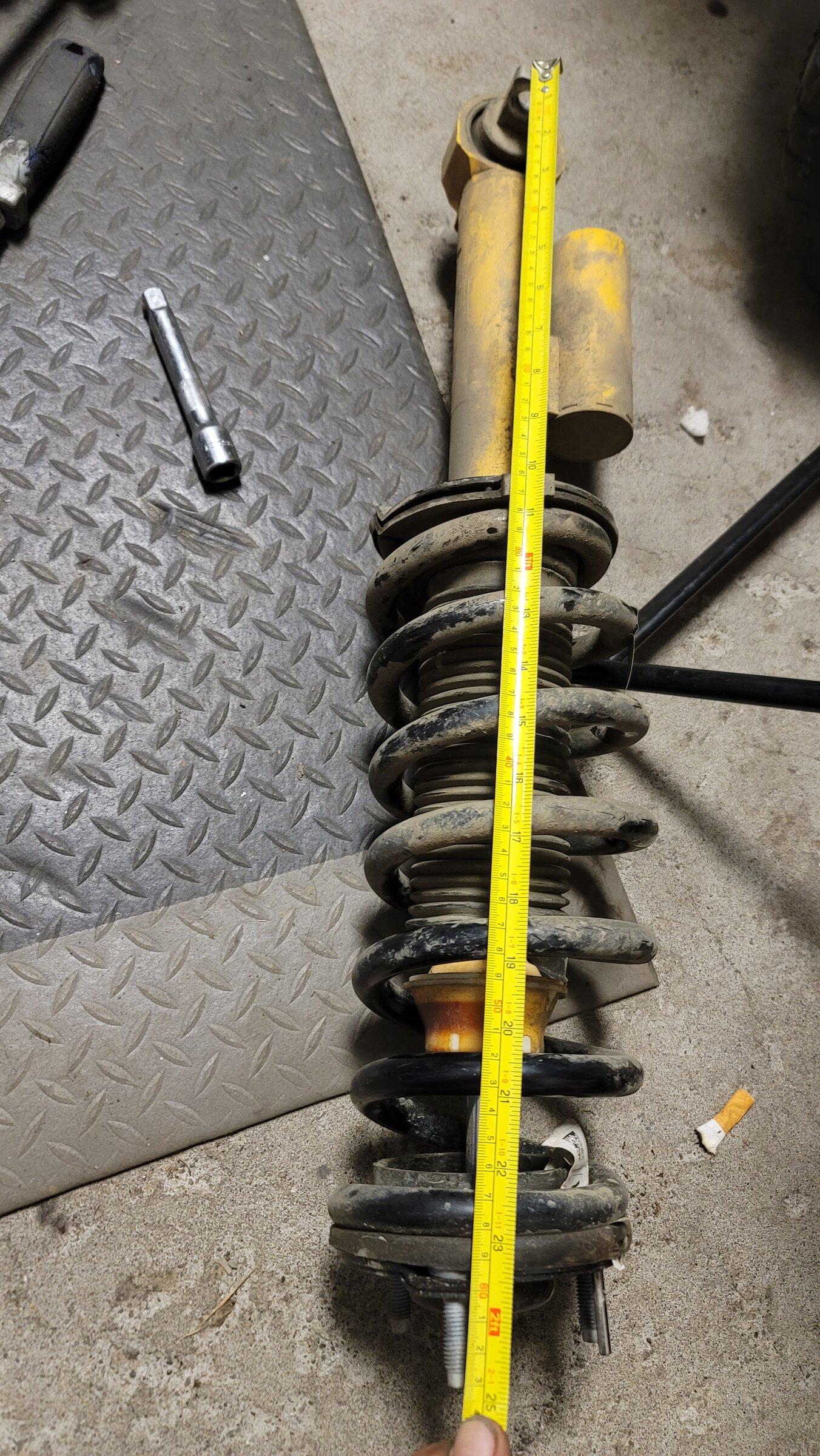

So after the realization that these bump stops are JUMBO....and also progressive in their compression resistance, I decided to trim nearly 3 INCHES off them and reinstall and see how that affects my compression...

After installing the coilovers with the new tiny bumps, I took it around the block to the loading ramp I use to check flex and articulation....
The result is an additional 2”+ of COMPRESSION travel!!!
I'm running 37s for now and my goal is to stuff 38s in there this summer. So I need about an additional 1.5” of clearance between the top of the tire and fender lip (where the flairs attach). With the shaved bump stops this would make my 37s kiss the fenders during full compression. I don't want that so...
I used fabtech leveling 1.5 ” kit on the top of the shock mount with the RC spacer at the bottom of the shock mount. This gives me about 2.5” additional ride height in the front. It also allows the suspension to droop additional the same 2.5”...
Since the bump stops are shorter now, my compressed ”gap between tire and fender flair” amount is the SAME as before these mods. I still have 1” gap between tire and fender under FULL compression. But now have 2.5” more droop.
So the overall gain was very close to 2” of front wheel travel!!! And 2” + in ride height.
My front wheel travel now measures over 11” !!!😀

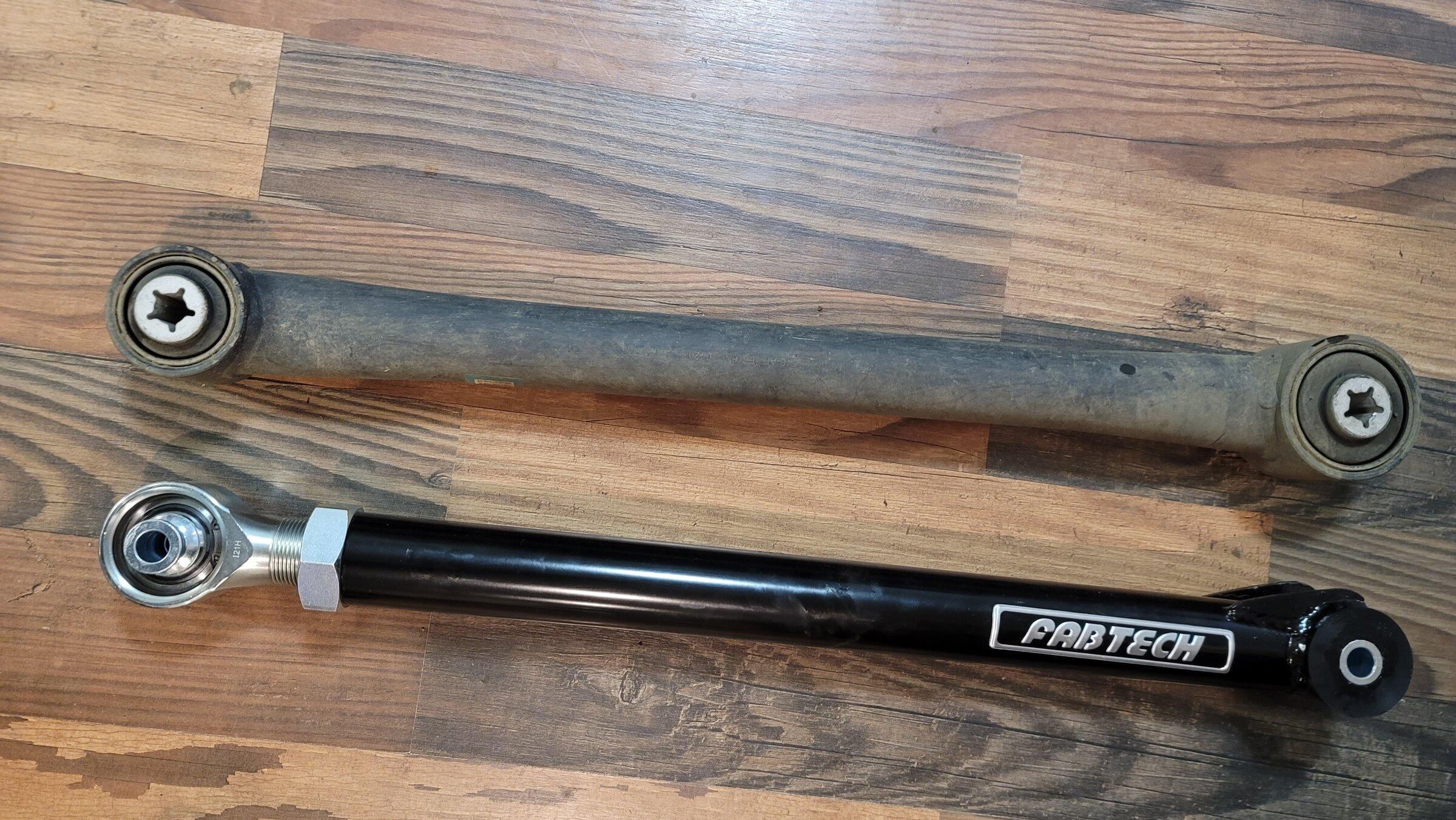

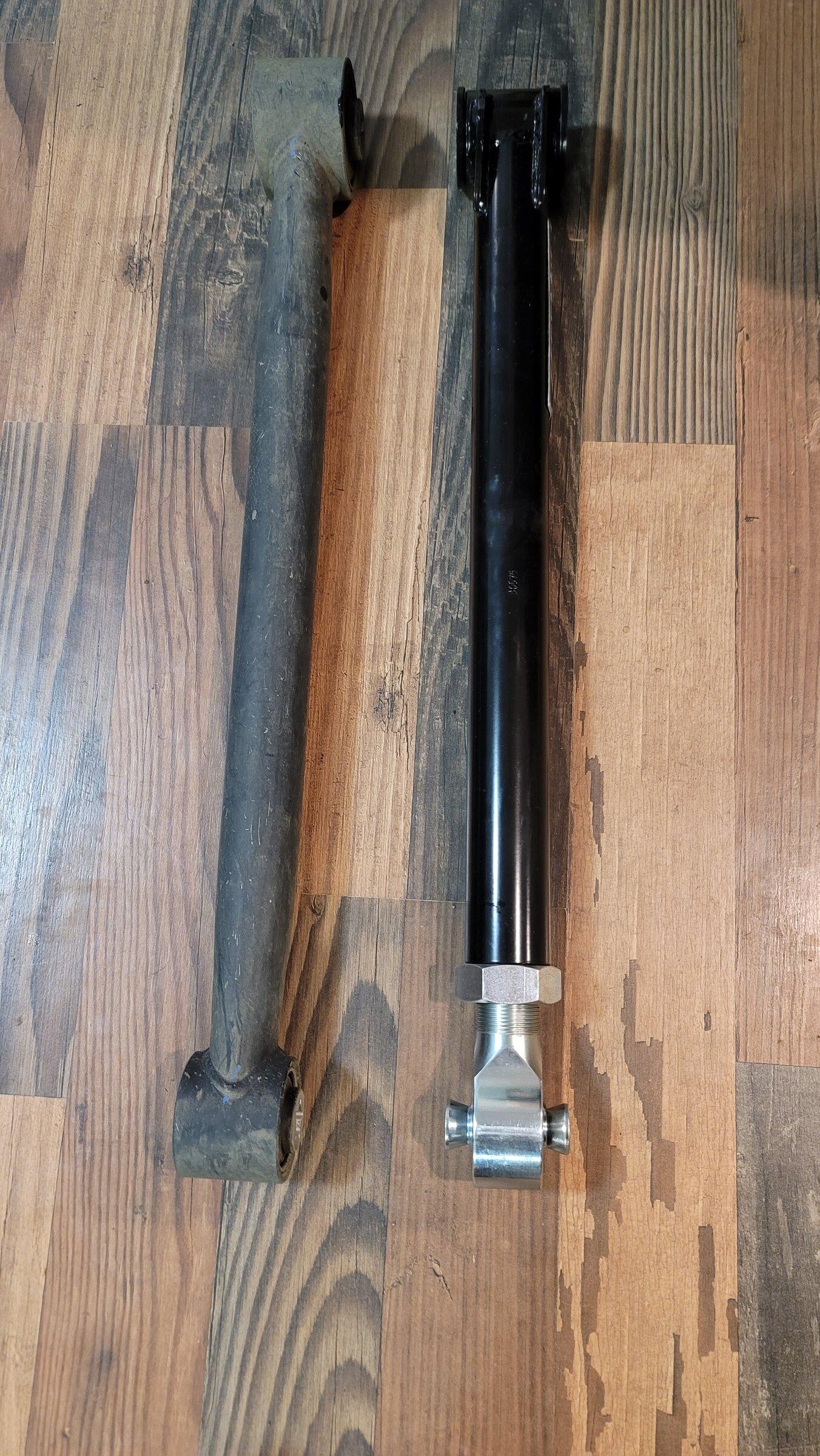

What does Fabtech use on the ends of the rear link? Looks like uniball on one end and a rubber grommet on the other? My factory rubber grommets were already cracking, so I'm trying to get rid of all the rubber mounts.
