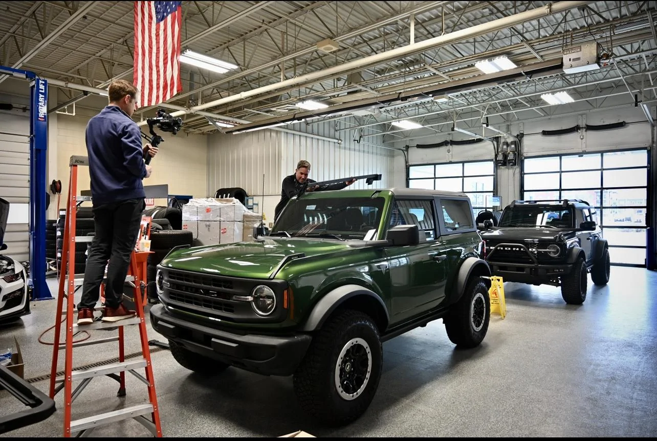

You should have installed the rear crossbar before tightening the stanchions with the torque tool

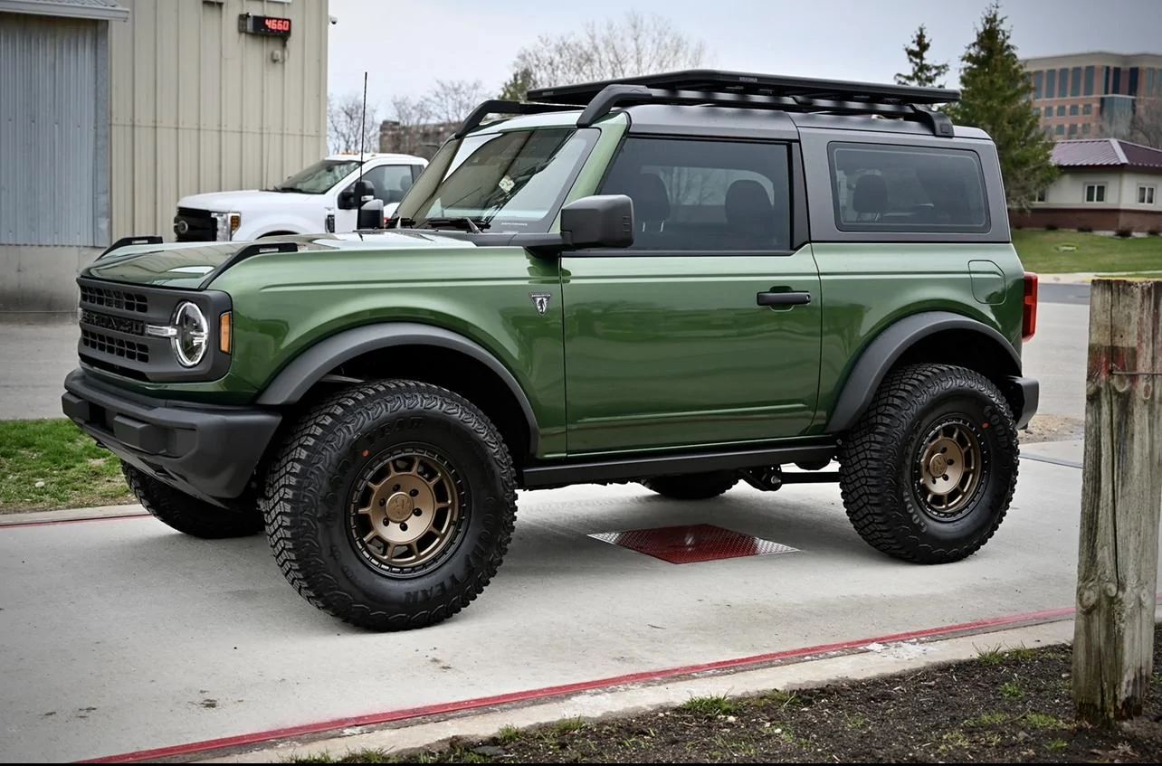

Question: Is there even a difference between the 2-door and 4-door OE racks? They look the same length to me.

And he's right. Install everything loose first then torque everything down. Especially when you're torqueing metal bolts on top of plastic. R&R enough times and you'll get some wiggle wiggle if you don't do this right.

Which size Yakima platform is that? It is bigger than what I want to install on my 2-door.
It's the large size 60" X 54" . I agree, we have the smaller rack on order that's 55" X 49" that should fit the 2 door better.

I removed my factory rack with a second person. Once it is all together just remove the bolts on the front window and use the weird tool Ford gave you to loosen the rear clamps.
2 people lift and walk backwards worked for me.
The hard top same thing need 2 strong people to lift to be safe. It is awkward to carry I'm going to make a lift to make it easier for me. Too hard for me to find a second person. My wife struggled helping me so now a small dent above the tail light.
