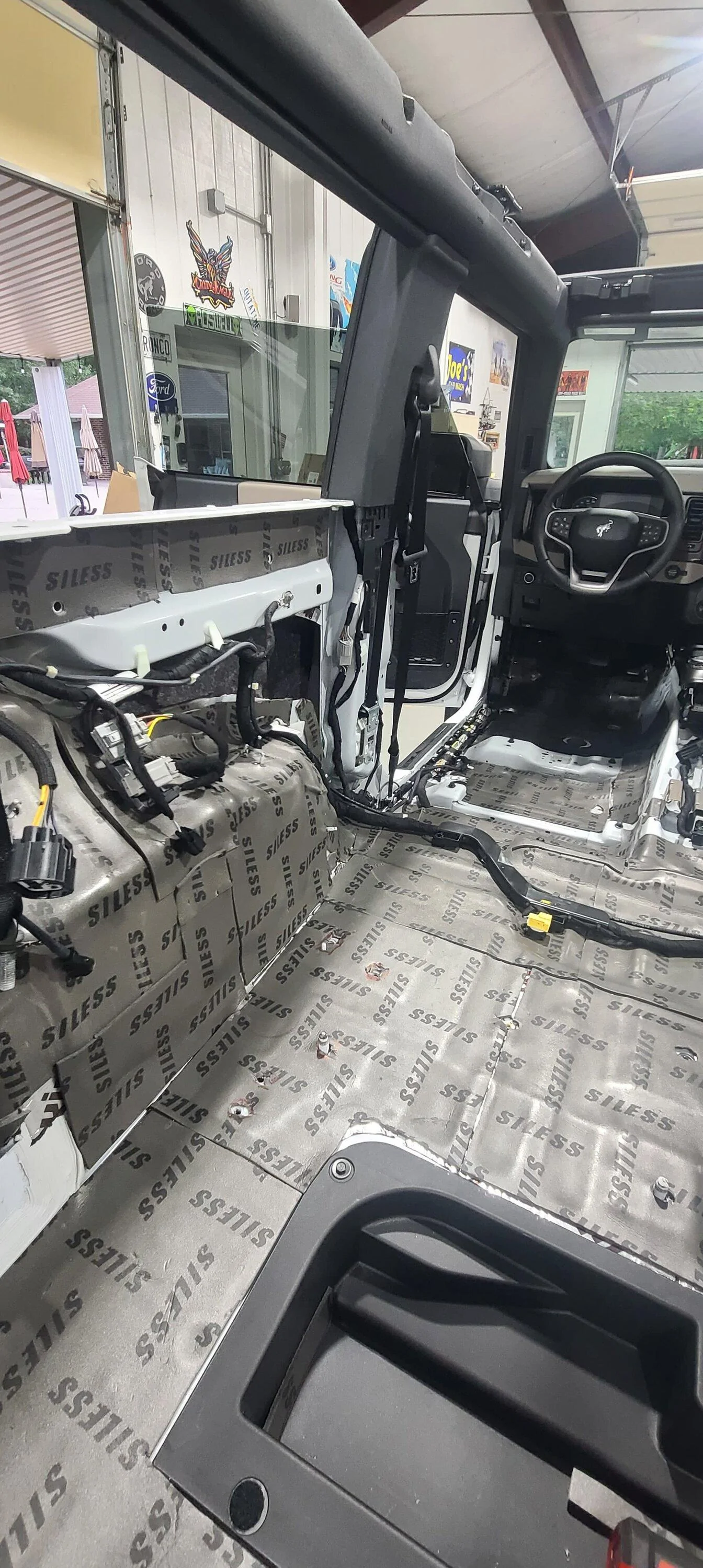

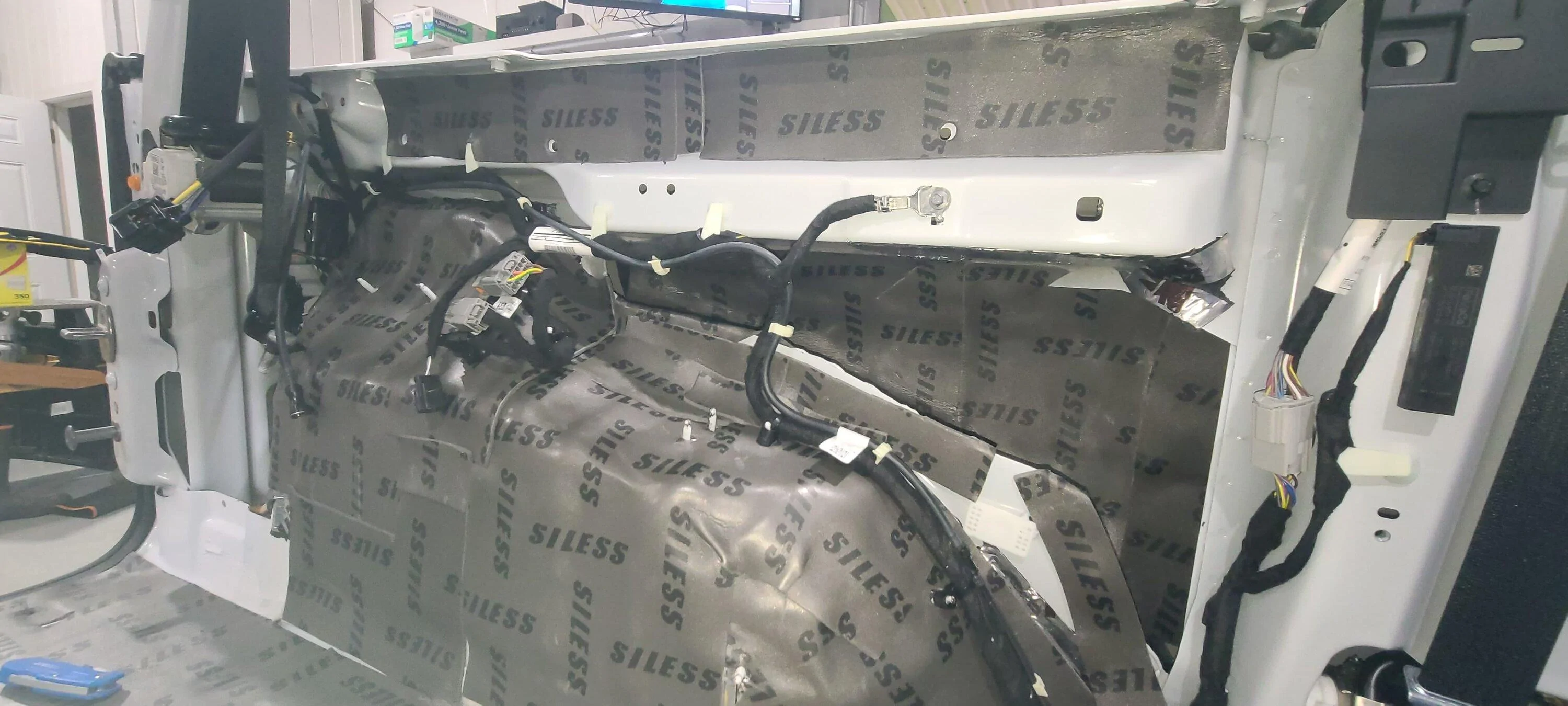

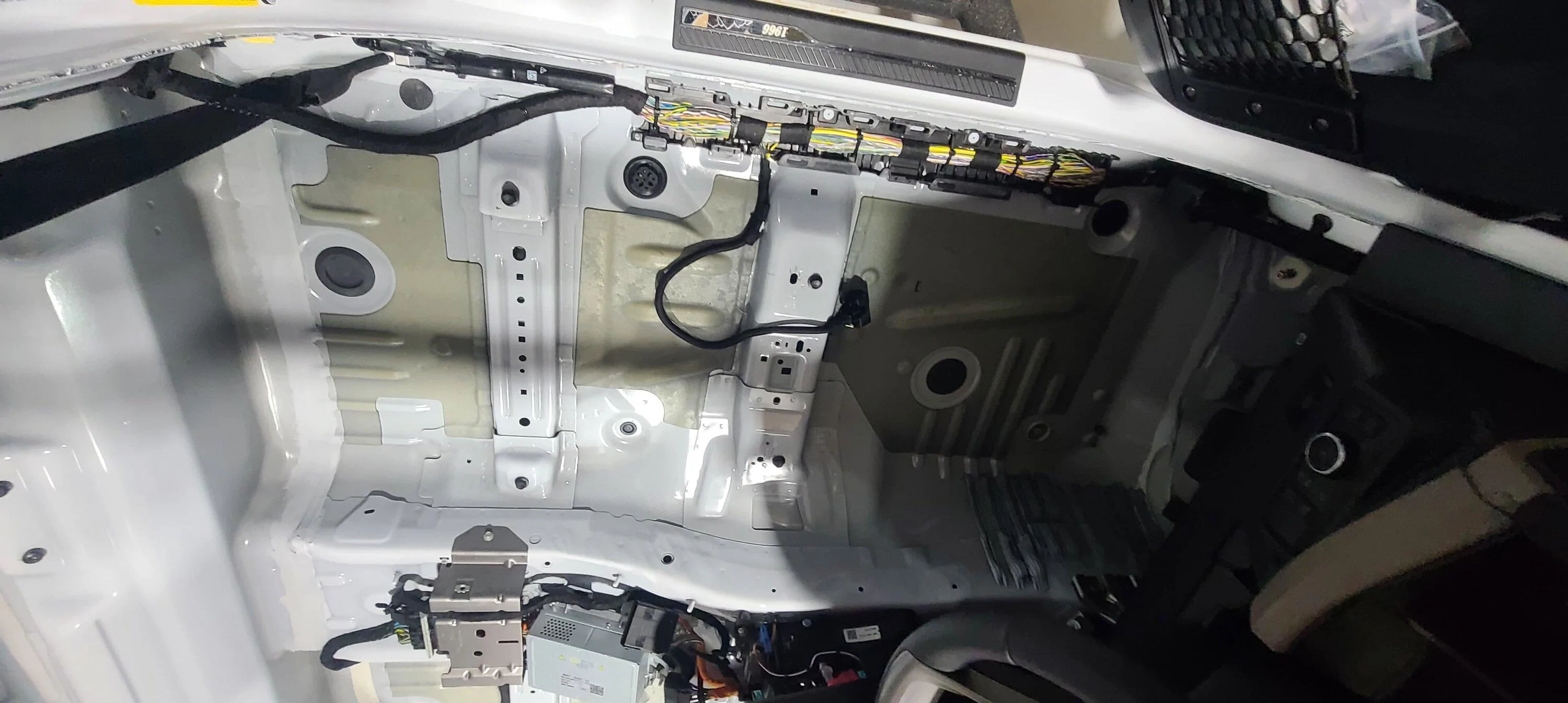

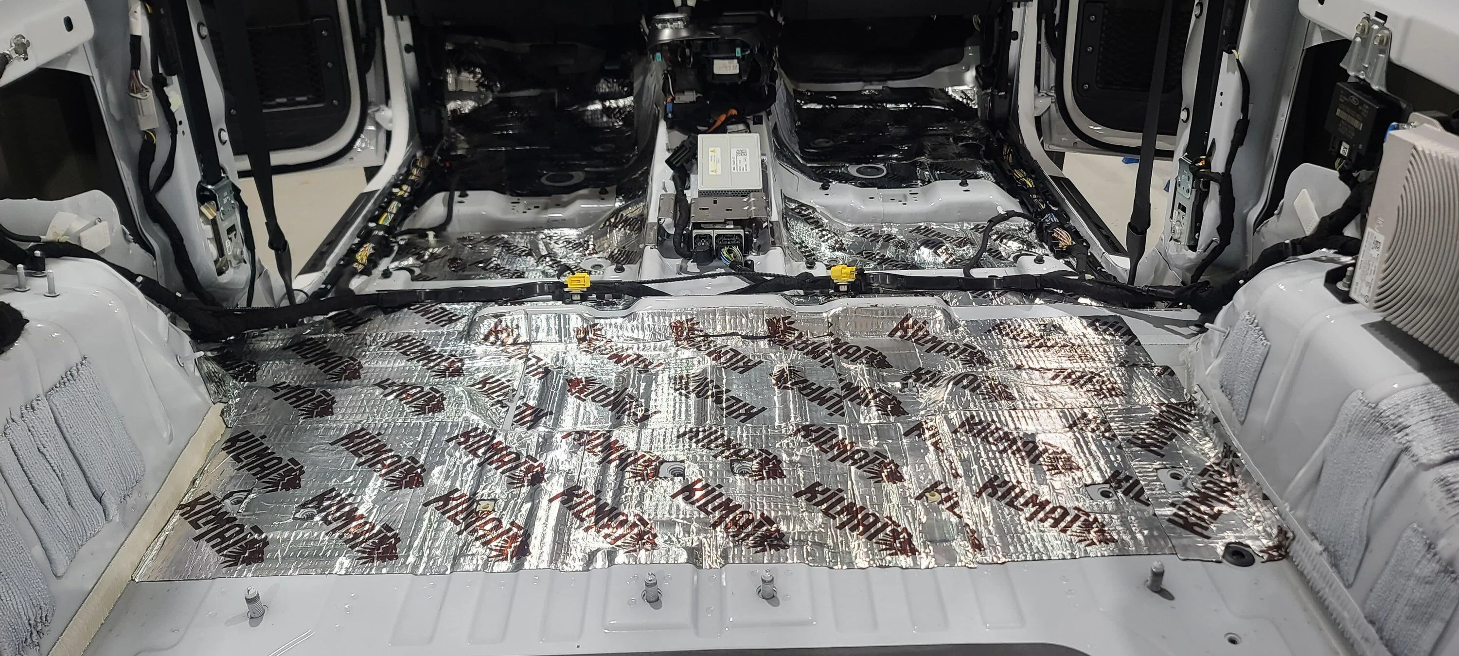

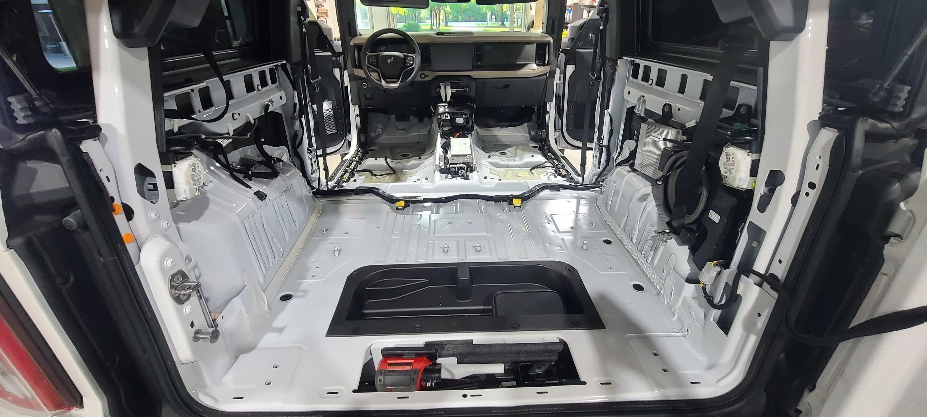

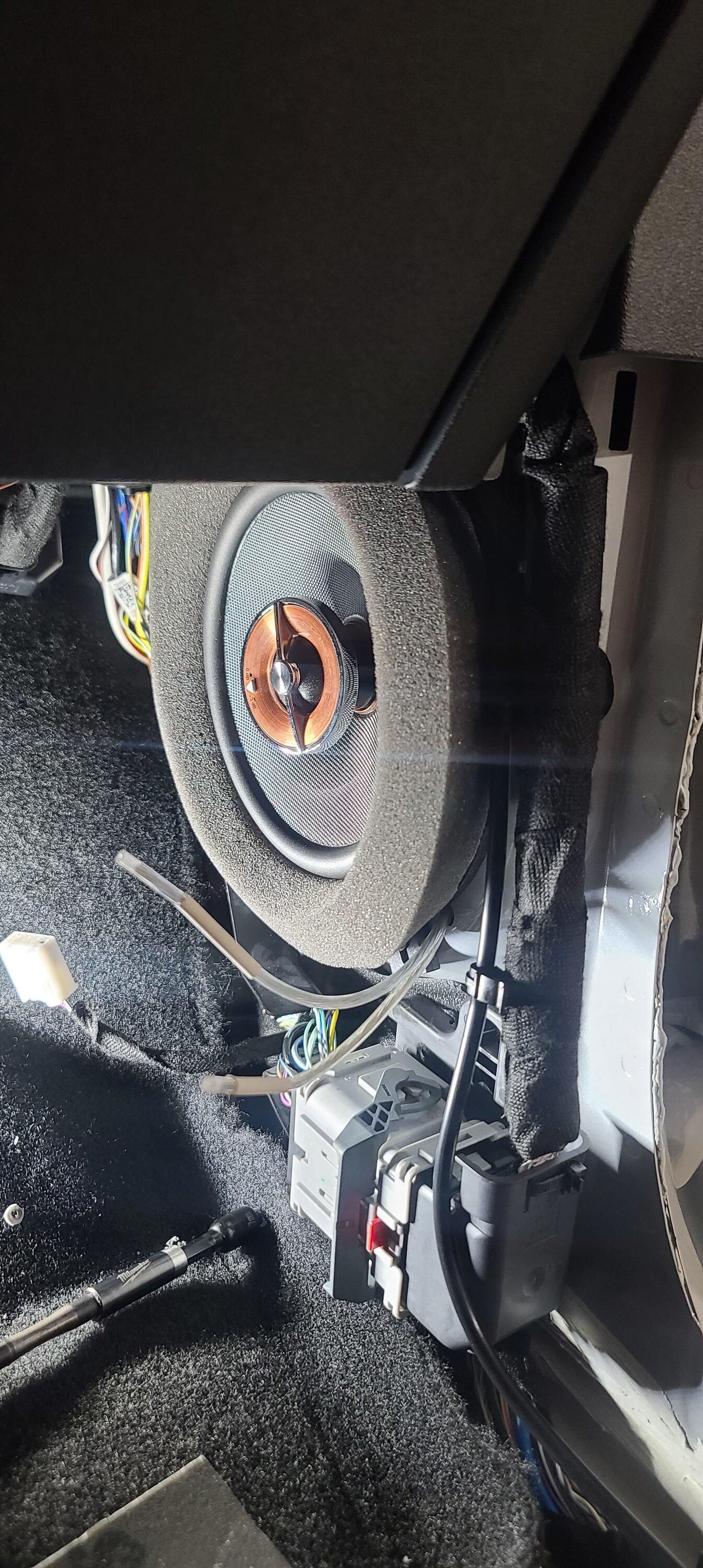

This weekend i decided to tackle the higher than used to road noise levels on our 2 door. After gutting the interior i am surprised that other than the carpet there is nothing to help keep outside noise at bay.

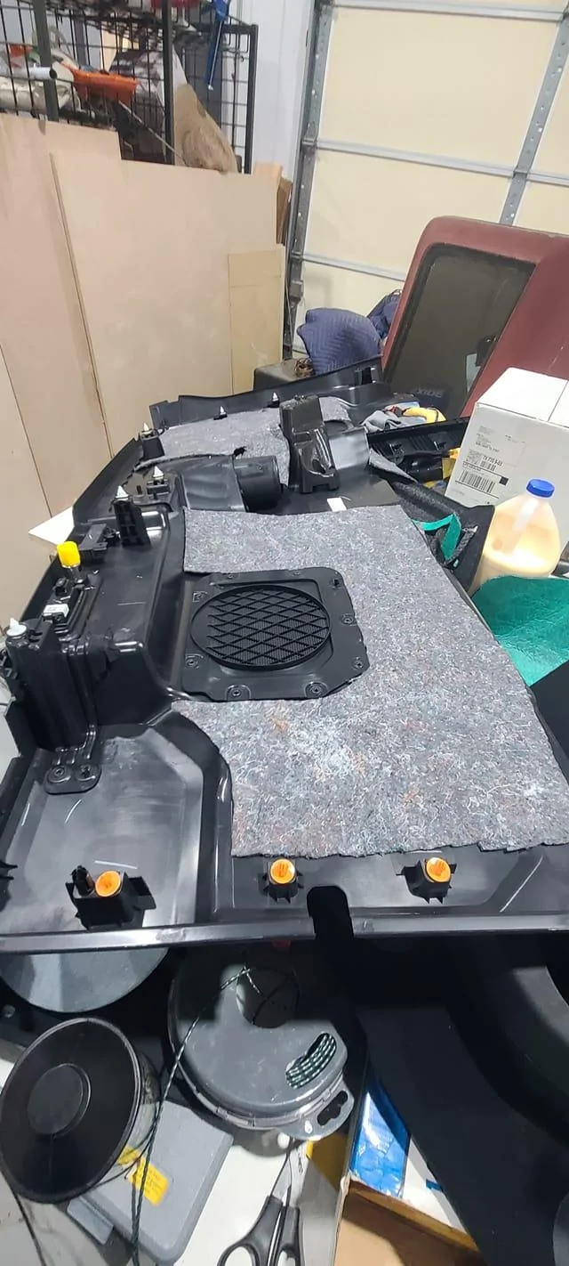

Taking the interior apart was fairly easy and took under 2 hours to get it done, after a good cleaning of all the panels it was time to lay some killmat down followed by some silex foam, and some sound absorbing felt material on the plastic panels and wheel well cavity. The rear wheels line up pretty close to your ears on the 2 door, i was surprised that there is nothing there to help with the road and tire noise. All the panel clips were lines with tesa tape before reinstalling. I still have the doors to get done(ran out of material) ,but even now the drop in road noise is very noticeable, and the bronco feels more solid.
As long as we had the interior apart we also replaced some of the speakers, the B&O is lacking and the Infinity speakers made it sound much much better.
Overall a good rainy weekend project

i wish it had crossed my mind to get some readings, but going from no insulation to a couple of layers, it's a noticeable difference. Top wind noise stands out a little more though.

the carpet looks like it will be fine if it gets wet, it's bonded to a closed cell foam underlayment, just need to add the drain plugs

I guess my ears aren't so sensitive yet at the young age of 44. But I notice really no road noise in mine. And I love the sound with the doors and top off. I even had someone ask me if the Bronco was electric. But nice project if it helps you.

I'm considering something similar...just to dampen the hollow sound going over bumps with the top on. Curious why you used kilmat and silex. I assume you used the felt on the plastic because it's lighter weight?
