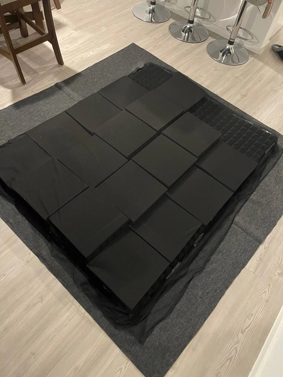

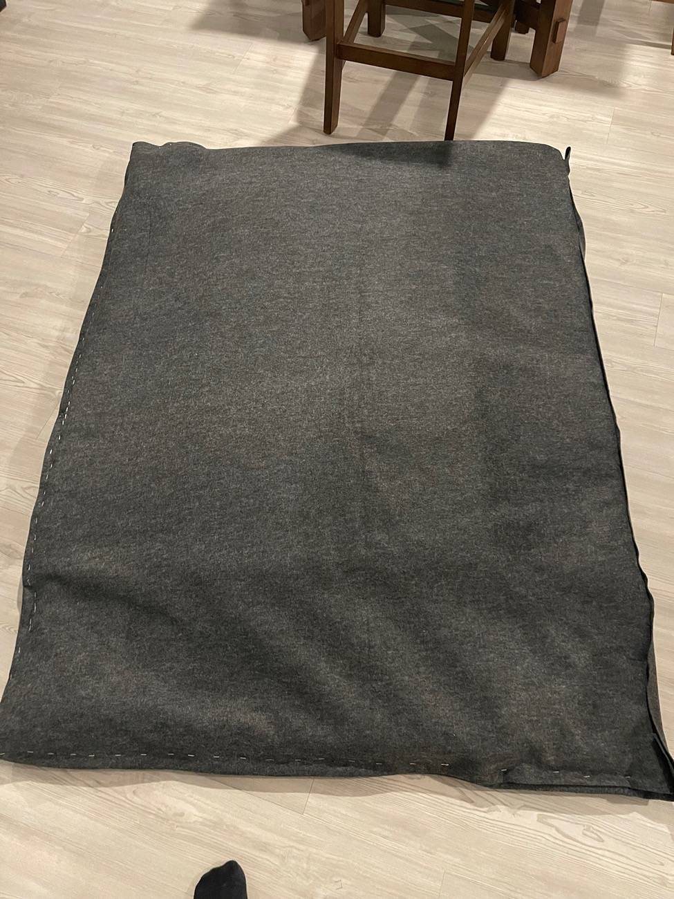

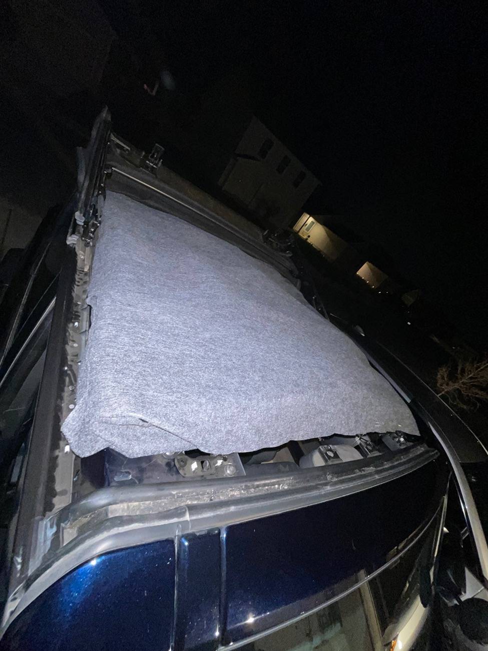

This was a combo of the cheapest amazon bikini top, sound deadening 12x12 panels, fabric from hobby lobby, fabric tape and staple gun lol. It honestly made a HUGE difference and is as quiet as a factory hard top, if not slightly quieter. Three stacked layers in the middle and two on the sides so it still seals good and doesn’t let water in. I wish I would’ve done this sooner

As long as there is room to stack at least two of these foam pads it should work. This is mainly for really long road trips. It comes out in 2 seconds with the top off so it’s easy to store in the room or wherever we are staying.

that insert I made comes out in 5 seconds after opening the top. It’s going to be there 99% of the time. If I’m going to the beach or trails where I plan on opening the top I’ll leave it at home or at the room.
it doesn’t have any leaks, i tested a pressure washer on it and when i had three stacked high on the outside rows it let a little water in. When I down sized the sides to two high there was no water intrusion

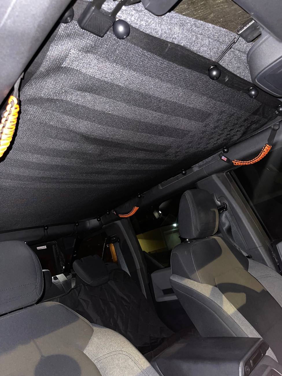

Looks pretty much like the dirty dog liner done DIY. I highly recommended that for any soft top owner. I’m only 30 but being in a steel mill I’m losing my hearing and it sure isn’t getting better and i could tell a difference.

I reached out to them to get an eta on when the headliner was going to be back in stock multiple times and never heard back. They have now pulled it from the site so I think it’s long gone. This worked out awesome though
