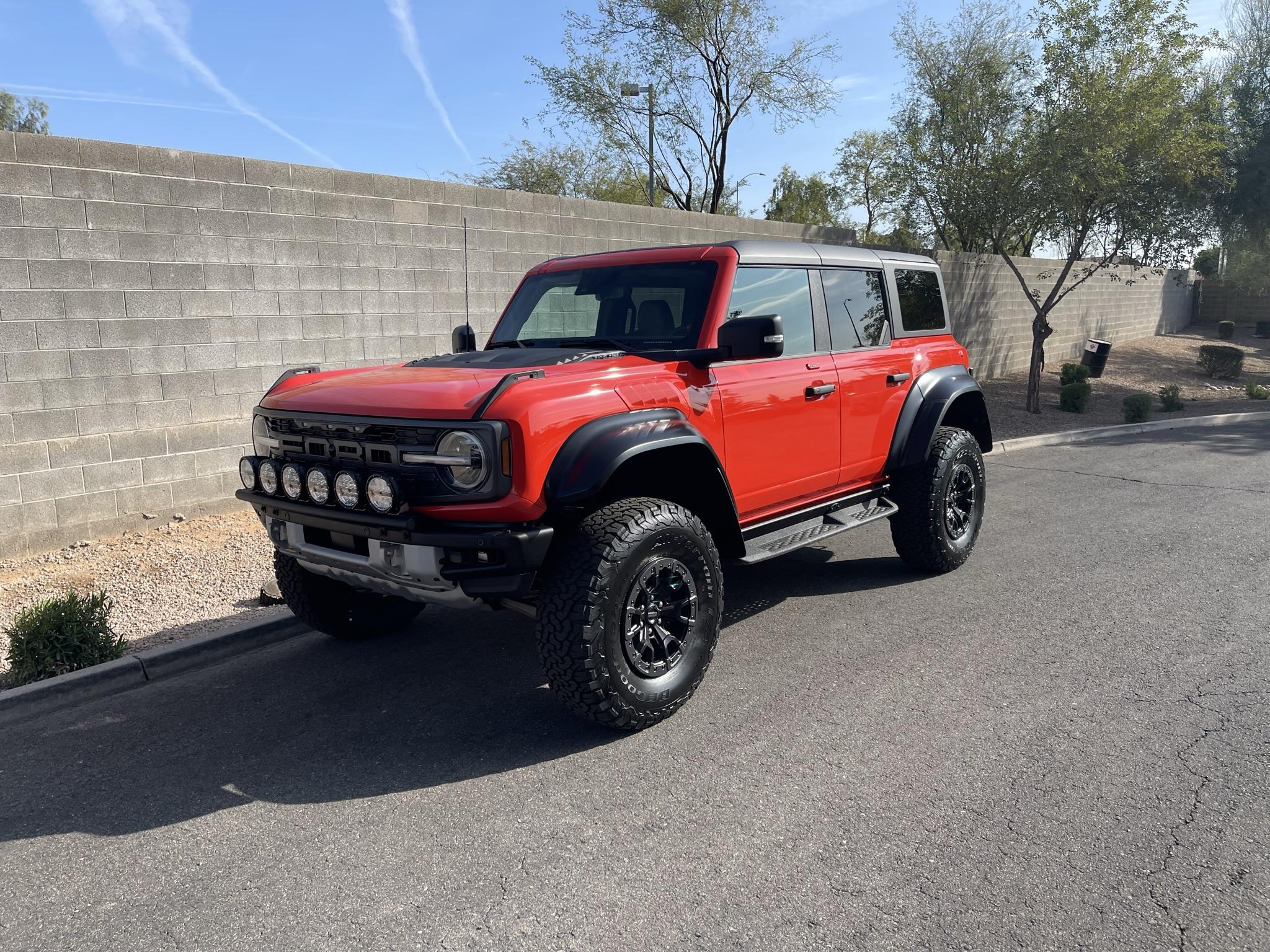

Any side shots so we can see the actual leveling?

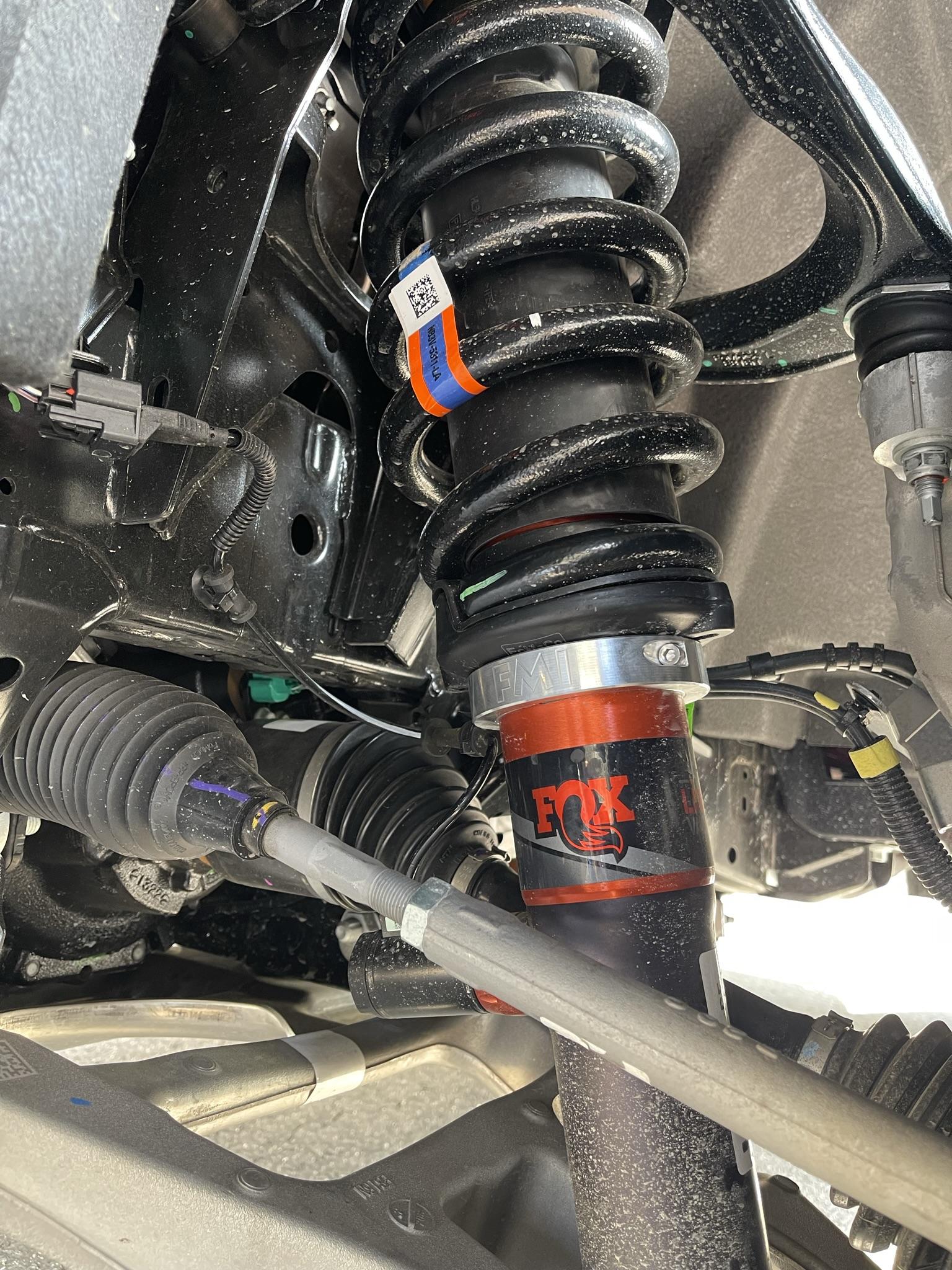

How does the collar affect the spring/shock function? You're compressing the spring to increase the ride height.
If the springs are progressive, doesn't that mess up the ride on normal roads and shorten the overall suspension travel when you're off-roading?
This doesn't make sense to me.
the lower coil spacer block just adds a little preload to the spring to bring the height up. I didnt notice any real change in ride feel or handling characteristics. It sill rides great and feels like stock. it doesnt shorten or limit or change the travel at all. The only way you limit travel is if the spacer is so tall that you end up in coil bind. in this case we are not even close to coil bind. the spacer could be another nearly 2" tall before getting to coil bind on the front spring. and since we are not putting the spacer on top of the complete shock mount you are not letting anything drop out farther then factory intent so the travel numbers are the same.

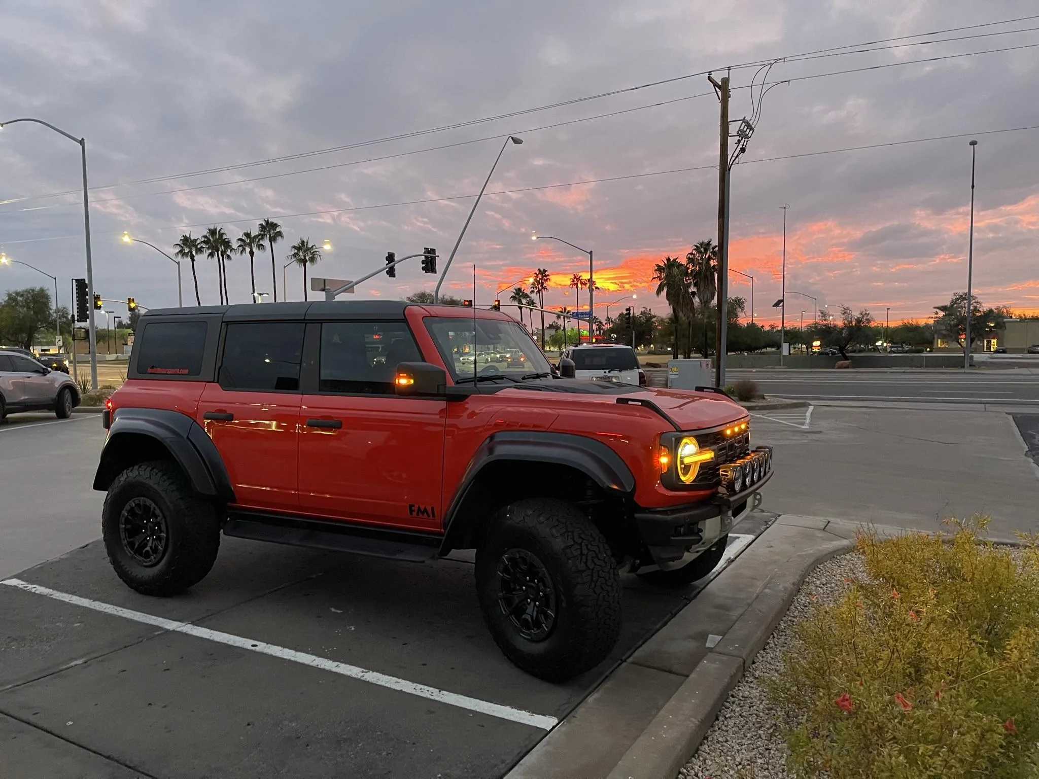

Looks great! Is that Race Red I see??

our bronco raptor is Code Orange actually
