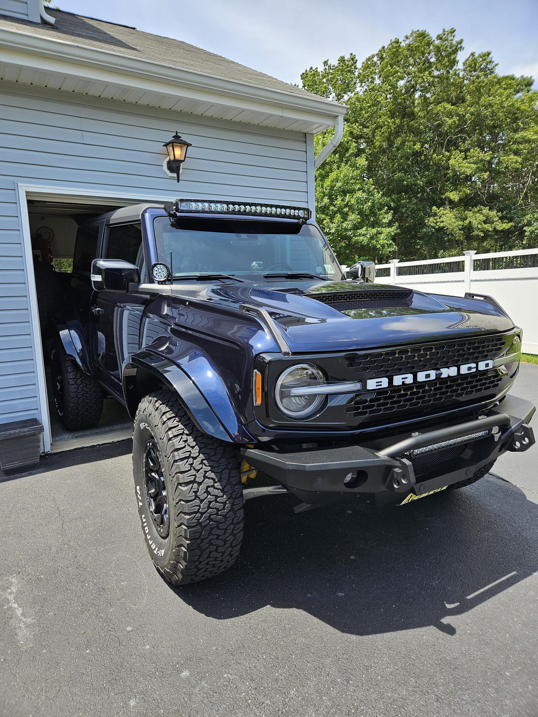

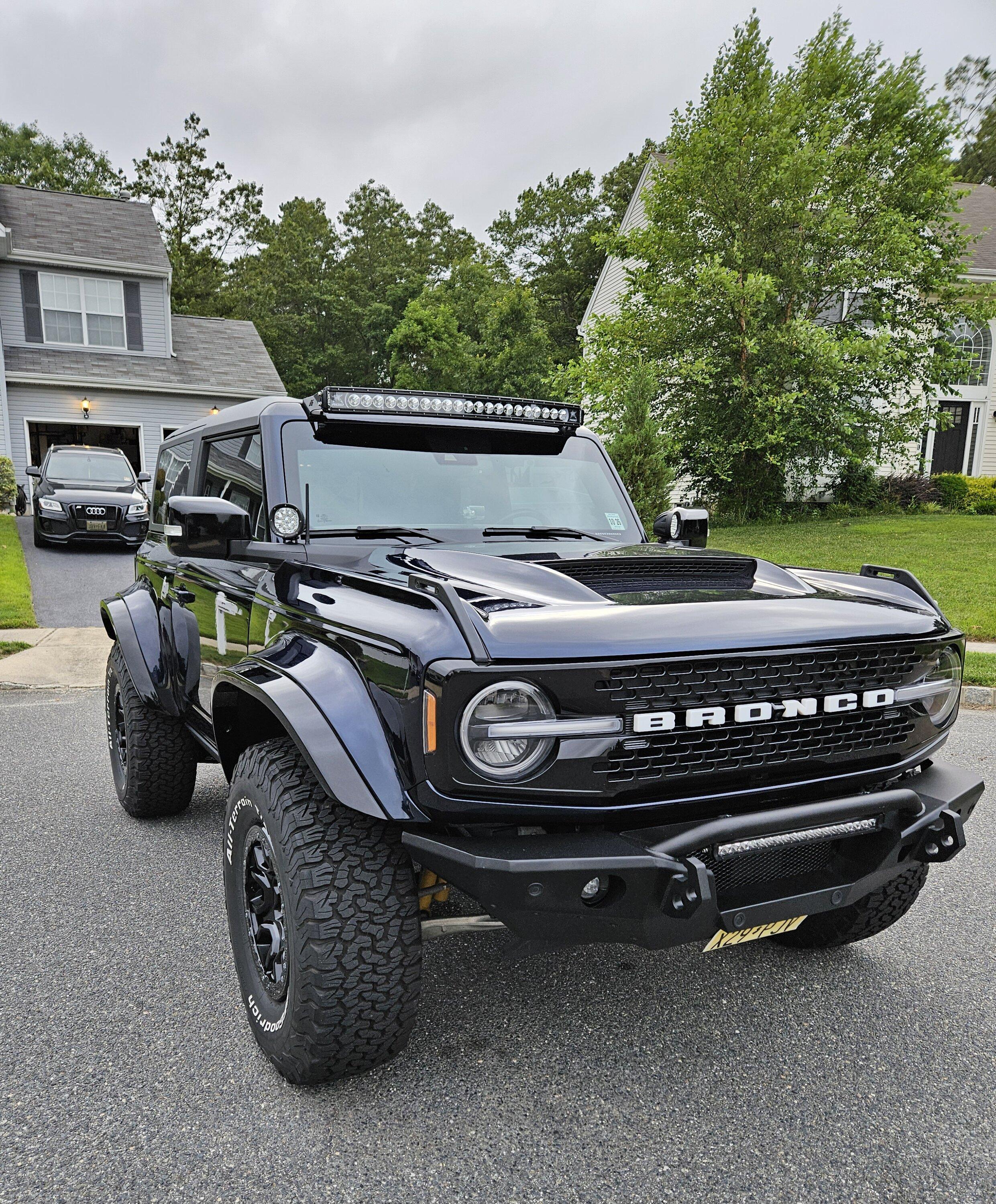

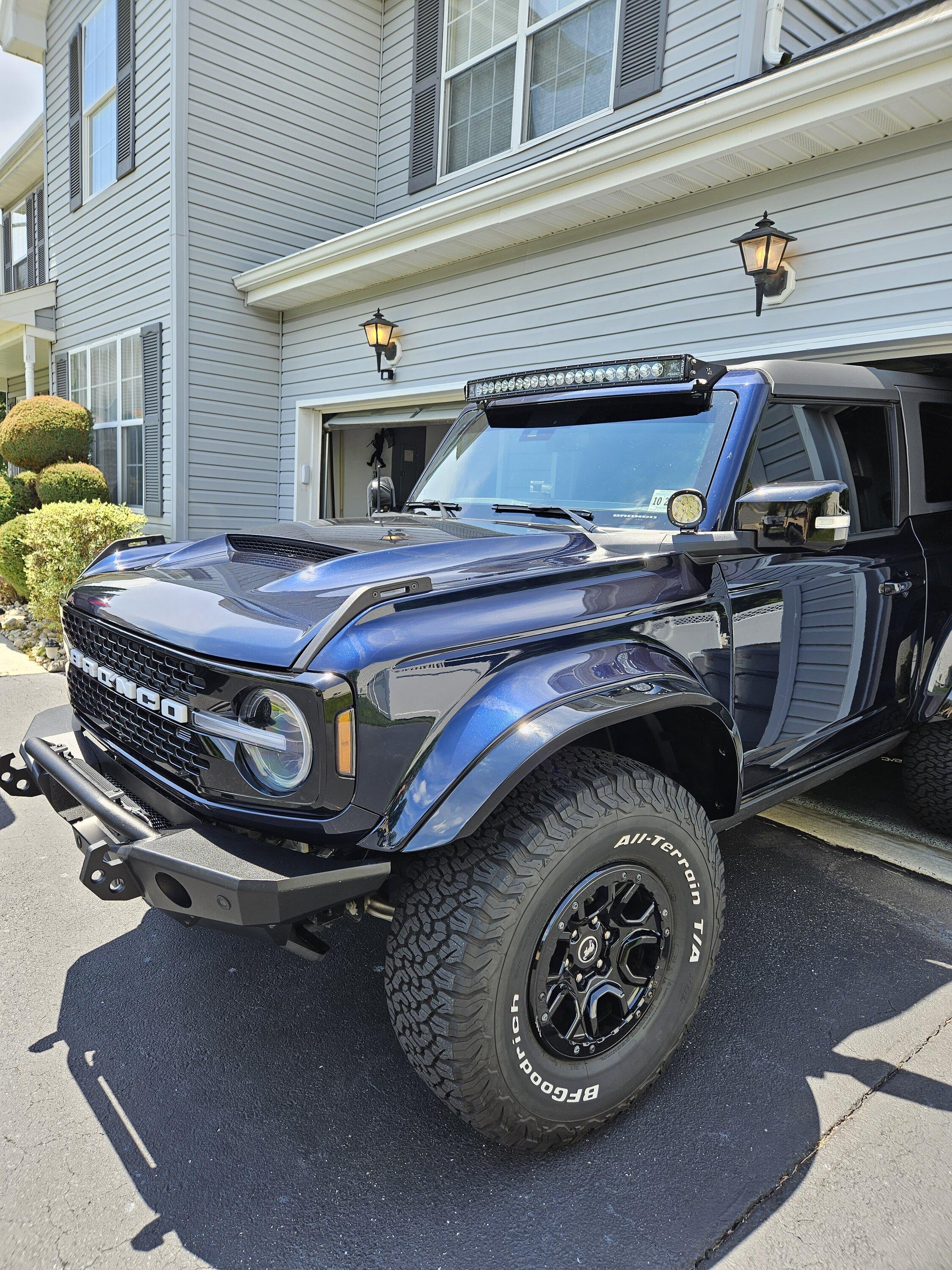

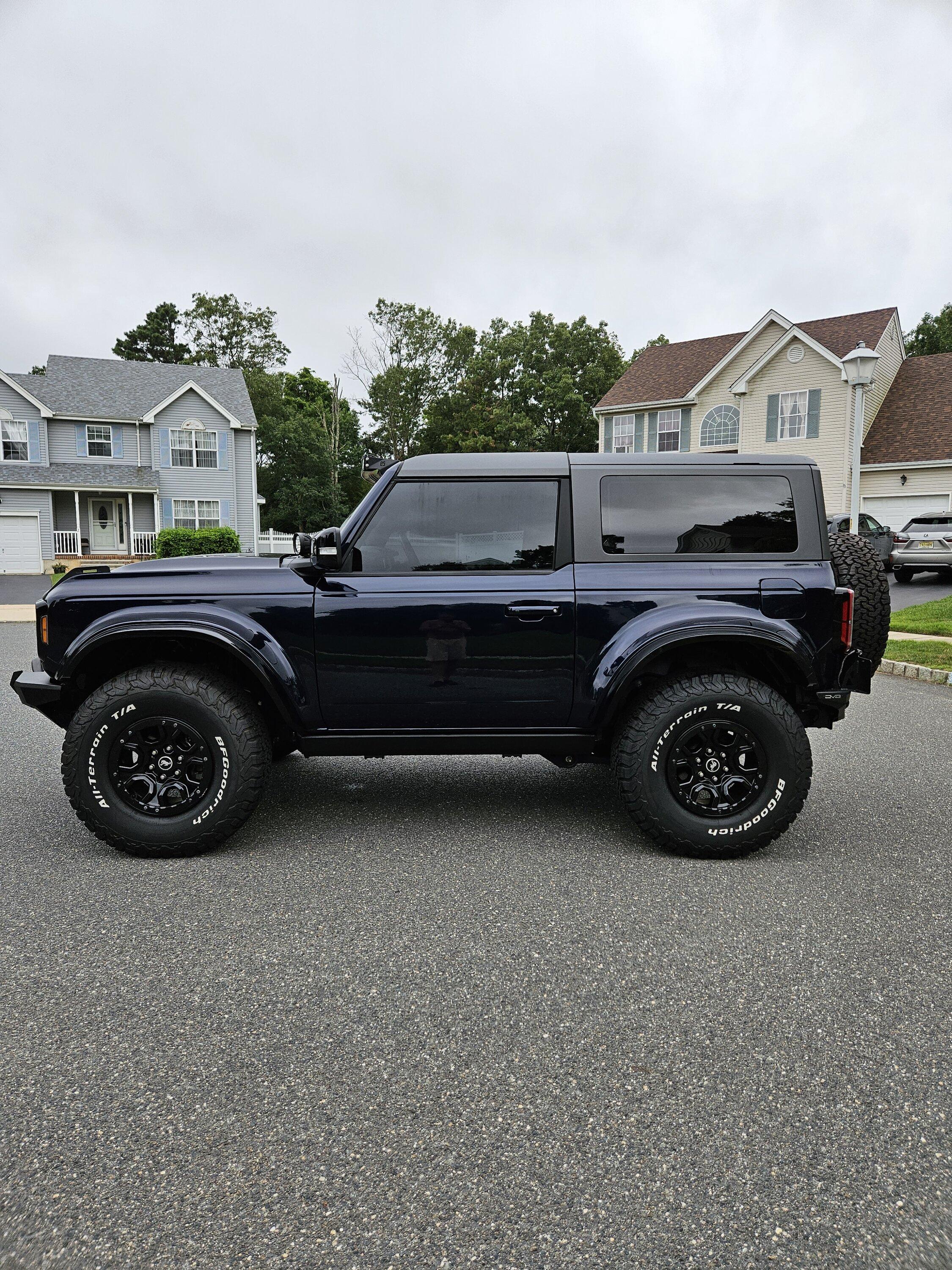

This build was to install the 8"/1 fenders with liners. There's not much to add, they need to be fitted, prepped, painted and installed.
The liners (tire side) comes prepped with a gloss black gel coat. The other side is raw fiberglass; it's your call if you paint it.
Once the fitting was done I picked the liners. Prepped (sanded, or scuffed up) them, then sprayed Bedliner on the gel coat side. The other side I used a roller to lay down a heavy coats of Bedliner as well. In the end, I put 2+ coats down on each side.
The fenders were sprayed with Antimatter Blue, the outer fender flares were sprayed in gloss black to match the Wildtrak grill, mirrors, etc...
On to the next Mod or change....
So, it looks like 40" K02s tires will fit thanks to AFC.๐Ÿ‘๐Ÿบ๐Ÿ‘๐Ÿคฃ

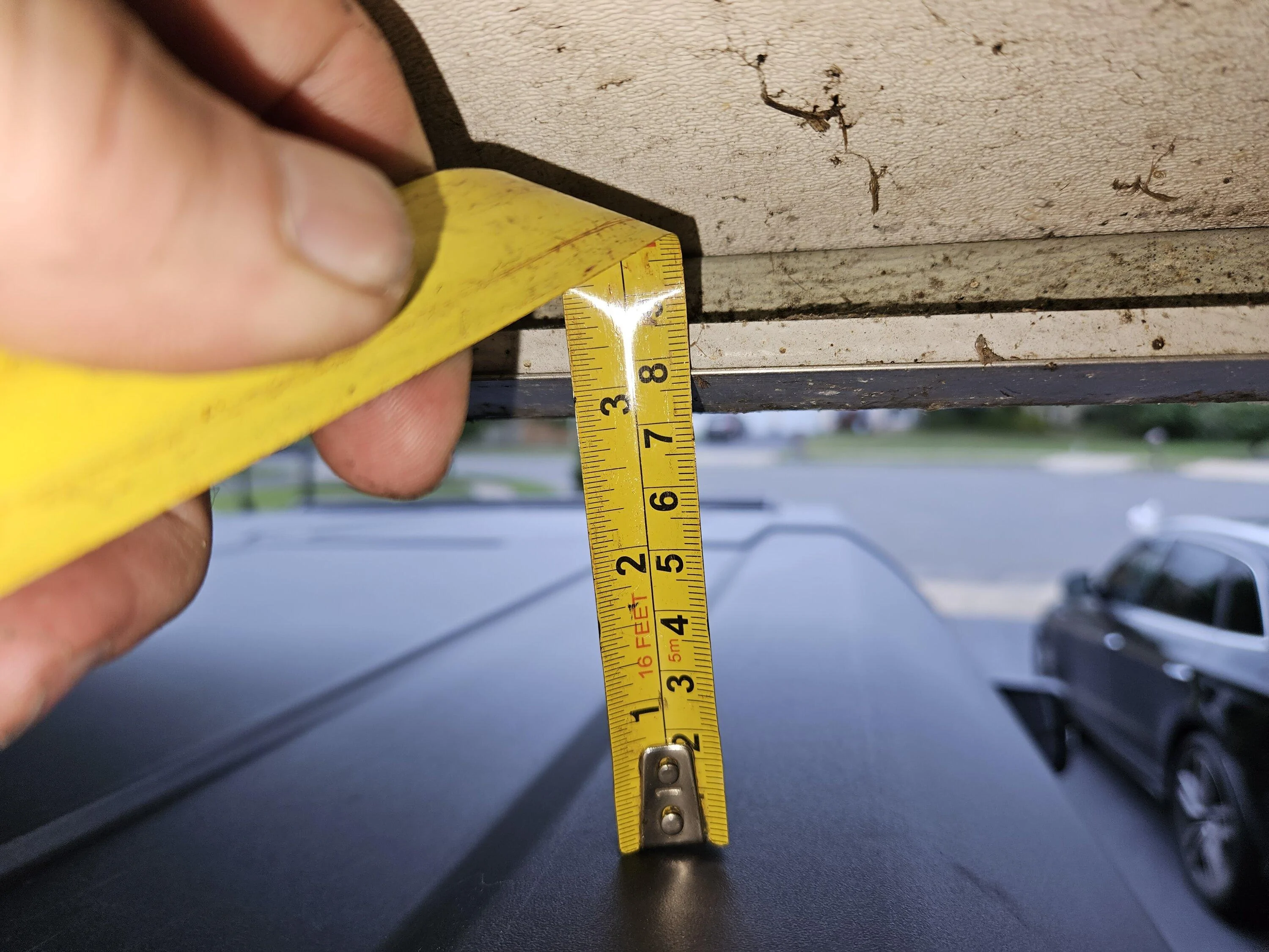

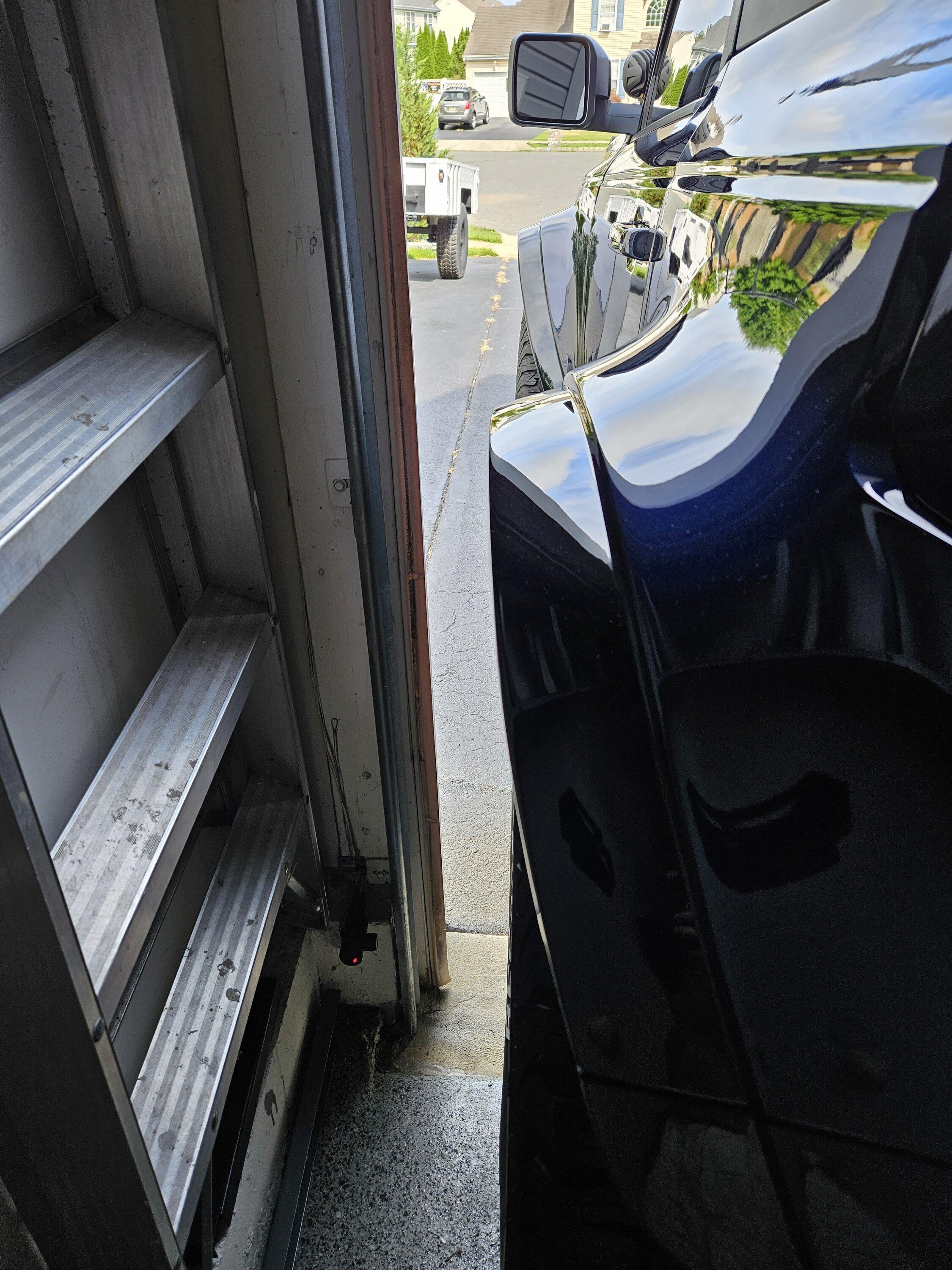

Looks good. Howโ€™s the garage clearance, looks tight?
That's funny!!!! I'm tight at the top. Sides changed a bit... I knew if the mirror was close, I had plenty of room to back in. Now the fenders n mirrors are pretty much even. Need to develop new habits when parking.... lol

Yeah, meant the top. Looks like youโ€™re hitting / rubbing?
