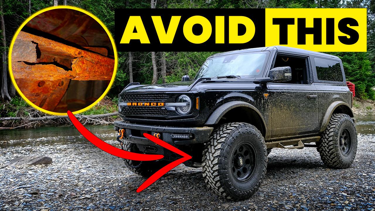

Ford Bronco Undercoating "How To" for Offroaders (Video) DSCF1924-Edit
If you want to keep your Bronco for a long long time, make sure you undercoat it! Here's how I do mine every year, with a few extra steps for "offroaders/overlanders". Let me know if you have any different tips!
