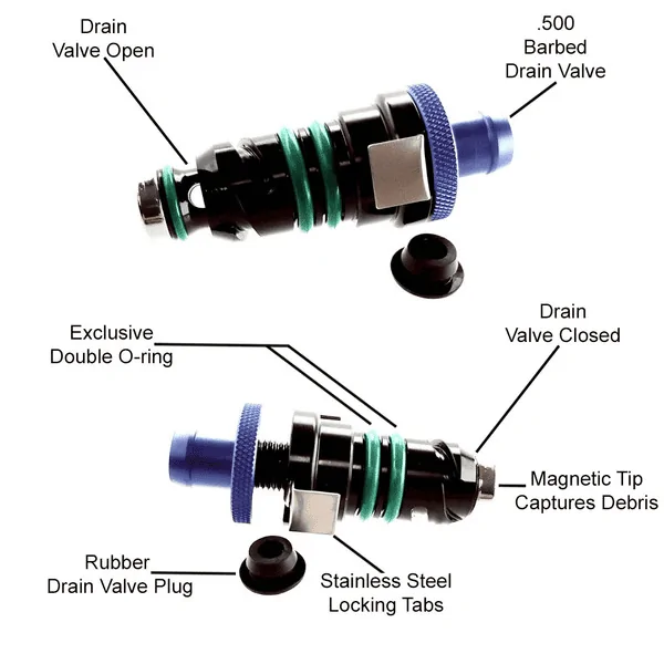

FEMCO makes a better and lower cost option. I have it on my 2.7 and it's great.
Good to know. Ronin's was sold out and I was curious about the Femco one.
I changed mine last night at 1200 miles to go ahead and get synthetic in there. After draining for 30 min, filling, and waiting for it to settle in the pan, I showed full at 6.5qts. I think the other half quart was in my oil filter housing. Should I have changed the filter first before draining the pan to get more out?
Love the top mount filter, I used a 1-1/16 socket to remove. Drain plug location is better than the F150 because it doesn't point right at the sway bar, but I still had it gush onto the passenger tire and floor. Definitely going to swap the plug for a Ronin/Femco/Fumoto next time.
One other thing I did was crank in "flood mode" a couple times before starting to get oil circulated in the engine and build pressure. Just floor the gas pedal and hold the start button and it will crank but not start.
I wanted to use Castrol Magnatec but I noticed the manual says to use API SP rated. The Magnatec at Walmart carried the SN Plus rating. Went with Pennzoil Platinum instead. Next time I might just use my FordPass points to get Motorcraft Synthetic.
Lastly, is there no oil pressure gauge? I have oil temp but didn't find pressure.
EDIT: just found this UPR billet aluminum drain plug. May have to go this direction instead of another plastic unit.
https://www.uprproducts.com/upr-ford-easy-oil-drain-valve-for-mustang-f150-raptor-edge-explorer/
