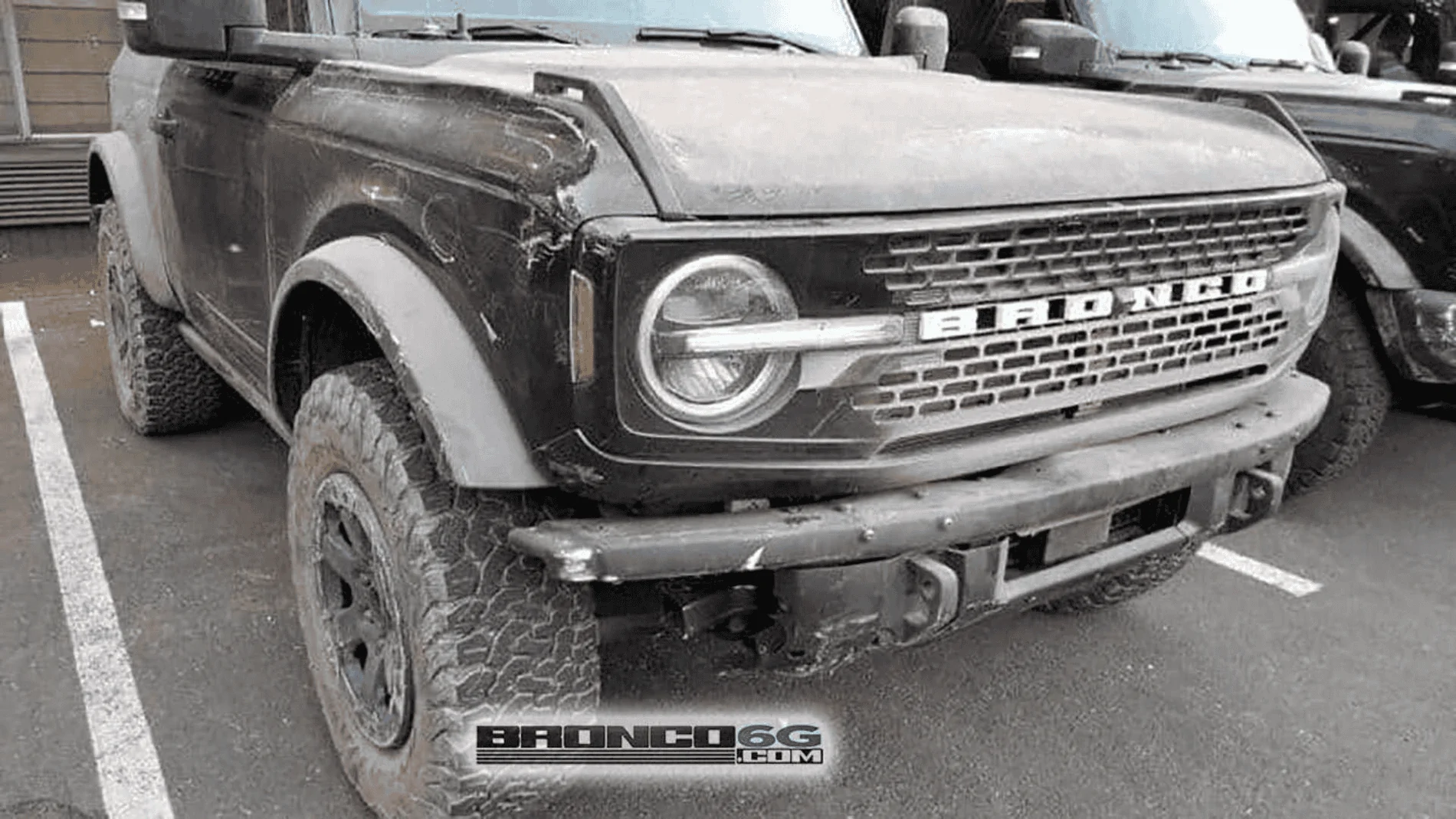

That pic looks to be the part of the modular bumper that is made to be removed. I wonder if the center section and "wings" are a bit more rugged.
Ford Bronco $850 Mod Bumper + Bash vs Aftermarket thoughts? 1603577832706
For you none BL folks I think the $850 is a good price point. Jeep wants almost double for their steel bumper option.

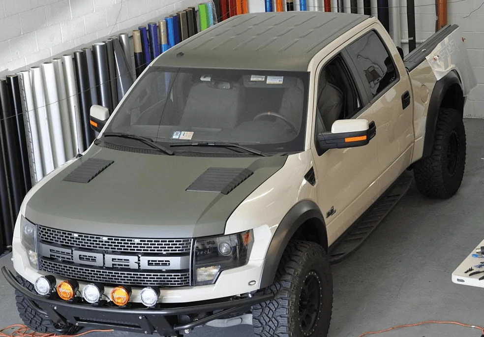

You are missing the whole point of an aftermarket bumper. Most aftermarket bumpers will come with light tabs so you can mount lights. So yes, if you don't need all the extras then stay stock.
Below is my 2013 Raptor with an aftermarket bumper. You can't see it but it also allows for a 20" light bar below the 5 light cannons.
BTW .. I also have an aftermarket bumper on my 2019 Raptor that has some custom light tabs.
Ford Bronco $850 Mod Bumper + Bash vs Aftermarket thoughts? 1603585309581

Are the hood and top of your Raptor Line-X'd? Looks good

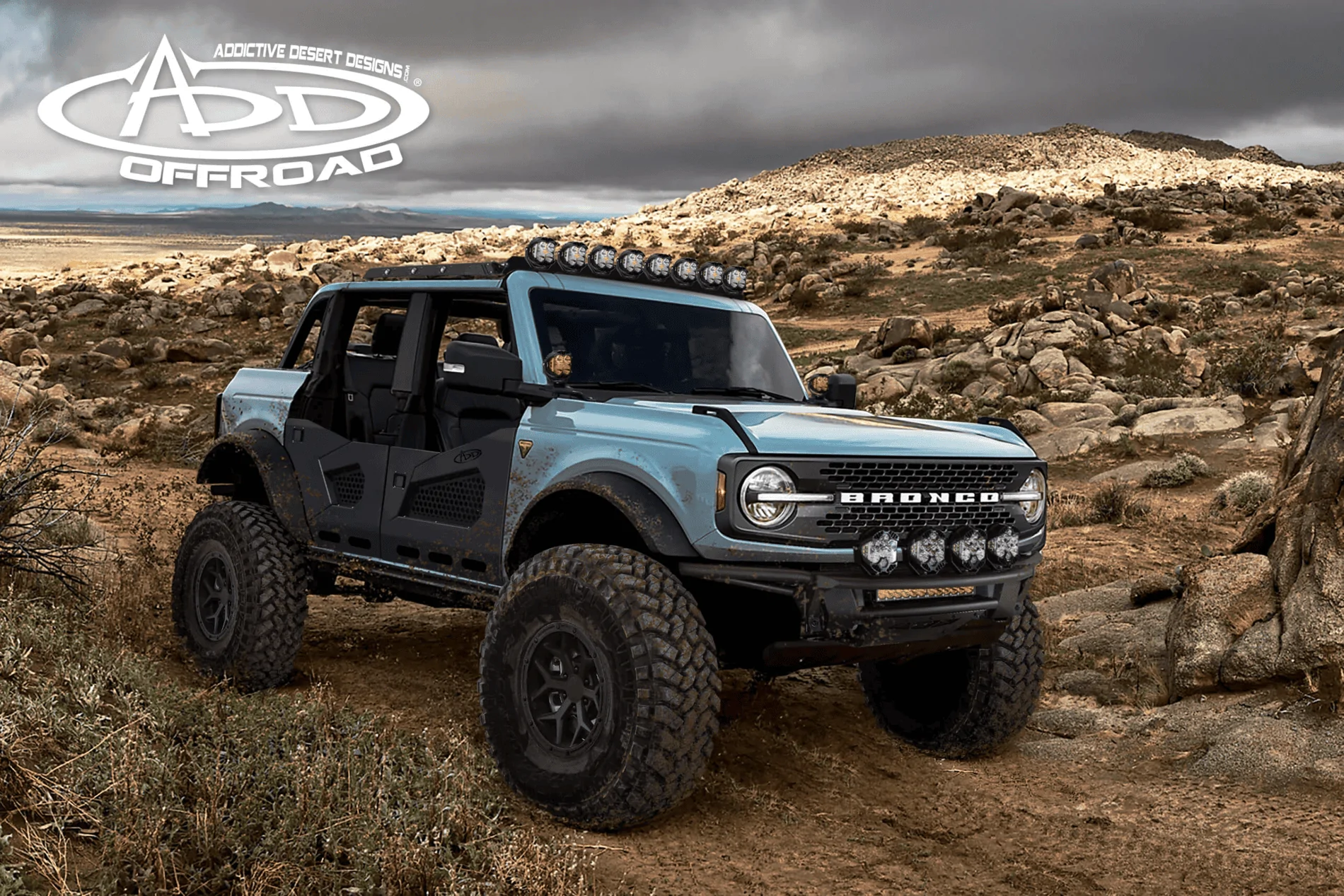

Thats my plan
This minimal bumper looks great
It does look good!
Wonder if a thin light bar in that bumper opening will interfere with air flow into the intercooler!?

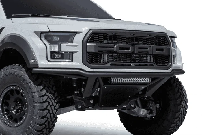

that's the in the ADD pro bumper and it comes in 2 flavors: Bolt on and frame cut
What I am about to describe here is for the Raptor and the pic you are referring to is just photo shopped by ADD as they intend to make the bumper BUT can't do so as they don't have a real bronco to mock up.
Bolt on is just that .. bolt on. It may require you to remove the inter-cooler shroud BUT but not the IC louvers.

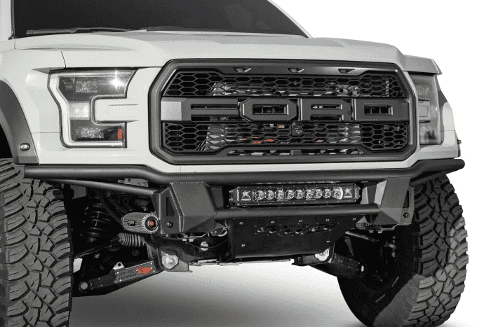

Frame cut means you are cutting the frame horns so the bumper can sit closer to the body. A frame cut will require you to remove the IC shroud and louvers and will require you to relocate the IC behind the grill.
Most after market bumpers will not account for any sensors that may sit in the oem bumper. You will have to relocate them. For example the Adaptive Cruise Control sensor.
It is way TOO early to speculate until the aftermarket can get a bronco and remove the oem bumper to see what is what.
Bolt ON:
Ford Bronco $850 Mod Bumper + Bash vs Aftermarket thoughts? 1604940286337
Frame cut:
Ford Bronco $850 Mod Bumper + Bash vs Aftermarket thoughts? 1604940310879
