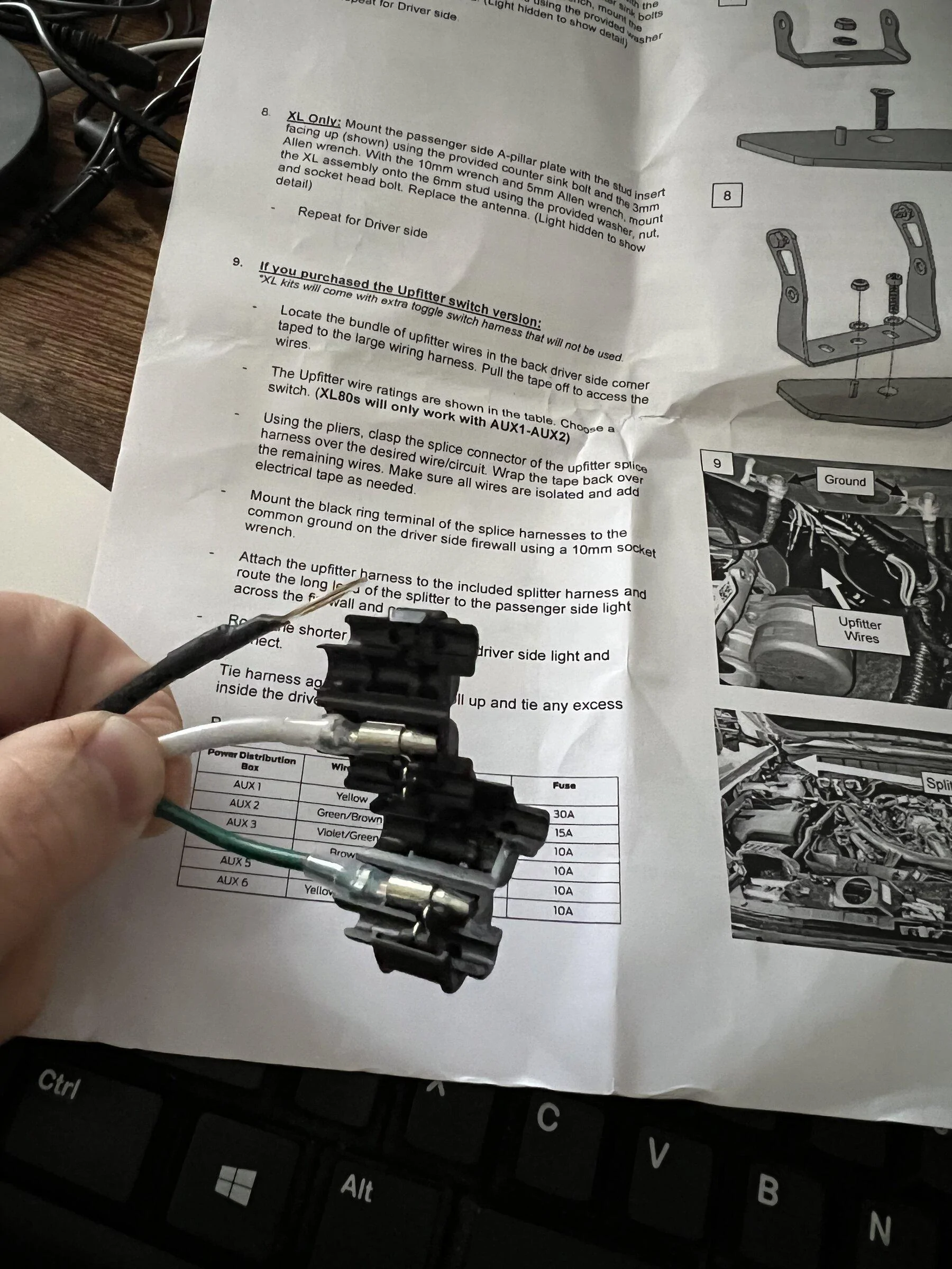

When people are wiring their a-pillar lights to the Aux switches, are you wiring both to the same AUX switch? or RH on one, LH on the other?

I’d imagine both to the same switch that way your
Not wasting a switch

I put mine on the same switch. I have plans for the other switches for other accessories.

Both to the same switch, as the harnesses included with these kits only allows for that type of configuration. Otherwise you'd need to run an independent harness to each light. I've never seen anybody wire the left/right up separate but you could if you wanted to aim them off to the ditch and control them separately.

Thanks, thats what I assumed. Figured id ask before i got too deep into the install.

the 2 clasps here is what got me thinking
The white wire goes to your upfitter. The green wire is the "low" power mode (I assume you got the XL Sport/Pro/80). It'll active the lights in a LOW mode when positive power is ALSO applied to the green wire. 99.999999% of our customers don't bother with the green wire, as who's going to need low mode (as that's still too bright for public roads on pillars)

XL80s, thank you sooo much. A1 customer service sir!

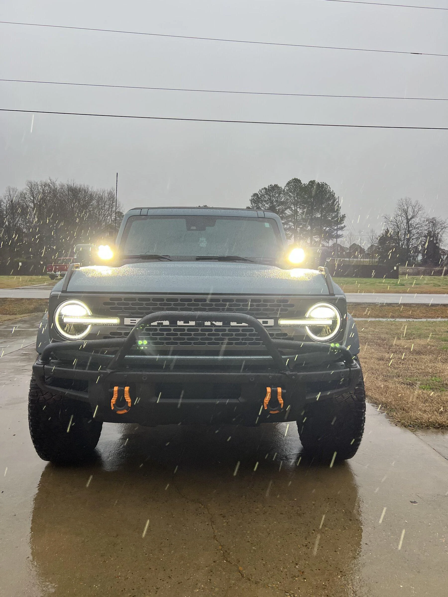

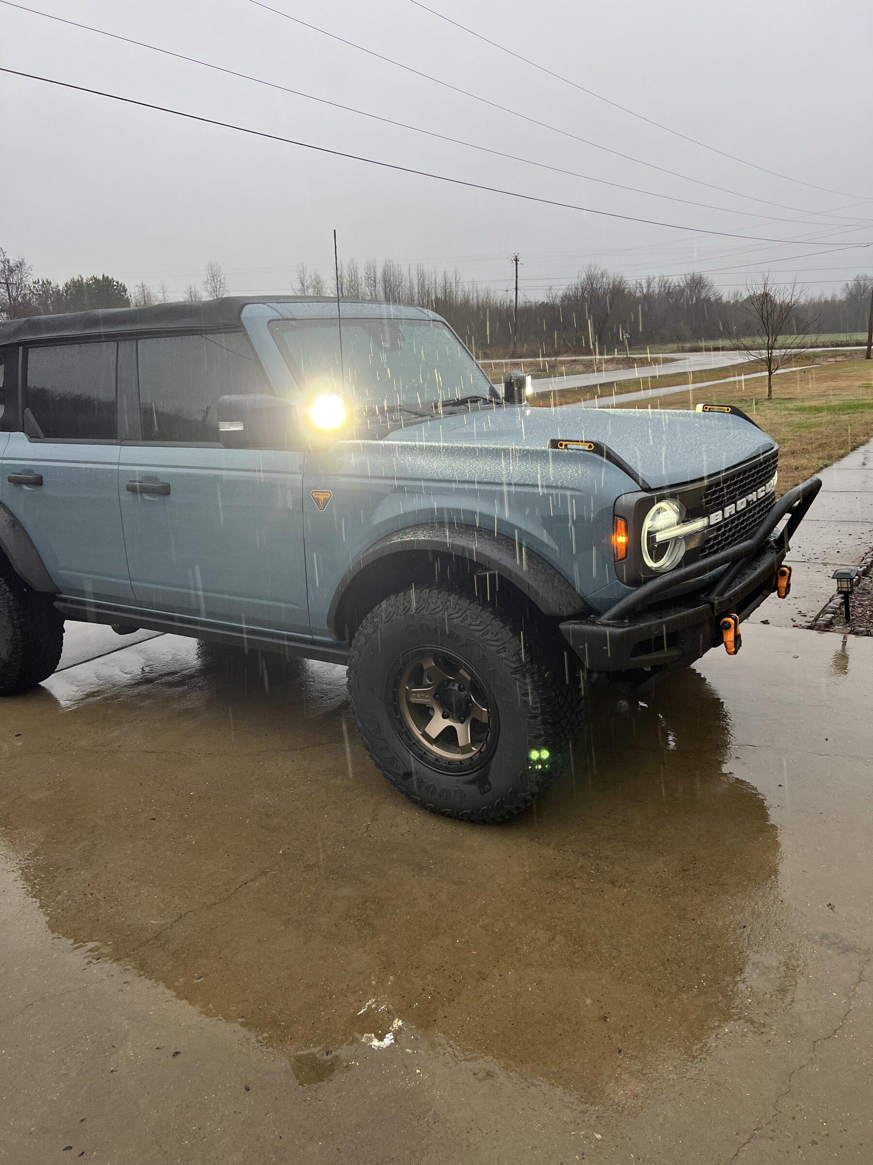

Got the XL80S installed today. Boy those suckers are bright, got a tan trying position them. Lol I love them!! The upfitter harness made it so easy!
Ford Bronco A-Pillar/Ditch Light Kit EEB4AD29-2925-4EA4-92CC-E39E9C77B5B1
Ford Bronco A-Pillar/Ditch Light Kit AFEF3207-2815-44F8-B3F4-FD1046AA48DC
Ford Bronco A-Pillar/Ditch Light Kit C43D84B0-A8A7-4987-8158-65165D1E6C34
Needs a little adjustment, not much
