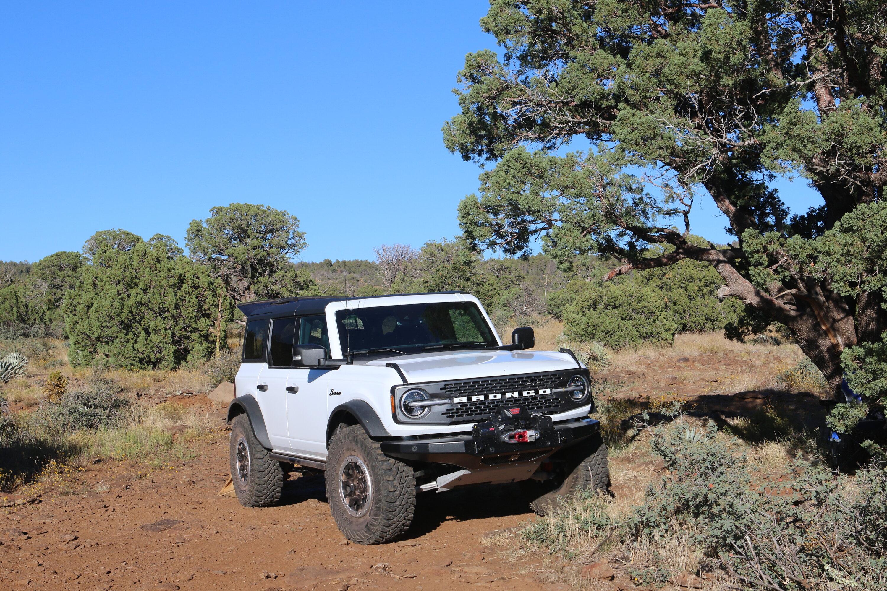

Narrow 37s fit much easier. Nitto Recon Grappler 37x11.5R17. Running Method 17x.8.5 - 0 offset. Only rubbed at top of fender (due to chopped shock bumpstop).
Tire tread measures the exact same as the factory Sasquatch tread width.

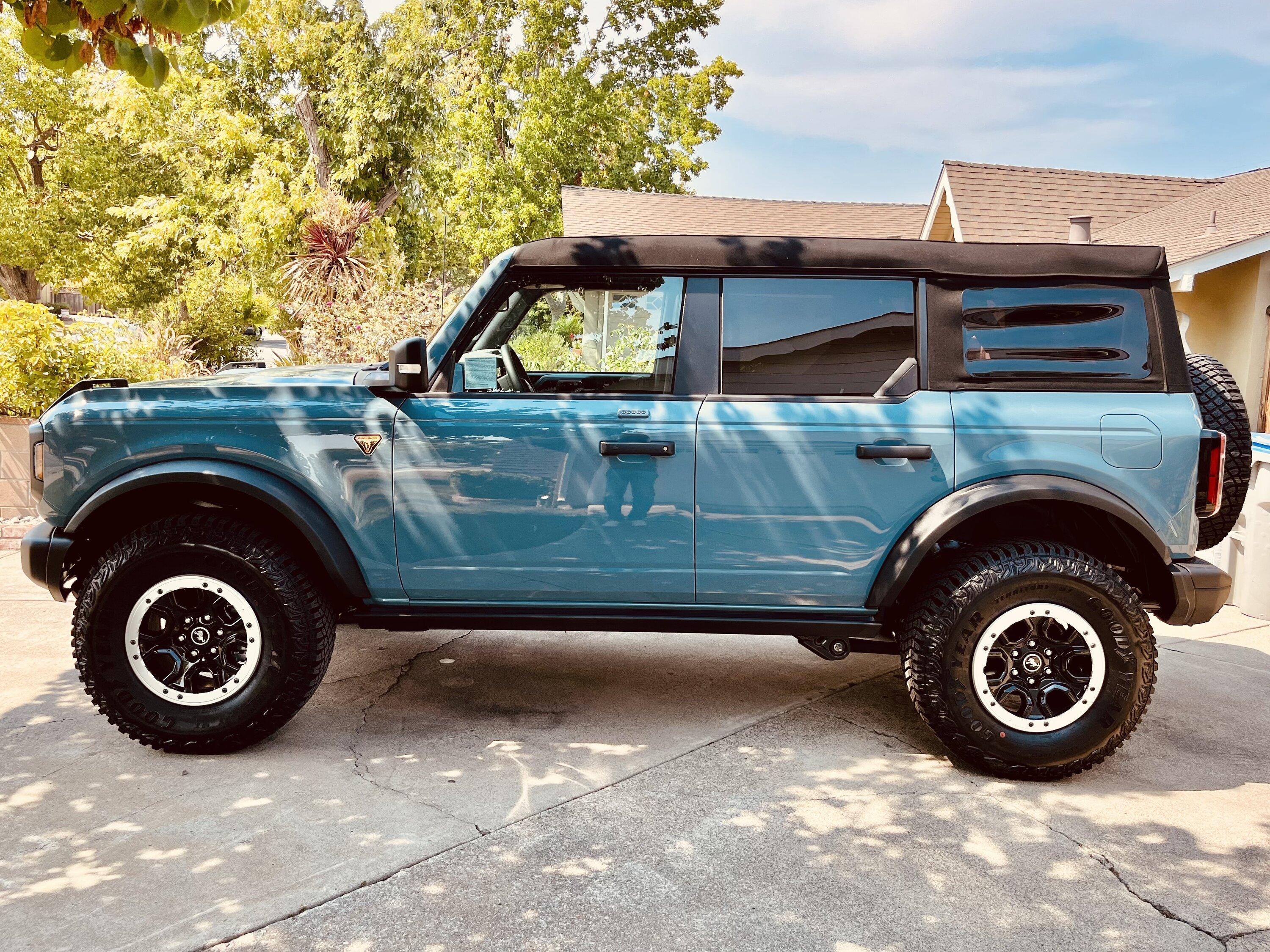

SVC Perch collars, JKS Max Tire kit & 37.125 Geolander MT's & no spacers. It works for me 🤠 .

Nope. Just wheels and tires. It did rub at the top of the fender most likely due to cutting the sasquatch bumpstop in half for increased compression travel. We since have installed Icon coilover which resolved the fender rub (installed their bumpstop spacer to limit travel)>
Narrow is the way to go. And in reality it has the same tread width as factory. Tires also weigh ~10lbs less per tire than wider version. Less impact on MPG as well (think range for off road).

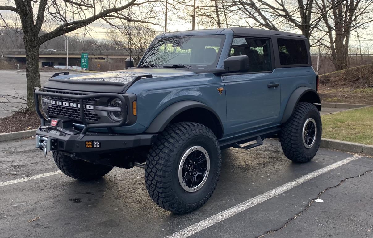

I used the fabtech leveling kit and my 37s clear.
Ford Bronco Advice on Adding 37” Tires? 1708614302951

Any front and side view pics? Do you have a winch or aftermarket front bumper? Thanks.

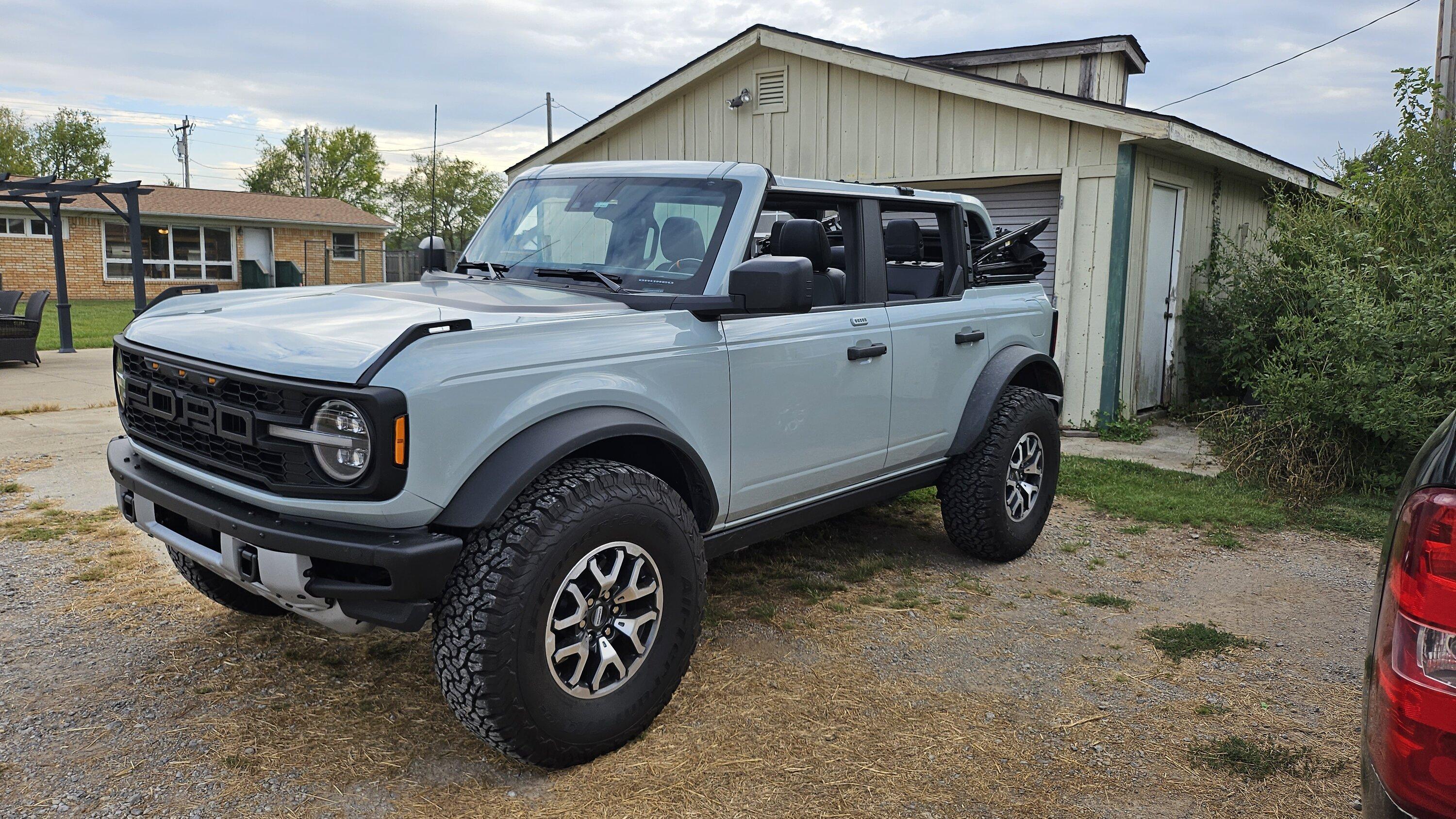

Zone 3”, JKS tire kit, front and rear bumpers, 1.5” spacers and BFG 37” KM3s. Smaller spacers can be used, if any at all.
Ford Bronco Advice on Adding 37” Tires? IMG_8166
