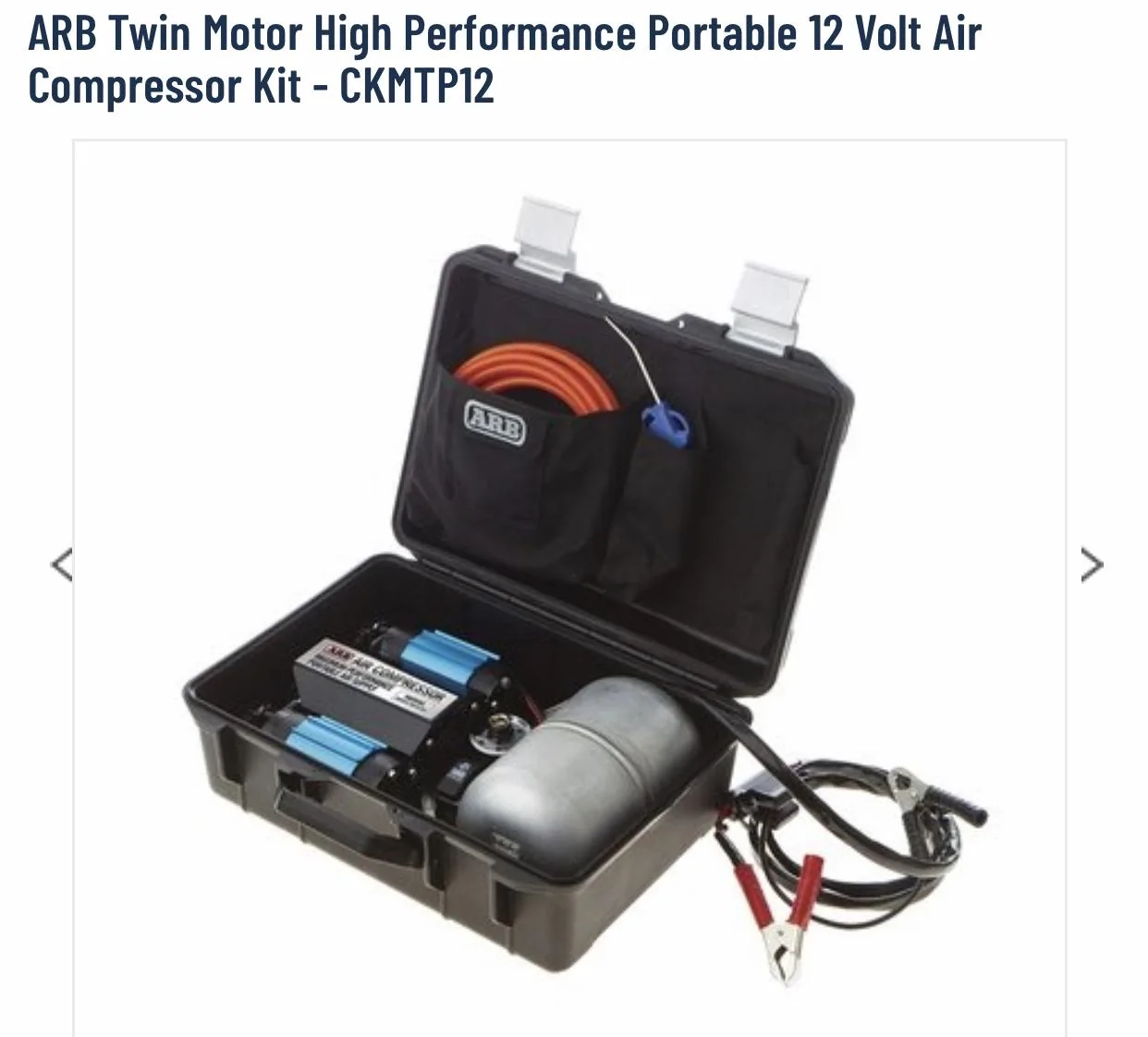

I have a 10# co2 tank, viair 400p & the ARB twin compressor kit w/ tank thats the big brother to the single ARB kit you’re referring to on the B&P. Viair 400p is too slow for me, co2 is quickest, arb twin is the most convenient one of the bunch and with a 2-tire hose, its a breeze. I dont like the hardmount system because all 3 vehicles go offroad. I have a co2 tank mount in my wrangler on the rollbar but not installing a mount in the other 2 vehicles.

fantastic this is just what i was looking for. Seems the dual compressor with a tank will allow you to run tools. However it seems the one ford is selling also has a tank just one compressor.
Might have to get fords version!
No tank with the Ford ARB
