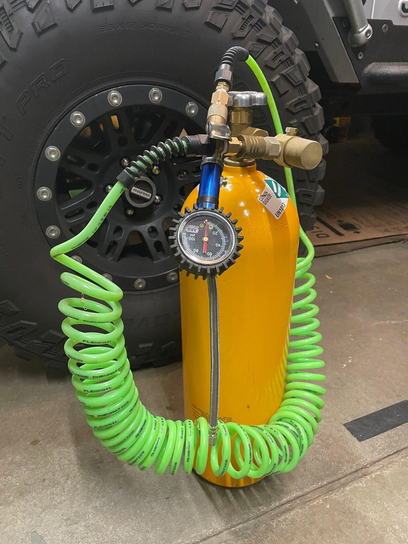

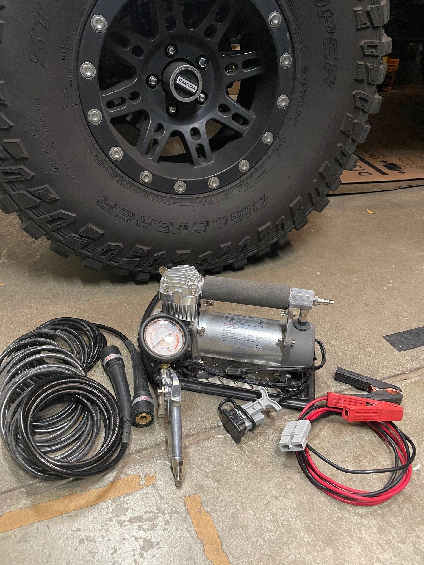

OK after spending some time in the garage tonight, here is what I came up with:
Jeep Tires (35/12.50/15) Cooper STT Pros
Inflate from 18psi to 35psi (times include all 4 tires connecting/disconnecting and walking to next tire):
Viair 400p - 14min 8sec
CO2 tank - 5min 24sec

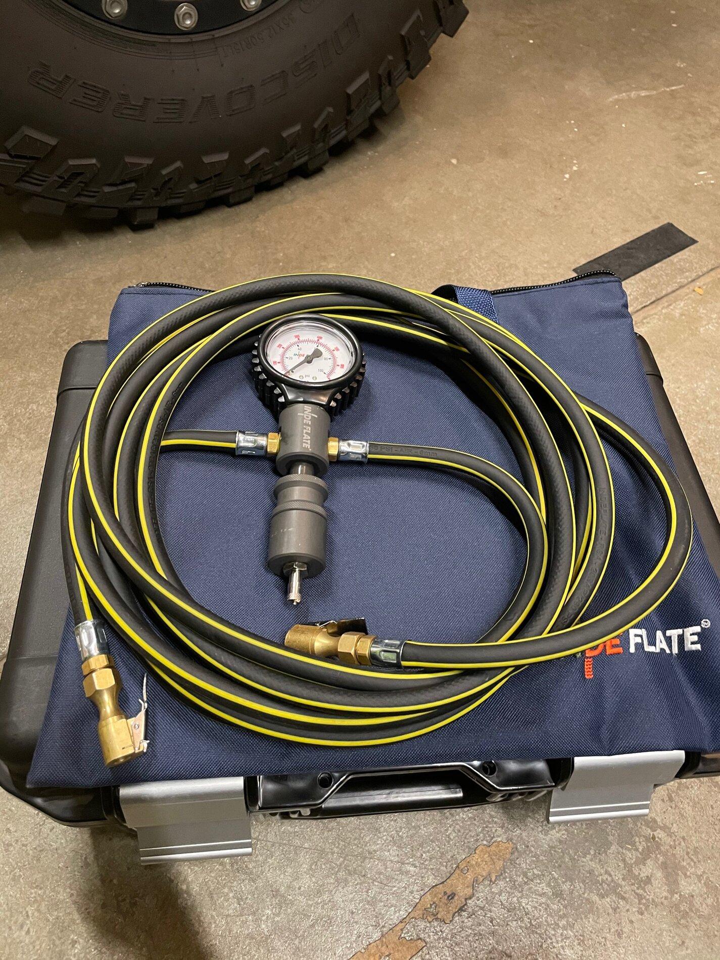

CO2 tank w/ InDeflate 2-tire hose system - 4min 30sec

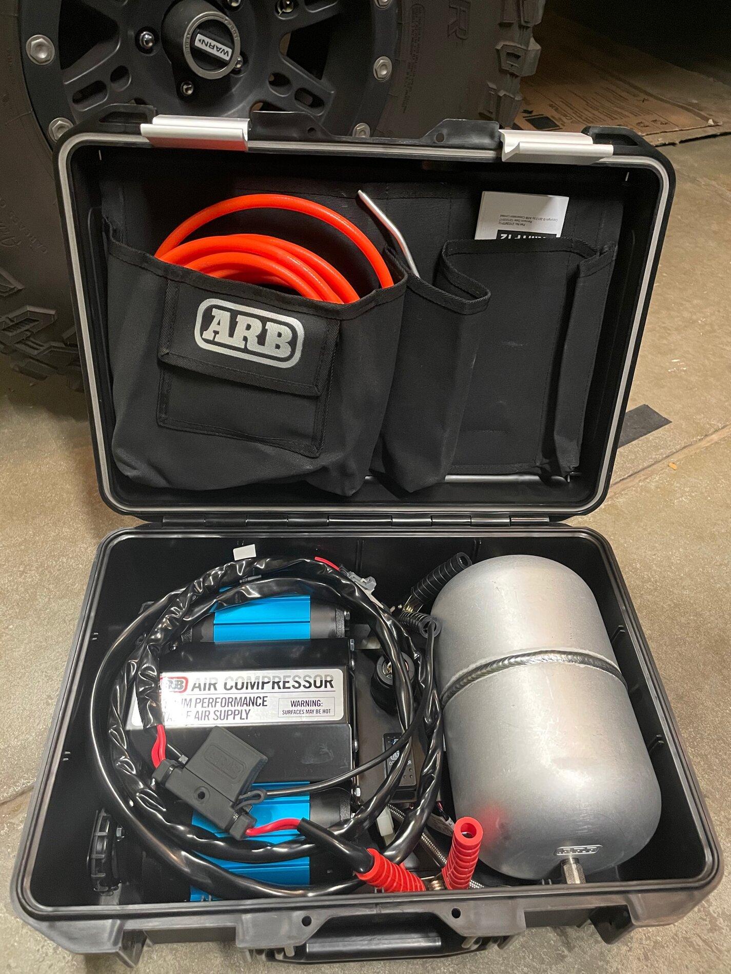

ARB Twin - 7min 32 sec
ARB Twin w/ InDeflate 2-tire hose system - 7min 16 sec

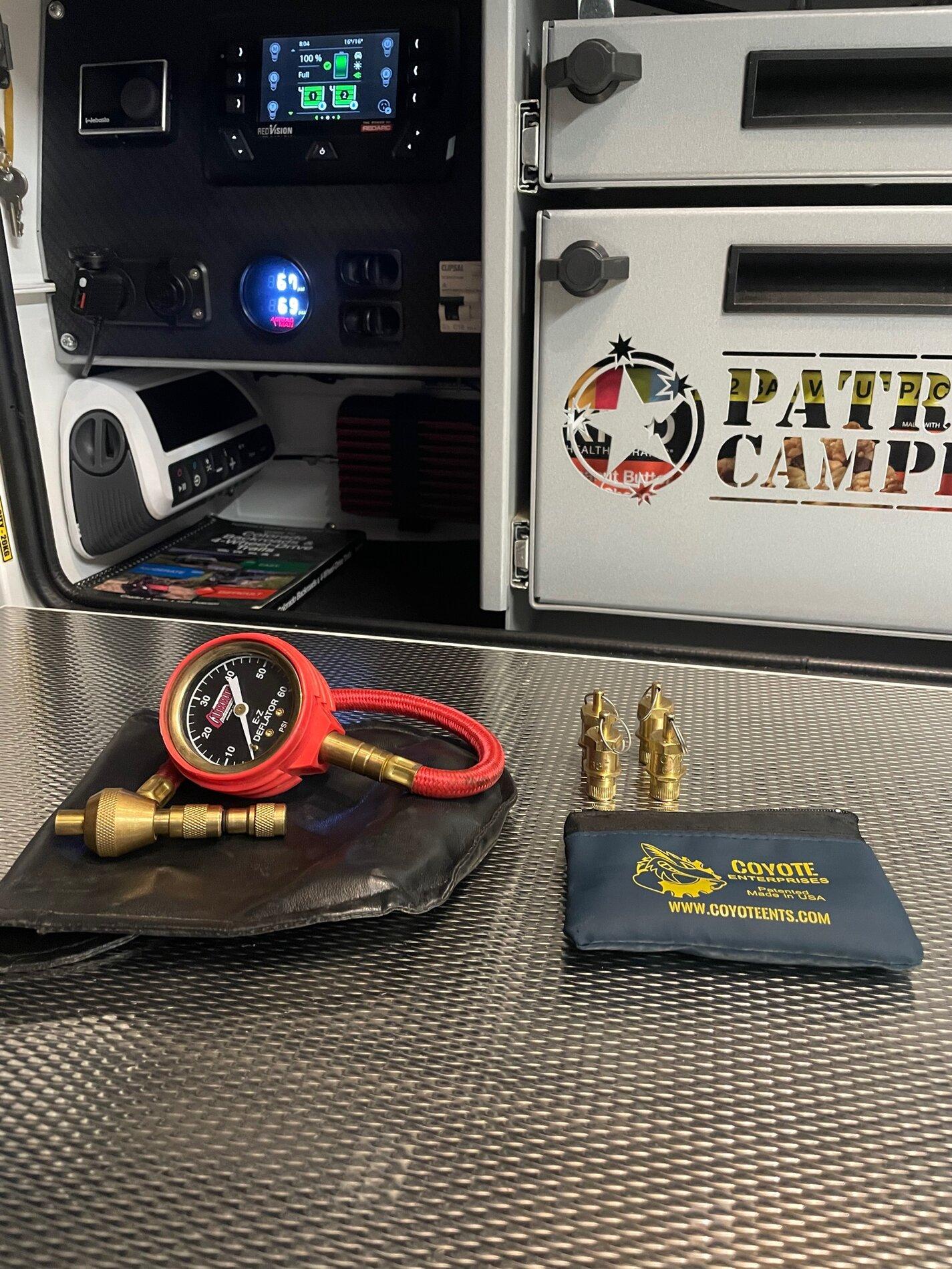

Deflate from 35psi to 18psi (times include all 4 tires connecting/disconnecting and walking to next tire):
ARB E-Z Deflator - 5min 40 sec
Coyote Tire Deflators - 5min 12 sec
InDeflate 2-tire hose system - 7min 0 sec

As you can see, CO2 tank wins hands down, but take into account having refilled or swapping tanks, mounting of large tank and potentially running out of CO2 on a trip.
Viair 400p gets so dang hot after airing up tires that you can't stick it back into its bag and if you're not careful, it'll scold your hand. So while it's cooling down, you have a loose projectile in your vehicle, truck bed or trailer.
ARB twin has internal cooling fan and isn't too hot to touch, can be mounted on your vehicle (under the hood, under your seats, in the rear cargo area etc.), or in my case since I have 3 offroad vehicles - be portable in its own case.

Coyote Tire Deflators are a bit quicker, even though they don't completely remove the valve core like the ARB does. I like them because you literally screw one on, pull the valve and move onto the next tire and do the same. I have my Coyotes preset to 18psi and they auto shut off when they reach 18psi.

Thanks so much for doing this! Results are pretty much as I expected, although I'm surprised the EZ deflator and the Coyotes are about the same. They sure seem easier though.
The winners for me are the ARB twin and the Coyote (or similar) deflators.

The reason the Coyotes are my choice, is you screw them on, pull the pin and walk away and do other things while they're releasing the air. With the EZ Deflator, you have to crouch at each wheel and not walk away so you can monitor the psi.
Most likely my setup will be (deflate - Coyotes on tow vehicle and the Indeflate 2 tire hose setup on the trailer tires) and when airing backup I'll use the ARB twin and indeflate 2 tire hose setup. The indeflate is nice because it pressurizes the psi between the 2 tires and balances them out. So since I run different psi in the rear when towing and different psi in the trailer, I can run the 2 hose to the 2 fronts, then 2 hose to rear and then 2 hose to trailer, giving me 3 different psi.

You guys do realize this is the same ARB single compressor that you can buy and they sell under the hood mounts? I have one mounted under the hood of my jeep to power my air lockers.
On my viair, I actually have an anderson connector in place of the battery clamps and it plugs into the rear of my tow vehicles, since the tow vehicle's anderson plug is what charges the batteries in our camper.
Reason I went with the portable kit vs hard mount (under hood, under seat, rear cargo area etc.) is because I never know which vehicle I'll be hitting the trails with.
