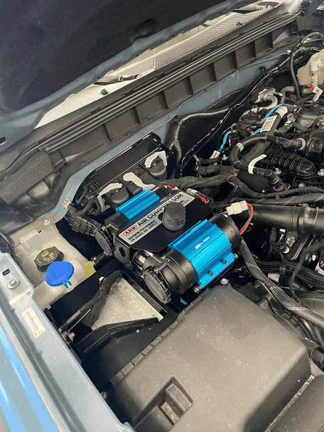

I know this is an old post. But we actually came up with a design for an on-board air system mount. Our bracket bolts right into the engine bay using factory mounting points and allows you to use an ARB Single or Twin compressor. Installation is pretty easy
https://www.4x4truckleds.com/kr-off-road-arb-compressor-engine-bay-mount-for-2021-ford-bronco/
Ford Bronco On board Air 1664552800408

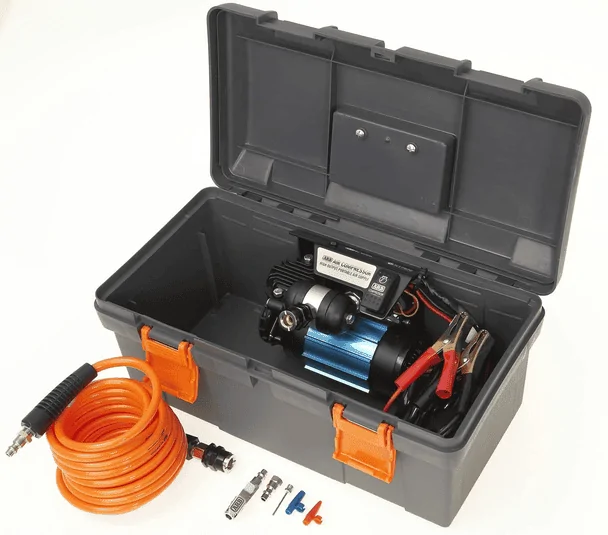

ARB Single: https://www.4x4truckleds.com/arb-high-output-portable-air-compressor/
Ford Bronco On board Air 1664552828588

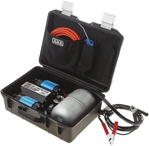

ARB Twin: https://www.4x4truckleds.com/arb-twin-high-performance-portable-compressor/
Ford Bronco On board Air 1664552837697

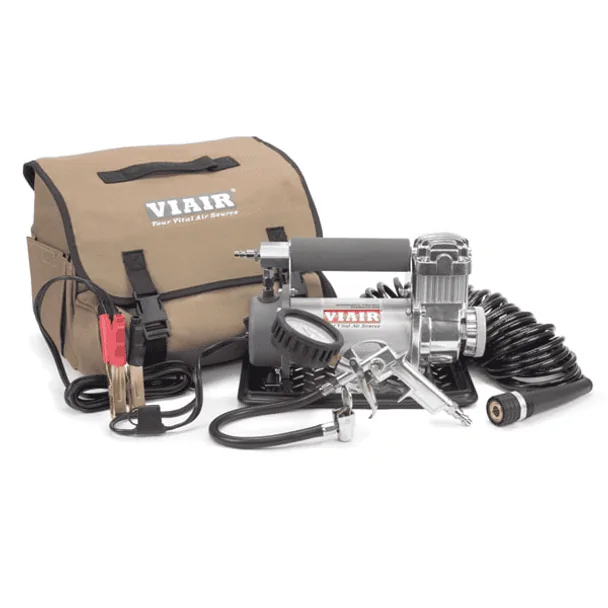

ViAIR 400P: https://www.4x4truckleds.com/viair-400p-portable-compressor-12v/
Ford Bronco On board Air 1664552849789

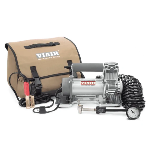

ViAIR 400P Automatic: https://www.4x4truckleds.com/viair-400p-automatic-portable-compressor-12v/
Ford Bronco On board Air 1664552861539
The difference with the ViAIR 400P and 400P Automatic is that the automatic has a built in pressure switch, so the compressor turns off between tires.
The ARB Single and Twin have this built in as well.
