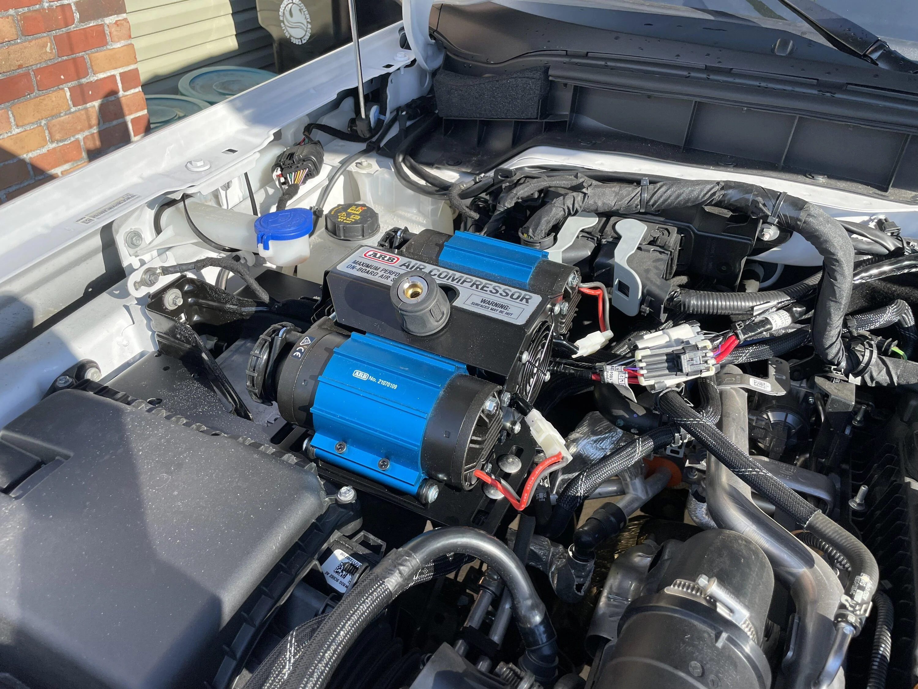

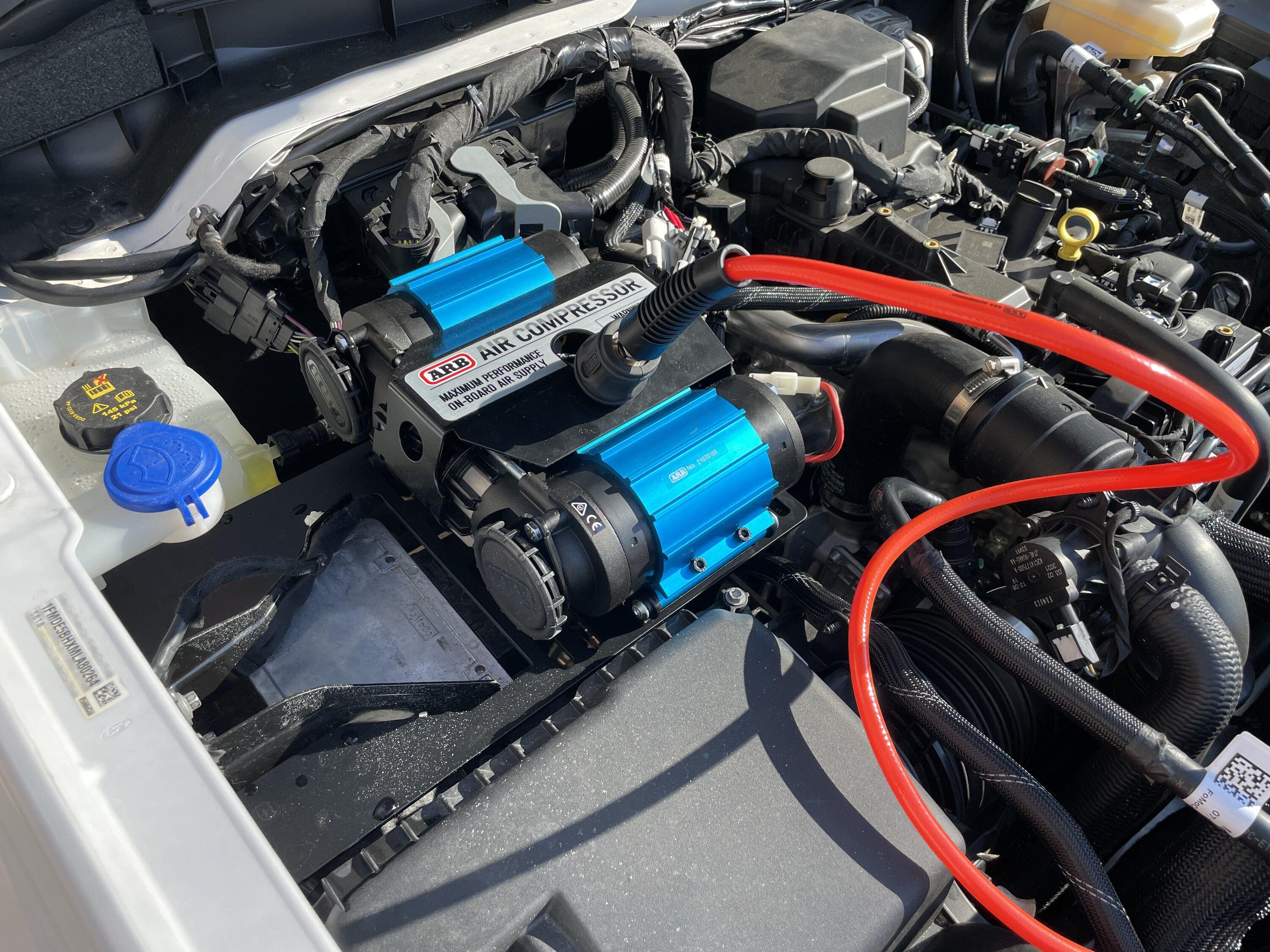

Is there general consensus on what is the optimal compressor mount? I have a 2 door 2023 Wildtrak Sasquatch and plan to install an ARB dual on-board compressor. I know that there are numerous options including engine bay, inside spare tire carrier, and under/in the trunk. I am sure that each has its pros and cons but maybe those of you with real world experience could give some guidance. Thanks!
Our patent pending KR Off-Road Mount is the easiest mount to use. We were the first to come out with an air compressor mount for the Broncos and put it under the engine bay. This leaves it out of the way and when you are airing back up, you don't bother passengers inside. We actually make our mount from stainless steel (everybody else uses cheaper steel) and powder coat it black. So it'll last the life of your truck. It's also made right here on Long Island (New York) so in the good ole USA!
It uses factory bolt points so you don't have to relocate anything and as I said, it installs easily. It'll support an ARB Single or Twin Compressor.
ARB Air Compressors are built to withstand a lot of abuse. They were designed in Australia where ARB is from, and those guys KNOW wheeling better then anybody, especially with their terrain. So these things work great in the engine bay. We also keep the air compressor at the very top so it doesn't get as hot as say the Jeep JK mounts (which mount them near the manifold which gets VERY hot, but still works).
We offer a complete kit and if you use coupon code BRONCO6G you'll save 10% on the entire kit.
https://www.4x4truckleds.com/kr-off-road-air-compressor-engine-bay-kit-for-2021-ford-bronco/
Ford Bronco Best on-board air compressor mount Photo Jan 23, 1 30 33 PM
Ford Bronco Best on-board air compressor mount Photo Jan 23, 1 31 04 PM
Check out the installation video here. Pretty easy to install. Justin used a different switch panel since he didn't realize we make a switch panel (and he doesn't have upfitters). But if you have the upfitters you don't need to worry about the switch. And if you don't have upfitters, we make a VERY easy to install switch kit (plugs right into the air compressor):
