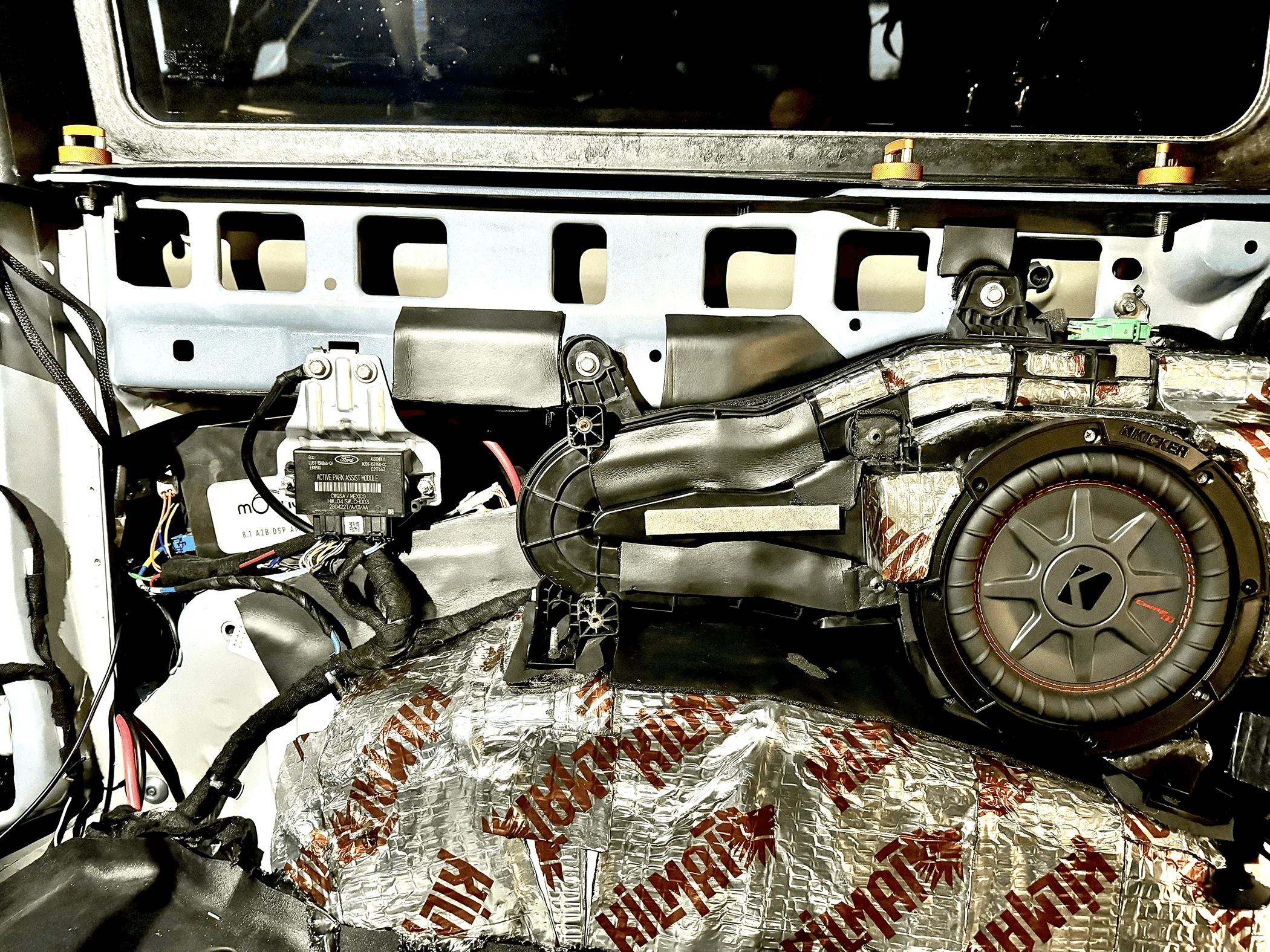

That's what I just did this week - had to stuff it in here since the 2D panels won't fit over it when you mount it to the stock sub enclosure.

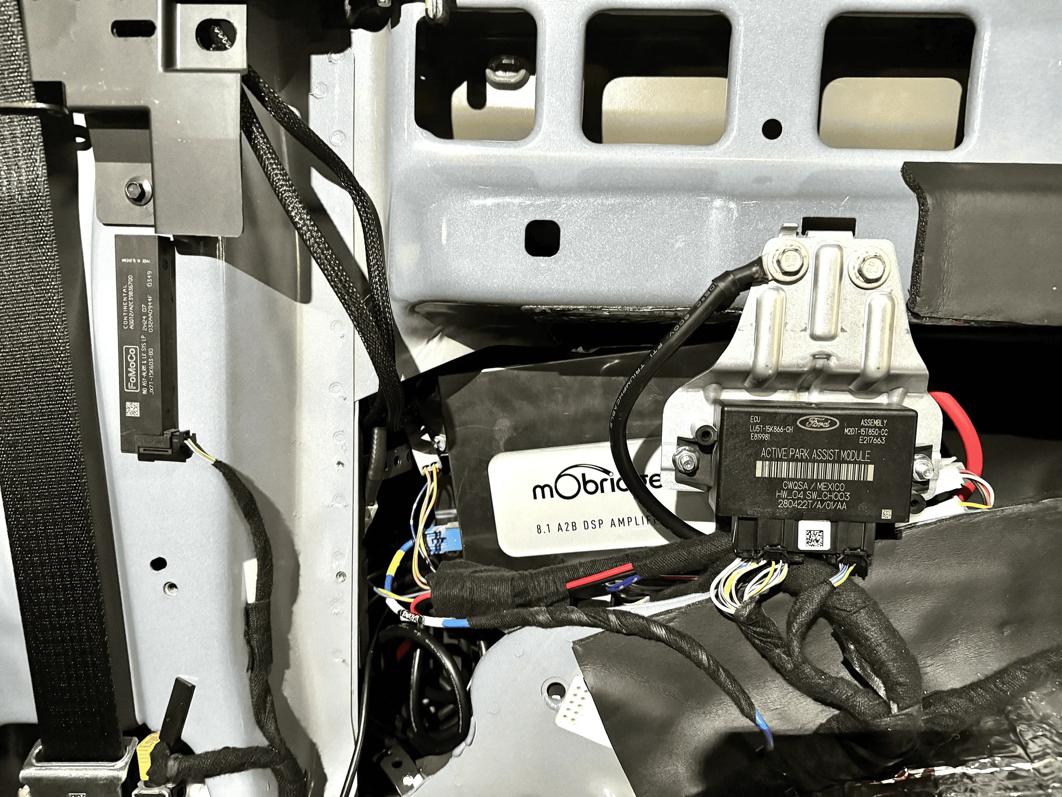

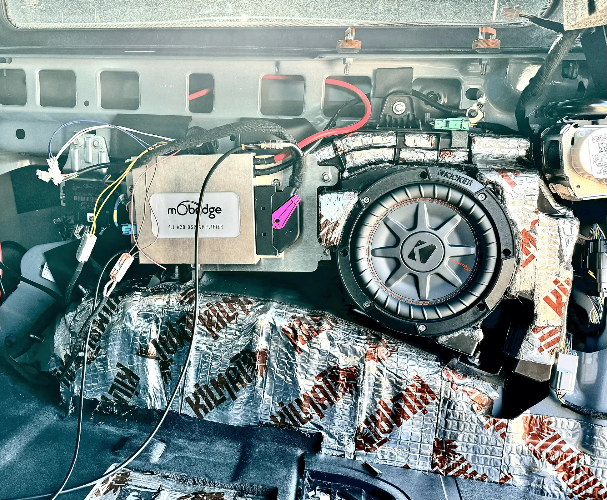

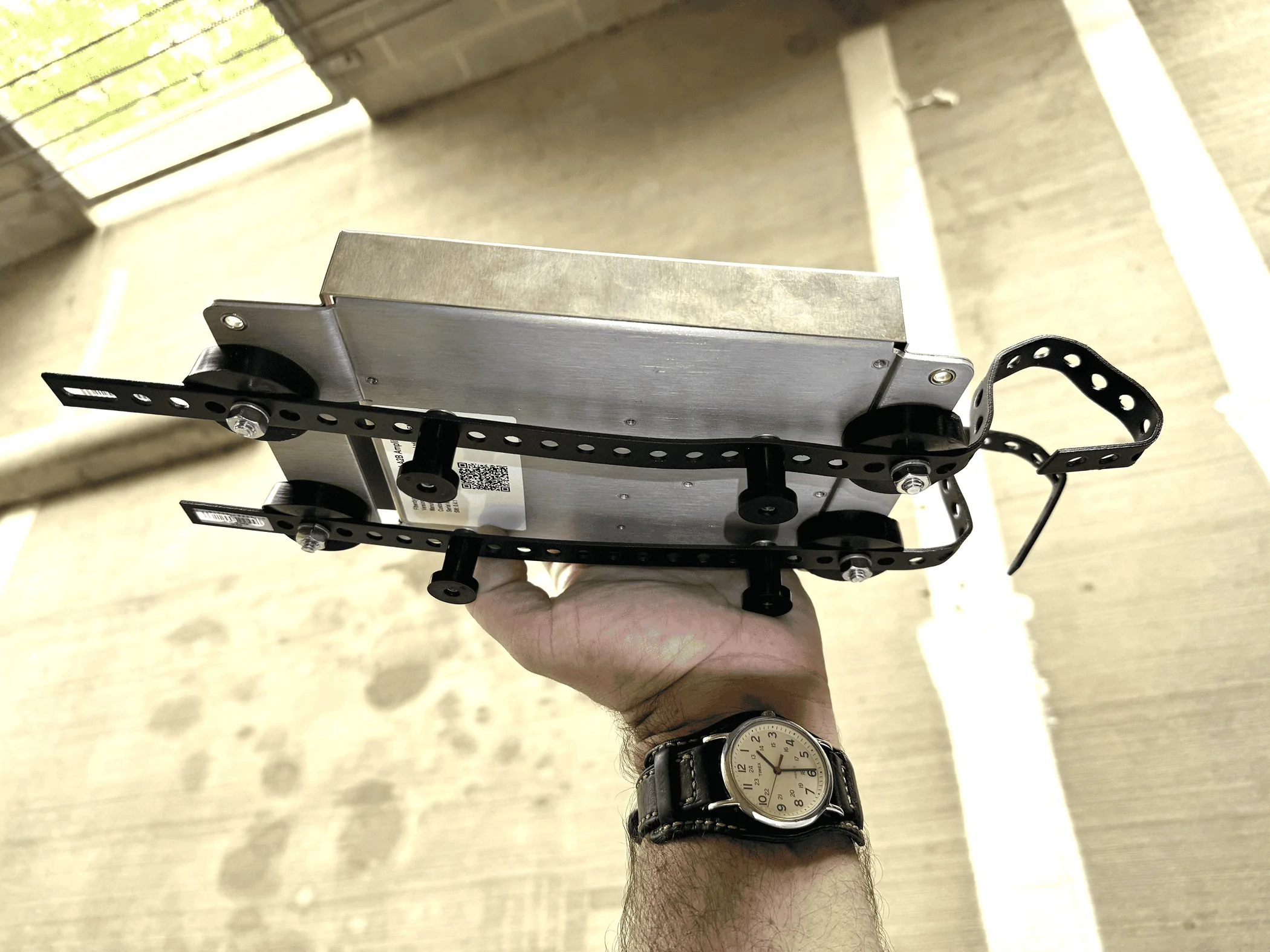

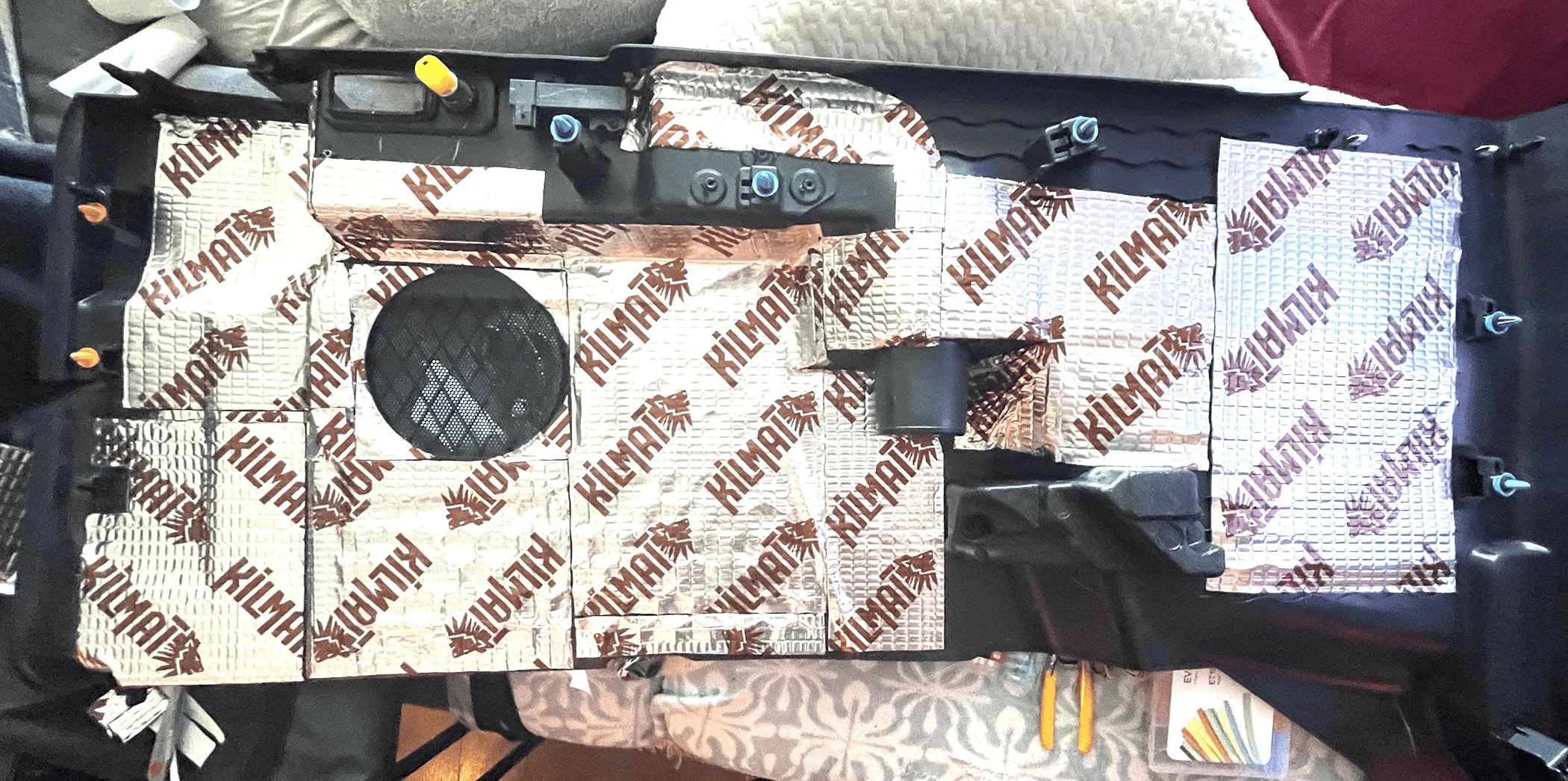

Quick before and after for ya -
The main issue with that location is that it's just a sloping hole... if I were smarter and had a 3d printer, I'd print a little wedge "plug" or platform to put in there to give you a flat level surface to make things easier.
I took the unit off the mounting plate and created the world's ugliest bracket system and re-mounted it to that using 1'' rubber shock washers as standoffs, then more 1/4'' standoffs behind it to keep it off the outside wall metal surface.
I was about to drill a new ground bolt hole, because the ground wire is a bit short, but took a risk and screwed it into that hanging plate and everything seems to be working fine.
Panel went back on, no issues other than the extra weight of dampening stuff I put on it.
