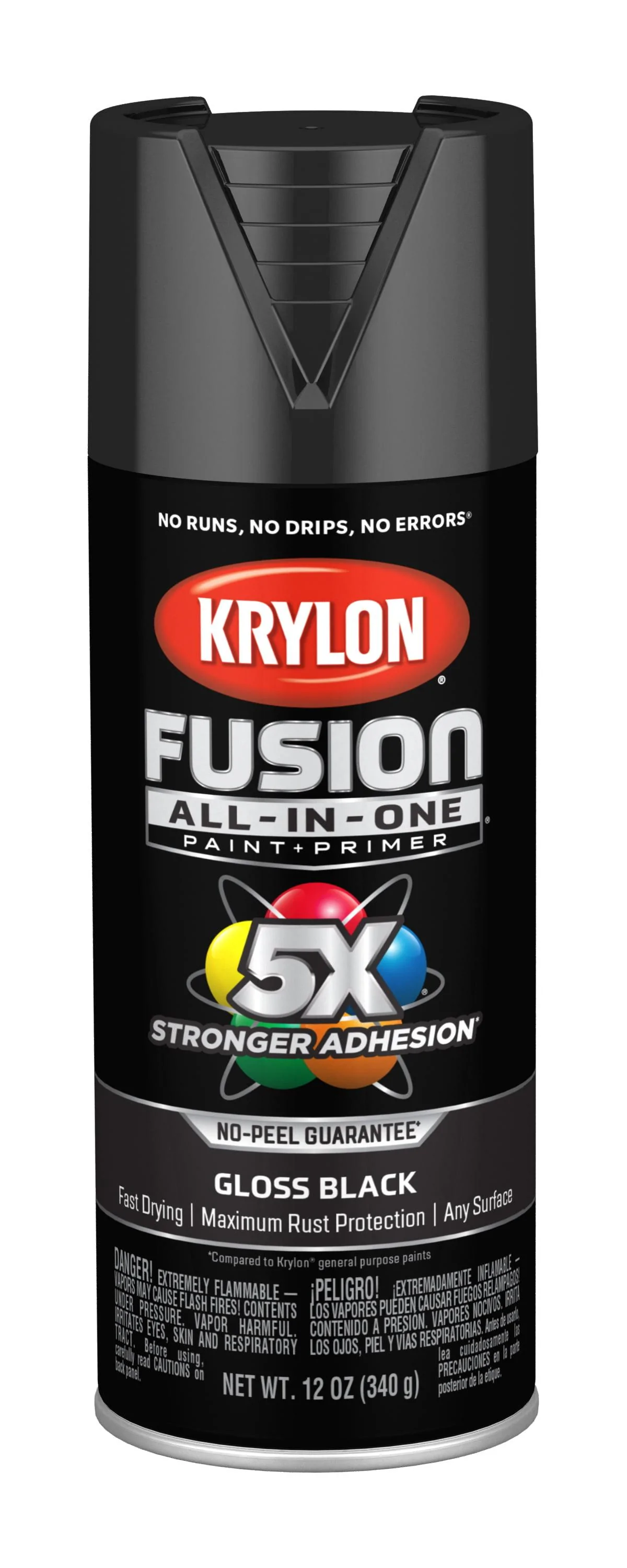

Im in the Desert South West, but I just taped off, scuffed it with some 220 grit , and painted it with Krylon flat black. I have GOAT Fab sliders which hide most of it. Ive had no issues at all, self car wash sprayer and all???
