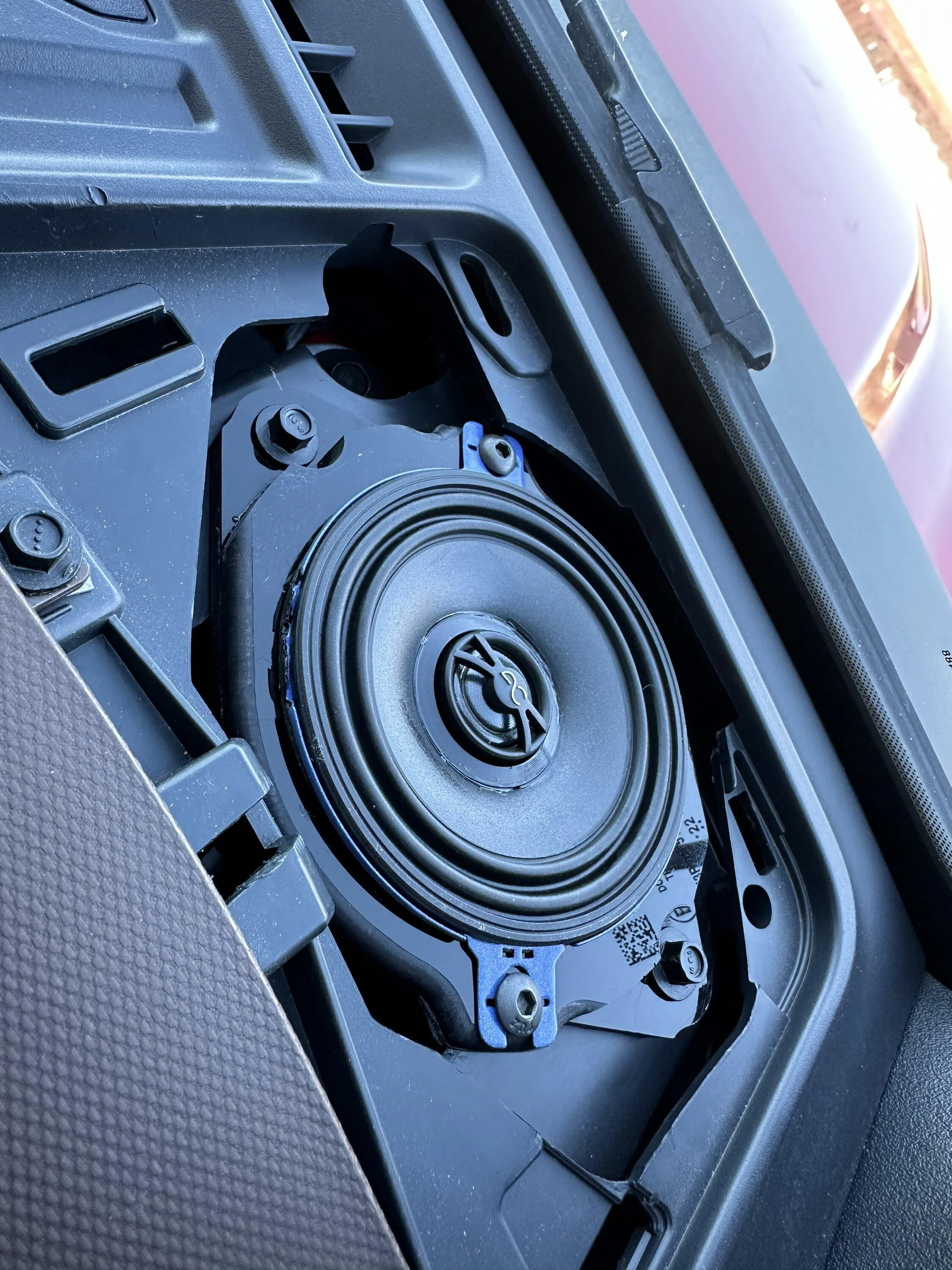

Installed the 3.5” Audiocontrol PNW speakers in the dash. Still powering off factory B&O amplifier as I build rack for aftermarket amps. Pleased with the sound and output of the new Audiocontrol speakers
Ford Bronco Audio Control 4" Speakers review? IMG_0183
Ford Bronco Audio Control 4" Speakers review? IMG_0182
but anxious to see what they can do with more power and dsp tune.
Had initially installed Audiofrog GS42 in the dash but changed as the PNW 3.5” speaker align better with the factory speaker grill.
