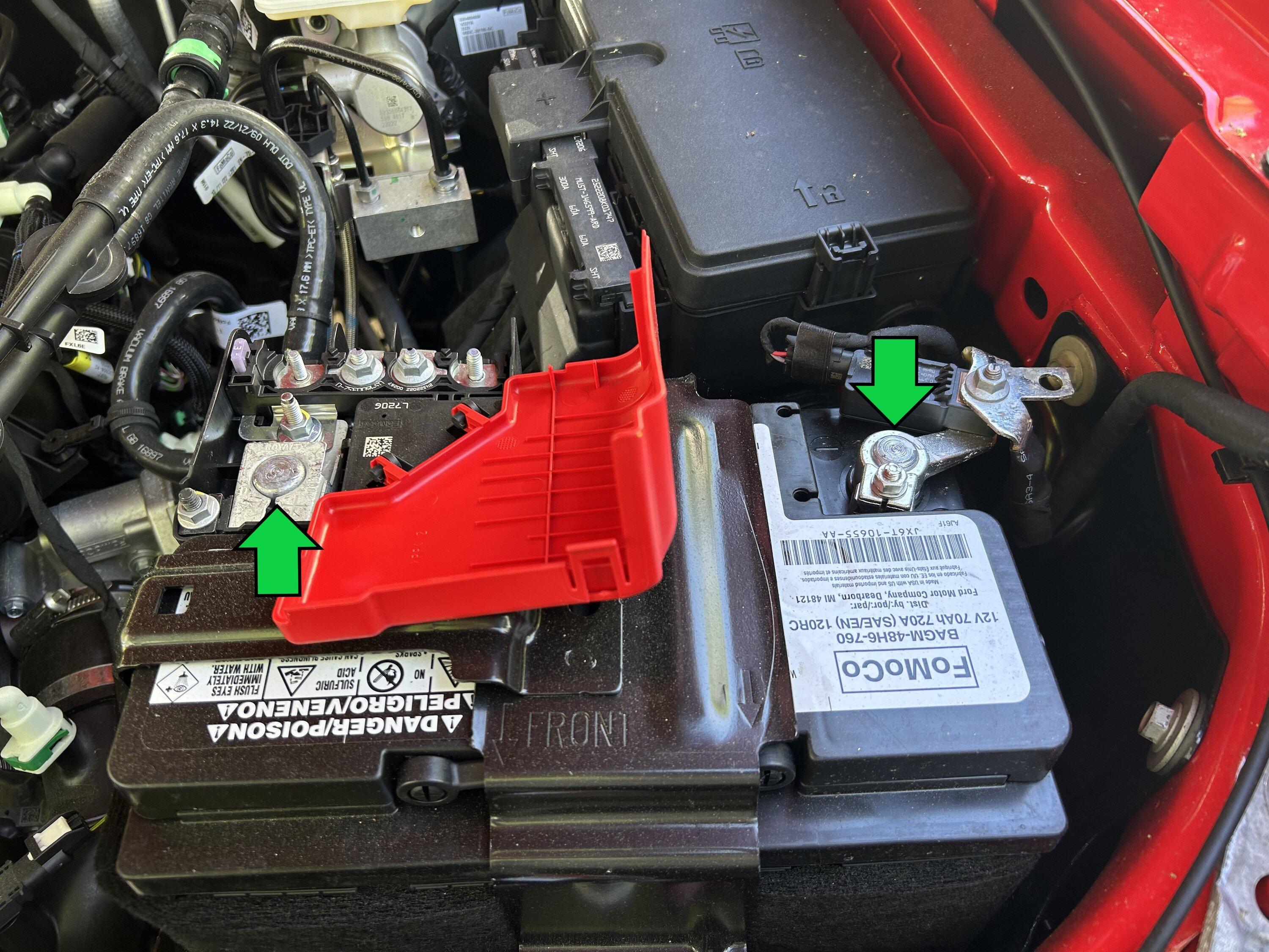

Great info!! Thanks! I have my battery hooked up to an AGM rated trickle charger now but I have it hooked right up to the battery terminals. Is that wrong?
That is in fact incorrect.
You can see the BMS hanging off the negative battery terminal - that little black box on the negative terminal. It's kind of hidden underneath the green arrow in this pic.
(I'm stealing an image from another post here)
Ford Bronco Auto Start Stop Staying Off!! img_1543-
If you hook the negative directly up to the terminal, you bypass the BMS and it can't see the battery charging - so it won't reset the amp-hour calculation (battery life).
You need to ground to the chassis, or to that tab over to the right/along the upper bolt for the main cable. That puts the BMS in the loop and then it can see, and correctly count, the amps going back into the battery and keep the battery life calculation accurate.

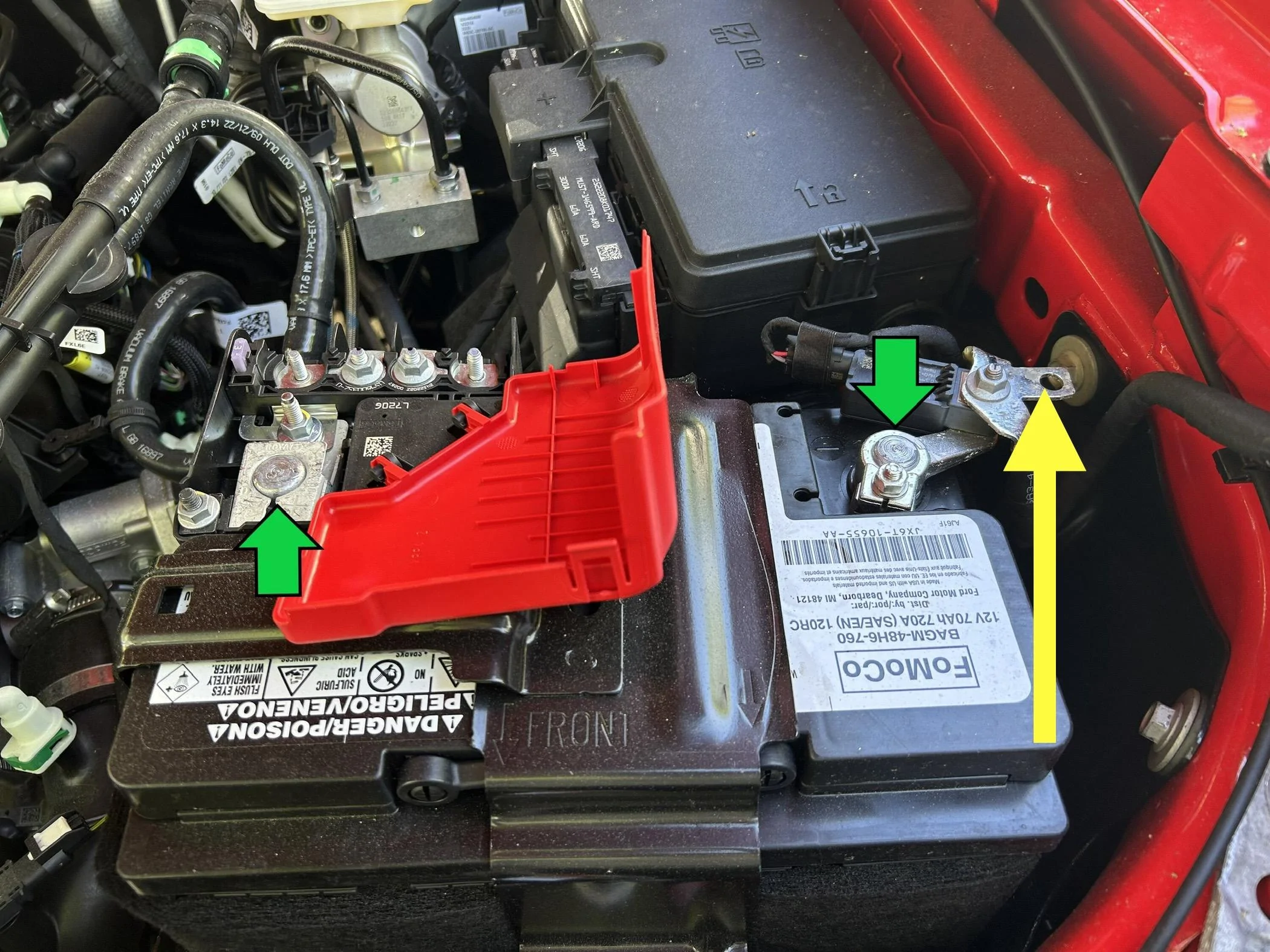

Ok so then attach negative to the tab with yellow arrow?

I just moved it to that tab with the yellow arrow but it was sitting for a few hours on the negative terminal itself (incorrectly). Have I ruined anything?

No harm. You provided voltage across terminals that always have voltage across them. You just didn’t include the BMS intelligence in the loop. Including the BMS adds the system into the charging process; good for protection of the battery, the electronics and the rest of the system and updates the BMS with the battery charge status.
