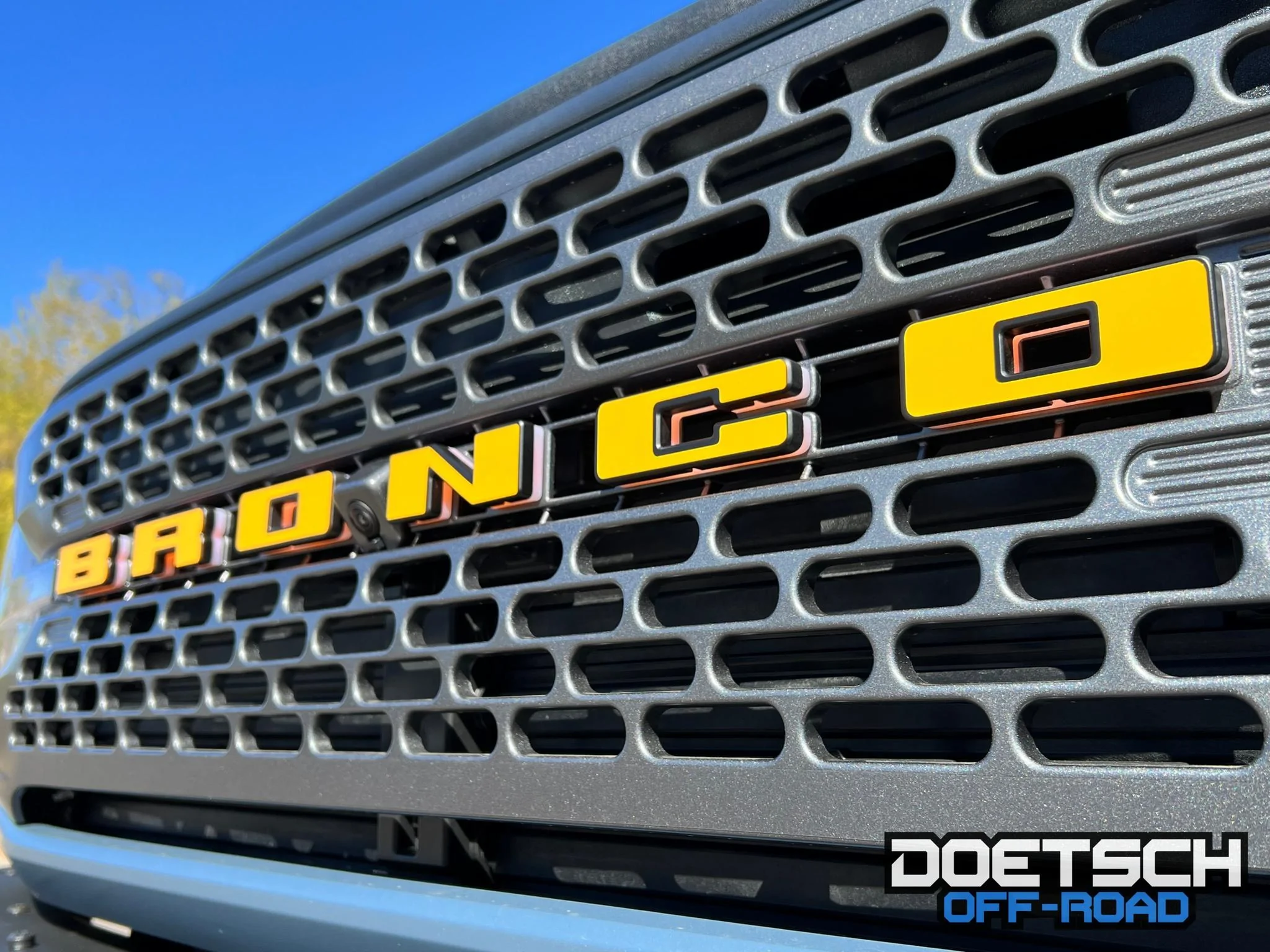

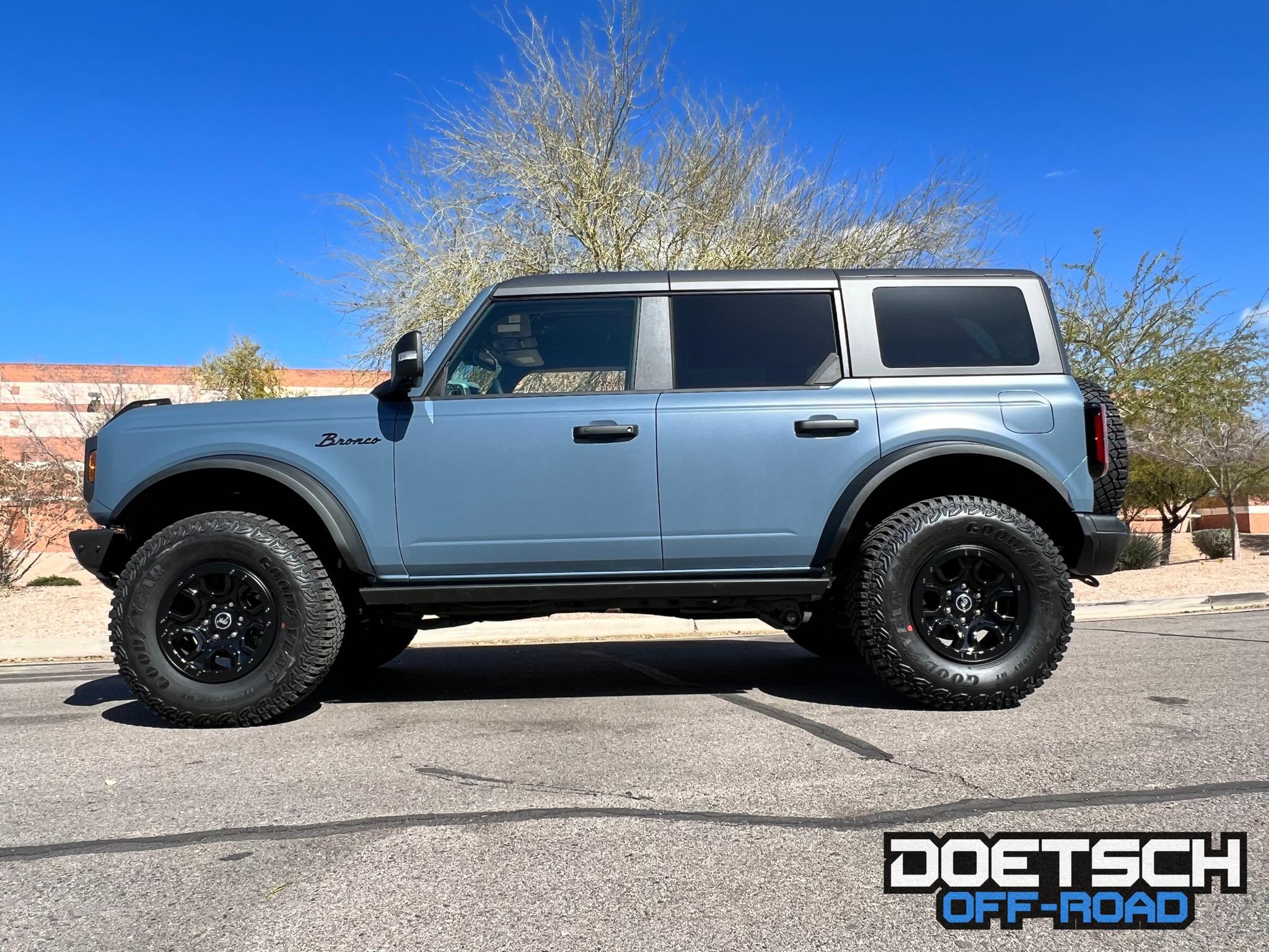

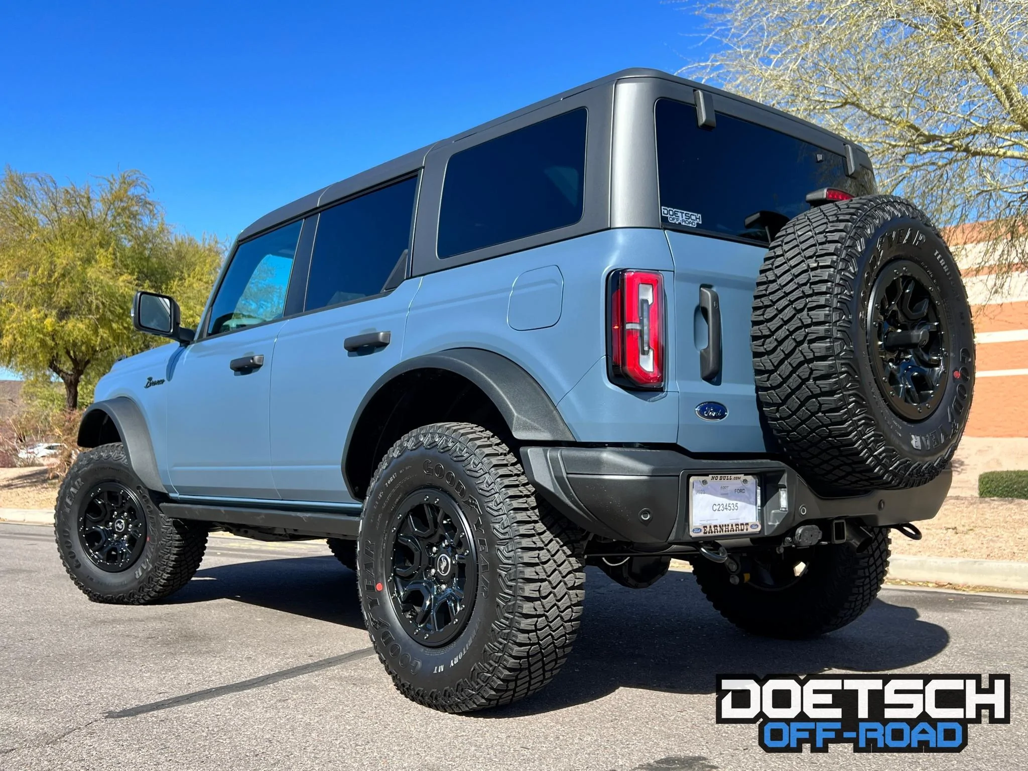

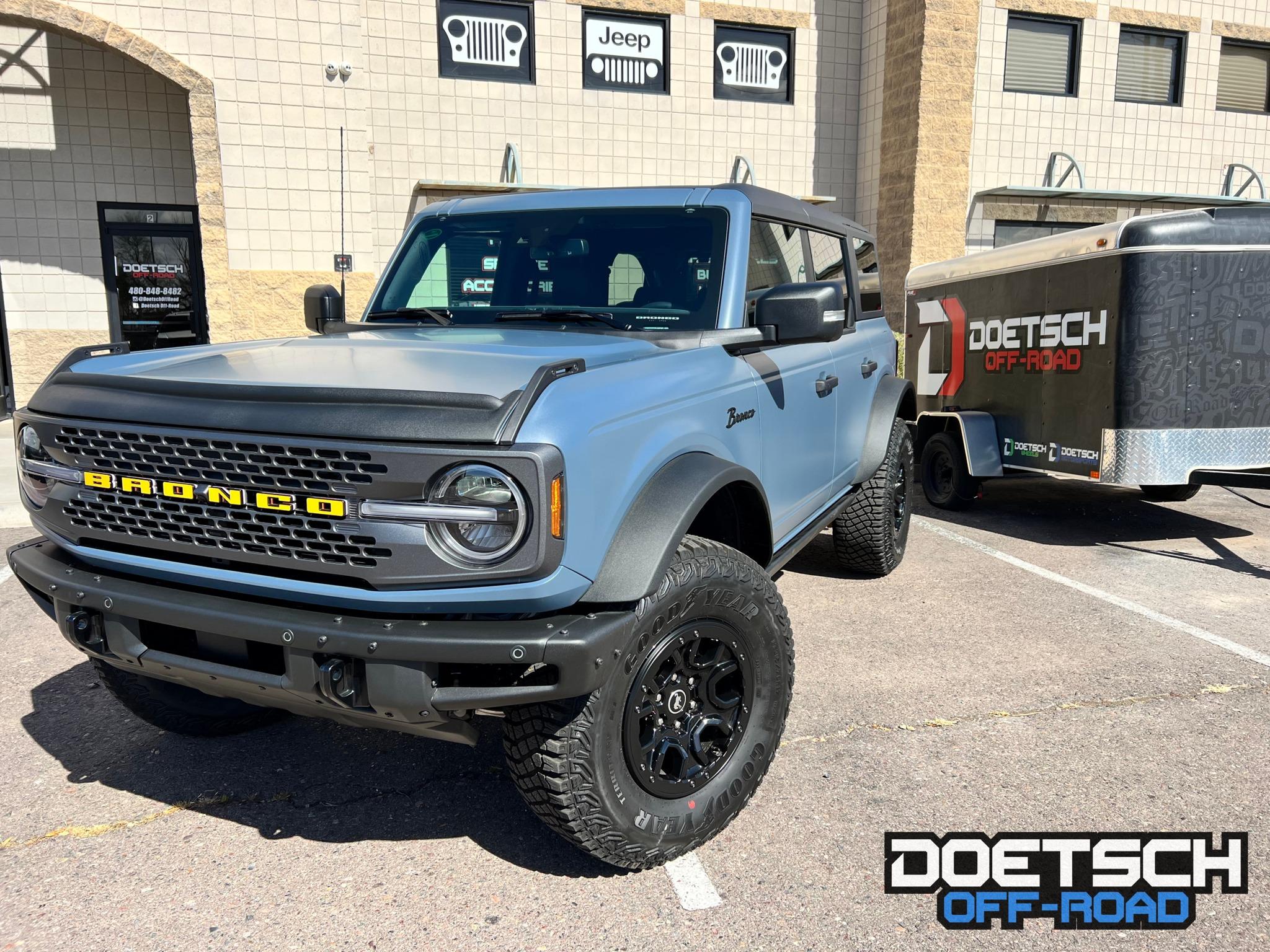

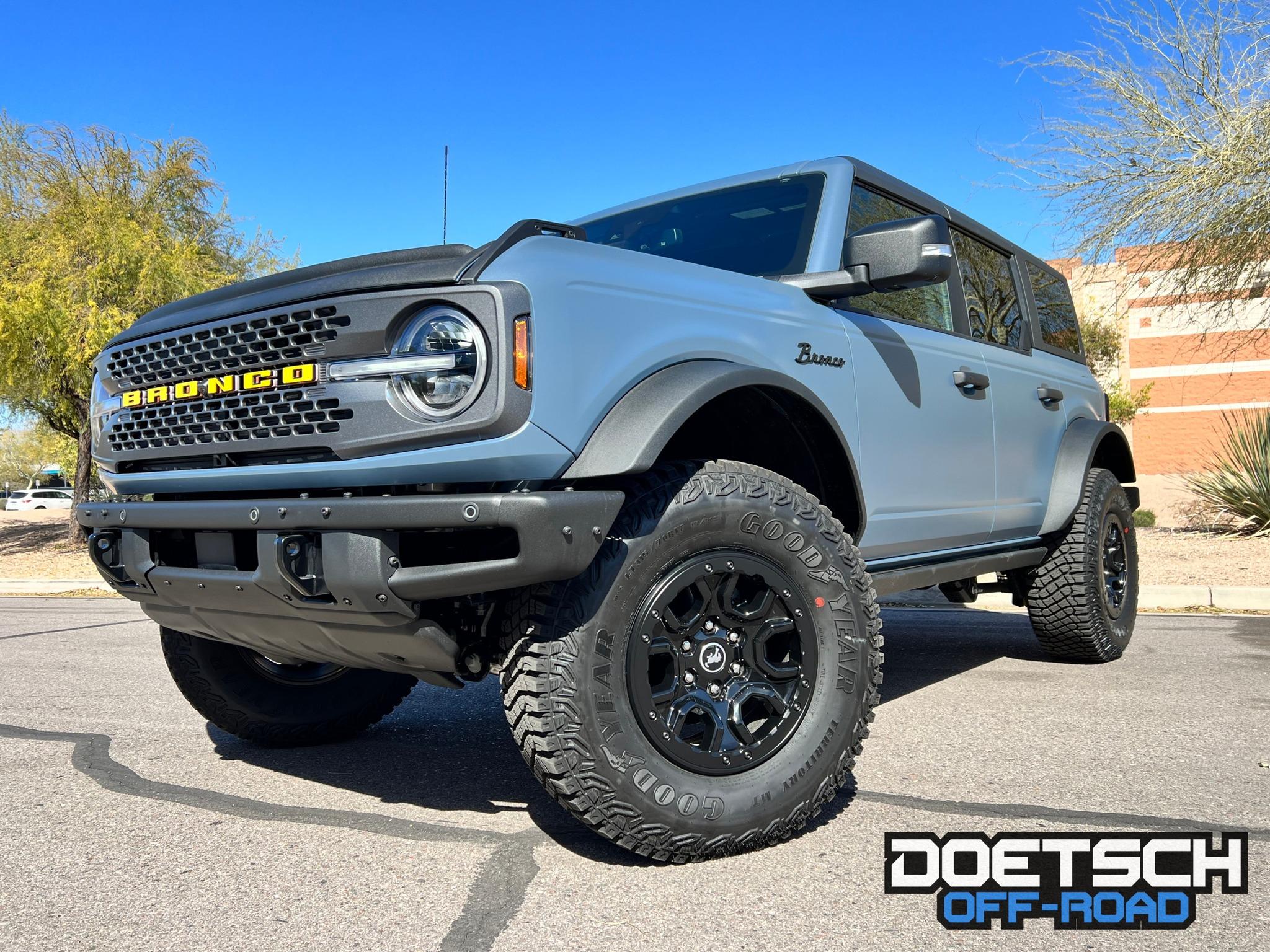

Jamie just picked up his Bronco Badlands that features a brand new color, called Azure Gray Metallic. He brought it straight to us to make that new color pop even more, by applying an XPEL Stealth paint protection film (PPF) over the entire Bronco (minus the hard top). The Stealth product is a clear film that turns matte, whatever color is underneath. It provides the change effect of a traditional vinyl wrap, with the benefits of PPF such as being self-healing and more resistant to rock chips and scratches.
Next we added a 1" Zone Offroad lift to level out the Sasquatch equipped suspension, then installed a set of Oracle Lighting "BRONCO" letters with amber LED backlighting, capped off with custom orange vinyl letter overlays.

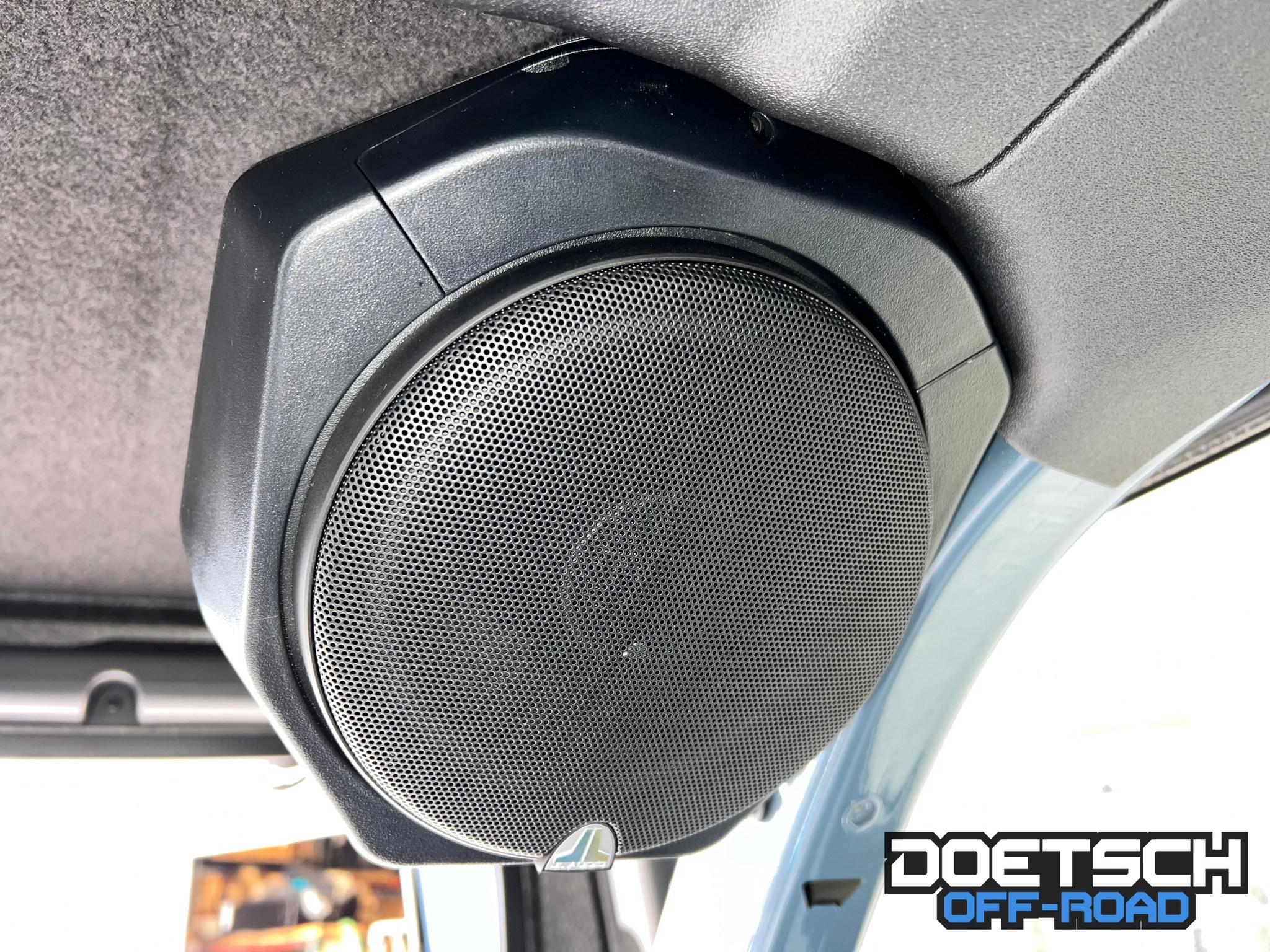

We also increased his tuneage thanks to a pair of rear speaker pods stuffed with 6.5" JL Audio speakers, as well as a custom designed tailgate subwoofer enclosure that's Rhino Lined and filled with a 12" JL Audio Sub. A JL 1000x5 amplifier carriers enough wattage to run the new set-up and to make this Bronco rock the block from here to San Tan!

Sweet build! Can you post the links to the speakers you have? I never even thought of replacing the entire rear speaker shells for some beefier speakers. Also very curious about your subwoofer. Is that using the same box as the stinger? Thanks in advanced!

Nice! I apologize, I should've been more specific. I'm referring to audio upgrades.

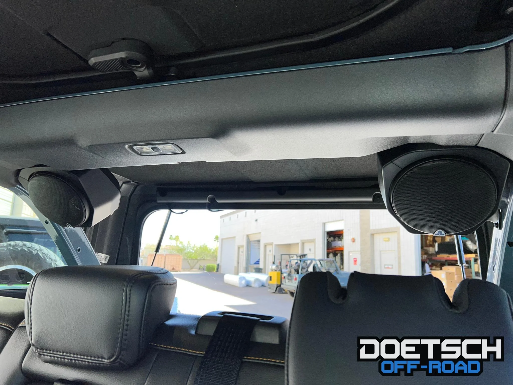

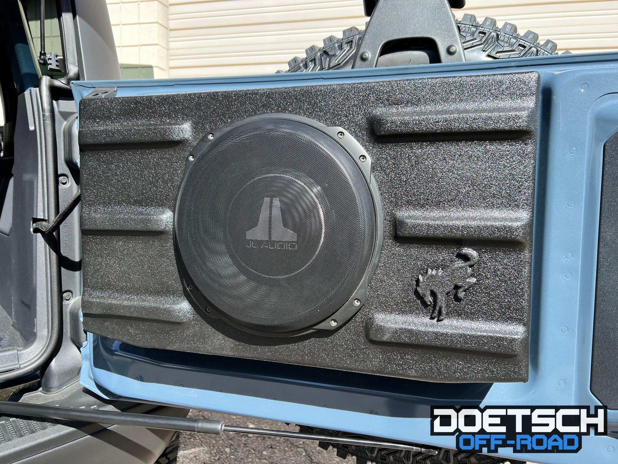

https://ssvworks.com/products/2021-2023-ford-bronco-rear-speaker-pod-add-ons
https://www.jlaudio.com/collections...r-audio-speakers-c3-convertible-systems-99022
https://www.jlaudio.com/collections...ducts/12tw3-d4-car-audio-tw3-subwoofers-92185
https://www.jlaudio.com/collections...ucts/vx1000-5i-car-audio-vxi-amplifiers-98632
Sub box is wood and bondo with bedliner. Custom made to the correct airspace. Very different from STiniger.

Thank you! Replaced all the 6 in speaker in the dash, new amp and added the stinger box with the Phoenix Gold 12 in sub. Only speakers left to replace were these and the 6.5 in pods is exaclty what I was looking for. Just purchased.
