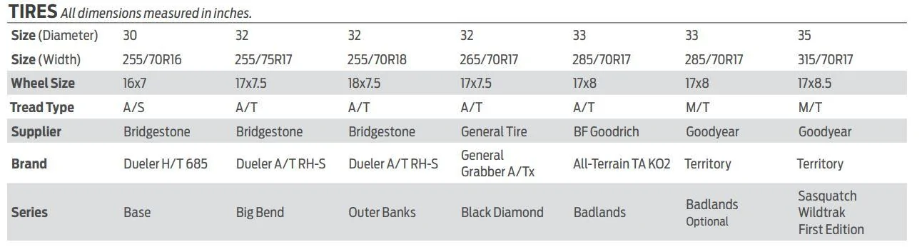

I love the fact that the badlands can run 35's from the factory. It's been asked a few times but I didn't see this exact question. I was also thinking of skipping the sasquatch based on the fact that you get most of that package standard on the badlands.
I like the look of the factory rims but I really don't need mud terrain 35's. I'd prefer something in between. I run Nitto Ridge Grapplers on my rubicon and love them. They are quieter than the old BFGs and look great I think.
So here's my question: does anyone know the width of the factory 17 inch wheels on the Badlands? I wonder because most 35s are 35 x 12.5 I think. And the issue on my rubi was the stock rims wouldn't take a 12.5 inch tire (safely -- I was told) so I was stuck with a 34x11.5.
Hopefully the factory 17s are wide enough to take a 35x12.5. If they are, then I think I'll skip the sasquatch and just put that money towards 35 ridge grapplers or something similar.

Jl rubicons are putting 35 x 12.50s on their stock 7.5 wide wheel with no problems. These Badland wheels are at least that, but I'm willing to bet that they are 8 inch wide.

Says in the specs posted the standard Badlands wheel is 17x8 and the Sasquatch wheel is 17x8.5.

Thanks guys. Just what I needed. Yeah I see more and more guys running 35s on 7.5 inch rims. I should have done that. But at 8 inches, that will be perfect and alleviates my concern. No Sasquatch for me then. I like the base badlands rims and will just add my own 35s.

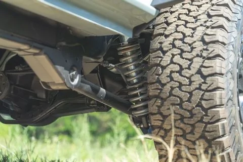

On the concept preview trucks I saw the cactus grey 4 door sporting some fancy adjustable coilovers. I assume that this was a preview of what the parts catalog might offer. I would like to get something as close to the FOX Live Valves which is offered on the Raptor. Is what is pictured the Ford Performance equivalent of the FOX's?
