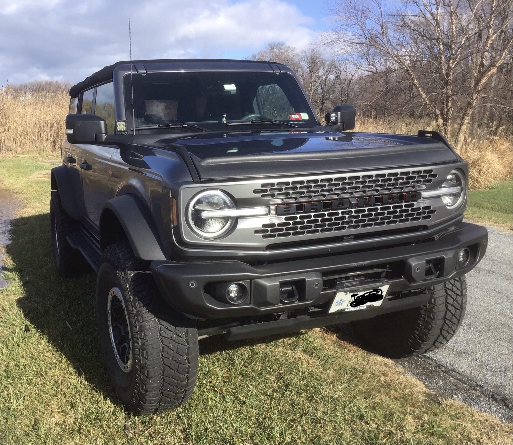

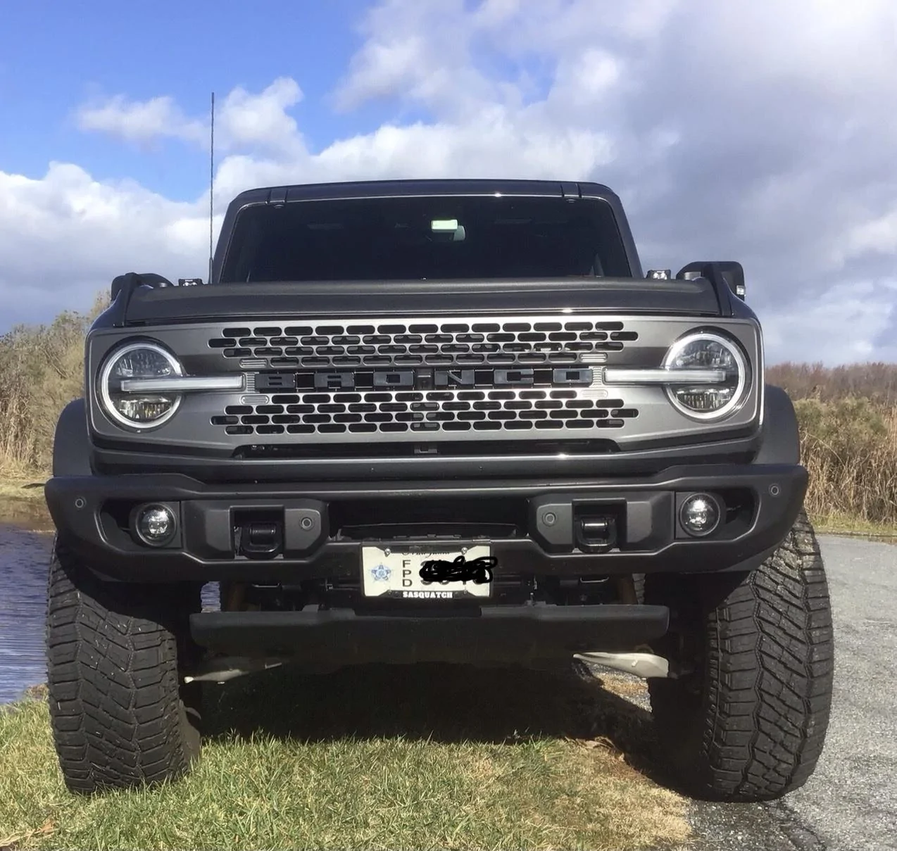

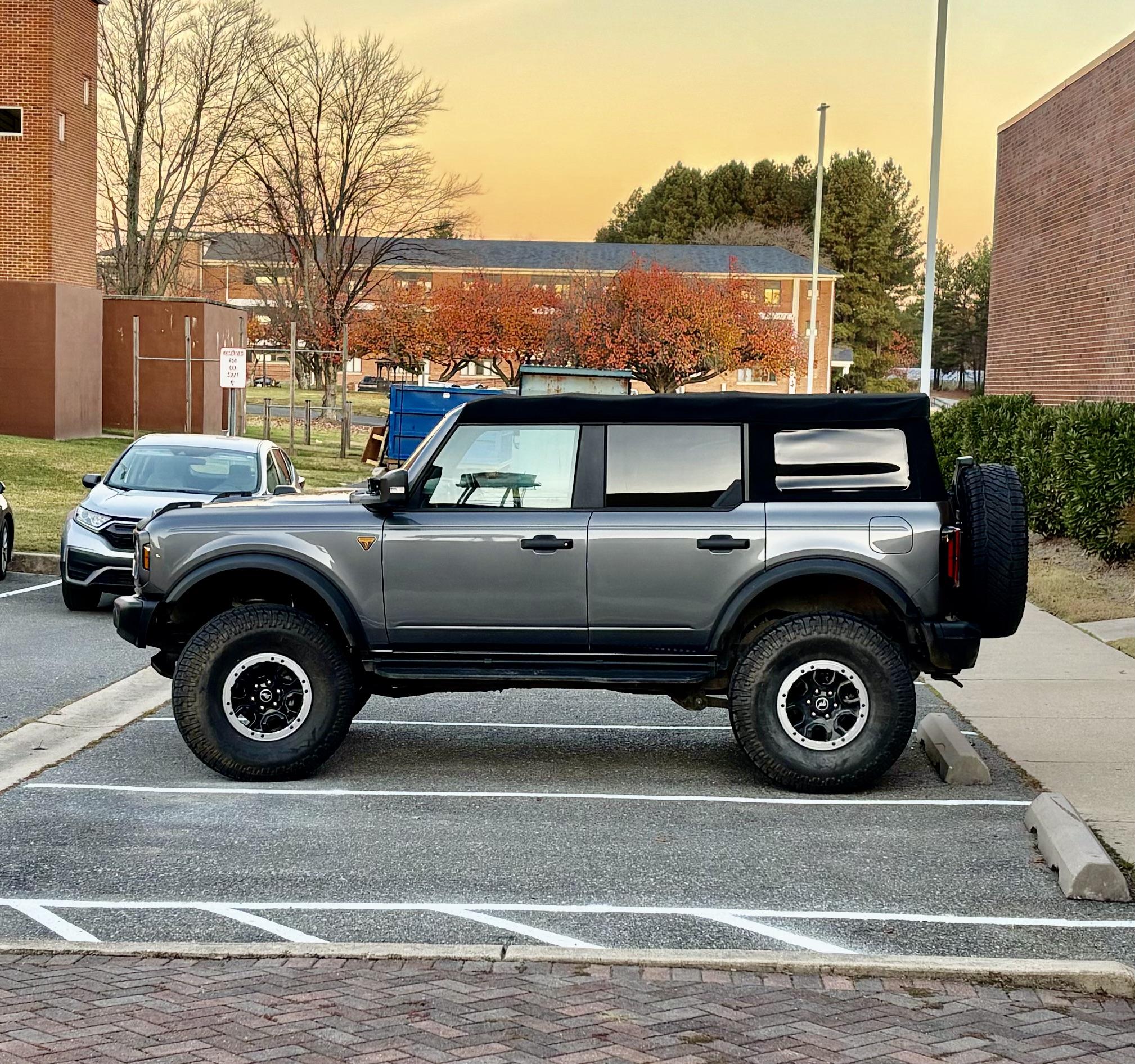

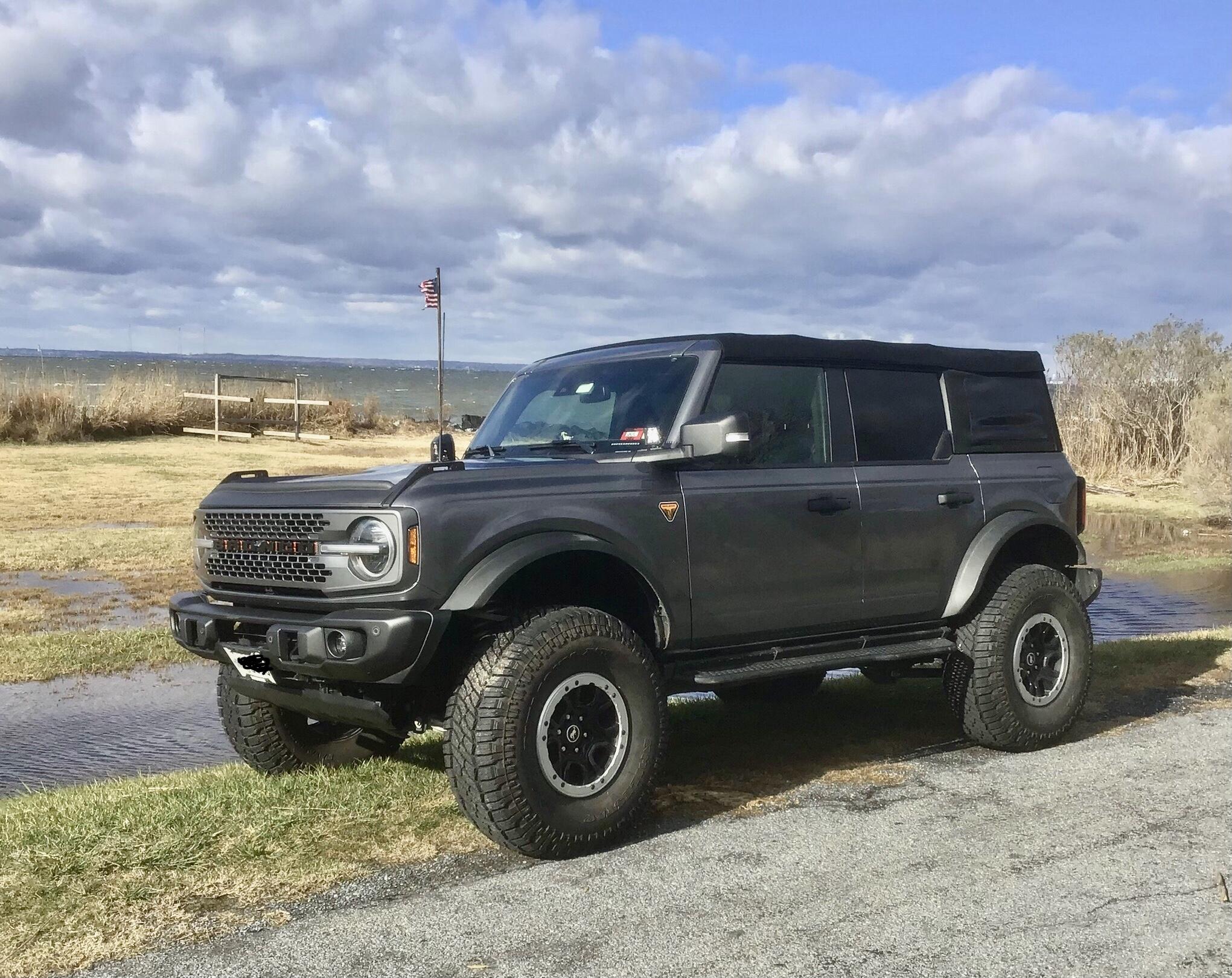

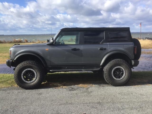

2023 Badlands Sas mod list:
*JKS Max Tire kit - this went on first
*Eibach coil springs- didn’t provide lift as advertised so I made the below modifications
Front- added Level kit shim spacers, one .25“ on top one .25” on bottom. Netted 2.5” total front suspension lift
Rear- added Broncbuster 1” collar to the Eibach coil. Netted 2” total rear suspension lift
*Custom 2.5” body lift. Added Broncbuster front & rear bumper relocation kits (their 3”)
*1” Wheel spacers
*74 Weld steering rack upgrade
* Icon tie rods
* Milestar Patagonia XT tires 38X13.5
* RC tailgate brace. With the Bronco buster rear bumper relocate kit installed, the tire pretty much rests
on the rear bumper with some custom tweaks
* RC brake light extension
* Rockjock tract bar relocation bracket- Very import addition to get her driving straight as an arrow
I am very please with the results. The ride/drive feel is great.
Special thanks to Bradley Thornton & Bird Dog Off Road for the help!

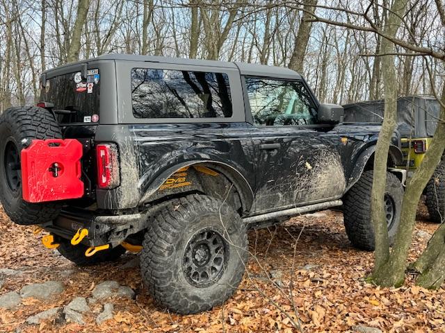

Do you wheel this? The Patagonia have a poorer offroad reputation. How are they for you?

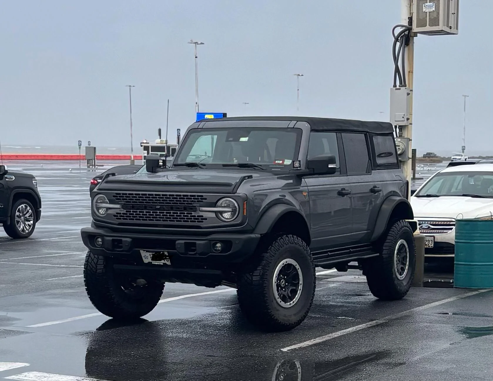

Looks great. How is it at highway speeds? I am looking for something that can handle 37s and still be able to roll down the highway at speed with all of our gear and still be very capable off road. We are looking at the BroncBuster steering and tie rod set up plus an adjustable lift setup.
I have wheeled it lightly, so far. No rocks as of yet. The tires do fine in the mud. Very happy with them in the rain. Supposed to be great in the snow-yet to be seen.. Had it off road in Maine last month. Ran some serious rutted muddy logging roads NP
Thanks, runs/drives great at highway speeds. Good idea to get your steering upgrades installed and a good shakedown prior to tire shopping. Get a good shop to do your alignment (I would do this immediately after lift and tract bar relocate bracket install)

Is the body lift required or a nice to have with 38s?
The bady lift was definitely required . My suspension lift is only 2.5” in front 2” rear. With the BB bumper relocate kit I don’t have a gap although it also pushes the bumpers out.

I didn’t do the whole rack. Just did the passenger side housing and the bronze bearing inserts on both sides. I will post if I have any problems/failures. There were no installation instructions but , everything looked well engineered and solid.
