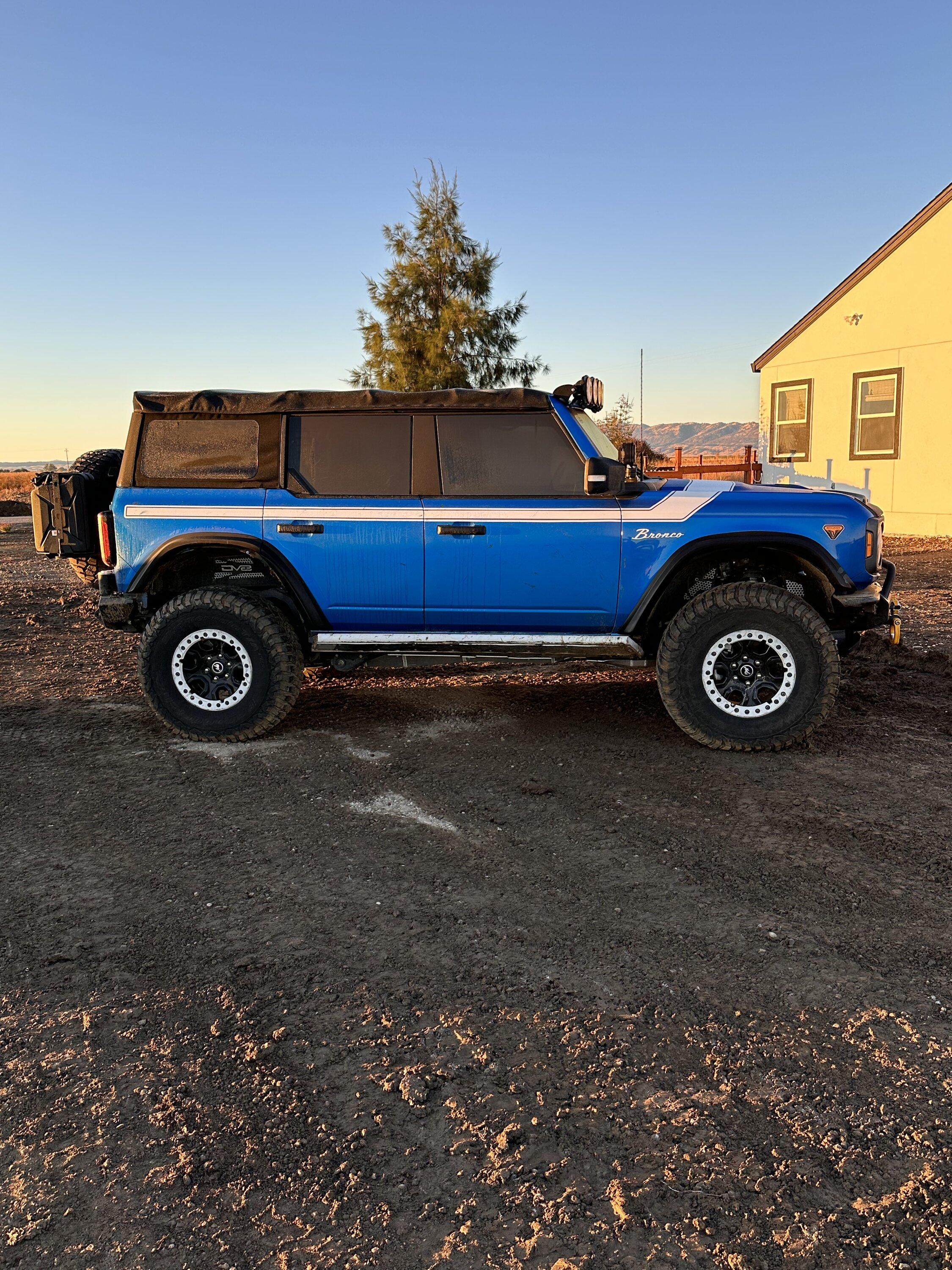

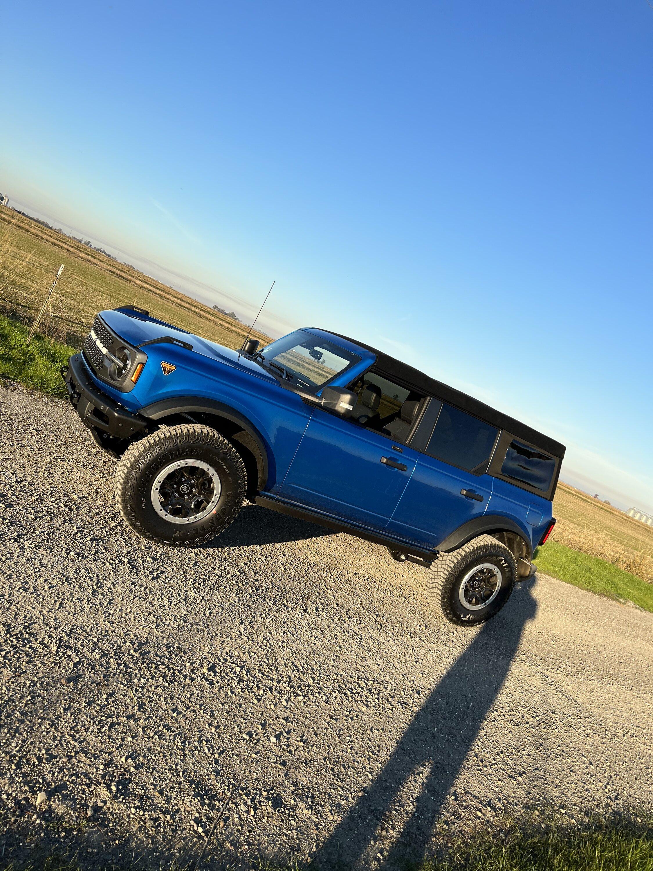

Figured I’d start a build thread even if it’s a little late in the game with my build. Start off my Bronco is a 21 Badlands with Sasquatch in velocity blue with the lux package.
This is how it looked in the first week of purchasing it. Also everything besides the upper and lower links have been installed by myself so feel free to ask about if it was difficult or not.
Ford Bronco Joe's BadSquatch Build B264157B-EFD7-4720-8C00-EF5BE62432AE

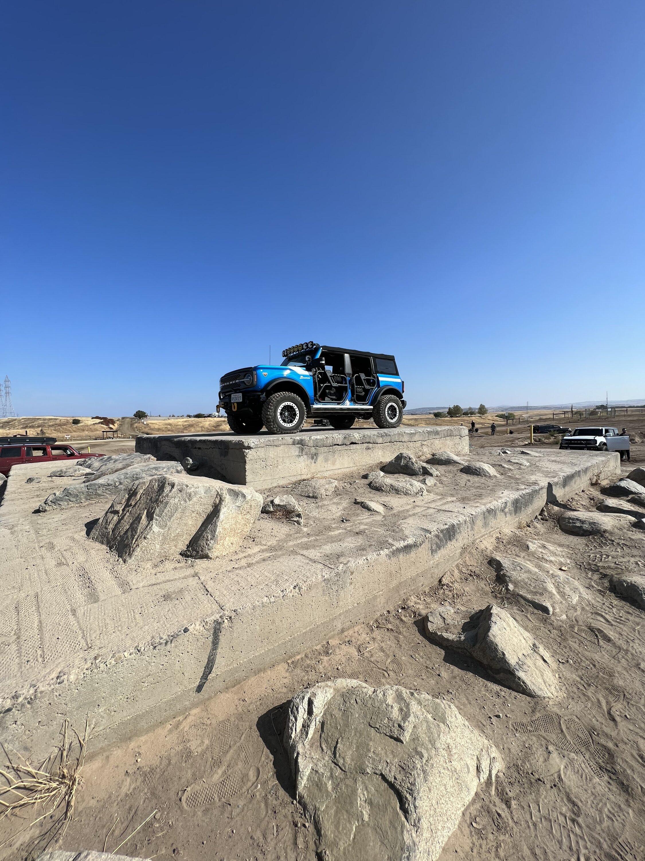

this is how it sits currently
Ford Bronco Joe's BadSquatch Build 113193DD-5995-46BC-9AE5-D7BA6492EC9D

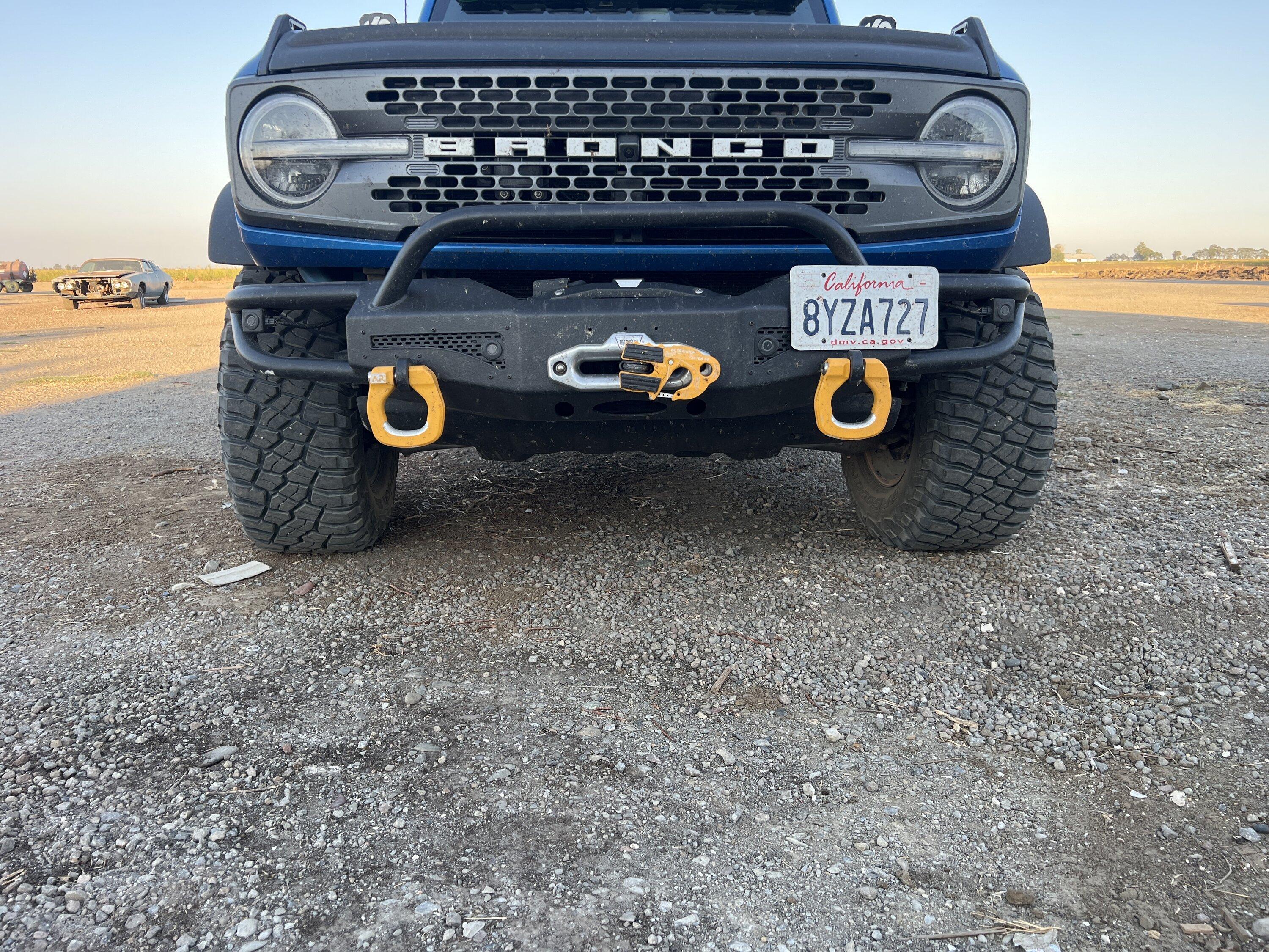

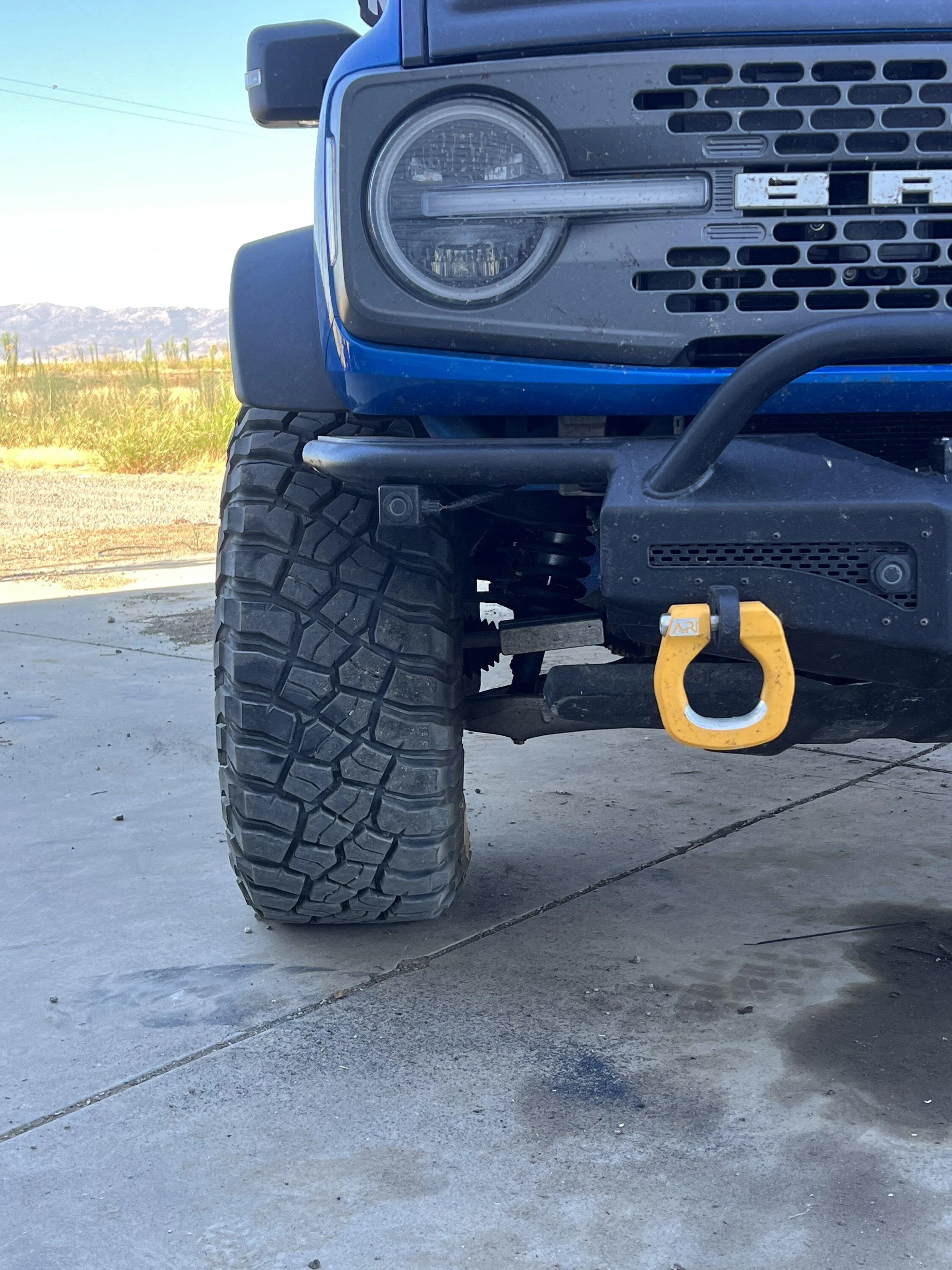

Decided to chop the tube wings off my bumper. Feel like it cleaned the look up and made it more sleek. Just need to see if I can move the parking sensor inboard more to protect it more.
Before
Ford Bronco Joe's BadSquatch Build 0D075336-E506-4B46-B55B-5F81798A2CF4
After
Ford Bronco Joe's BadSquatch Build BD981E5D-083A-4AC6-8A8D-FAA8385BC267

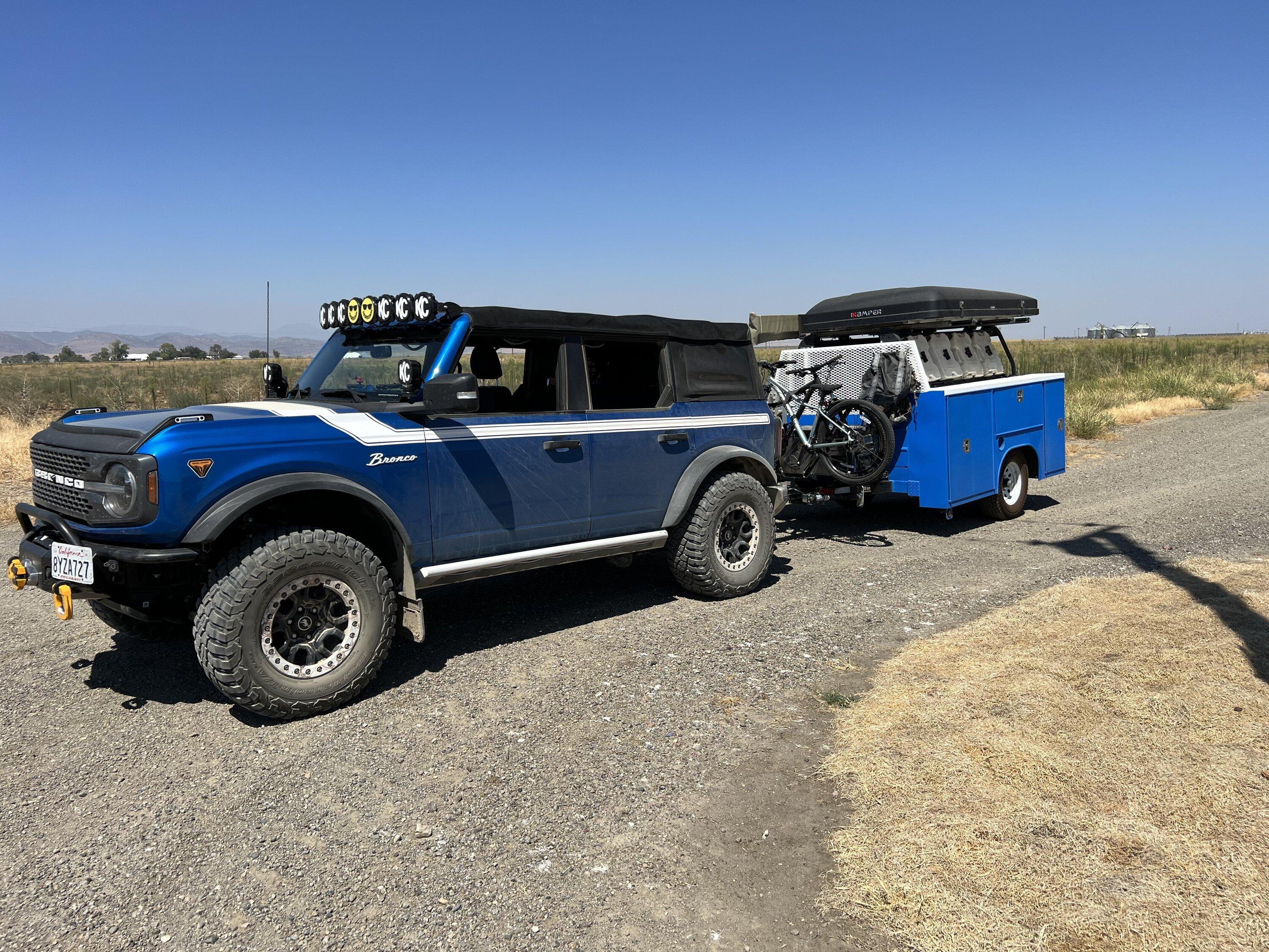

Finally got around to putting everything back onto my overland/camping trailer after getting it rhino lined and painted to match my Bronco. Feel like it turned out pretty nice.

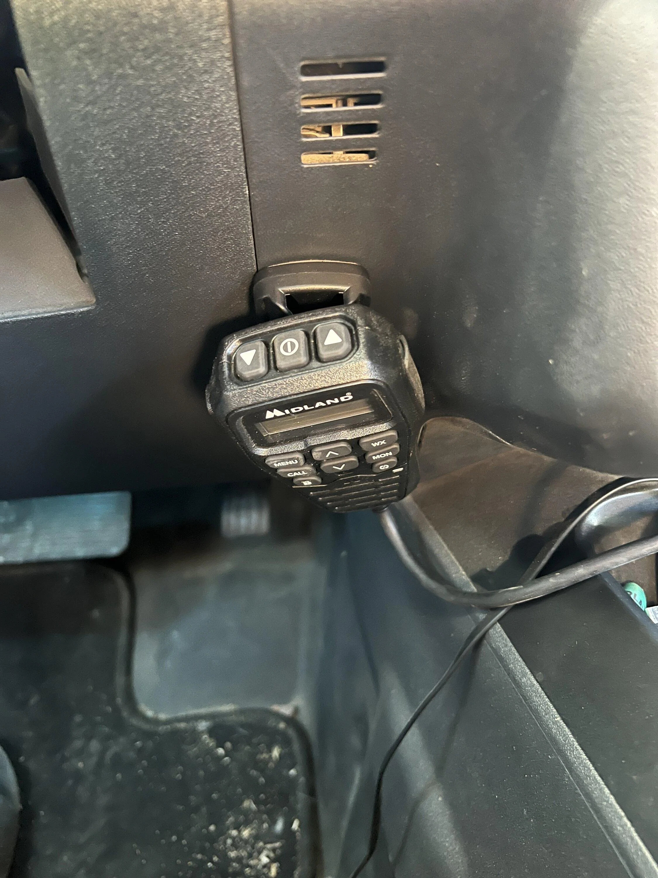

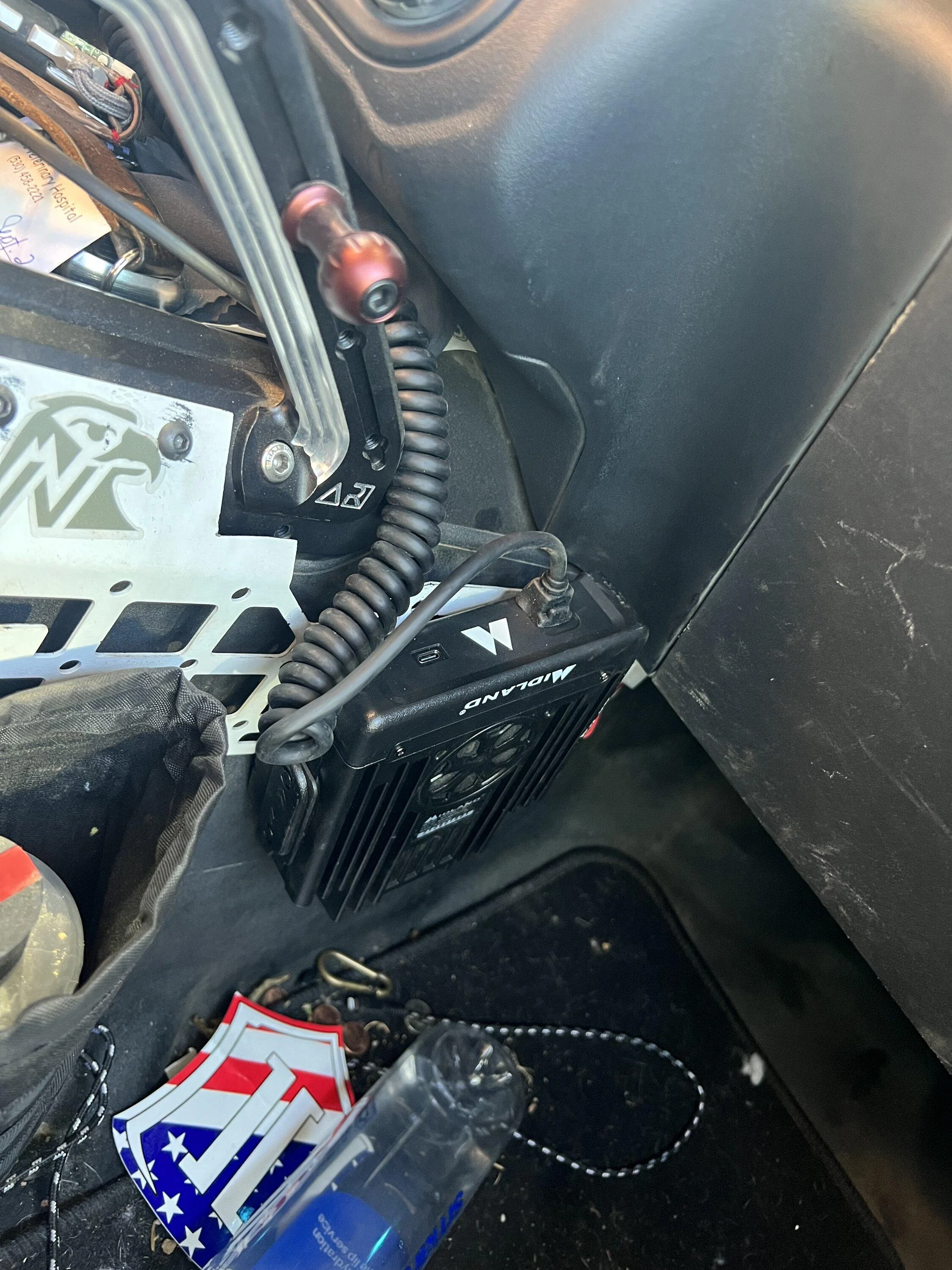

Installed a midland mxt 575 radio and used up my last aux switch in the process. Realized I had the wrong antenna cord so just waiting on that to finish the install.

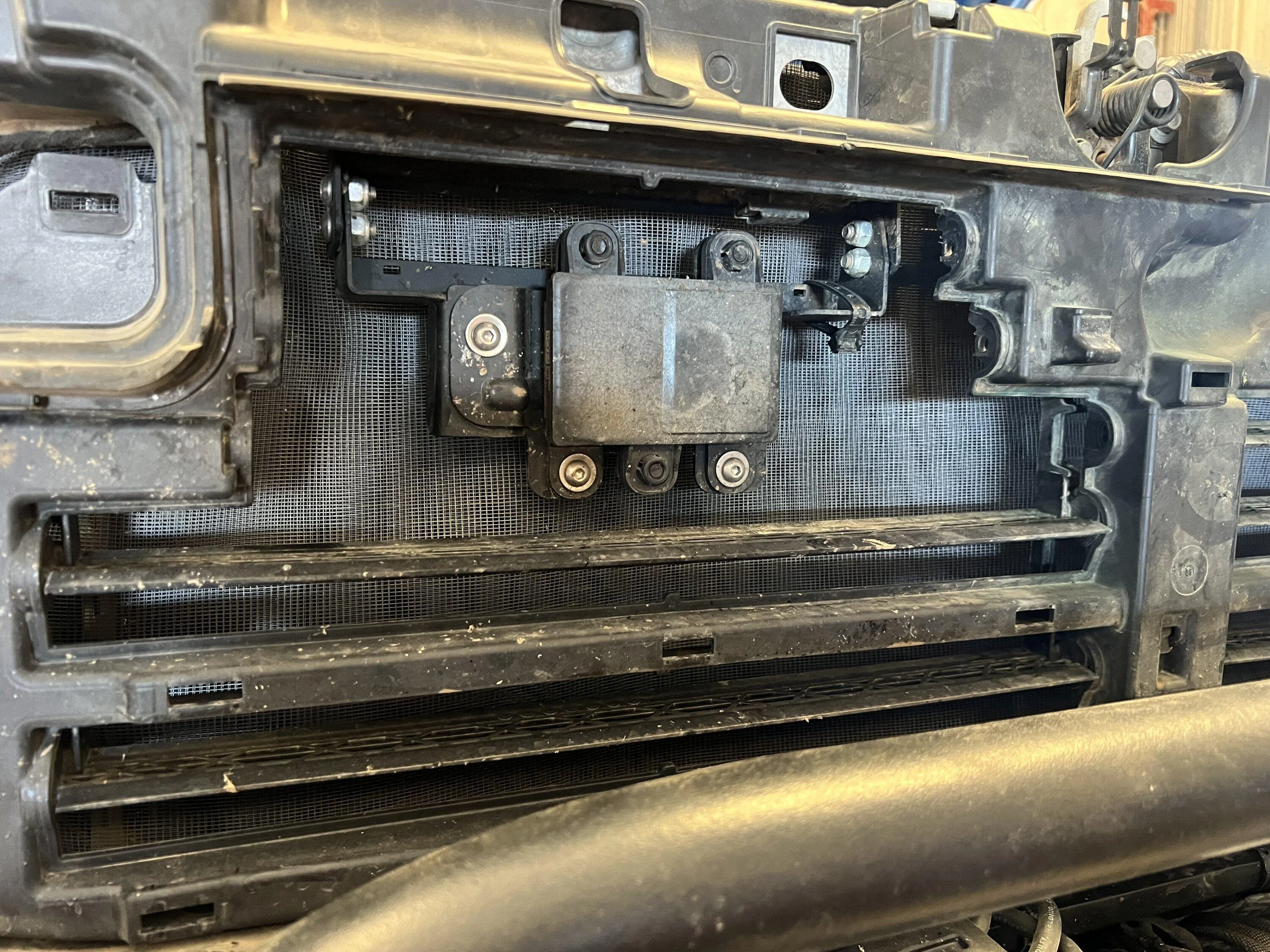

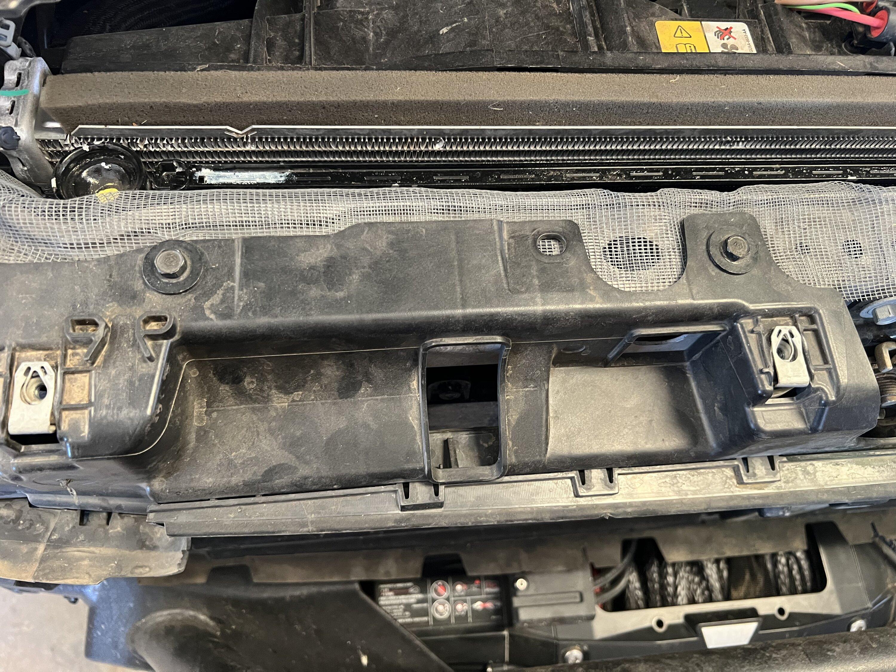

Toss some window screen behind the radiator shutters to help with bugs and seeds from around the farm getting into the radiator fins. Pretty simple mod.
Ford Bronco Joe's BadSquatch Build 0362C9C9-03A7-436A-9761-326F8583F20C
Any issues to this? I've never seen this done and I'm interested.
Haven’t had any so far and there was a few 100+ days after I tossed it in. We’ve kinda always tossed a bug screen on our pickups around our farm just anymore no one makes ones for a specific vehicle so figured so screen material for house windows would work just as well.

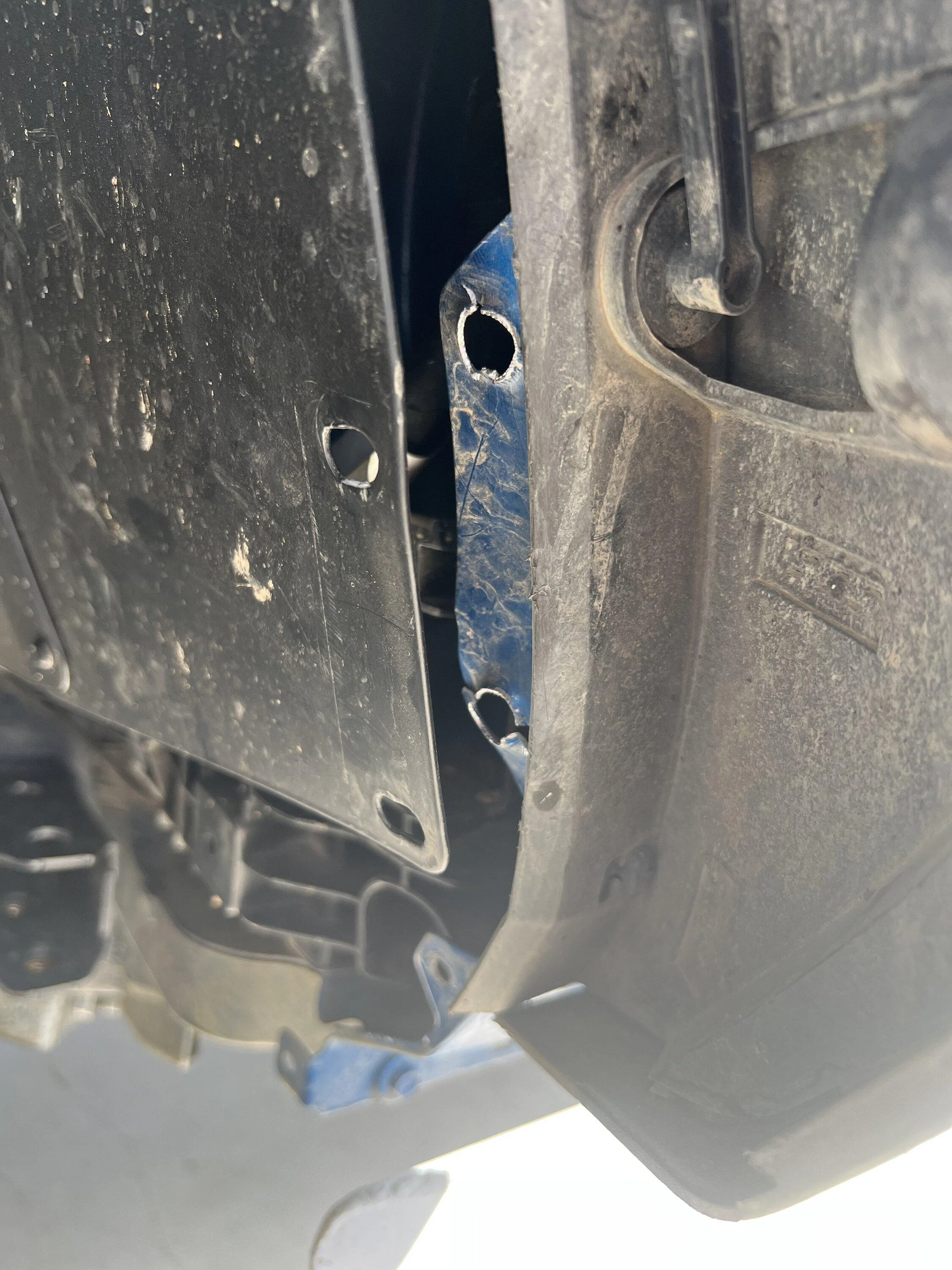

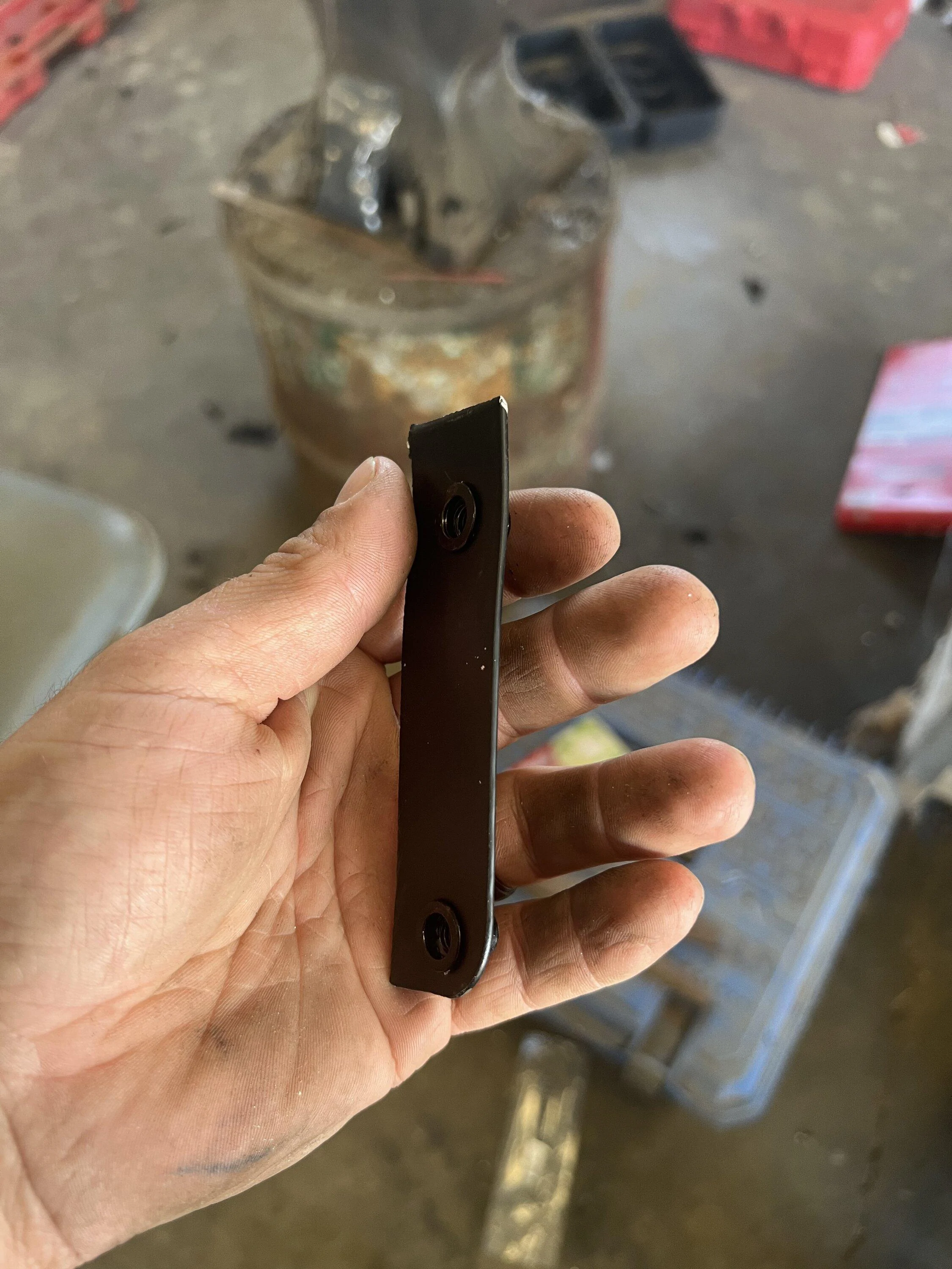

Did cause a tiny bit of damage on my Bronco and lost one of my Ford mudflaps when the frame part got caught on a rock and ripped the riv nuts for the DV8 inner fenders out of the sheet metal. Was an easy enough fix with a piece of scrap aluminum I had laying around.
