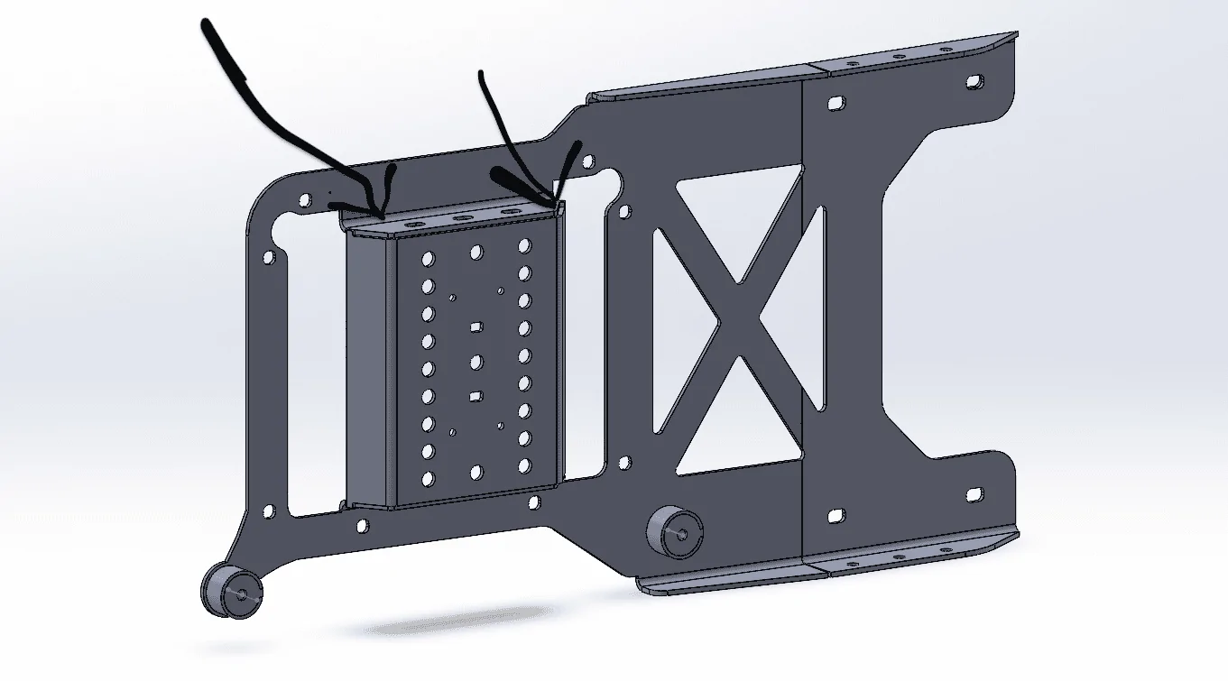

Mounting the tailgate reinforcement is a little more than simple bolt on.
The square shape with the several holes (see pic below) interferes with the alignment of the spare tire mount. The top angled areas shown by the arrows are a little large so I ground off the corresponding area on the Bronco factory spare tire mount. That part is plastic covered aluminium so easy to remove the problem area with a carbide burr and air grinder. You could grind the tailgate piece but it is steel.
Depending on tire size and rim set back you may need a spacer to mount the spare tire so it won't hit the reinforcement bracket. The factory spare lug nuts need to be lengthened by that same amount or 1/16 inch or so more. Broncorik is right about the bottom lug being somewhat shorter. I am in the process of drilling out my spare lugs and going to tac weld longer bolts in place. Not hard just more than I enjoy in this 100 degree temps.
FYI:
My tires are Sasquatch size but Mickey Thompson with factory rims. The Mickey's have a more aggressive sidewall that contributes touching the tailgate reinforcement. I need a spacer that is 3/8 to 1/2 inch thick. Factory tires may get by with 1/4 inch spacer....but you will need a spacer with Sasquatch and factory rims or rims of the same set back.
