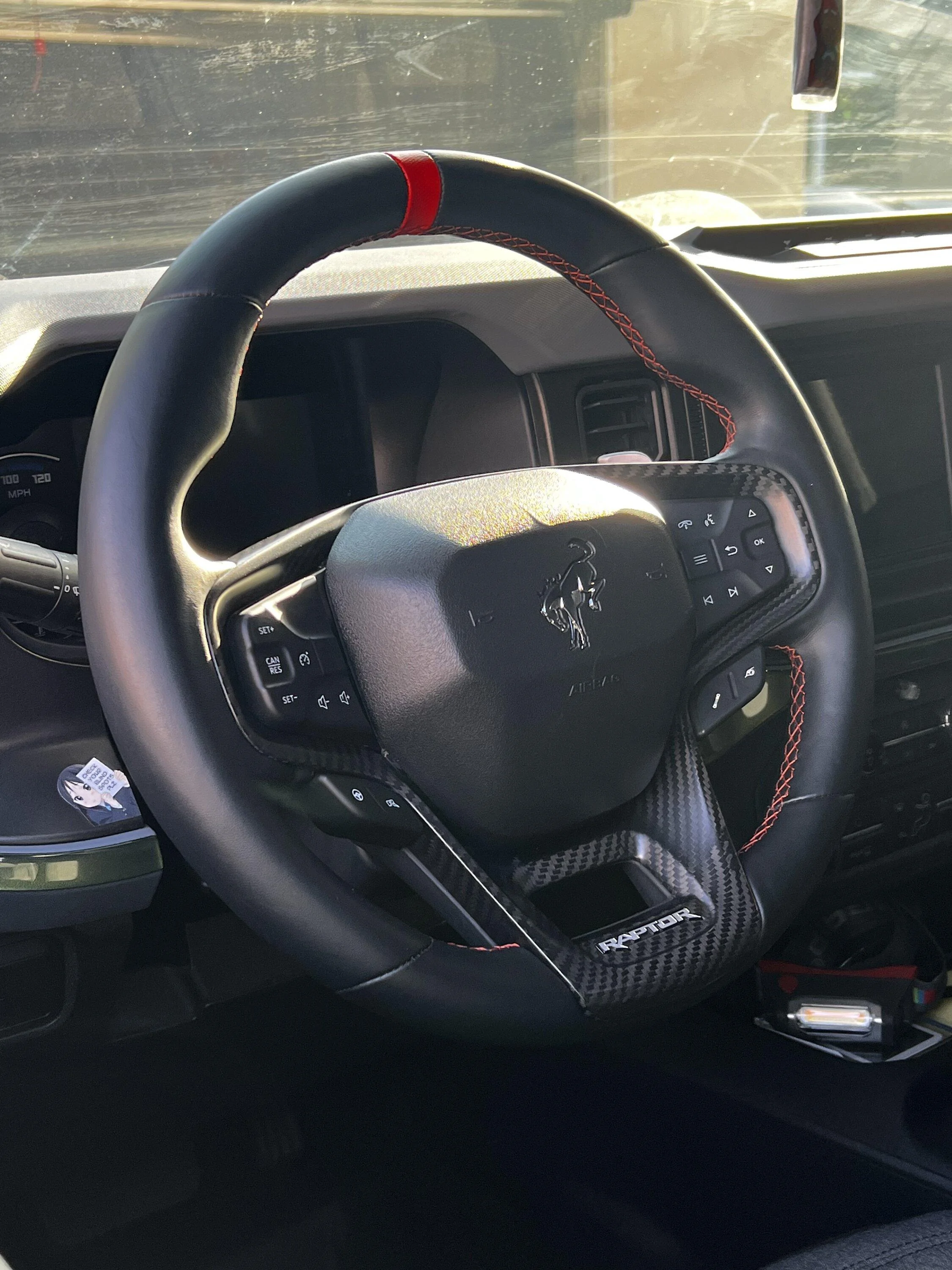

Installed but wishing the paddle shifters worked a lot of stuff I learned today swapping this wheel in.

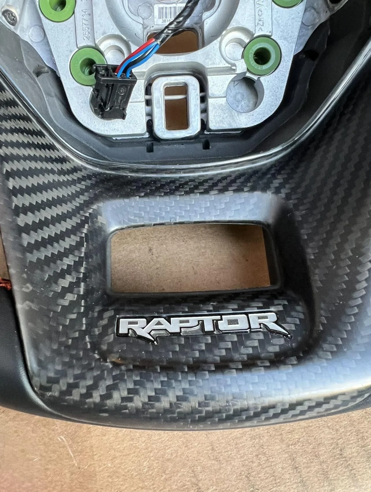

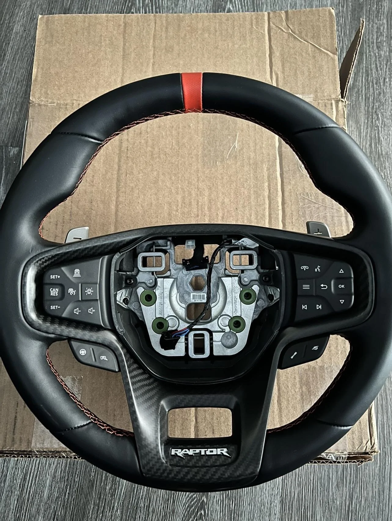

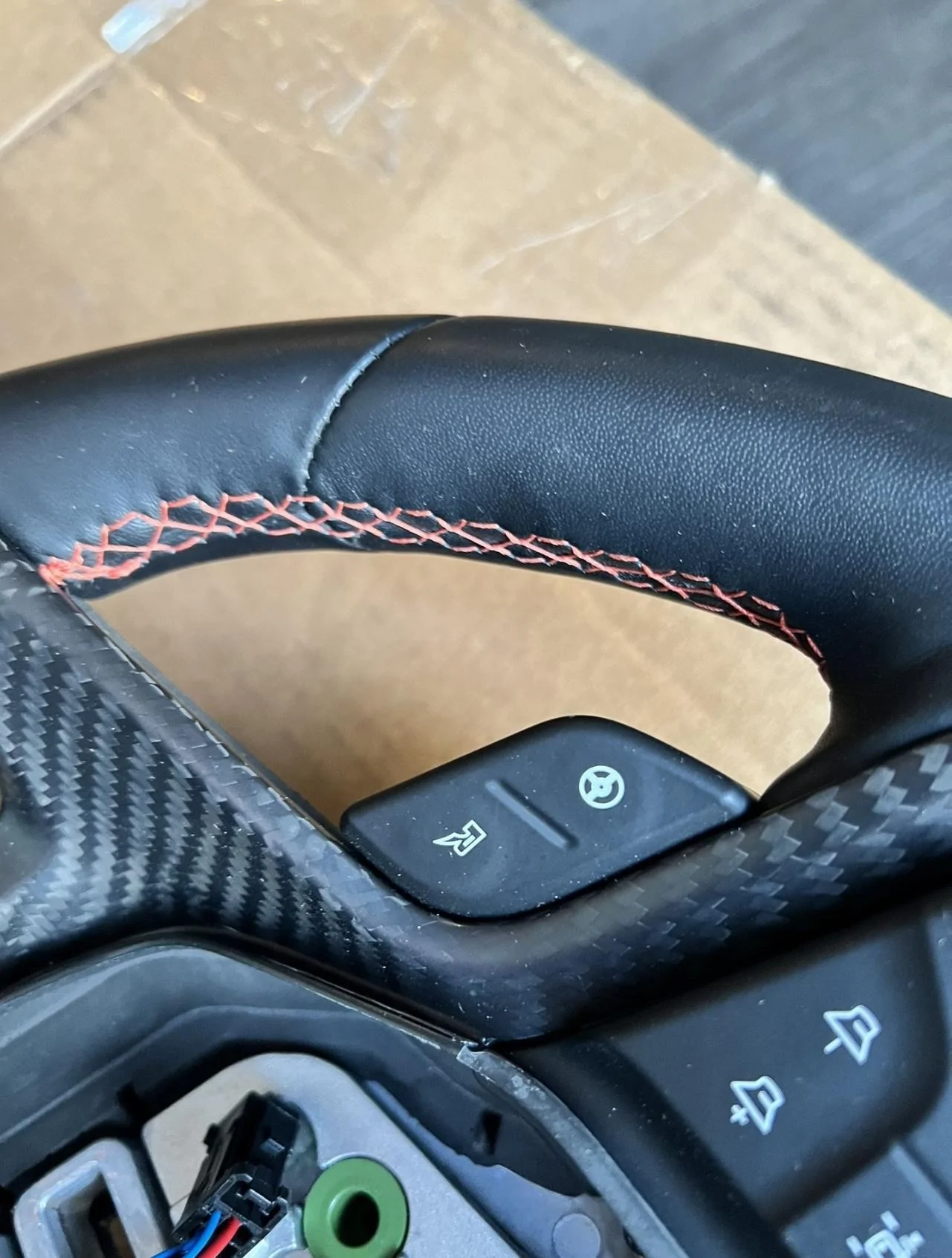

Everything works except the braptor specific exhaust and suspension buttons not sure about what the r button and the steering wheel one is for. No Forscan but I had to improvise and swap the key pad and button circuit board over to the wheel as the factory braptor buttons are not recognized by the vehicle if you just swap wheels and plug everything back the connections are the same. Really hoping that I can get someone like boosted grey goose designs to do something with the paddle shifters.

No I don’t have a part number on it. These wheels are about 1100 retail I think with no buttons. You can’t swap directly as the back side is molded to fit the braptor specific buttons
