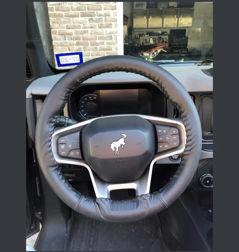

I hope this is not wheel skins.
Ford Bronco Base steering wheel replacement? 664AF080-6C3A-439B-B598-A732E6AEE2CB
This one would be fine if the wheel was removed and the trim bezel removed before stitching it.
That one does look like Wheel Skins, but yeah the Bronco does have a unique trim on the wheel that you wouldn't have to worry about on most other vehicles. Agree that in order for it to look good you'd have to try to remove the trim and then stich it.... not sure if you'd be able to get the trim back on over the leather though after that. Wheel Skins might have some insight if you send them a message.
