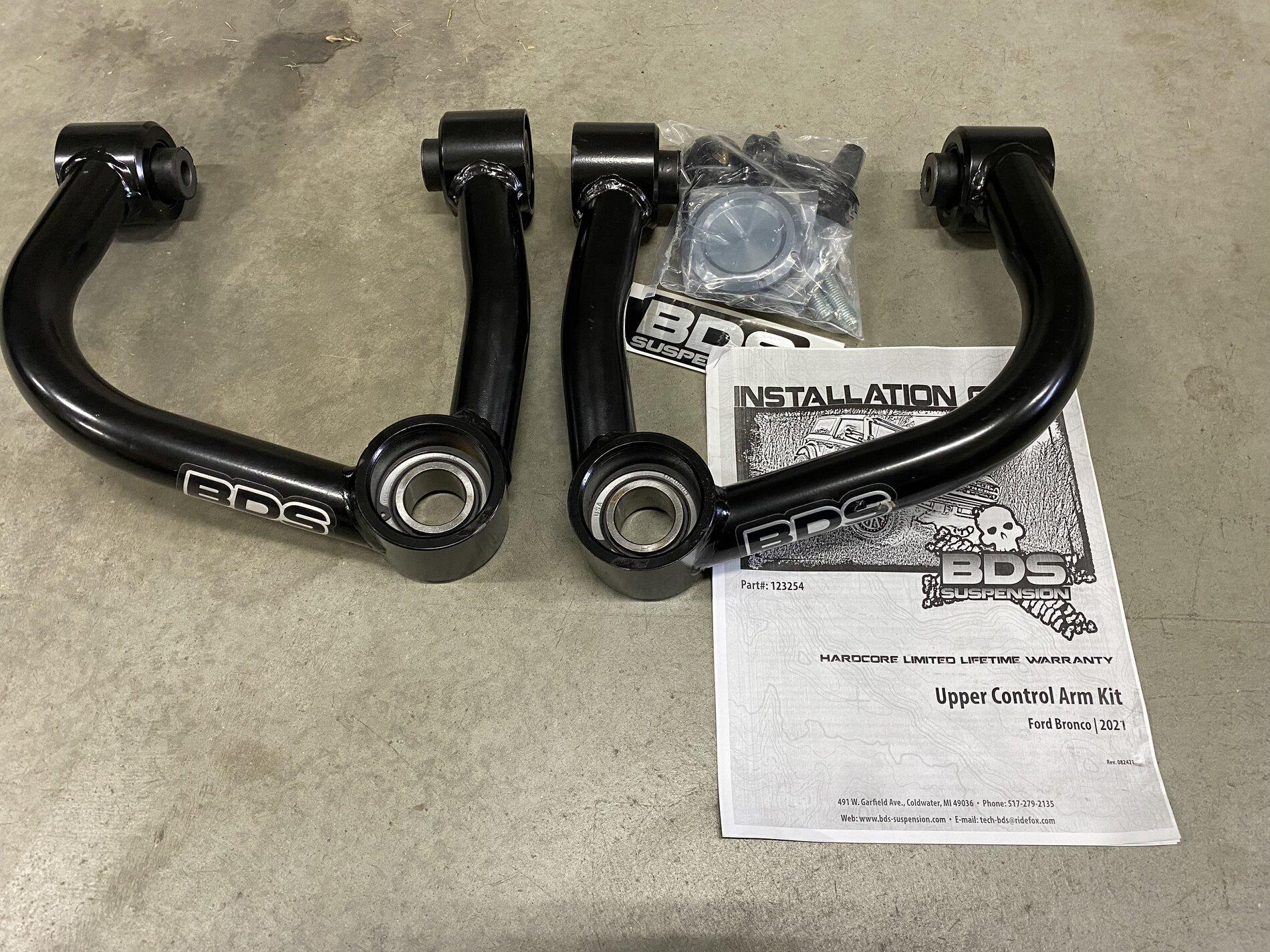

Some additional details inside instructions.
This is the maxlider kit. I literally just asked this in another thread but can’t you build this kit yourself now?

I see. Looks like BDS U control arms and a Zone spacer.
