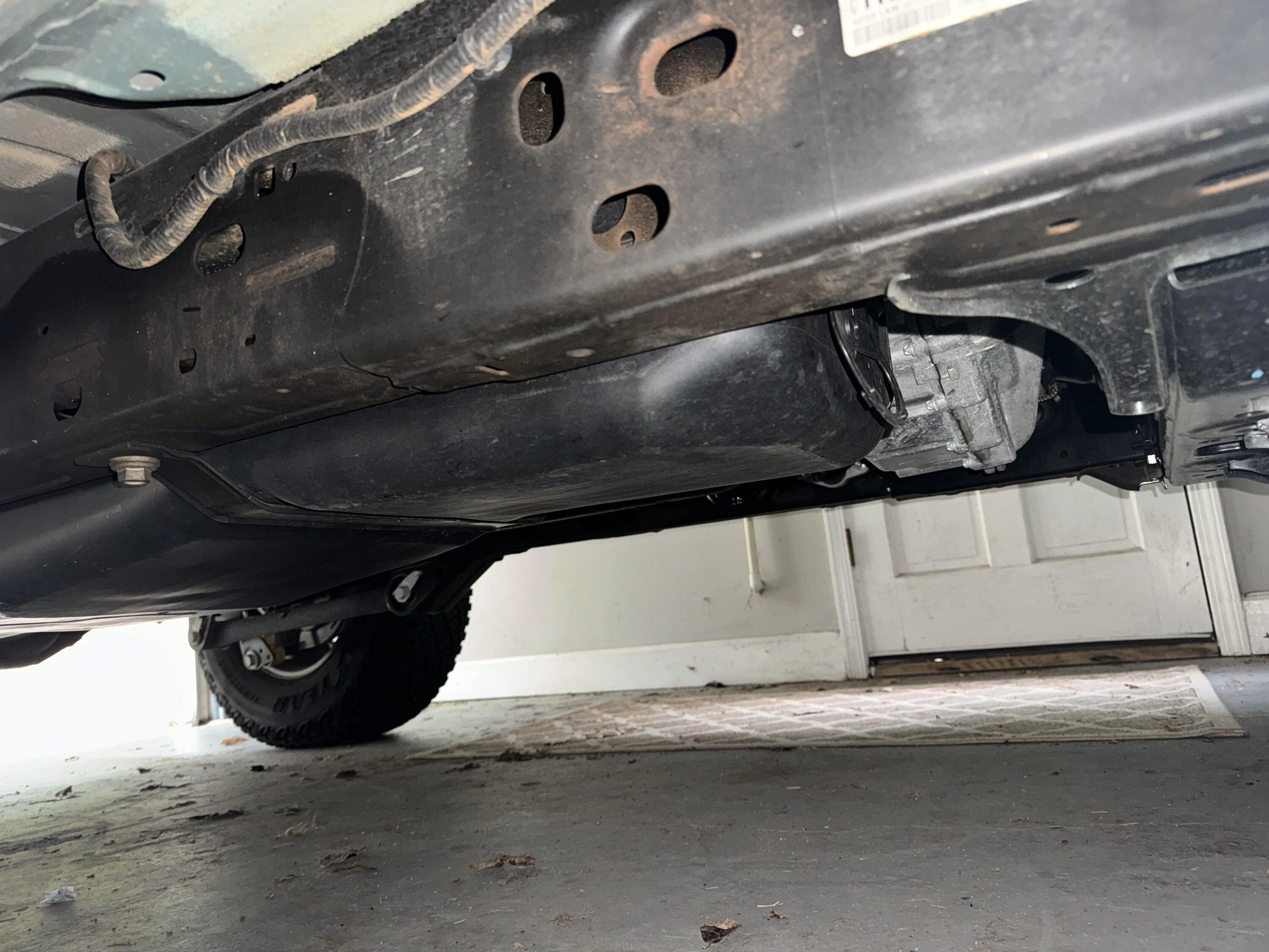

Looks like I just have a plastic tank hanging out. And it already has scrapes on it where I’ve bottomed it out.
Holy Crap !! That's crazy. My 23 WT def has a skid plate on the tank. I bet you have a 4 door. IIRC the 2 doors have a tank skid and the 4 doors don't which is dumb if you ask me.
Sorry about that !! I didn't think about the 4 door difference.
No worries, and the fuel tank is my biggest concern. It is so huge that it is just begging for a puncture.

I don't think fuel tank skid is standard equipment on a Bronco except maybe Raptor and 1st Edition. The tank skid is part of an optional package. My 2023 WT had it but I optioned for full skids also.
The OEM Ford parts skid system mentioned for $830 includes the fuel tank skid and others. Nothing from Ford protects the transmission though. That will have to be aftermarket.

the steel bash plates were an option on wildtrak but I don’t think they came with the gas tank skid. Only black diamond and badlands get gas tank skid and bash plates as standard
