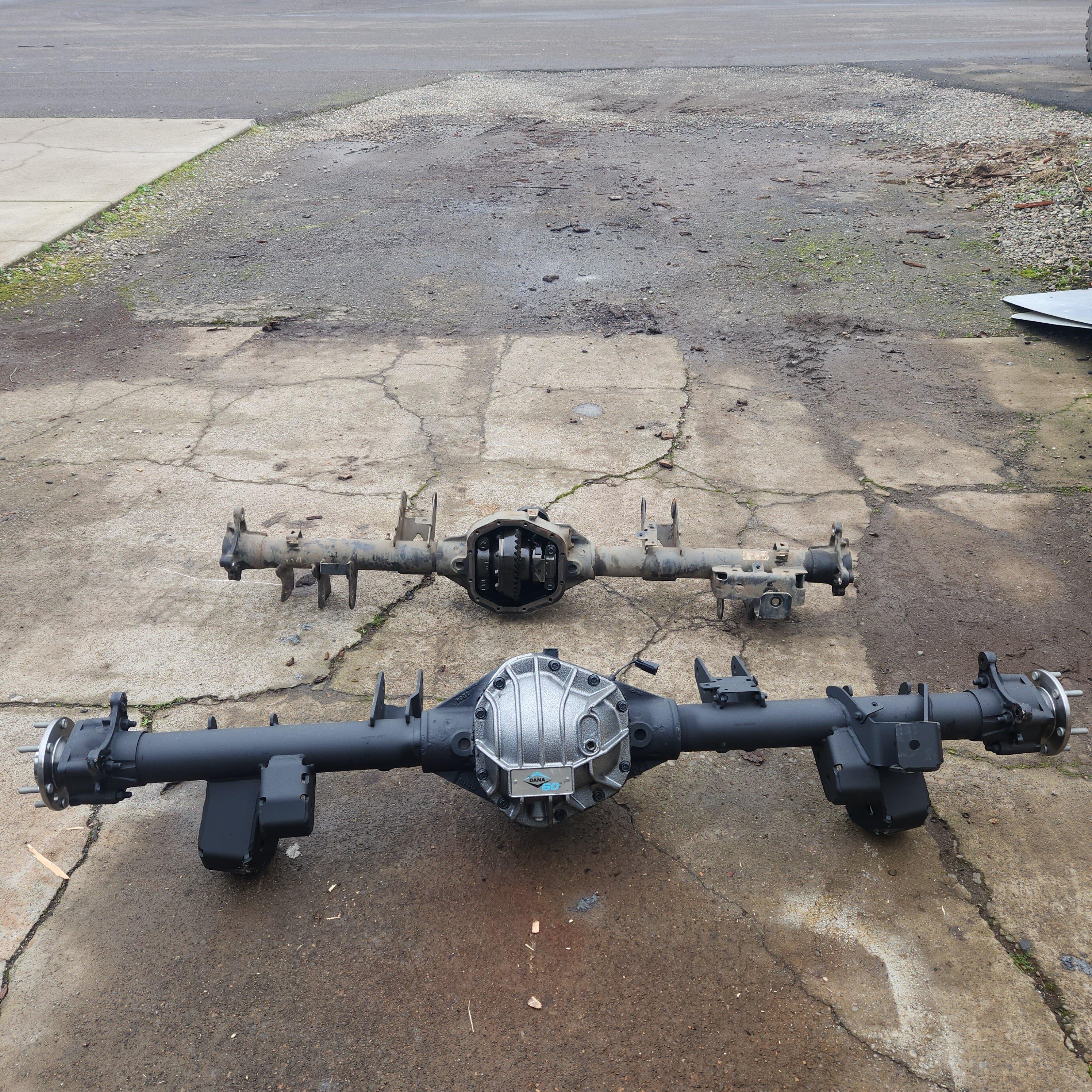

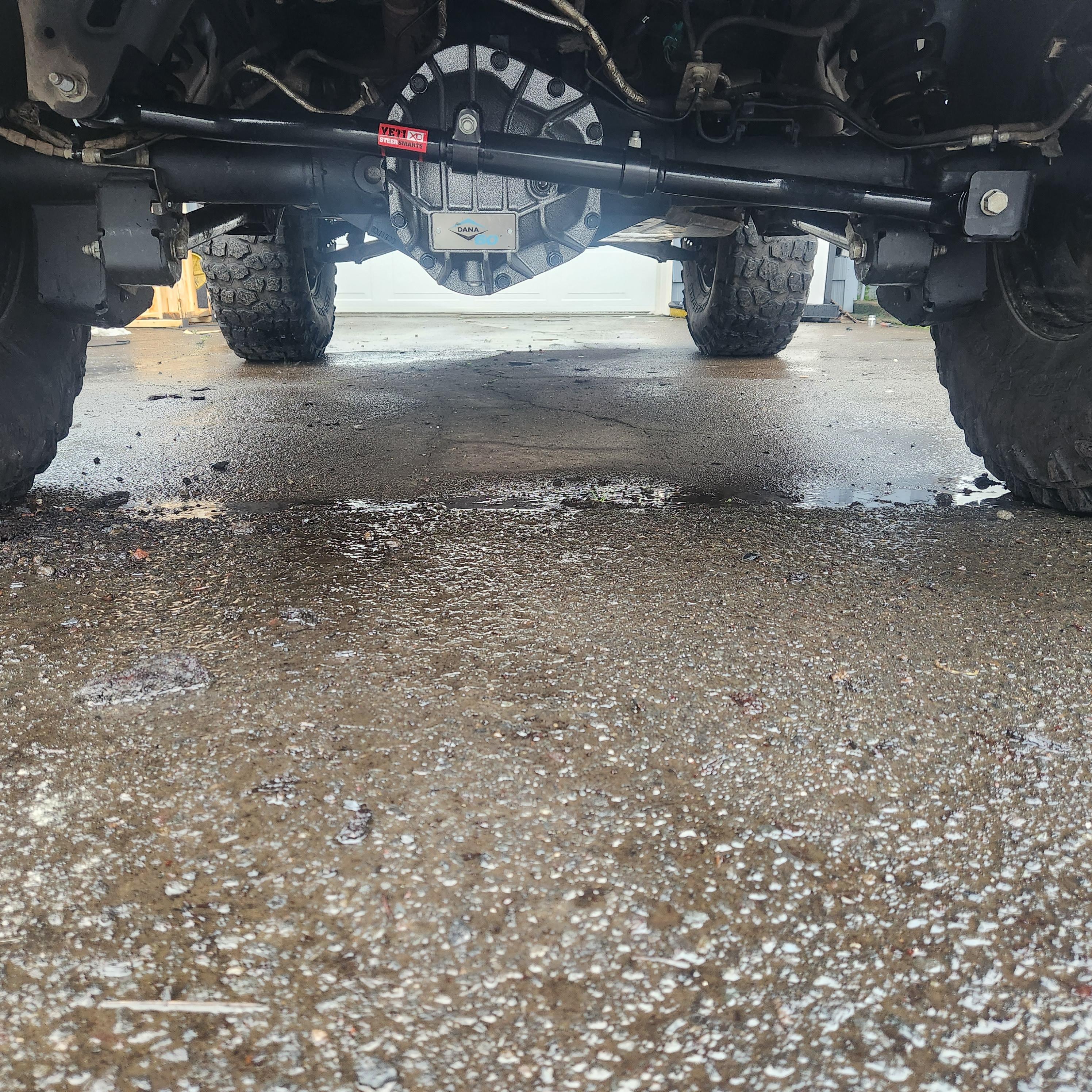

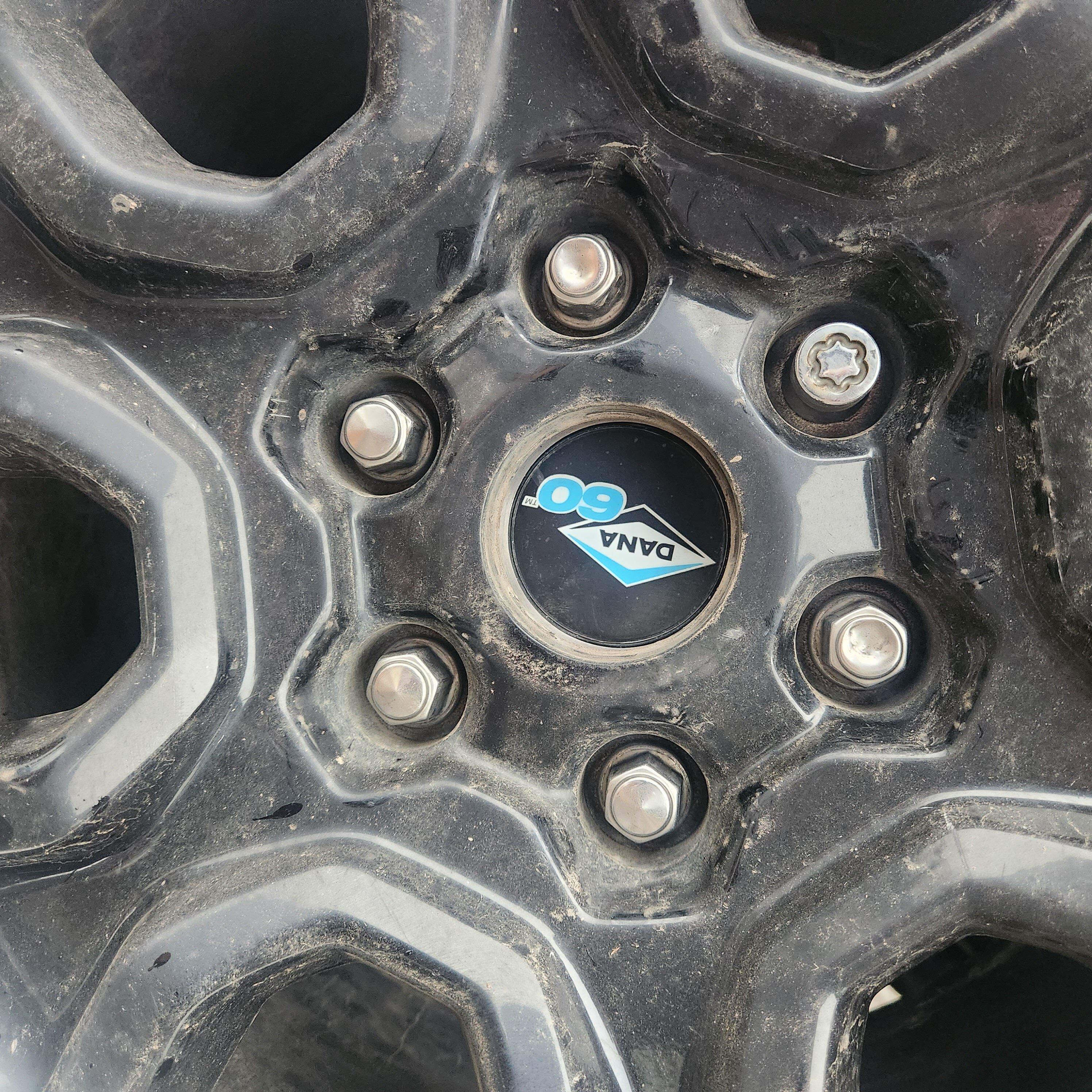

added the Spicer ultimate 60 rear axle to handle the extra loads from the big meats...Fantastic plug and play, bolt-on setup...so easy you don't even need to bleed the brakes.

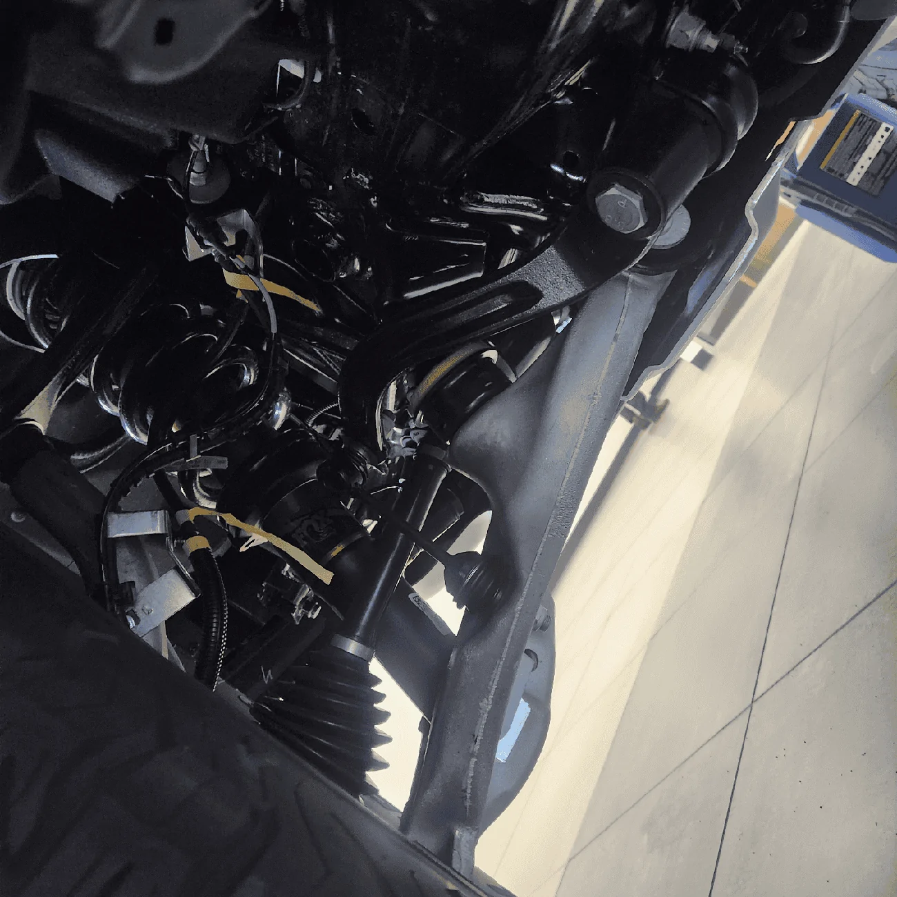

So do you already have the BRaptor front control arms bolted in? Sorry I didn't go back to look at older threads.
they shipped today...Spacers for a few more days...then install. 😅🤪🥳
