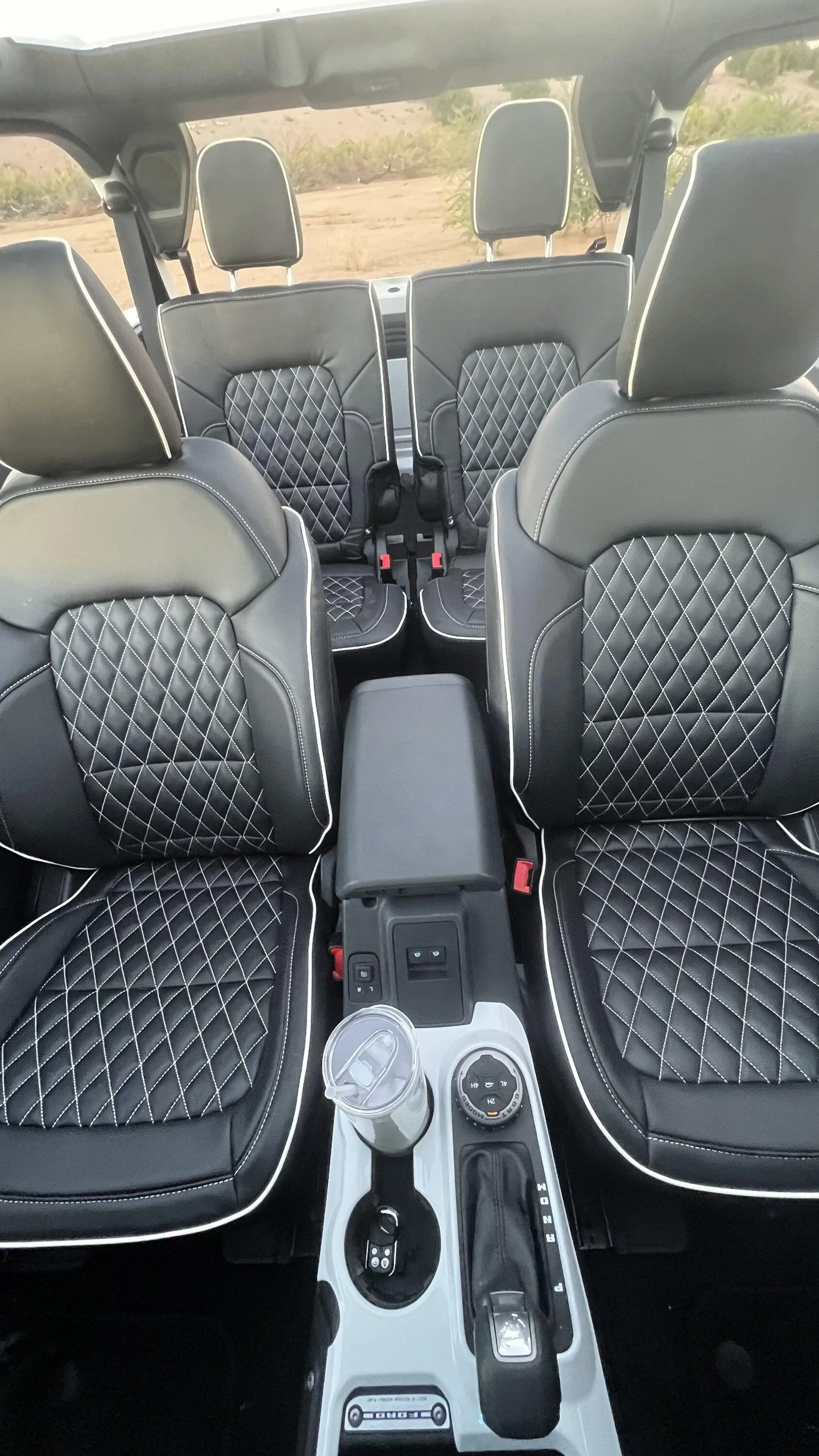

BTW - how did you get the console white? Is it a sticker?
Overlay pieces on console trim, steering wheel and door handles painted oxford white.

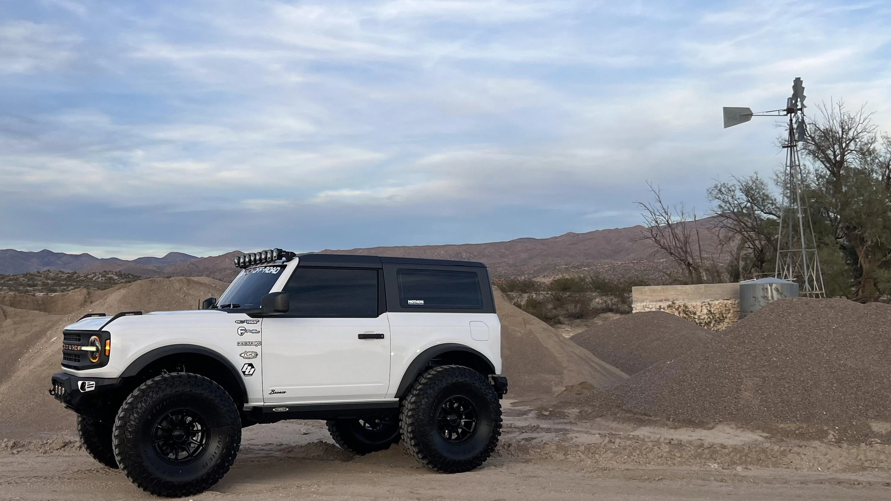

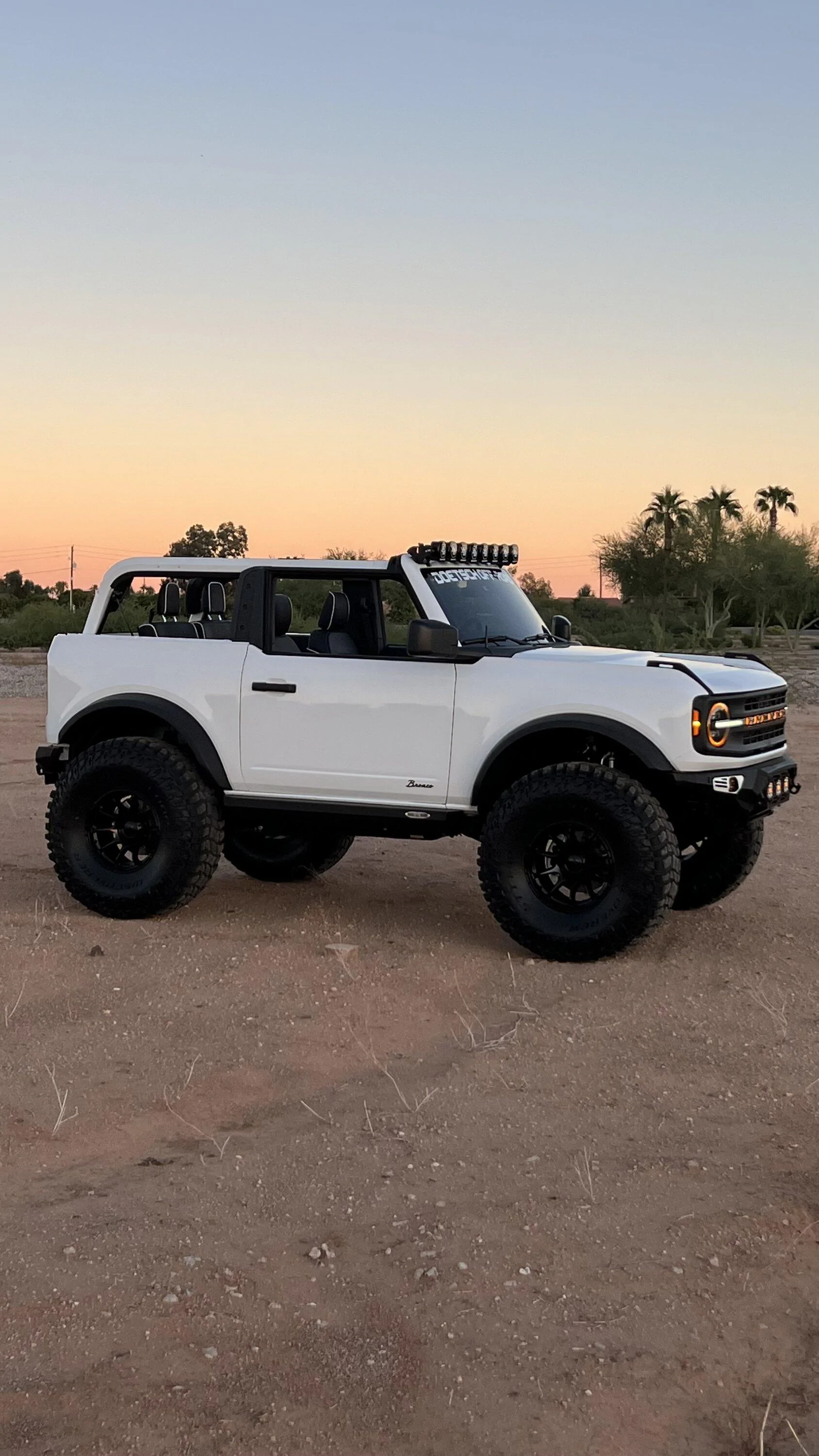

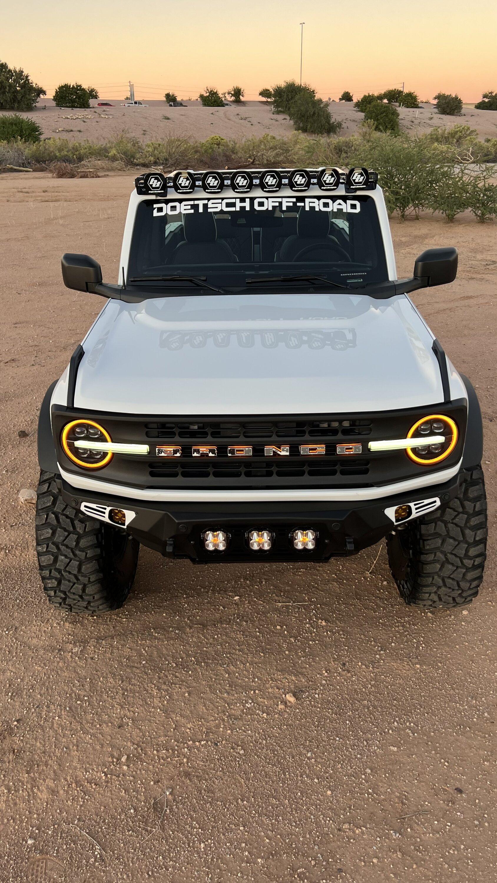

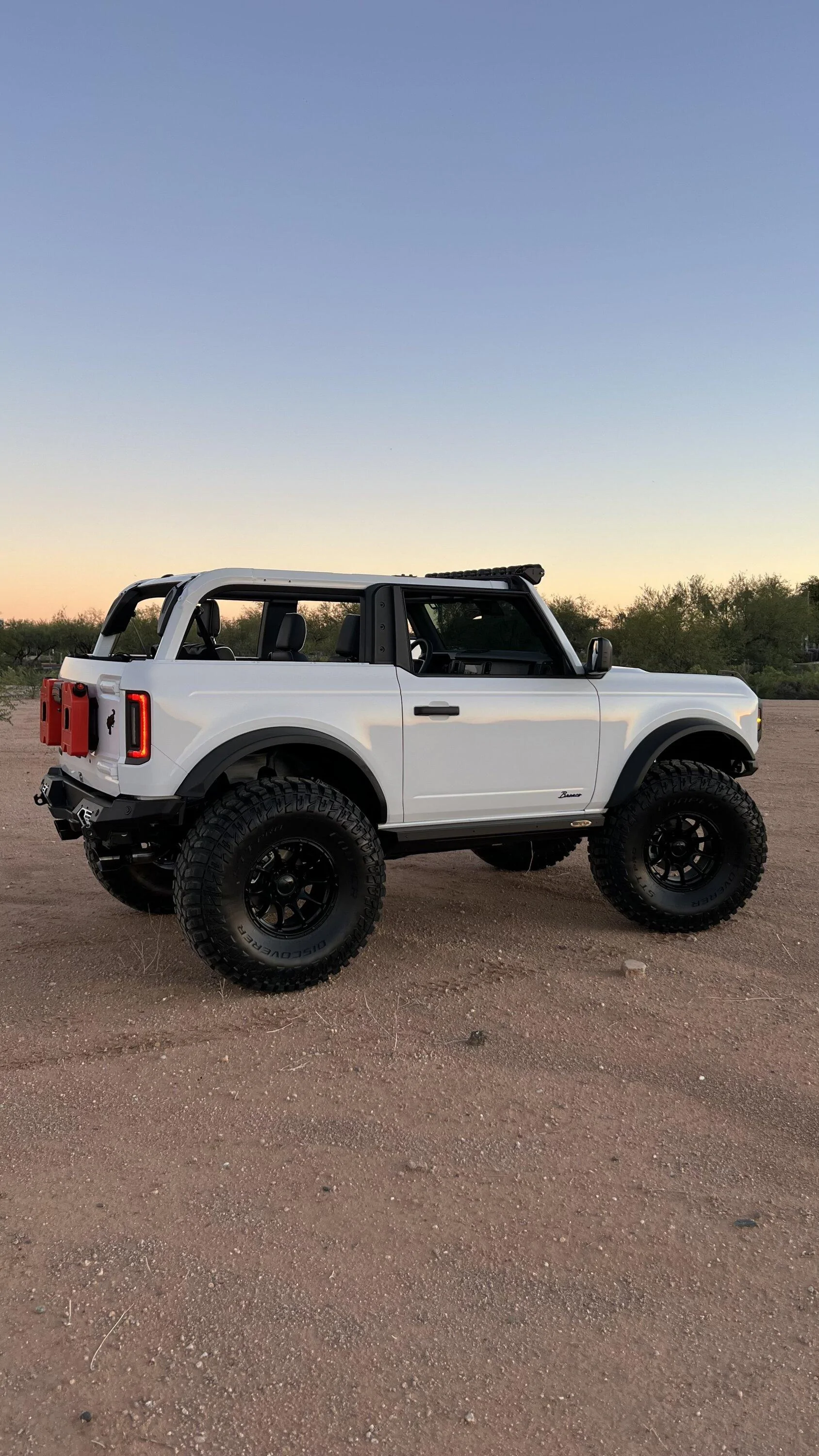

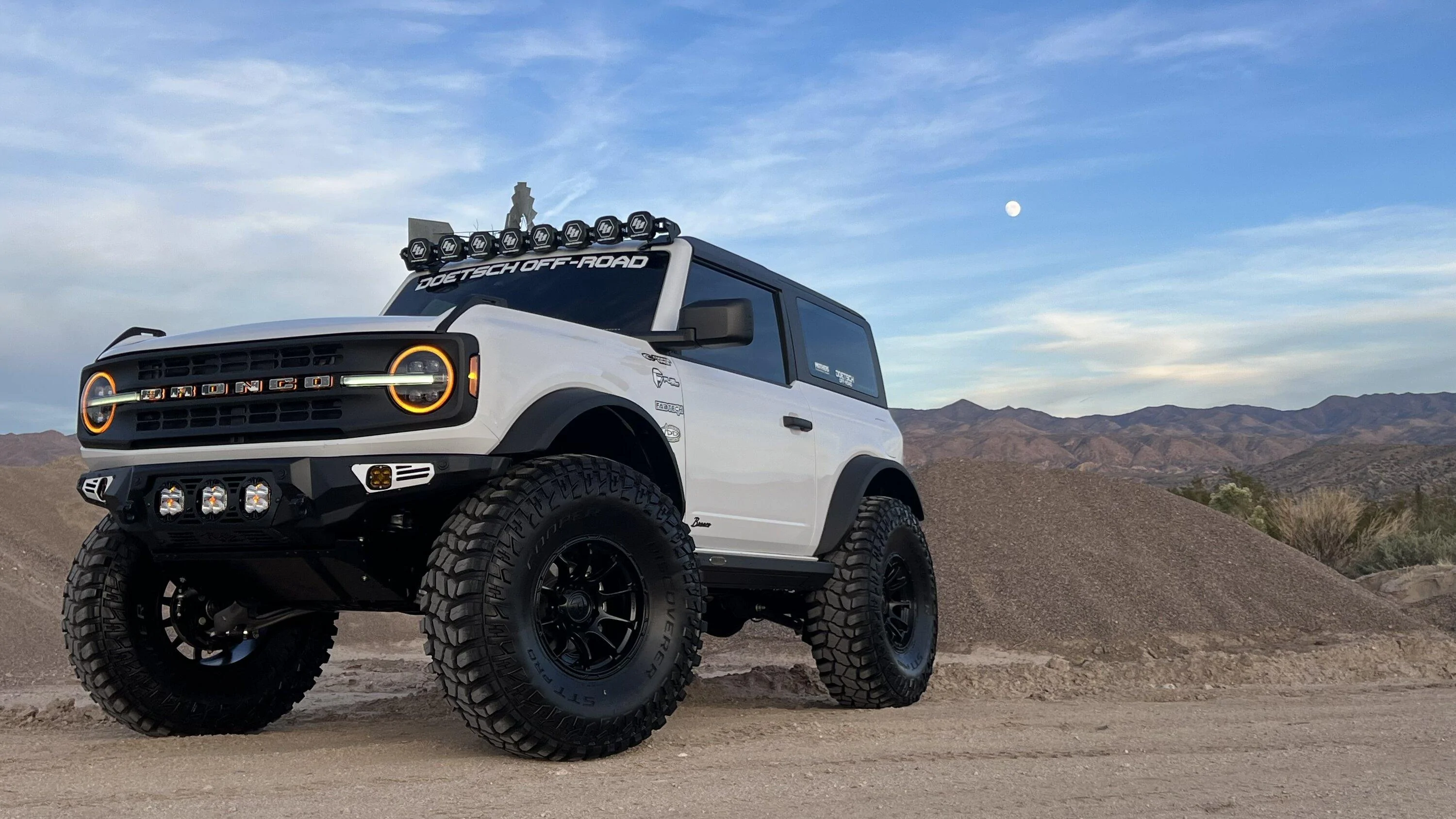

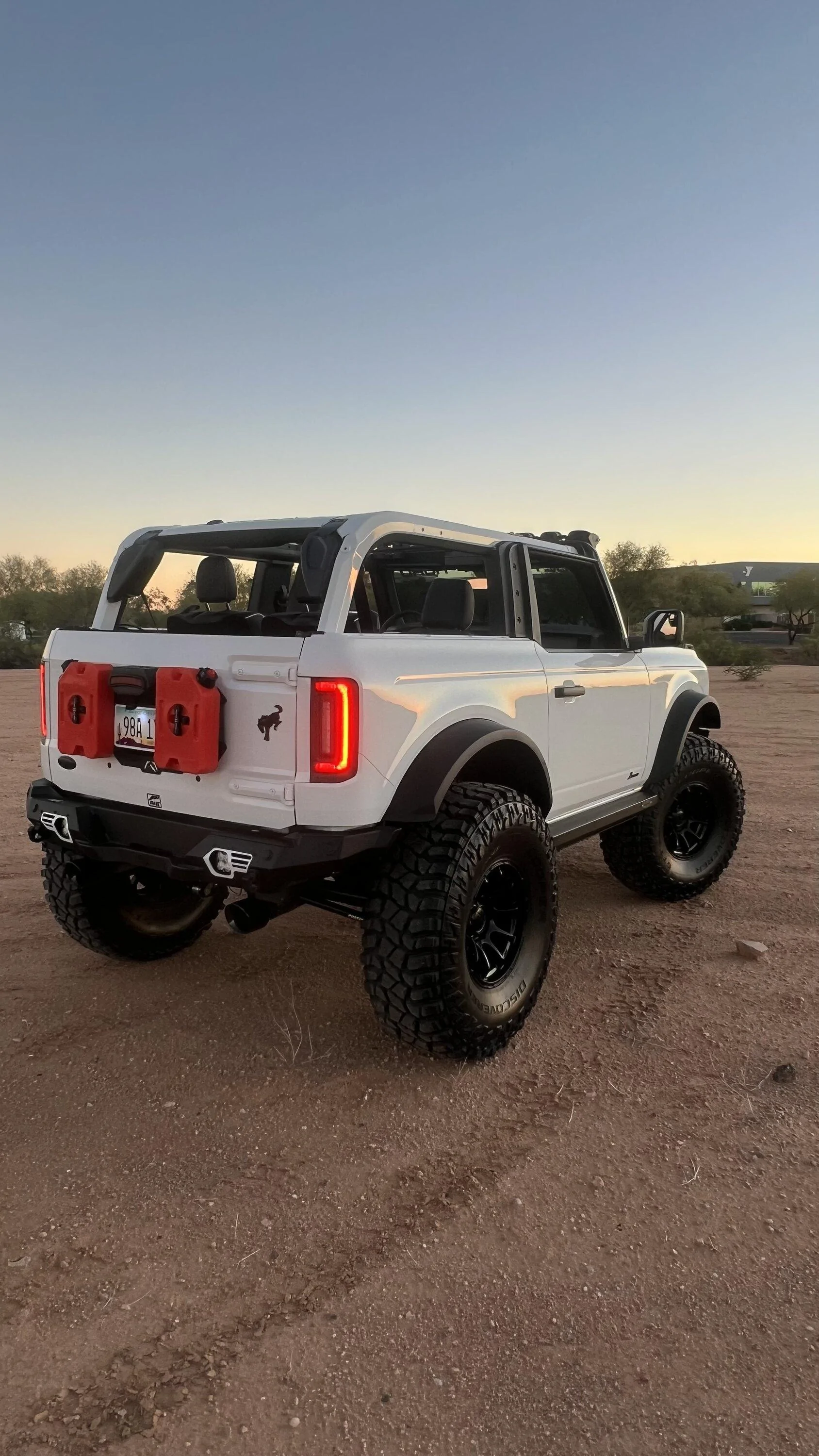

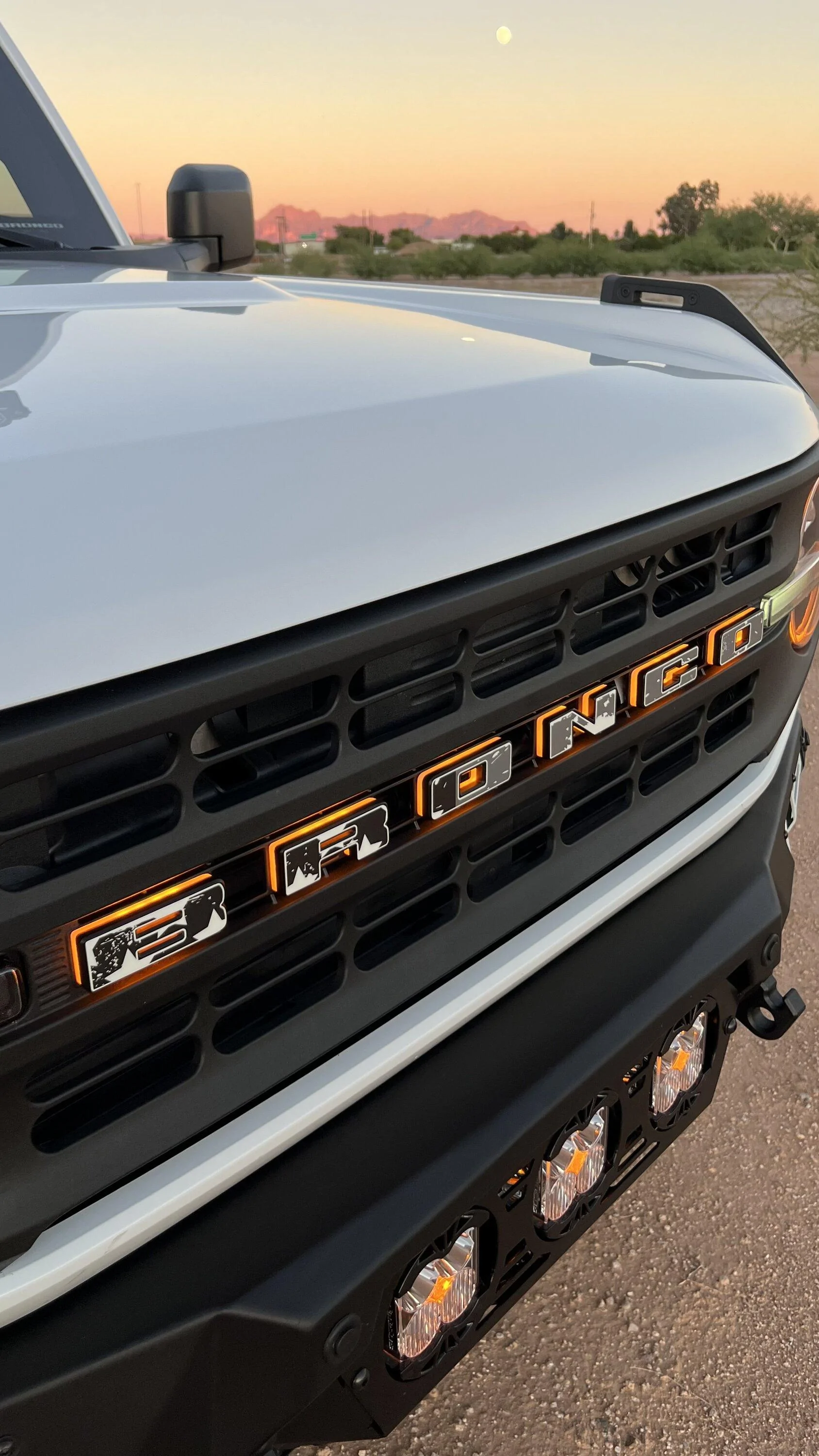

A work in progress, and my daily driver.
Had some bad 3d cad data, so a few lift components had to go back to the drawing board...but coming soon.
As it sits here, its 4.5" Lift on 40s.
Ford Bronco SEMA 2dr Daily Driver Build on 40s w/ 4.5" Lift - Doetsch OffRoad 1668480398226
Build list (current)
4.5" Fabtech Motorsports coilover lift with UCA, rear links, tie rods and rear trackbar
Broncobuster Steering bushing
17x9 Fuel Off-Road Forged Variant wheels
40x13.50-17 Cooper Tire STT Pros
Power steps from RockSlide Enginnering
Bomber series bumpers from Addictive Desert Designs
AlphaRex Alphablack headlights
Oracle Lighting flush mount led tails and backlit lettering
Baja Designs 40" on-x light bar, squadron pros, and LP4 lighting.
Katzkin Leather custom interior
AWE Exhaust
Vivid Racing VR Tuner
As always,. this is a work in progress. Additional lift and Dana Axles coming soon!
